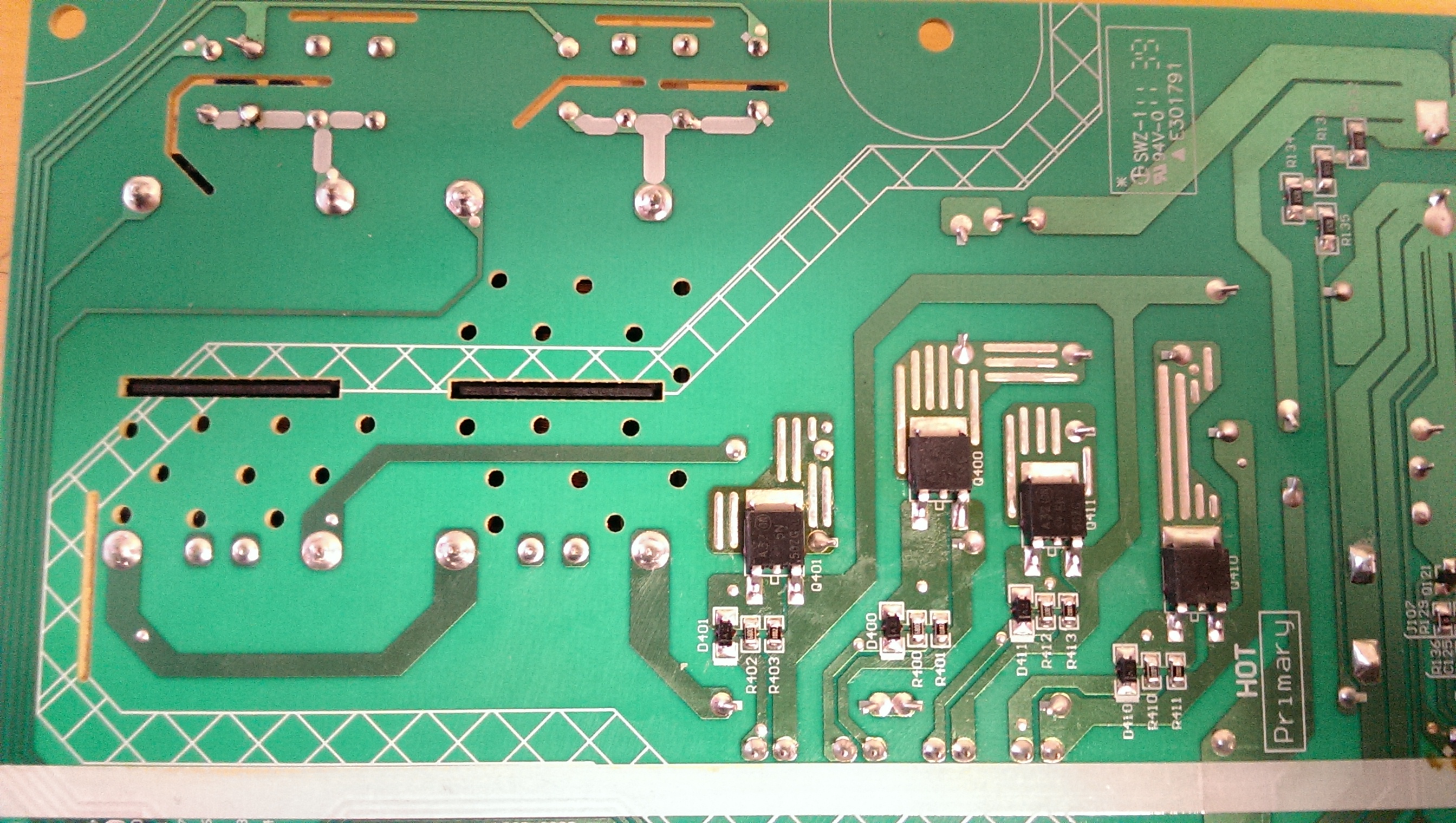

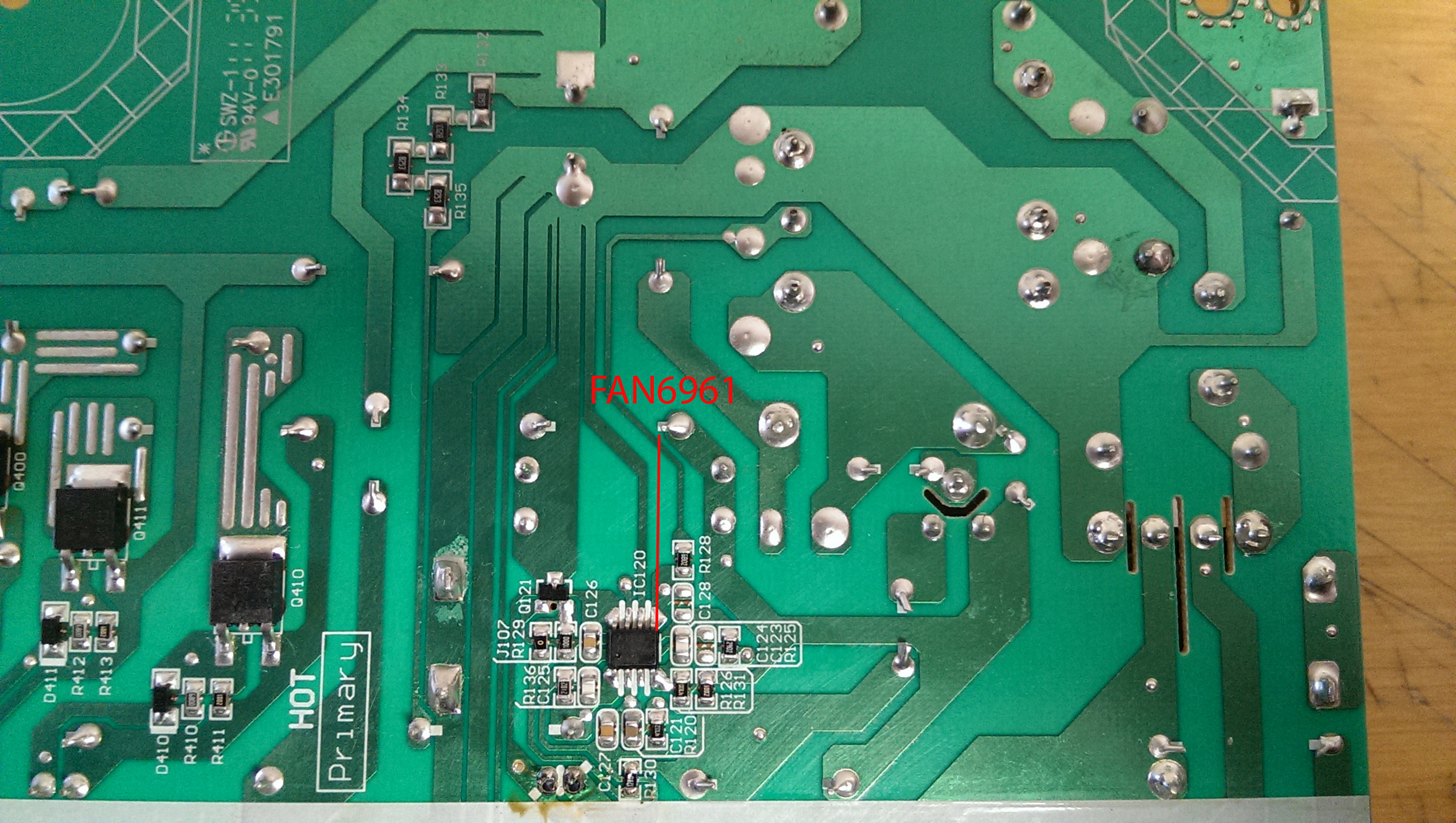

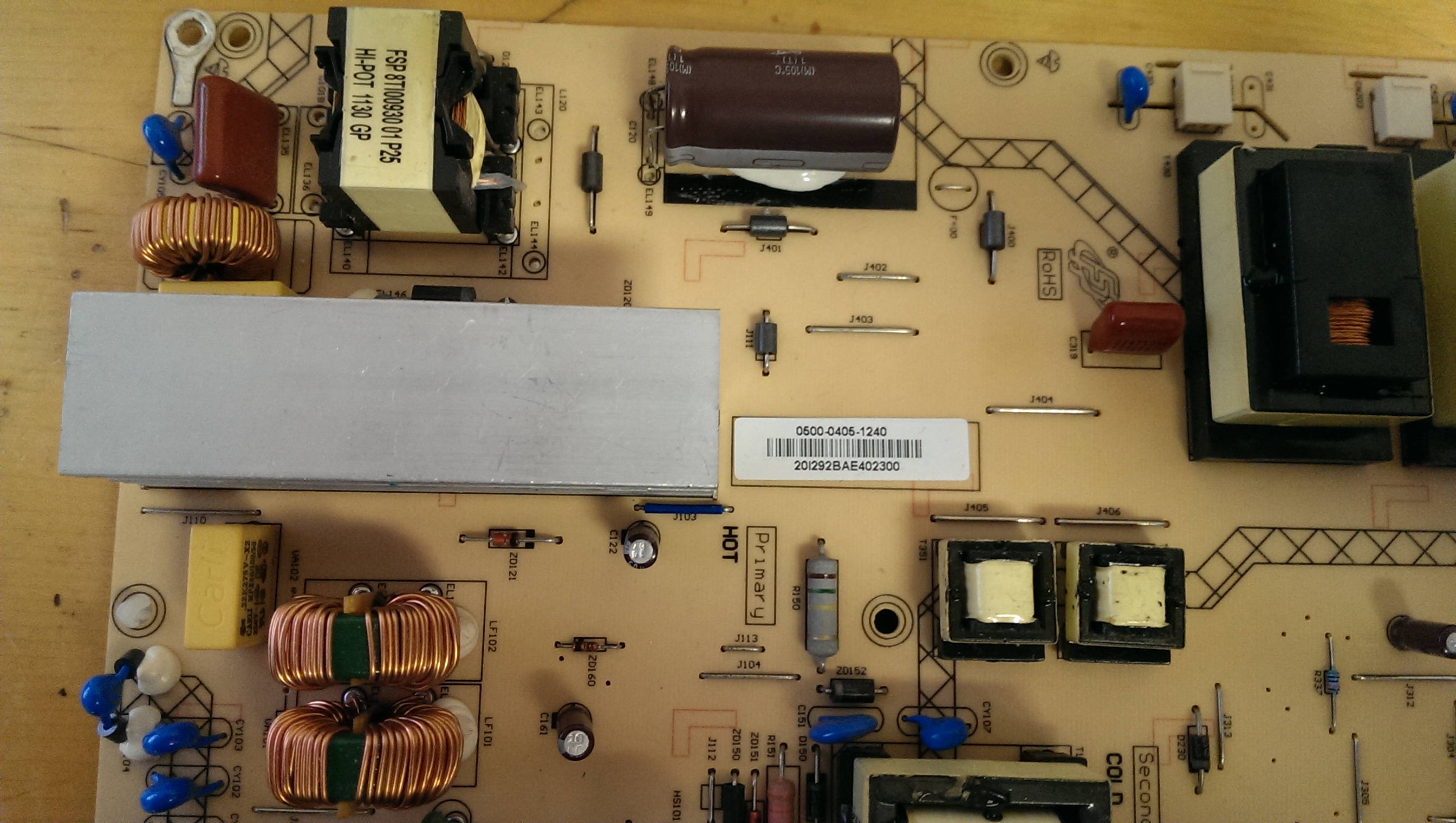

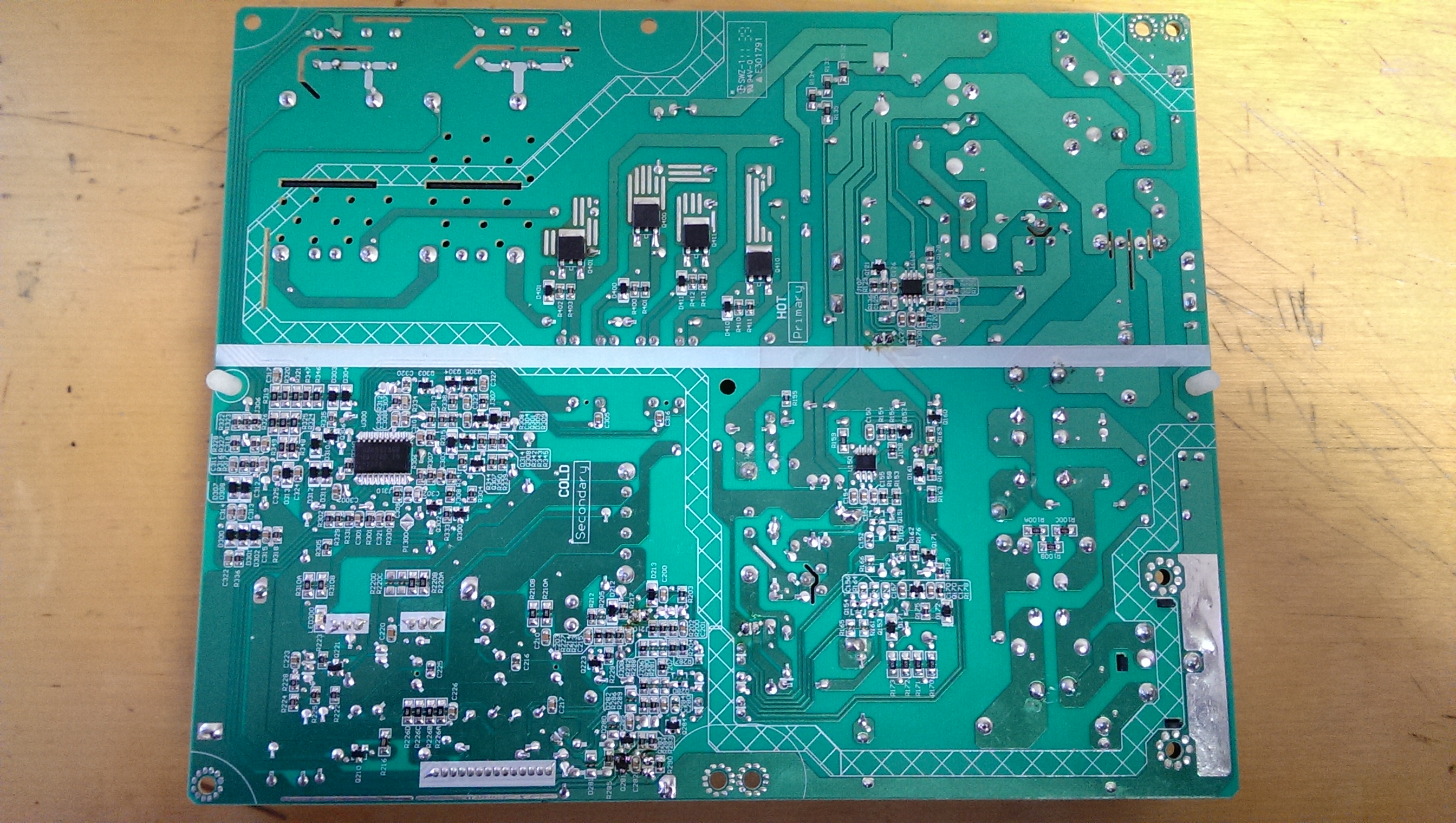

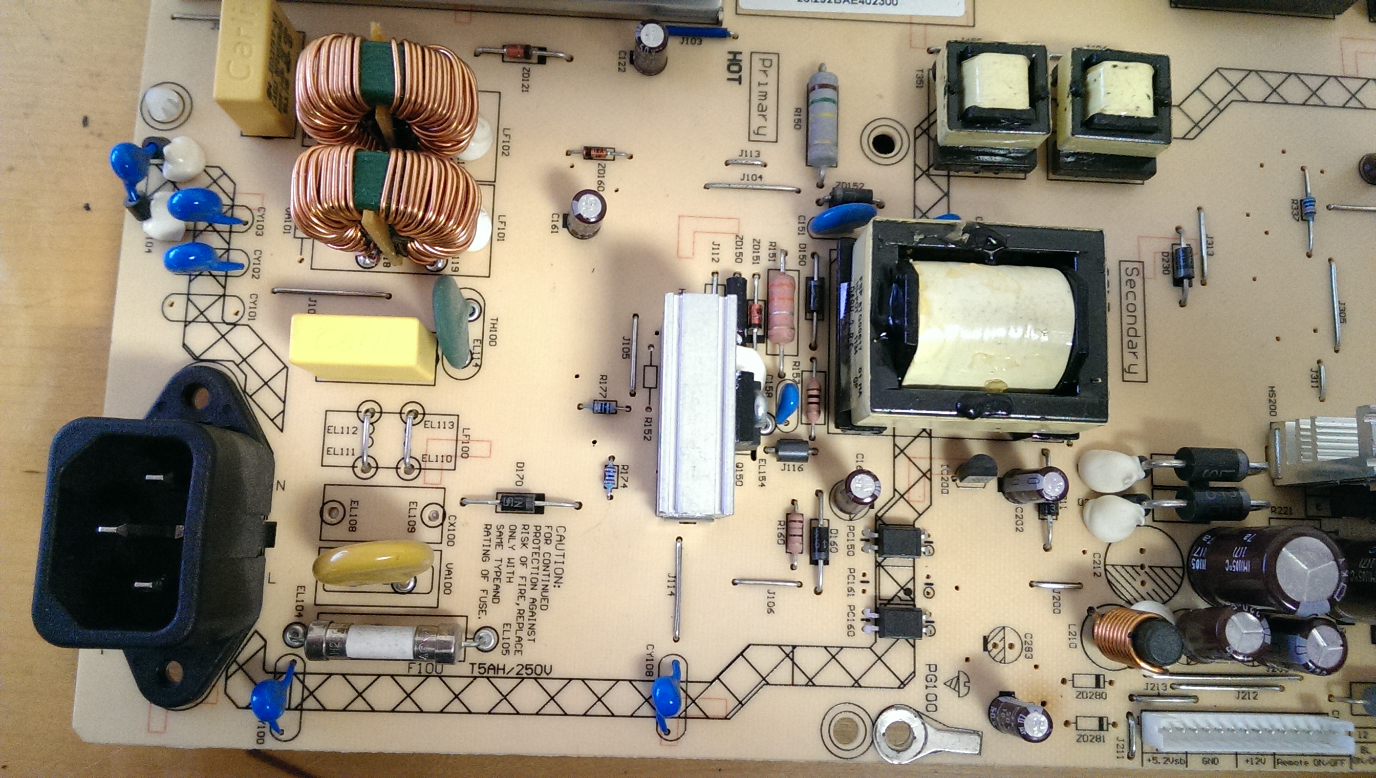

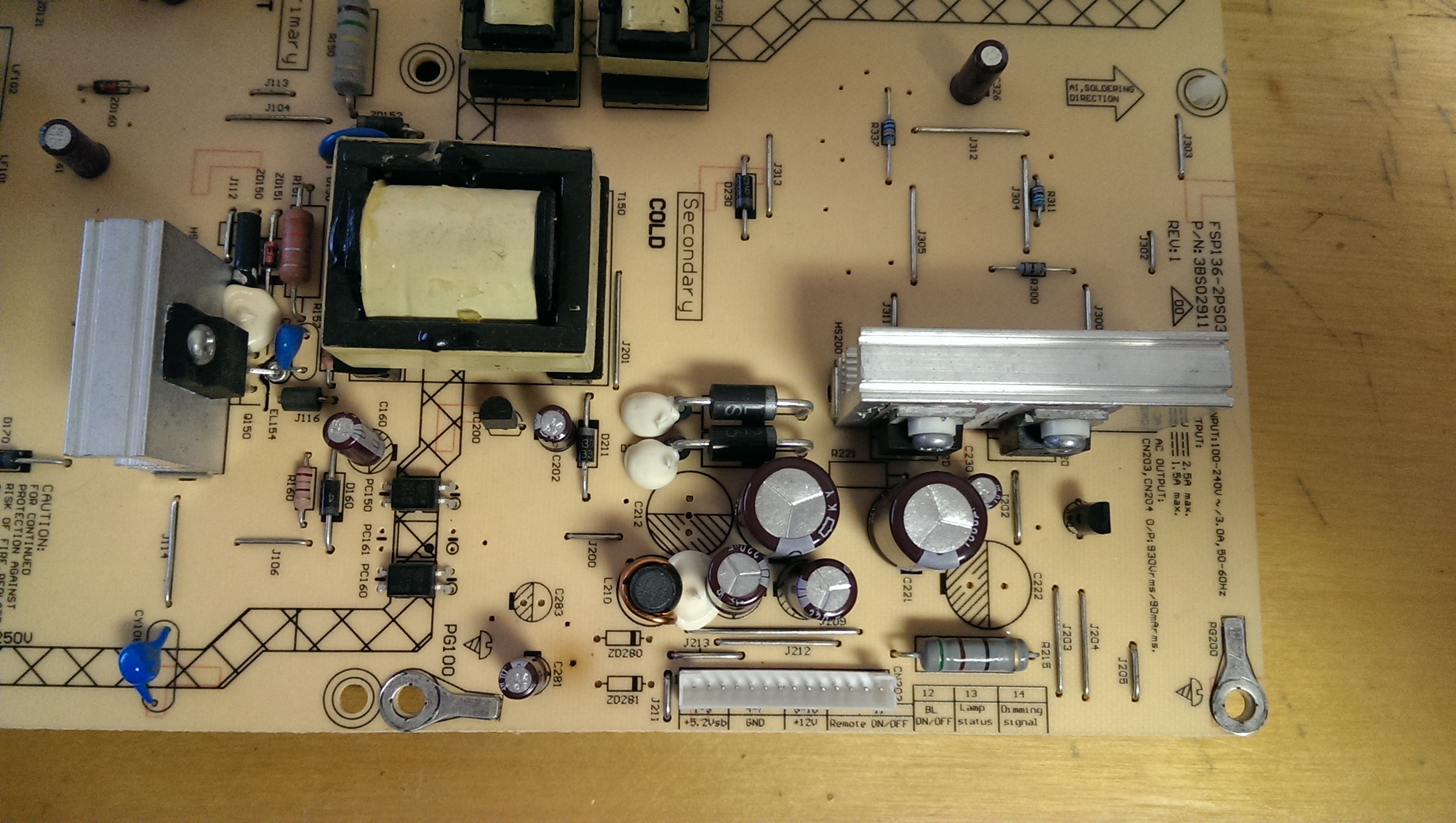

    Hello I picked up this TV from a friend broken. He said it was working fine then one day just wouldn't turn on. After looking at a few thread on this and similar sets I ordered a replacement eeprom and swapped it but it didn't improve the operation of the TV.
    When you press the power button on the TV or the remote control the orange vizio emblem briefly flashes white then right back to orange. If you hold down the power button it will repeat this same cycle once every couple seconds.
    I checked the voltages on the power supply while pressing the power button. The 12v comes up to 12v for only about 1/10th of a second then drops back to 0v. The on signal from the main board pulses the same way. I disconnected the cable from the main board and used a 3.7v battery cell from ground on the power supply to the "Remote ON/OFF" pin. As long as the voltage is applied to the pin the 12v supply comes up to 12.2v and remains steady. The voltage on the large primary side capacitor goes up to 396v also from 167v when the supply is turned off.
    After doing a couple checks I decided to connect another lead from the battery to the Backlight ON/OFF pin. This is where things go wrong. The backlights flash on and off at a couple times a second and the 12v output drops between every flash as well. I suspect there may be something going on with the power supply when it's under a load and is why the set will only power very briefly then back down.
    If I unplug either or both sets of ccfl bulbs the power supply does the same thing and only small LED near the OZ9977BGN chip flashes. This LED also flashes along with the backlights when they are plugged in.
    I'm not all that familiar with troubleshooting these types of power supplies. So I figured I would turn to more seasoned pros for suggestions.
    If I can't repair this one I have no problem ordering a replacement power supply but I want to be reasonably sure that it's a wise investment
    If more photos or information is needed just let me know and I'll see what I can do.

    check resistance with respect to cold ground on the output +rails,you should see many kohm's,a few ohms would indicate a short
    check output diodes for shorts,there are 2 large ones next to heatsink,shottky? ,remove one leg test with diode setting on meter

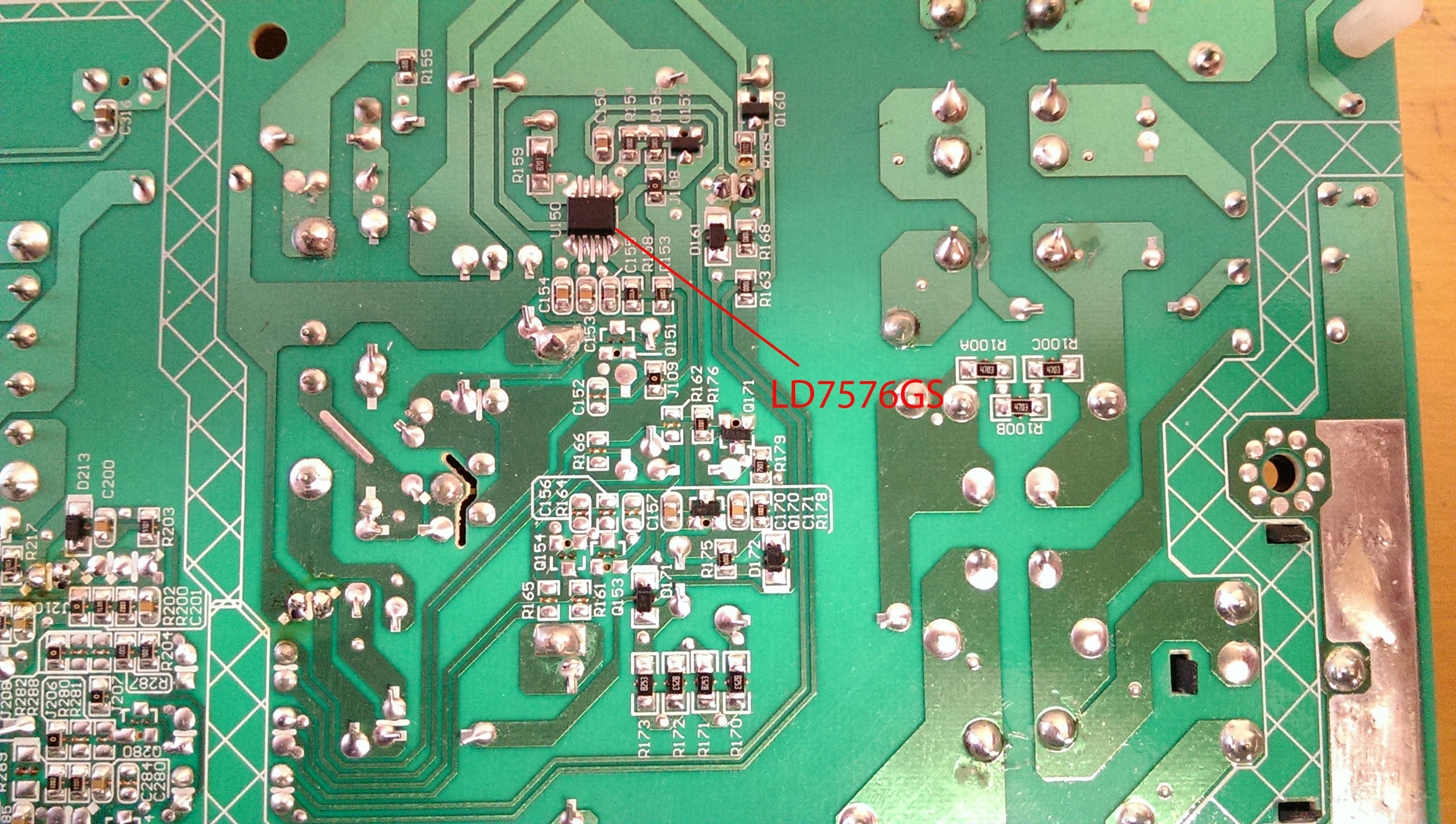

        After following the circuit around a bit I noticed the backlight inverter IC is powered by the same 12v supply that drops to 0v when there is a load present so the backlight circuit may not be the cause and just shutting off cause the power to the PWM is being interrupted

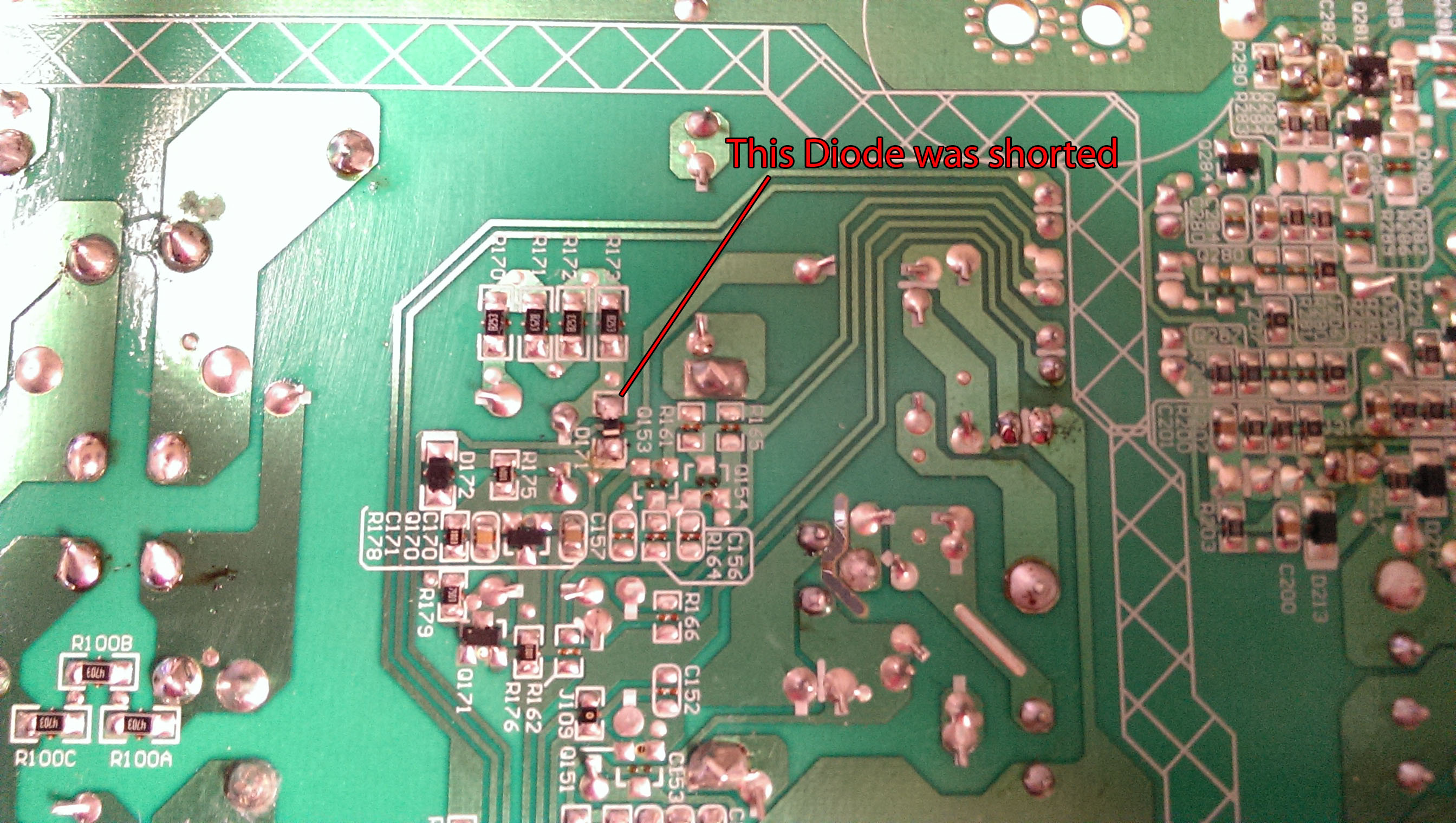

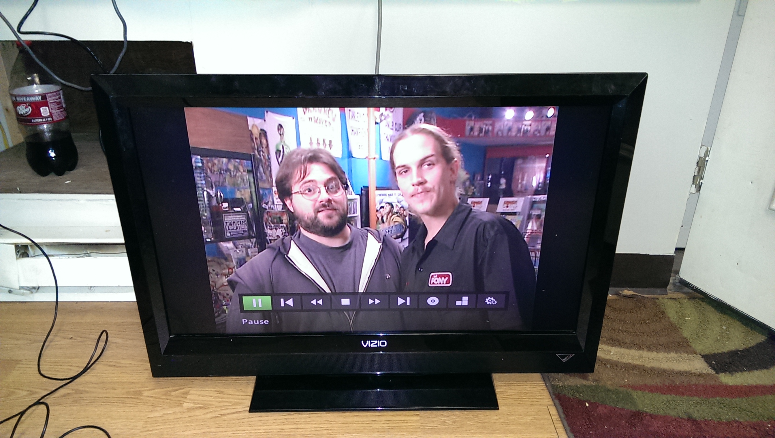

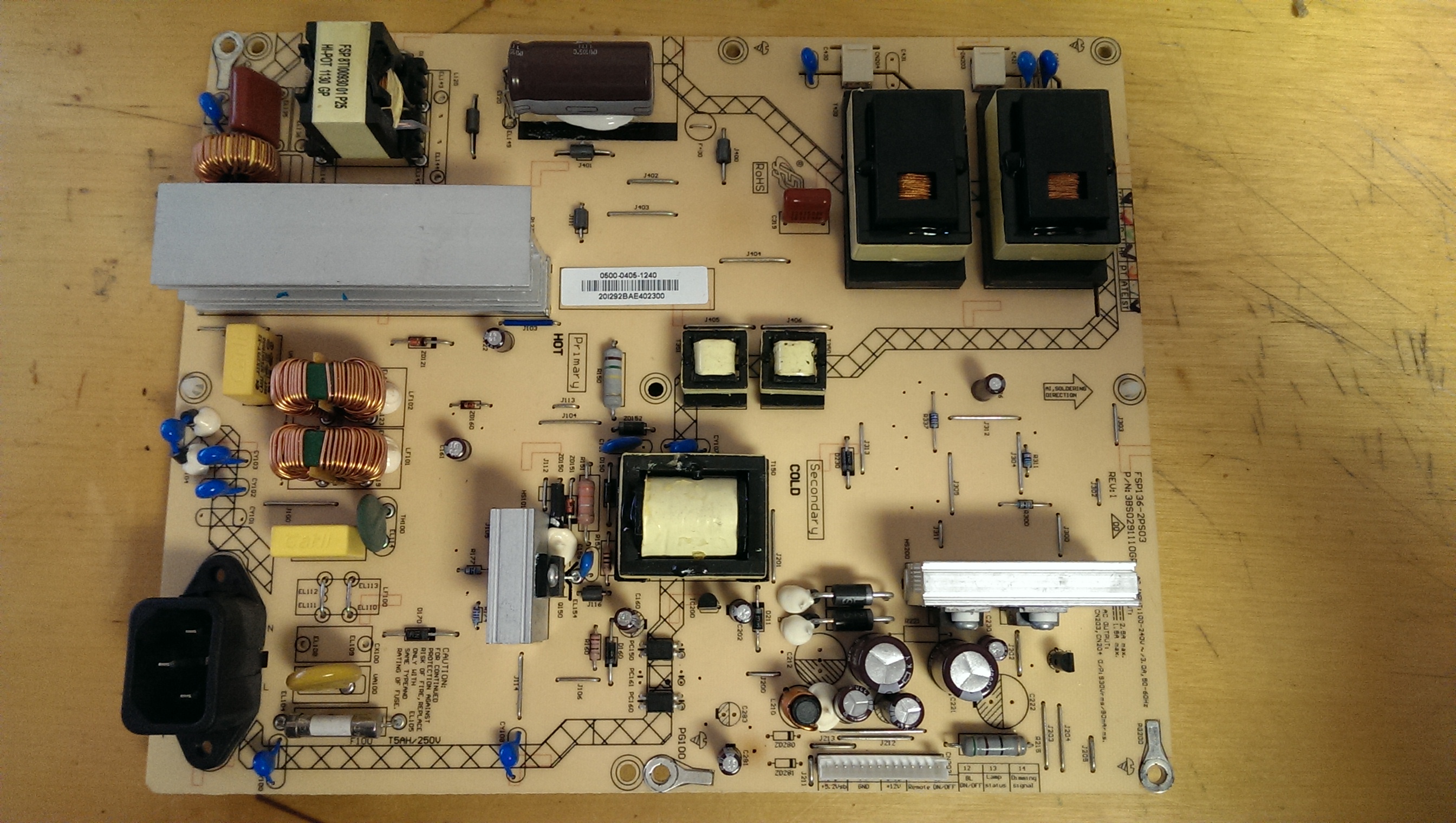

                                  Well it looks like my adventure ends on this TV. I replaced the startup cap and the bulk filtering for the outputs with better parts but no change so I started working backwards through the circuit from the turn on pin and located a shorted SMT diode. Replaced it and all is well again. It looks like that section of circuit is part of the feedback for the optical isolators.
                                  Thanks for the help. Is much appreciated.
                                  Pics below showing damaged component and powered on set.
                                    Re: Vizio E321VL Doesn't power on
                                    Good fix!, so the 5V power supply was the cause of the problem due to shorted diode. The diode looks like it is being fed from main primary supply, you can see bunch of resistor in series then go to one of leg of the 5V SMPS IC?
                                      Yeah. it branches off and goes to the IC and a small transitor. Set is working well. Hopefully it stays that way
                                      I actually went over most of the easy to test discrete components my first time around the power supply but I missed that diode. Guess with so many it's easy to lose track and skip some
