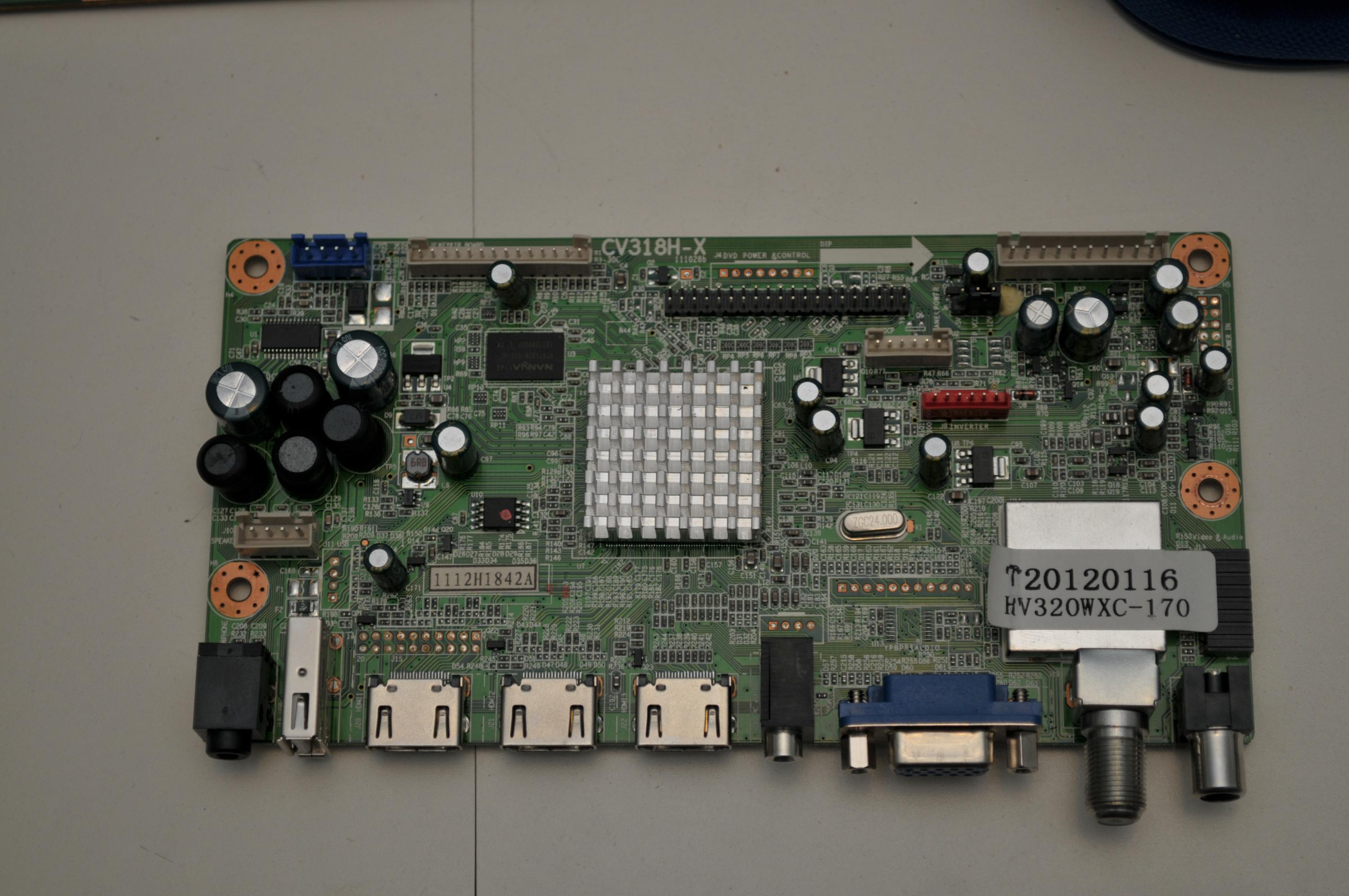

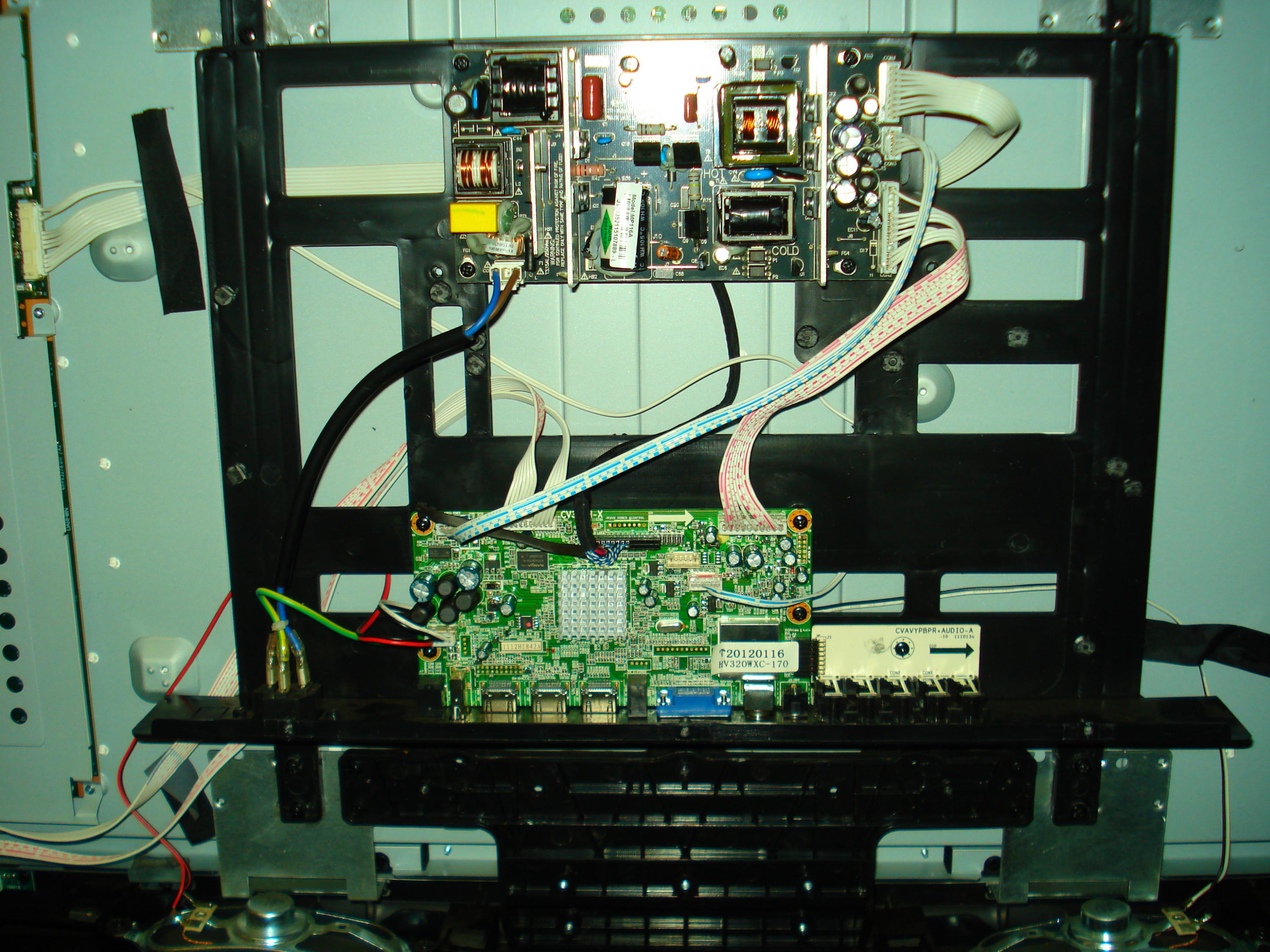

      Turns out my memory was a little off when I wrote my previous message. The startup sequence is like this:
      Press power button. Set turns on, red LED turns Blue, PSON goes to 4.15 volts from 0.04
      2 seconds later backlight turns on, but no image on screen
      5 seconds later, backlight turns off AND LED turns red from blue
      1 second later PSON goes from 4.15 to 0.04 volts.
      I also watched the 5VSB and 5V lines and both were about 4.9volts.
      The 5VSB never fluctuated as the set turn on or off.
      The +5V switched off 1 second after the LED turned red (in step with the PSON line going low)
      I was told that the set was only just over a year old, and there seems to be a few of these on the local Craigslist for sale "As-Is". Replacement boards don't seem to be available yet, although the mainboard design looks it's been around for a while. I think I might try a board from a different TV set to see if I can get the screen working.

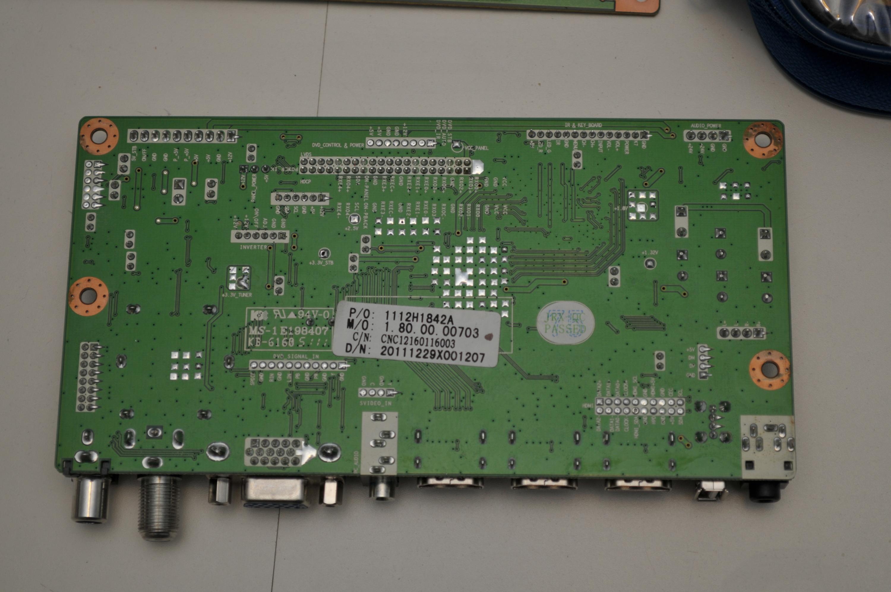

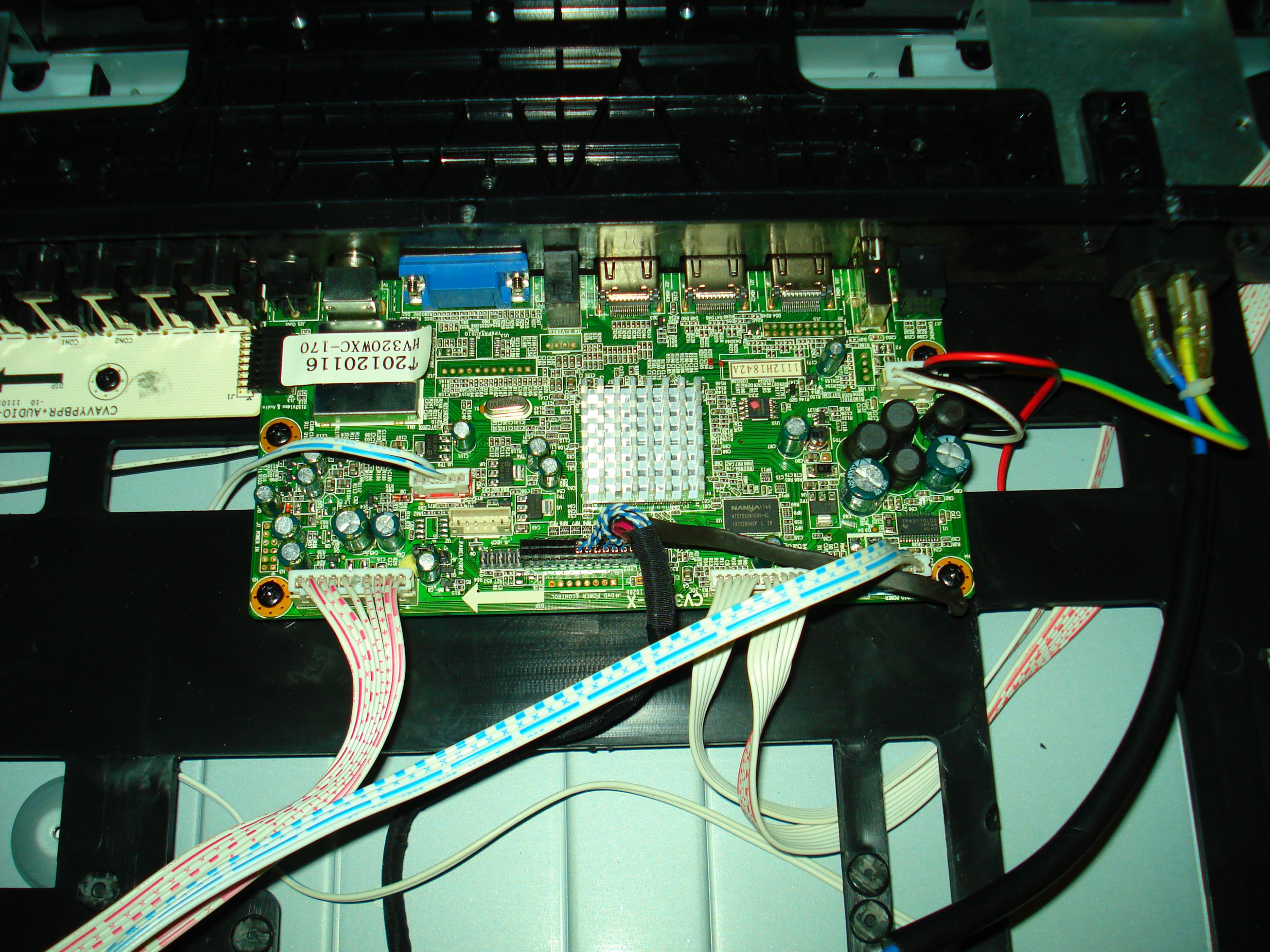

      Here are pictures. The back shows the pinouts
      My set's serial number ends with 407, the one in the other thread ends with 545. I think I can safely say they are pretty much identical, right down to the part numbers on the boards.
