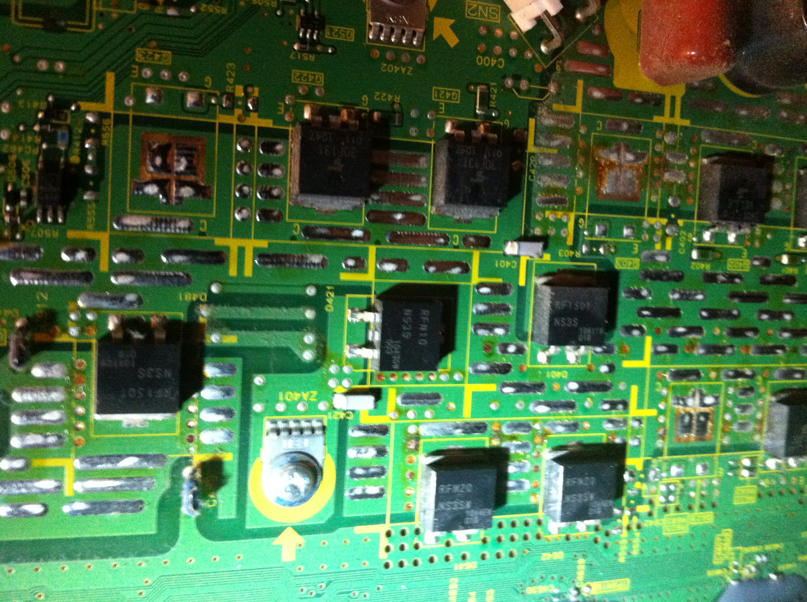

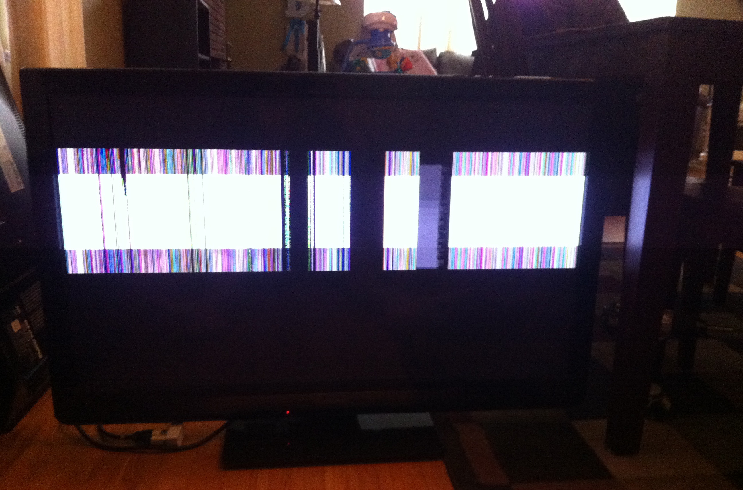

    Hi guys. I have a tc-p42s30 with a little bit of a different issue than I have been able to find with anyone else. The tv will power on normally, no blink codes. The panel lights up with large horizontal bars filled filled with think vertical lines. The audio will come one. I figure that the SN board (tnpa5349) is the culprit and like others I'm having a difficult time finding a new SN board. After doing some research it appears that some people have had success replacing the IC chips on SN board. I'd rather just replace the board but right now its not looking like much of an option. My issue is I really do not know how to test the chips to see which ones are bad. I can replace them myself, just need to find out which ones are bad. Can anyone tell me how to test these chips? I have attached a pic of the panel so you can see what I'm talking about and I also provided a link to a "repair kit" for this board. Please let me know if you have any insight for me here. I would GREATLY appreciate it.
    http://www.ebay.com/itm/PANASONIC-TN...item2eccec8344
  • tw2005
    • Oct 2011
    • 6458
    Re: Panasonic TC-P42S30 issues
    To put it simply, they short out . If you have a meter that has continuity or diode mode, set to that and any continuous beep will be a dead one. Could also measure resistance, pick any 2 pins, usually shorted across all 3 but try all combinations of the of pins to be sure .
          I'd check -Vad and Vsc voltages on SN board.

            IC502 AND Q53. from what ive read this should take care of it unless something more major. I tried to take some reading with my multimeter on the different mosfets and each give me a different reading but I really dont know which ones are bad and which are ok.

                      They fail short cct so you could test them in cct as a quick guide however quite often they will be in 2 or 3s in cct so one bad one will short the others but when removed you sometimes may find not all are shorted.

                        well i got lucky and found a refurb board cheap. going to just swap the board and keep this one for a project later.

                          Wait. I have the same exact TV. I ultimately had (4) shorted mosfets on the SN board, which caused the TV to not show a picture at all and give a 7 blink code. On these TV's, if there is a short circuit on any board, the Power Supply will shut down automatically and give a blink code to prevent further damage.
                          It's odd to me that yours would powered up normally if it was a shorted component(s) on the SN board.

                              If your still getting a picture at all and the TV is running without a blinking code, then you should definitely not have a shorted component. On this model anyway.
                              Do you have anything hooked up to the TV at all?

                                  Yeah, I think you should be getting some kind of blinking code if it was a component on a board problem.
                                  Have you tried reseating the ribbon cables that go from the panel to the SN board? You can try taking out the ribbon cable(s) and reseating them (where the problem is on the screen)
                                  (Make sure you power down the TV first or you will short something out on the SN board if you do this with it powered up (like I did).

                                      do you have a manual? try service mode, then you can either try test patterns or I'd be tempted to try the mirror option and flip the display vertically and see if top goes black and bottom has that messed up display.
                                      on these a dead short on the Vsus at power up does not produce a blink but a solid led.
                                      It is possible to have a fault yet no codes as well, I've managed to create that situation on my TV.
