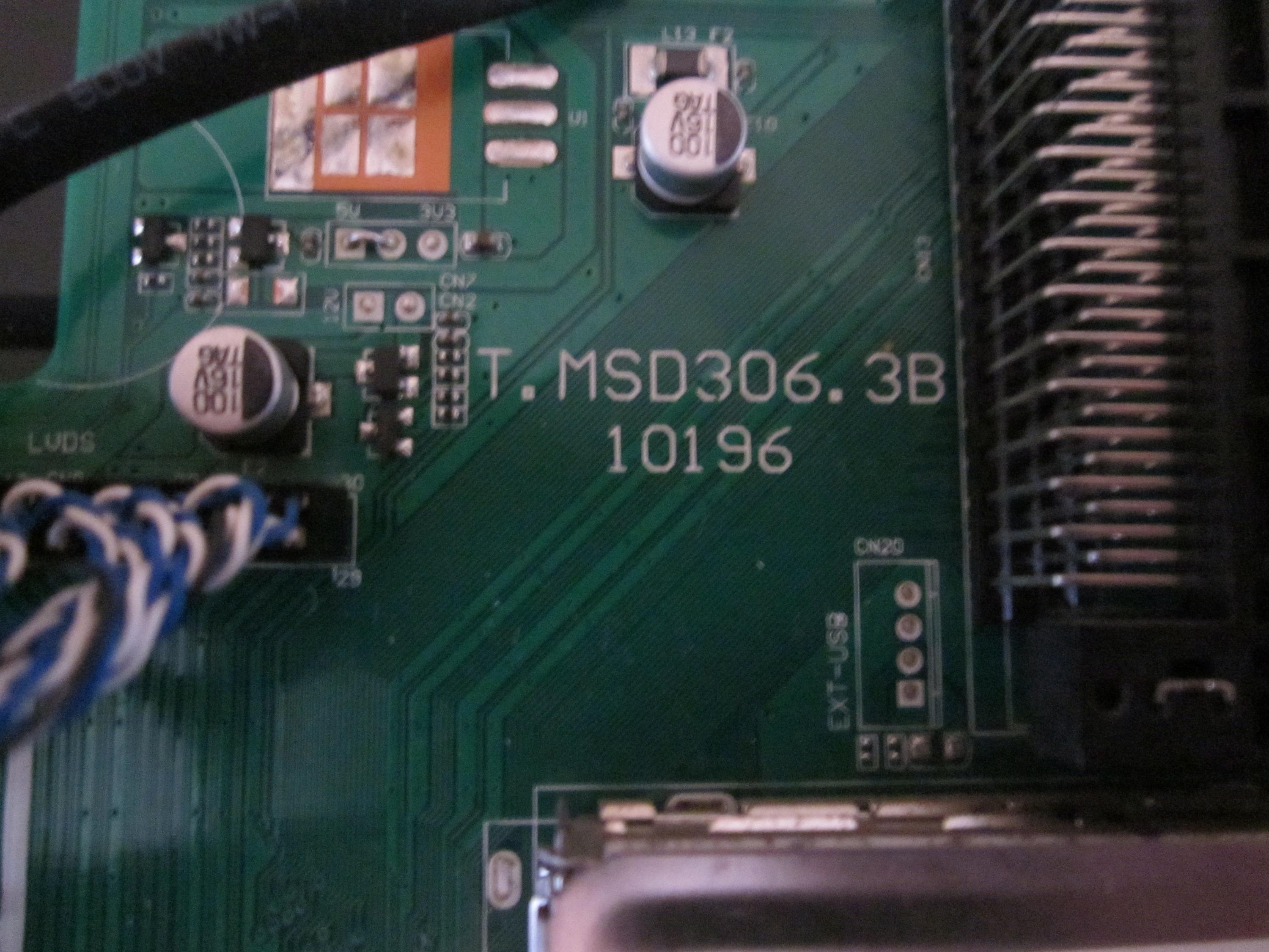

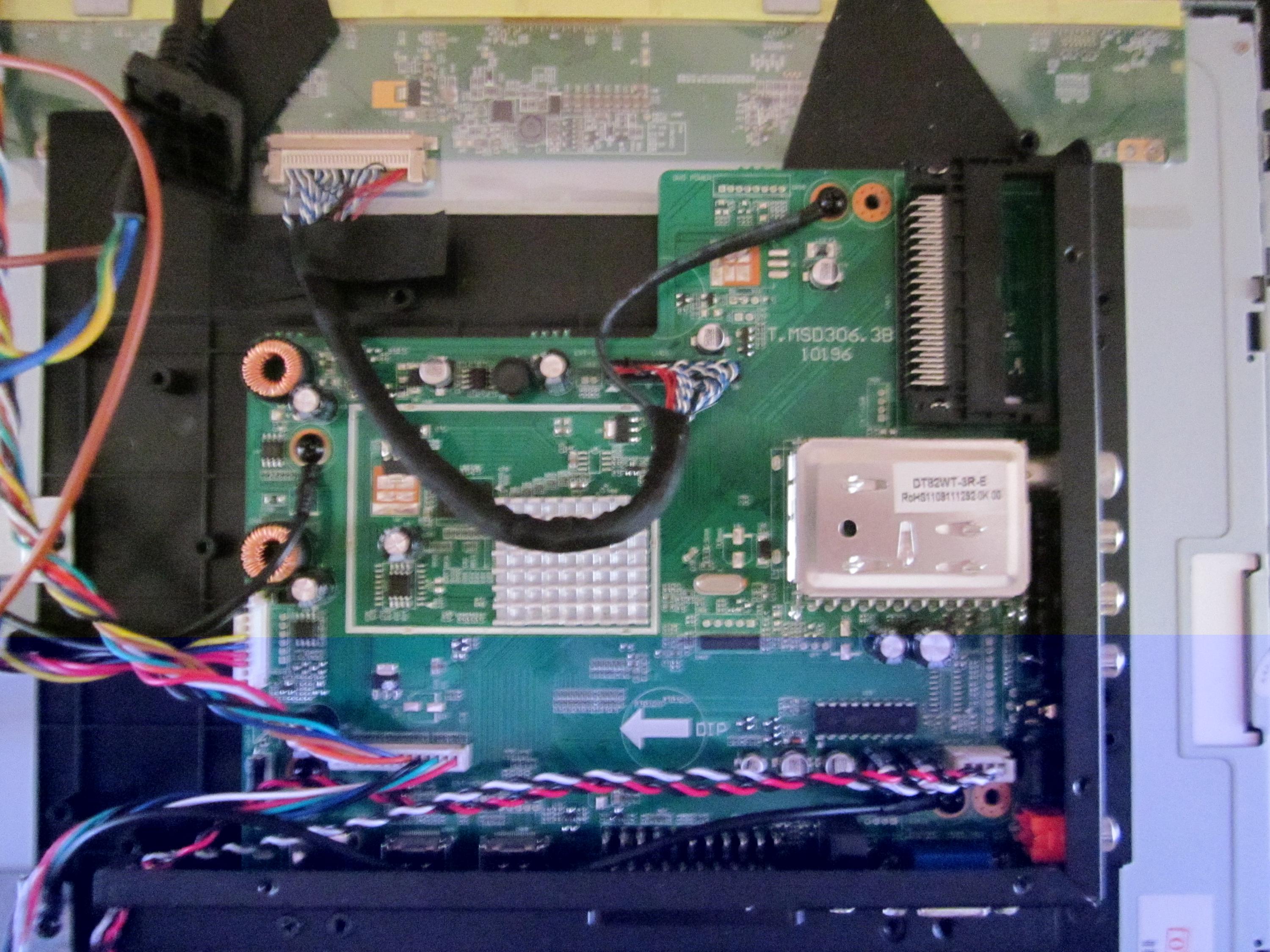

    hi another project BUSH BLED24FHDL8 stuck in standby solid red light only pics of boards attached where do i start?

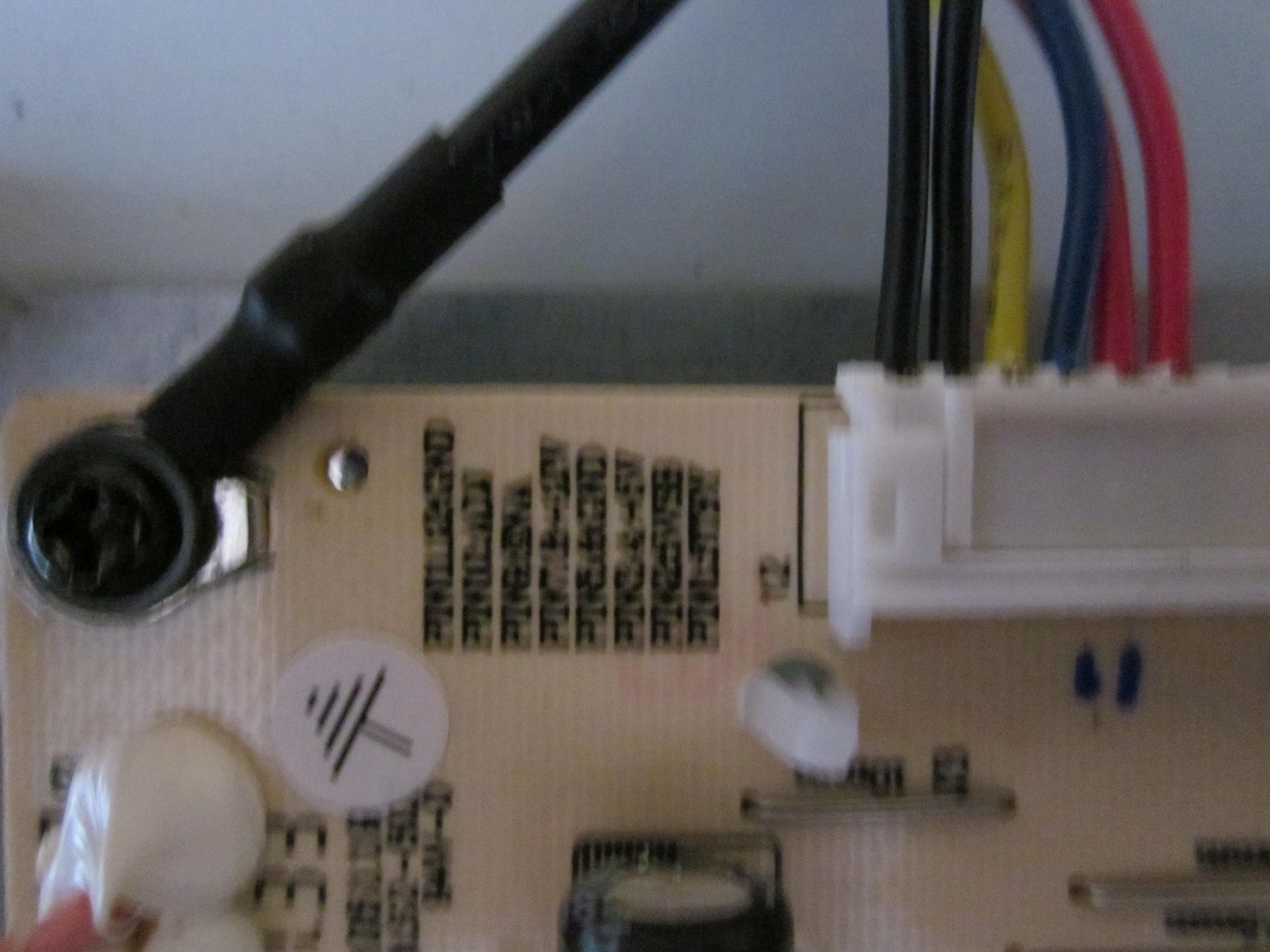

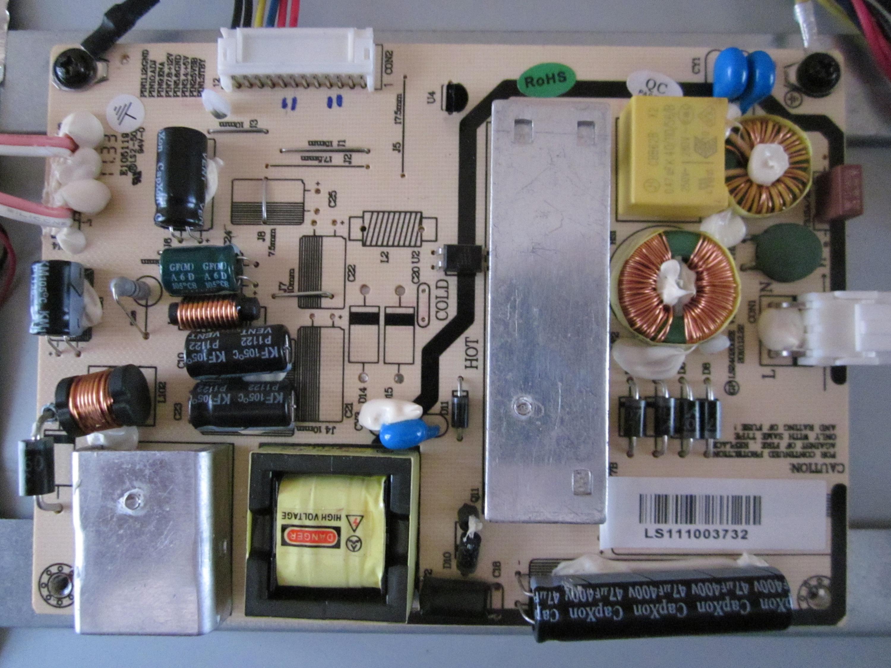

    only 6 wires from psu to main
    pin 11 and 12 gnd
    pin 10 adj 00.1 volt
    pin 9 ena 00.0
    pin 7 and 8 +12v 12.2 volts
    voltage regs on main are all 1117 b
    u5 0.00 3.31 5.17
    u6 0.61 1.86 3.53
    u2 0.00 3.28 5.18
    so where do i test next pressing the on button does not change voltages at all.

    If ENA does not toggle, then main board is bad, it is not sending the ON signal.

      cheers tom just rechecked with on the set buttons and a remote no change at all i will see how much a main is do the voltage reg readings look ok to you? cheers tom
      good pic of the board anything u can suggest to check?

        What's part number of U6? It seems a little odd.
        Full image:
        http://flattvparts.co.uk/bmz_cache/4....2444x2076.jpg
        Near coils, left hand side of board, there are chips U3, U4 and U7. Part #s of these?
        Fuse F1 good? Bottom LHS.
        Fuse F110 good? Top LHS.

          Fuse F110 good? Top LHS. no voltage either side checks ok on ohms test
          1117 b u6
          u4 aic2857f
          u3mp1423dn
          u7aic2857f
            Re: Bush bled24fhdl8 stuck in standby
            Just 1117 on U6? Nothing else?

              soz tom bad migraine today eyes hurting haha it says 1117 b ad a21g.

                I would expect something like -18 on that regulator, so that does not seem right, but it is possible it is unmarked.
                Can you see any way to measure the voltage across capacitors E3, E4 and E9, with board powered up?
                  e3 0 volts
                  e4 5.2 volts
                  e9 1.3 volts
                    U4, AIC2857F is suspect, but I cannot find datasheet for it.
                      Found a pin out, close enough...
                      So of U4, check pin 2, pin 8 and pin 7 voltage, board powered up, relative to ground (i.e. black probe on ground/chassis.)
                          tom that pic does not match ie the indent does not match to pin 1
                          0.01 0.01
                          12.24 0.01
                          0.01 0.00
                          0.00 0.01
                          the indent is top left on u4 if this makes sence back soon another freecycle set to collect will be bk very soon.
                          u4 aic2857f
                          gr8 12014
                          https://cdn.badcaps-static.com/pdfs/...f75d06d109.pdf may help you tom.
                            The schematic pin out is drawn differently to the real pin out, this is fine. Just use the pin numbers I mentioned, using dot on device as reference, not the schematic.
                            So, it looks like the main processor is not turning on that converter. Not much else to do other than price up a main board at this point, probably another board with bad firmware. You can try searching for a replacement flash chip, which may be one way of fixing the board, but that's not always available.
