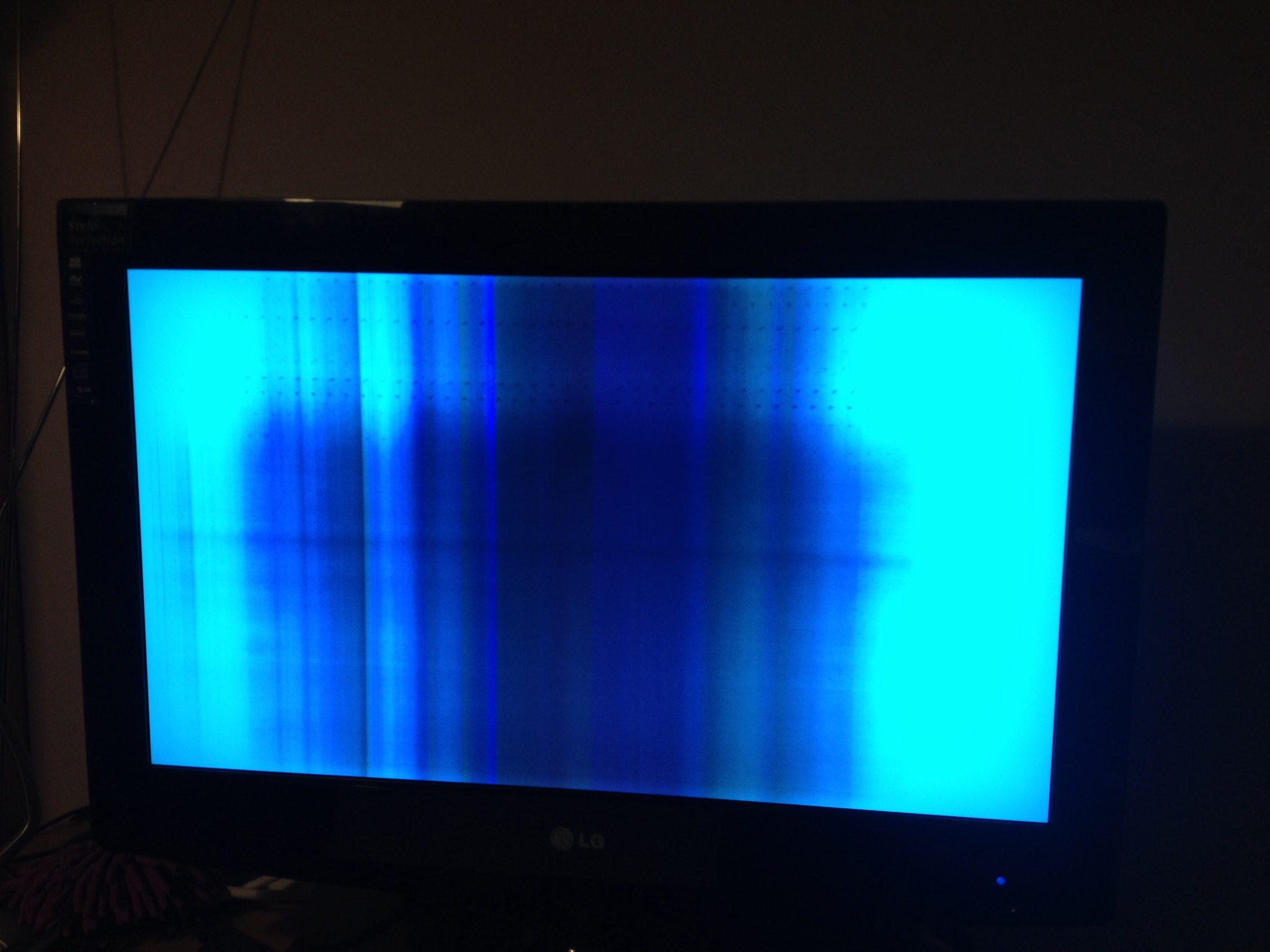

    Hi guys! I'm hoping someone can help me out here.
    I was given my Dad's old LCD TV a short while back. When I finally started using it, when first turned on the screen would just go grey then start to show a picture then freeze and go grey but after a short while it would warm up and would work fine.
    I recently started using it a little more often and the first few days it went as described, taking up to 30 minutes to warm up.
    This evening I turned it on and left it for a while expecting it to warm up after the half hour, however now I just have a bunch of lines which change colour as the programme plays out. I have sound, I am able to use the remote ad volume and even change channel, just cannot see a picture anymore.
    I'll try to add a picture I took this evening to this thread.
    Any help would be gratefully received!

    looks to me like the panel has gone but could be caps post good clear pictures of the set with the back off then pictures of each board.

        I'd say tab bonds.
        https://www.badcaps.net/forum/showth...ghlight=v260b1
        I've had good success with fixing these. I use a bit of foam pad (from kitchen scrubbers) cut up and wrapped in duct tape, to apply pressure on the tab bond.

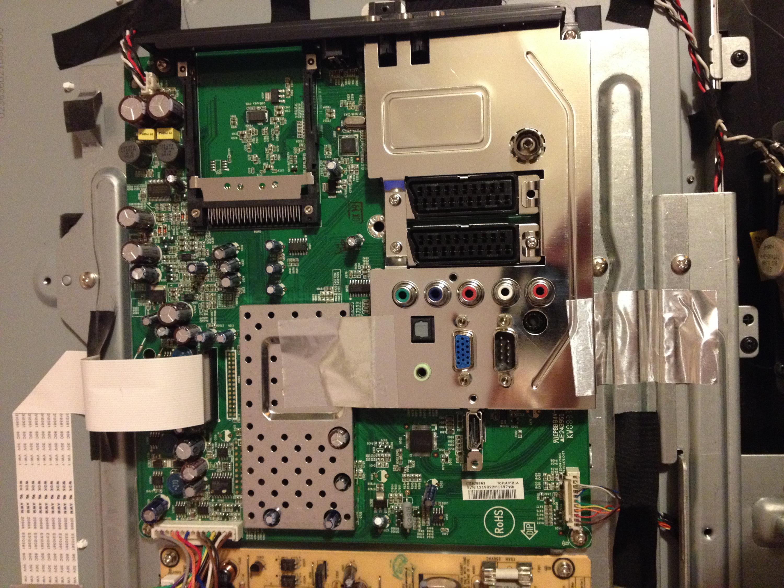

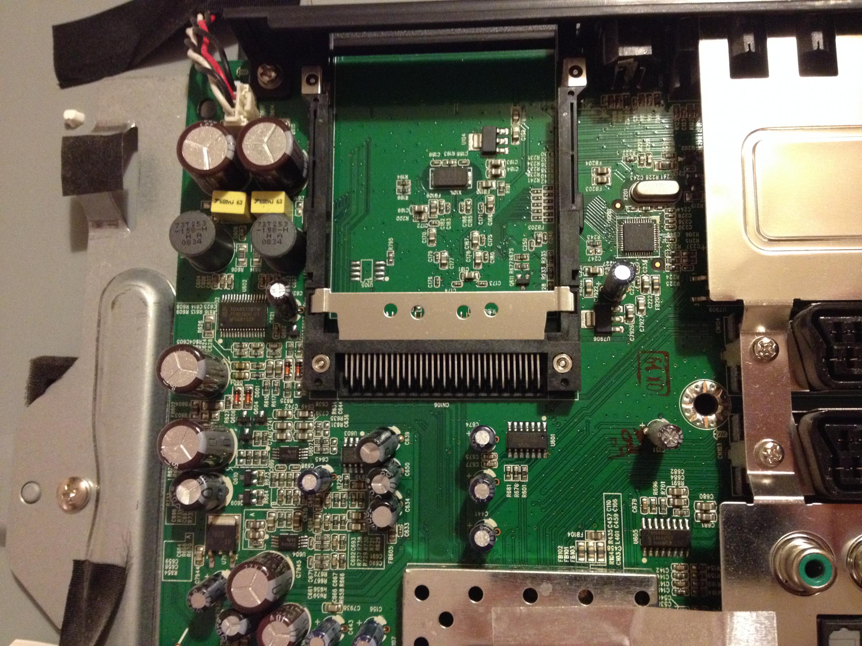

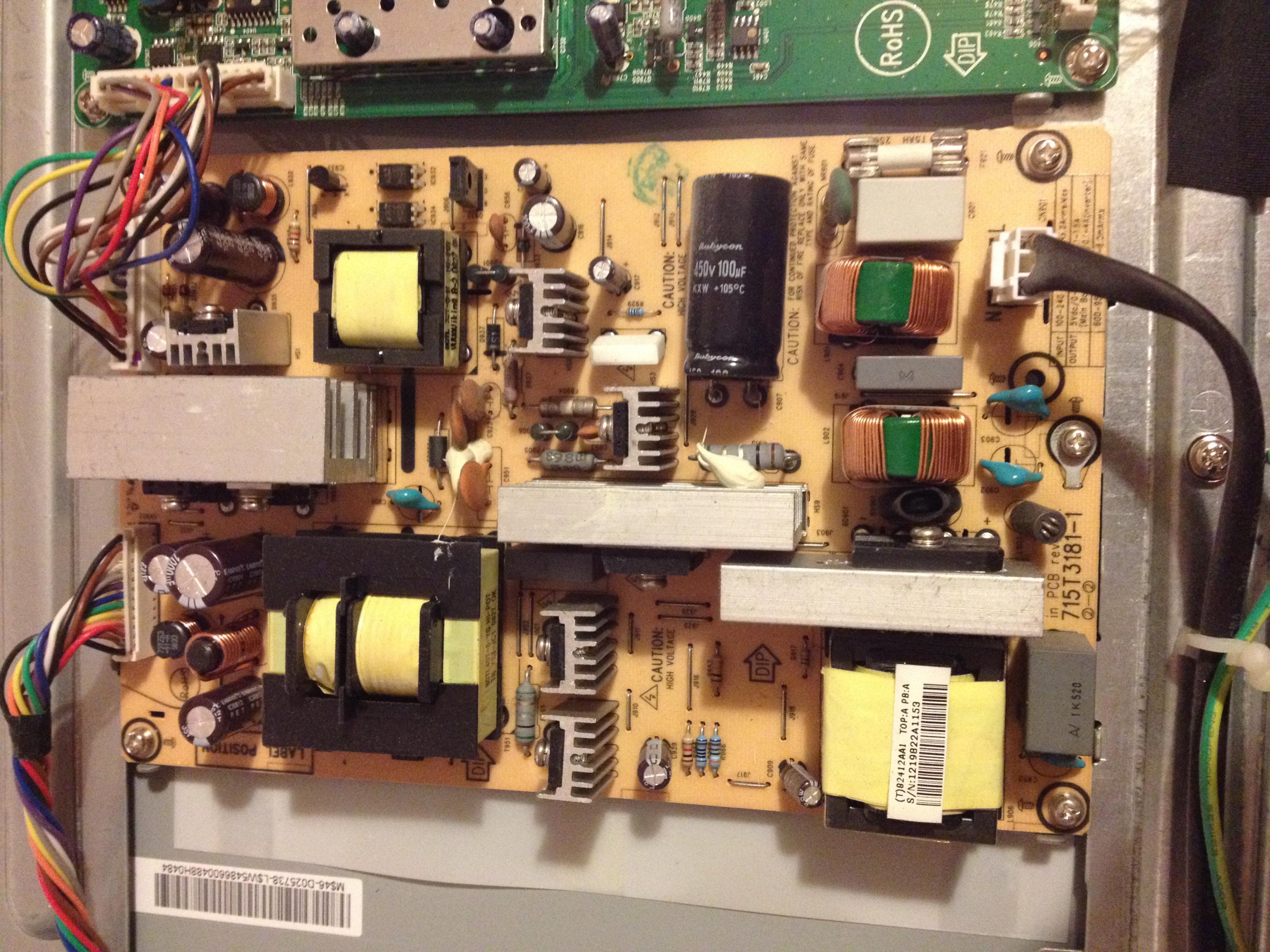

          Pics update of the circuits. I don't have a clue what I'm looking at here!!

            in pic 2 is that burn marks on the main board just below the two scart sockets.

              Here's same panel but in a different TV I worked on. First, please confirm the LCD panel is made by Chi Mei Optoelectronics and is of model V260B1. To find out if this is the case, check the internal metal casing for a sticker with such markings on it. It looks like this:
              Video: http://www.youtube.com/watch?v=mMo3NBGLwH0 (about 1 minute in has repair process)
              Fault symptom varies but the original light grey screen sounds like what your TV had. I've had ones that clear in 5 mins and others which take 30 mins.

                Well, since I've taken it apart and put it back together again it's working fine with a gentle squeeze either side of the TV! Definitely not the board I'm guessing!

                  My sets usually worked if you gently twisted the frame, but it never lasted. Permanent fix is tab shim. But it definitely sounds like you have such a fault.
