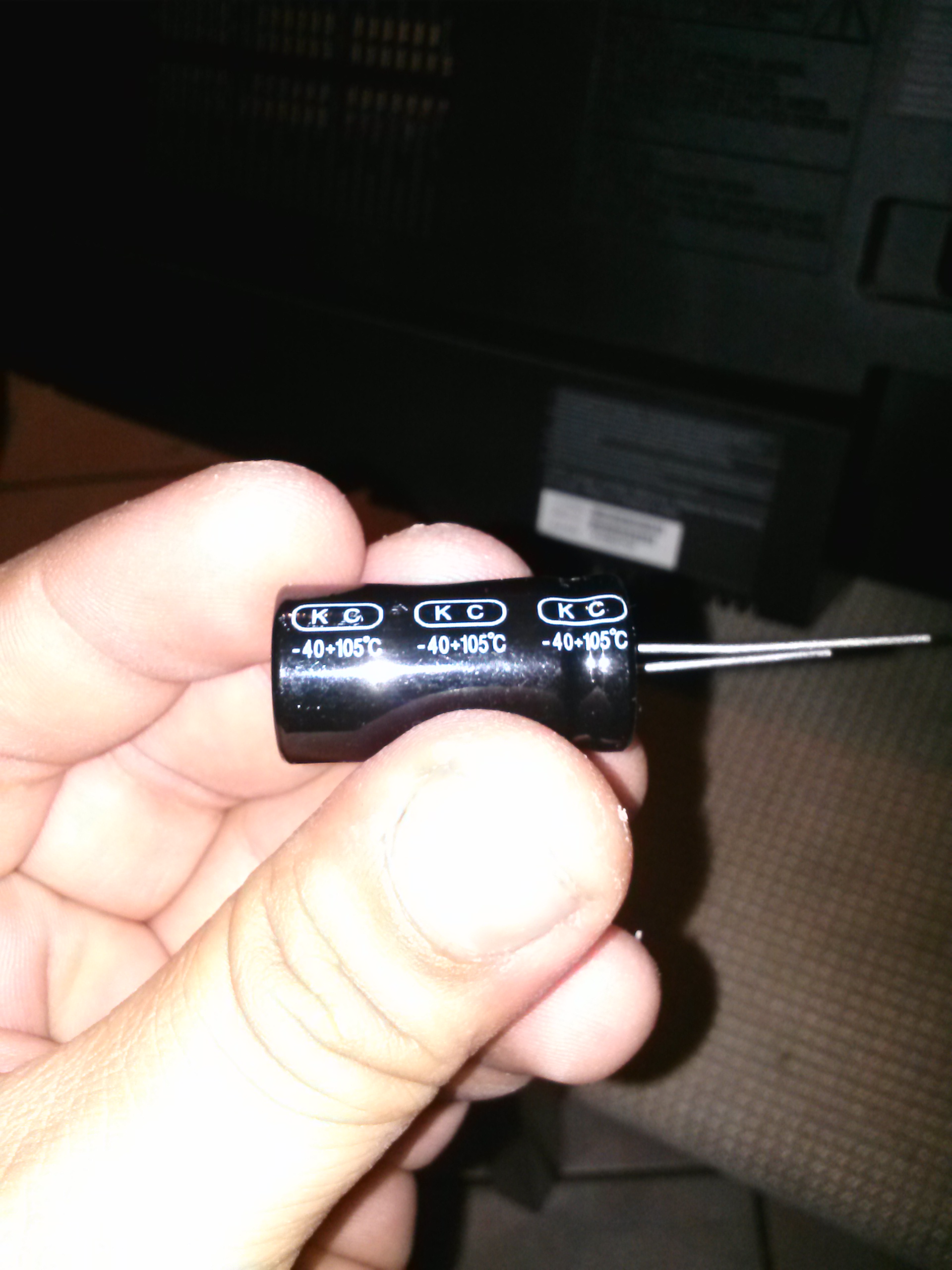

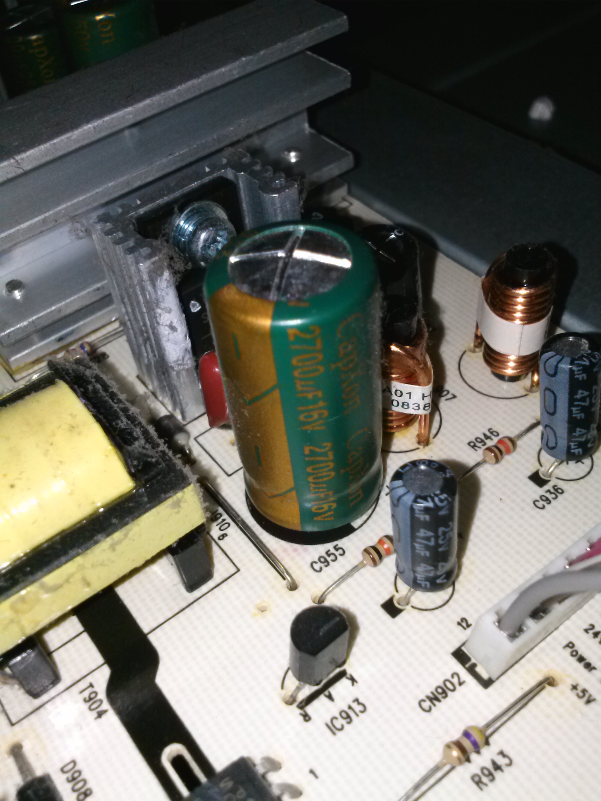

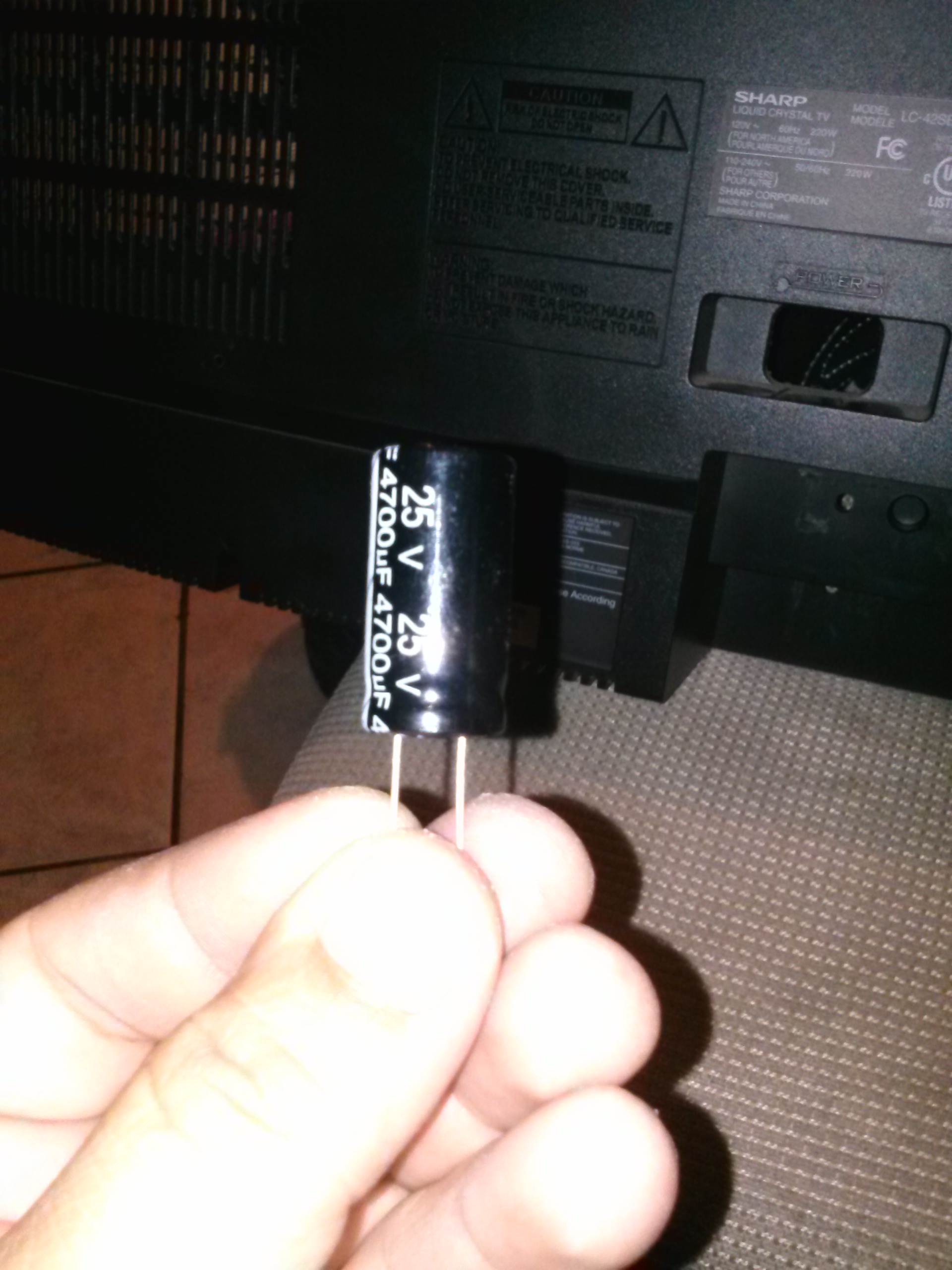

    Hello i have this sharp tv with 1 bulging cap on the power supply tv showed classic symptom of bad cap by long start up time.. Anyhow the cap is a 2700uf 16v 105 deg and i went to order them wit a higher V rating but it seems i ordered 4700uf 25v 105 deg.. will i be able to use it or do i need to order the correct one?

    I would not use that capacitor, cannot be sure it will work.

        ok will upload a pic now original it says capxon on it and its green and gold and replacement says KC its black with silver

        yea tom i was thinking the same thing but i read if its 1 u can get by

          I wouldn't use that capacitor even if it was right capacitance. KC brand -- likely generic non low-ESR so could be worse than original... If it works could just die in a month's time.
          You could get this capacitor from digikey:
          http://www.digikey.com/product-detai...2370-ND/613731
          +$2.75 shipping
          and it should be just fine.

            ahh ok i didnt know brands made a difference.. so now i know there are cheap quality caps (kc) and good quality caps.. what are the names of good caps for future reference?
            and how do u tell ESR from Non ESR?

              Also if there are any other capxon caps of the same series you should seriously consider changing them. One bad - probably all bad.
              That is not a usual value for a startup cap either. Its usually a small one on the primary side 50v 47uf but it can vary.
              Panasonic FR FM and FC series or Nichicon and Rubycon are considered good but you should buy from a good supplier as well.

                  This. Those 47uF 25V look like CapXon KM. They do not do well on these hot boards, and since you're already ordering from Digi-Key you should order the rest to replace all the CapXon, then you will be able sleep well at night knowing you don't have to worry about other caps failing

                          Update: caps came in yesterday. i installed them and tv is up n running. . thanks tom for the digikey tip and thanks to everyone else that chimed in...
