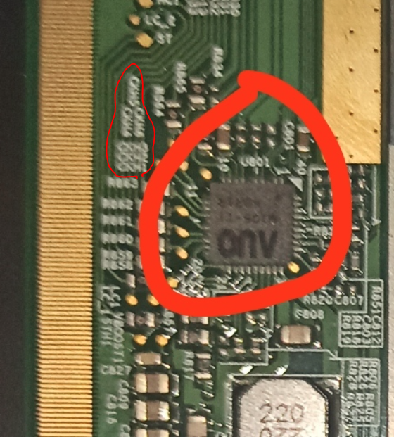

          Originally posted by Raulnn
          Thanks! No. I have disassembled the frame and it is perfect. The problem is with the tcon, DC DC converter area, but I don't know how to test if the converter is okay. the converter gets hot, the 3.3v and 1.7v test points are fine.
          show here photo of the circuit you mentioned and mark on it the part u said it get hot
            hello! In the photo there are several voltage reference points AVDD, VGL, VSS. these give incorrect values. however, the 1.2v and 3.3v benchmarks are correct. The supply voltage of that integrated is correct. I don't know if the problem is with that integrated part or with another component of that circuit.

              Can you help me? I don't know how to differentiate a problem in the DC DC converter, or in some nearby capacitor. the converter is very hot
                this is non DC /DC... contact AUO in Taiwan and give them the last photo you uploaded--- they will send you free of charge 8 ribbon set of COF need to replace... but you need to have 6000 euro coast of COF install machine.

                  Check the resistance of test points CKM1-CKM6 at the output of this chip relative to ground.

                    #29
                    Thanks. I have measured at the test point with a black ground terminal.
                    CKM1: 83,5 Kohms
                    CKM2: 1,8 Mohms
                    ​​​​​​​CKM3: 1,8 Mohms
                    ​​​​​​​CKM4: 1,6 Mohms
                    ​​​​​​​CKM5: 1,6 Mohms
                    ​​​​​​​​​​​​​​CKM6: 1,6 Mohms

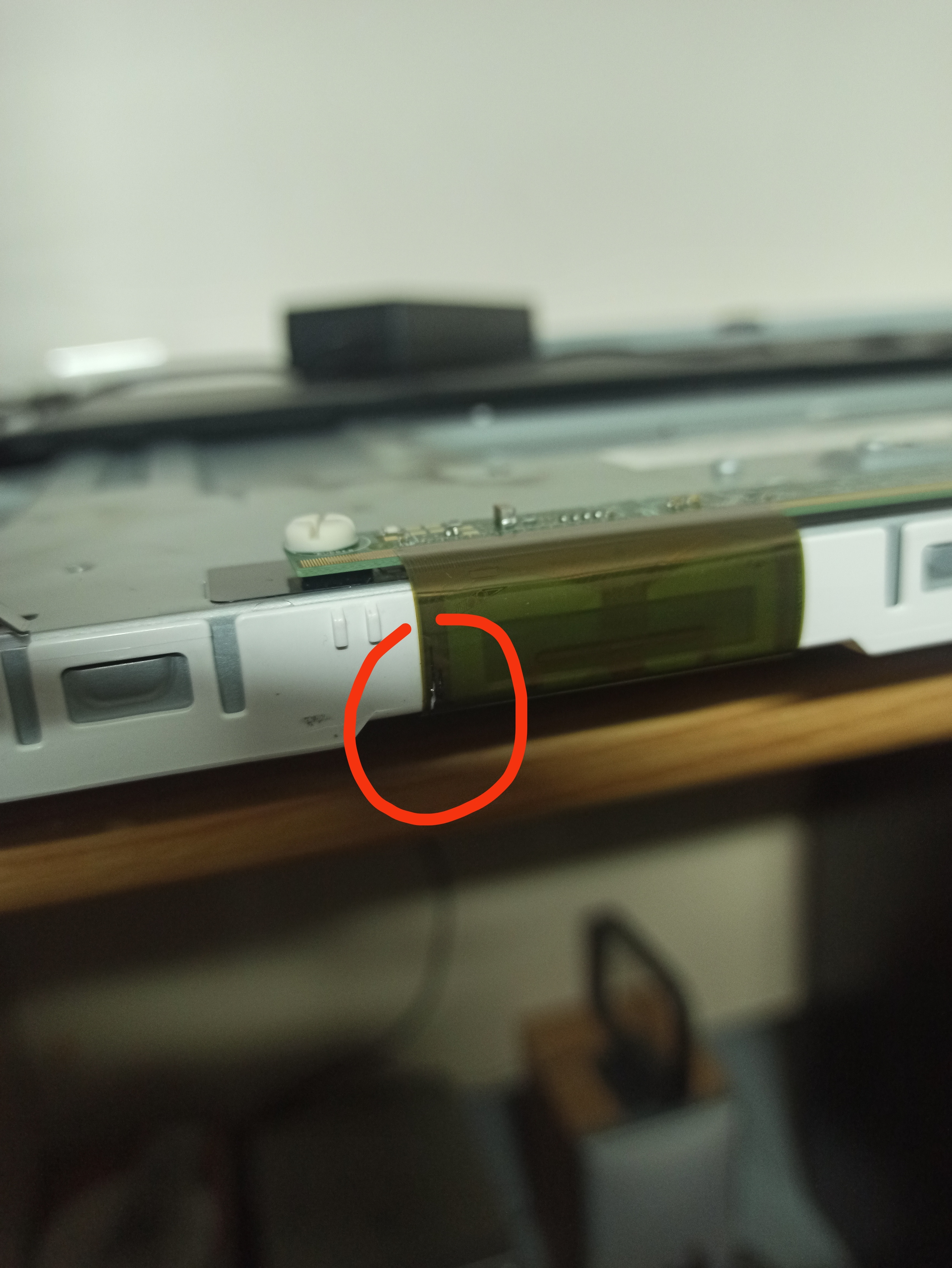

                        #31
                        riddle solved. A flex where the integrated hood is located is damaged. Someone did a bad job and ruined it.

                          thus you call it flex.... its the COF which Taiwan could send to you free of charge

                            #33
                            It's not the cof, look at the damage. but your hypothesis was the right one, because the fault is in the housing cof 😁

                              #34
                              because of the COF overload can also burn the lines on flex
