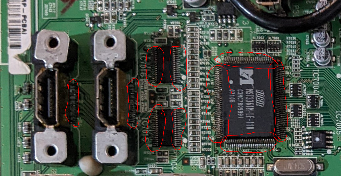

    This old tv had the caps replaced. It turns on and runs fine except for the hdmi. HDMI 1 will work just sometimes and HDMI 2 will not work at all. Did anyone ever come across this issue with this tv or would anyone know the best place to start?
    Проверьте пайку, предварительно очистите эти контакты кисточкой с илопропиловым спиртом, высушите и внимательно осмотрите эти участки через лупу; выводы не закорочены между собой и не припаяны к плате....

      Usual problem is the soldering of the HDMI sockets
    These are the exact areas i first covered with a magnifying glass. I fluxed all of the pins and just heated them with a soldering iron. Maybe i didnt go over them correctly. Any tips for me? Afterwards i checked for shorts and didnt see any.
