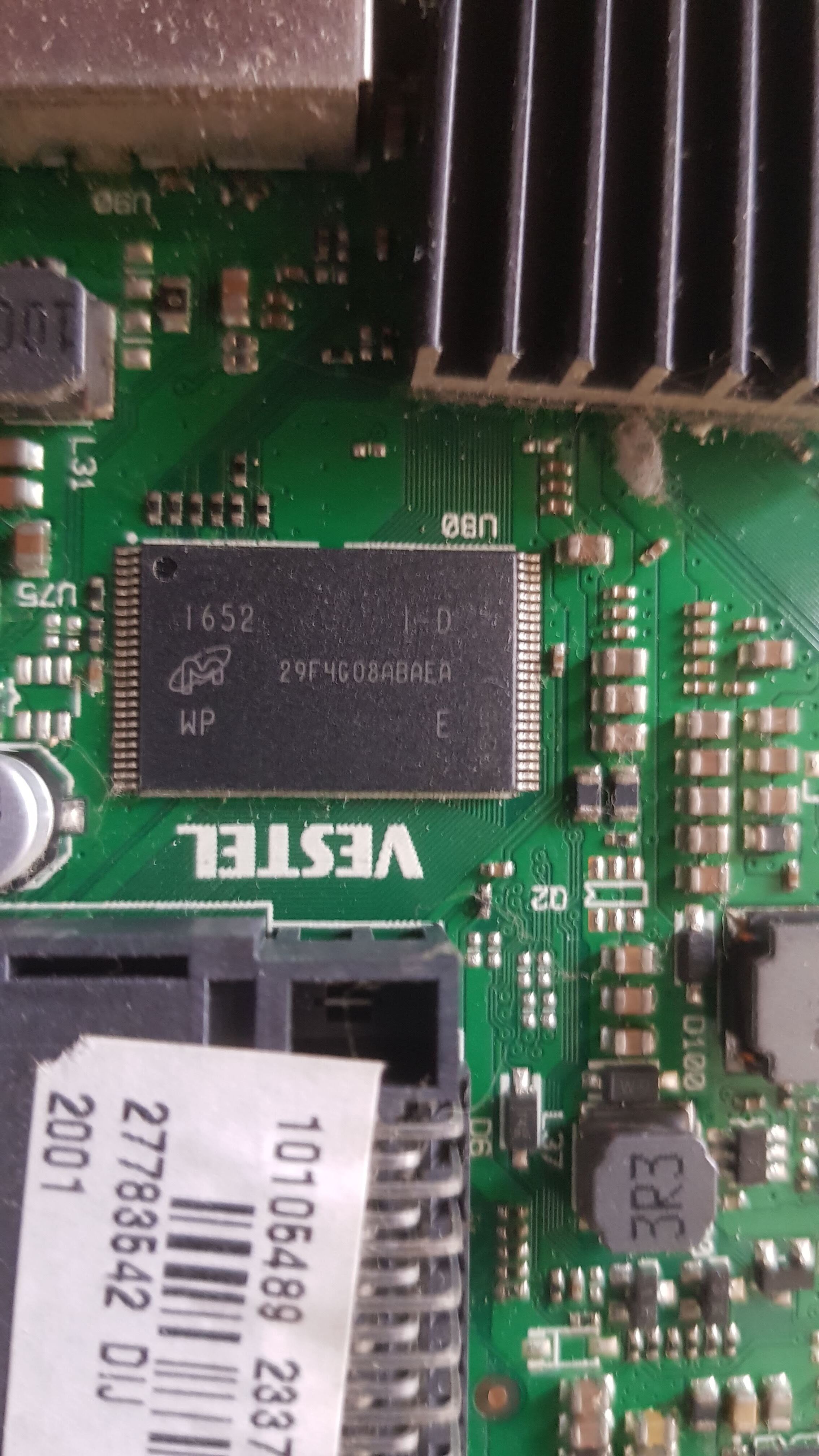

    My daughter's Finlux tv is stuck in standby, Red light blinking and goes off when power button is pressed.
    The required Voltage seems to be present to run the main board and it would seem its a firmware issue?
    I've looked all over to get the exact firmware with no avail, hoping some one here might some thing?
    PSU - VESTEL 171PS62
    29F4G08ABAEA U80 NAND

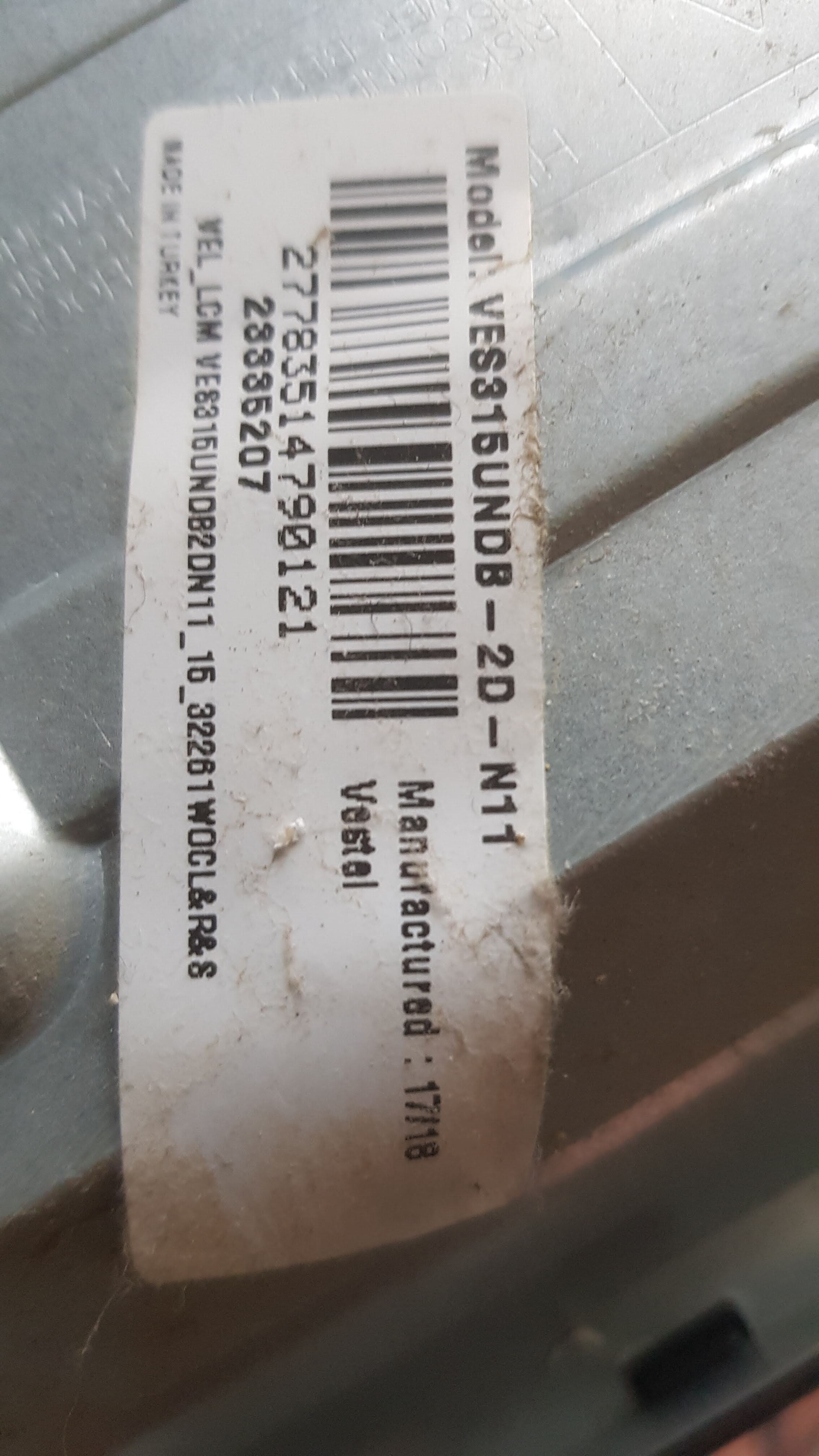

    Main board - 17MB110P
    Panel - VES315UNDb-2D-N11​

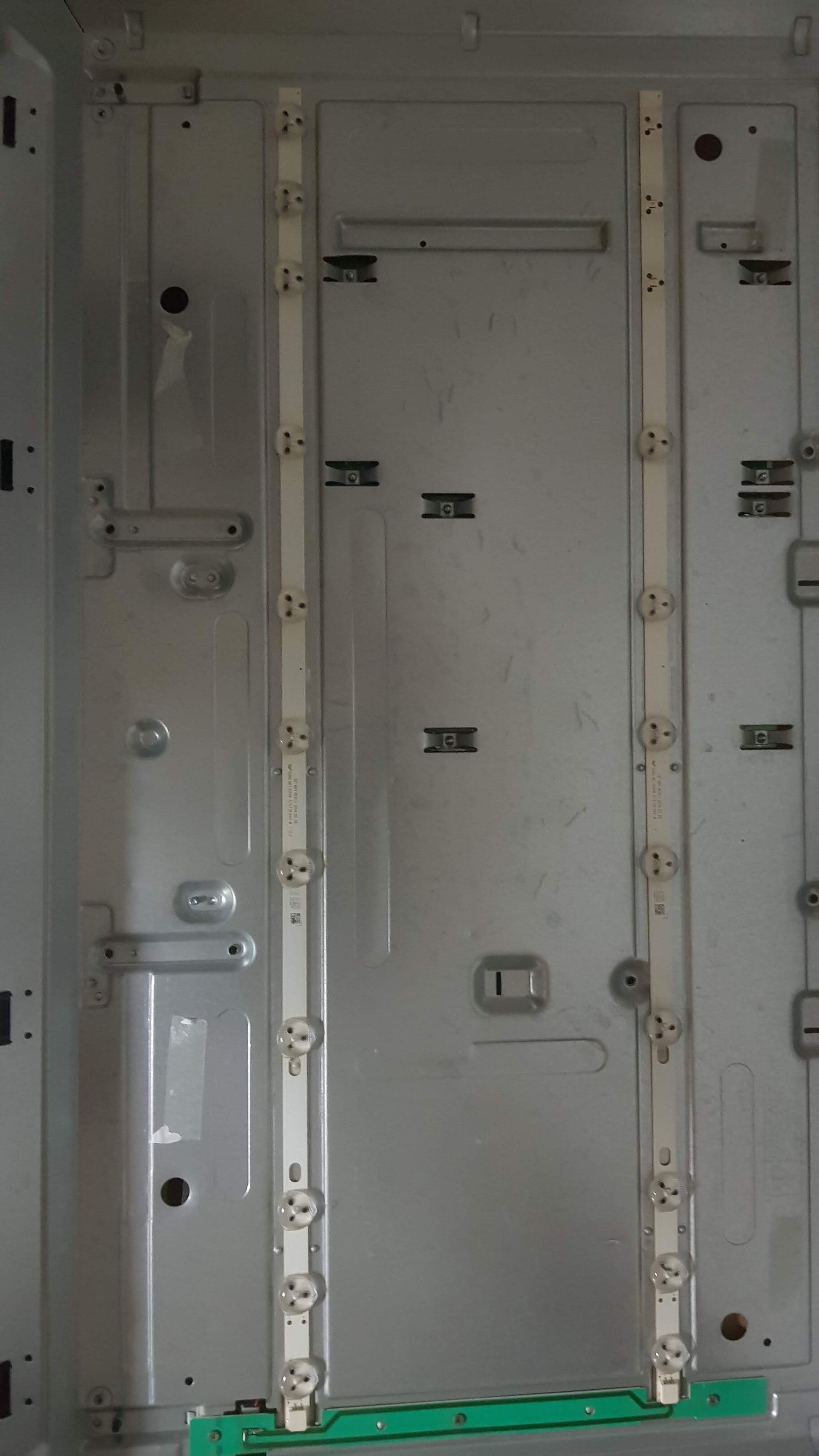

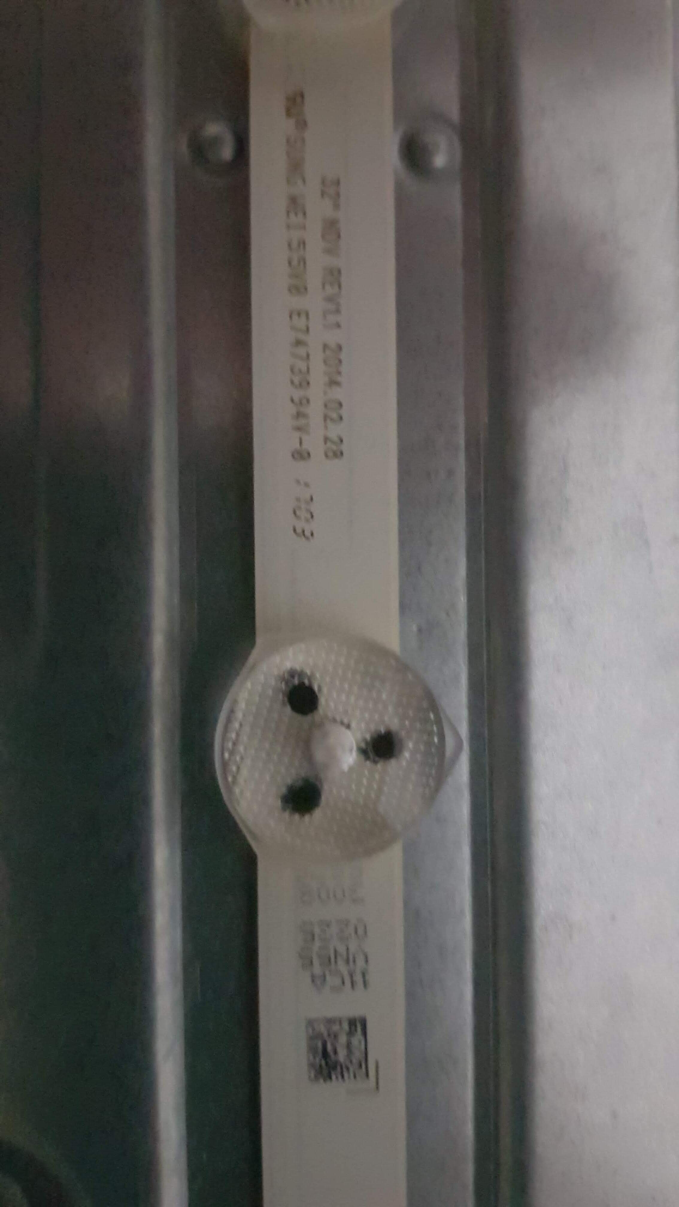

      I still believe the main board is at fault here because PWR_ON should give power at the led connector?
      I haven't seen leds like these before, some plastic lens caps fallen off,, real cheap set up!

        Check blon voltage not pwron.

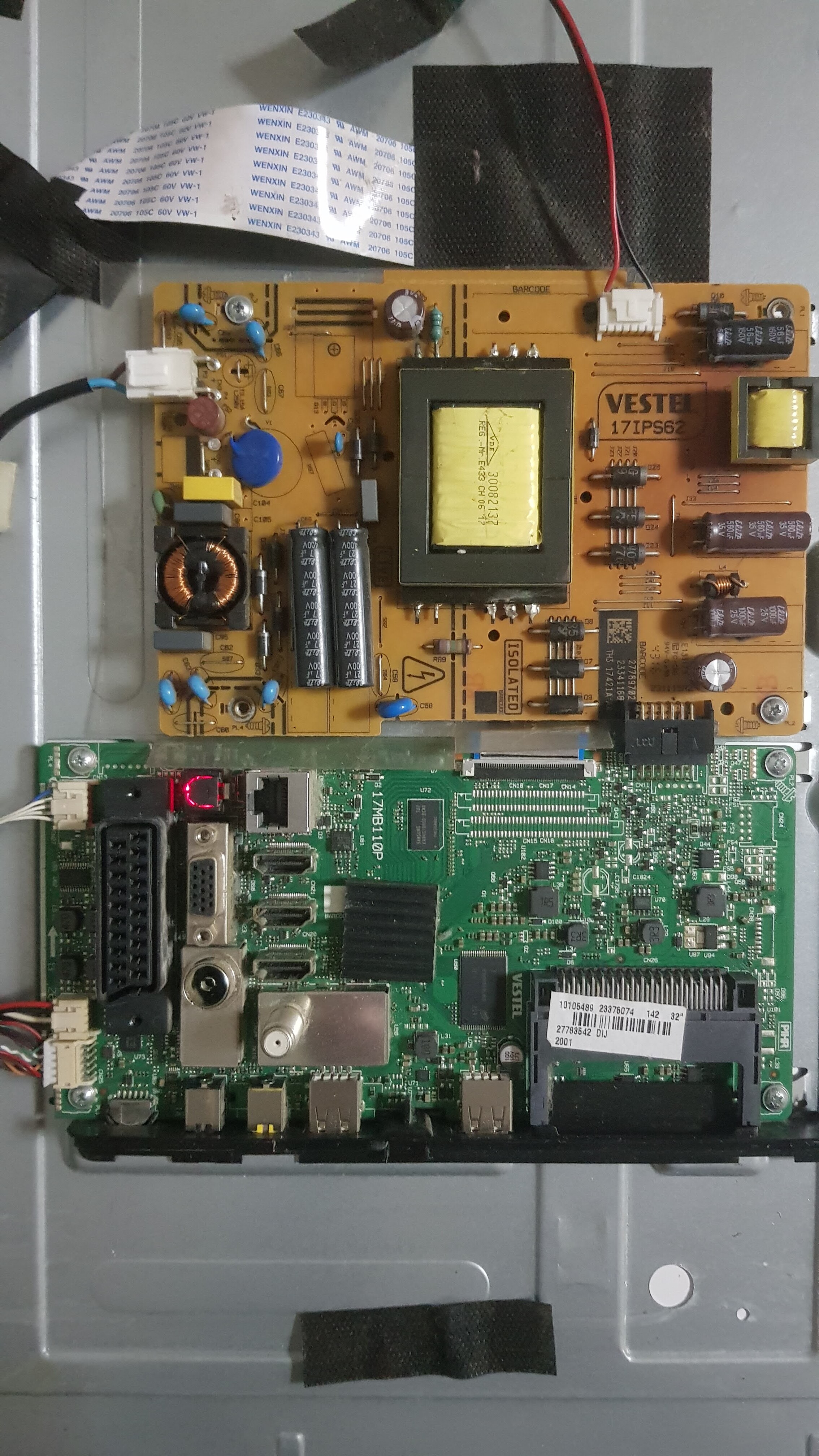

          BKL_ON/OFF has 12V on PSU + TP65 main board
          Might be U2 on PSU not switching?

        Checking the power board again I found D10 or D6 has 94V on the cathode and 30 on the Anode when the TV is on, in Standby 30V both ends.
        Not sure this is normal?

          A question for you have you tested the leds that illuminate the TV screen? As this would be my first thing to do before anything. These leds fail regularly on these Vestel manufactured TV's.

            Anyway the TV was what you mentioned in your comment - ' on some models it will flash briefly when power has been applied and will return to a steady standby led - On this model it does this until press ON with remote, the blink a few time and go off and you can see the picture with external light.
            After about 15 minutes it goes back into standby.
            As I mentioned I am re checking the PSU with the main board connected but removed from the TV chassis to determine is the back lights are receiving power or not.
            U2 has 12V at COM and 0V to the back lights PINS 8, 8 ,9 and 10 with and without the back lights connected. U2 could be shorted! OVP is also dead
            U4 will removed as it could be shorted, something my meter did not pick up cold testing.
            D6 will also be removed and C54

          This post is closed as a crack was found in the LCD panel .
