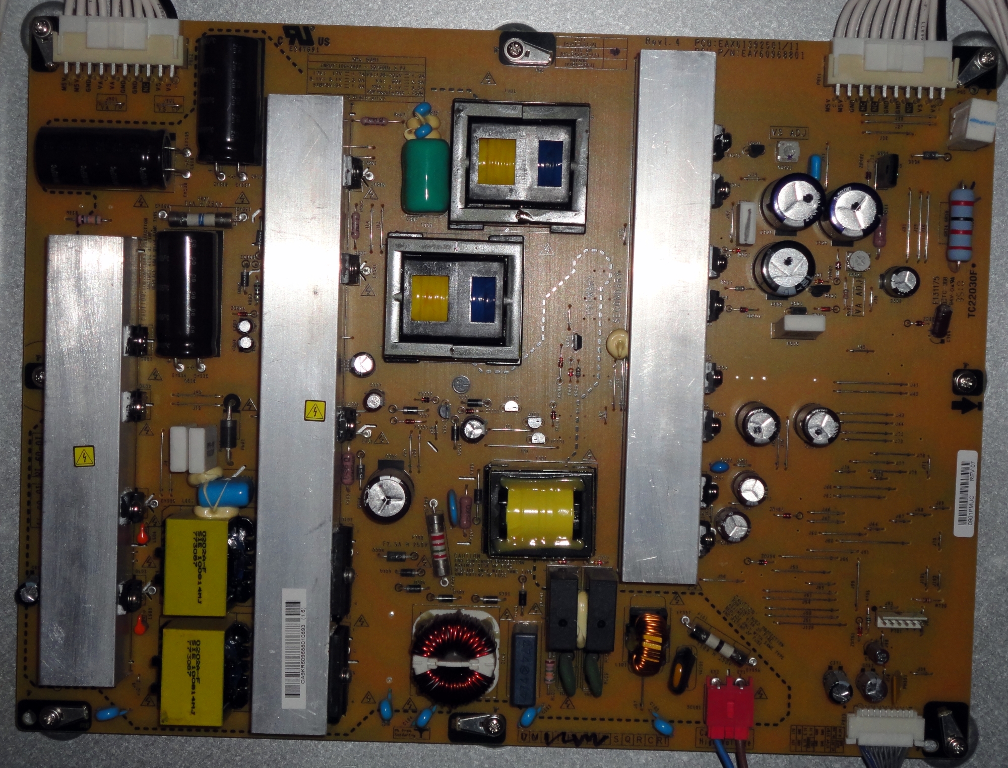

    I have a 50" LG plasma that cycles on/off twice then goes dead. When plugged up, you hear a relay click, then 1 second later, a picture displays for about 1/2 second, the relay clicks and the screen goes off. The tv then goes through the same cycle a second time, then it just goes dead. If I unplug it for a few minutes and plug it in again, it will go through the same cycle.

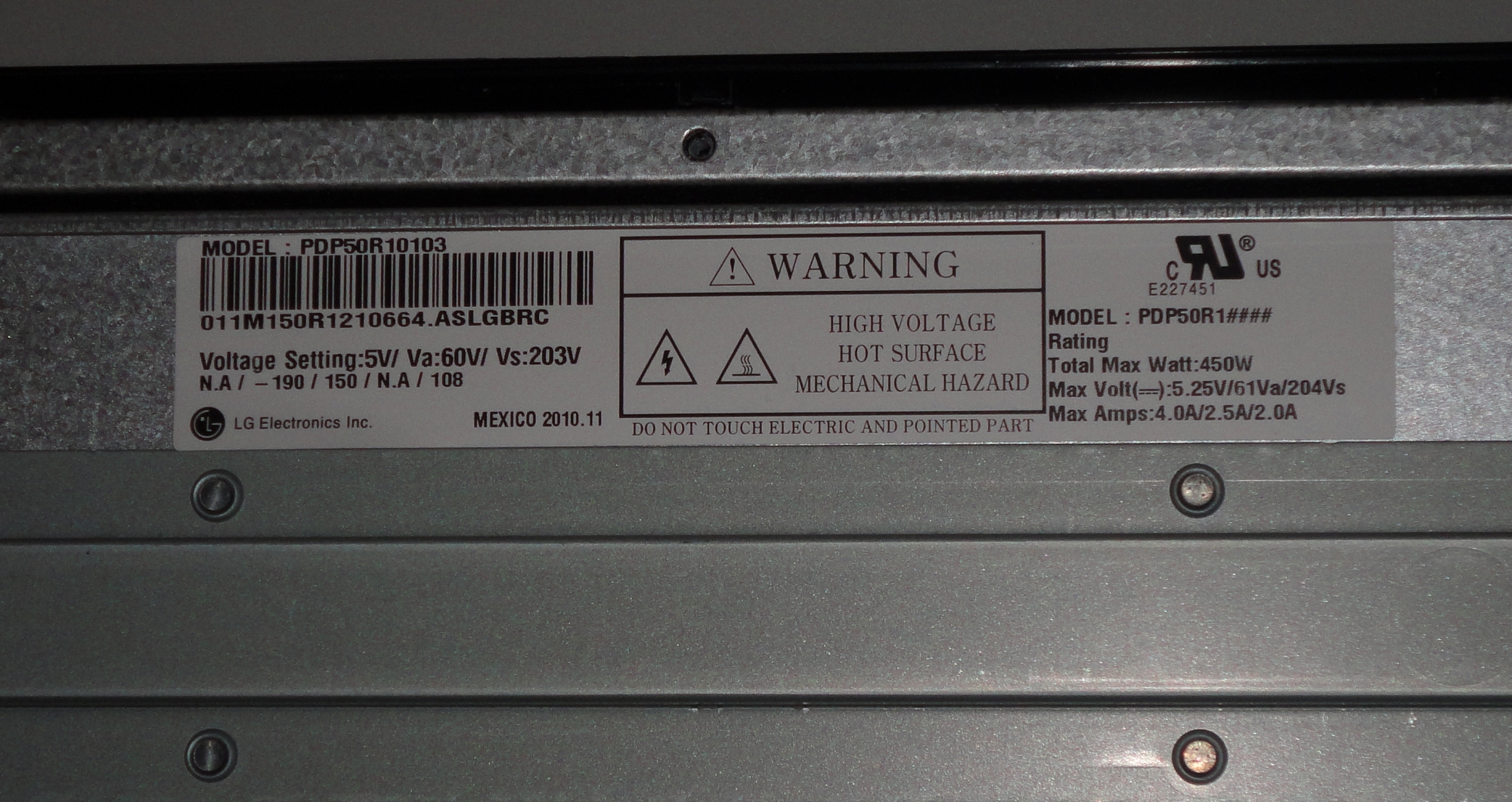

    The label says Vs should be 203 volts, and it is, for the 1/2 second the screen is on. When the screen goes black Vs starts decaying then goes back to 203 volts during the second screen-on cycle. After the second on/off cycle, Vs voltage decays rapidly to zero.
    Any help would be appreciated!

    Your issue sounds similar to this one: https://www.badcaps.net/forum/showth...hlight=50PK550
    LG Plasma Mal-Discharge Correction Service

      Using your suggestion, I tested the large 22 ohm resistors and one was shorted (arrow). I replaced it (cost $1.25) and so far it is running like a champ!
