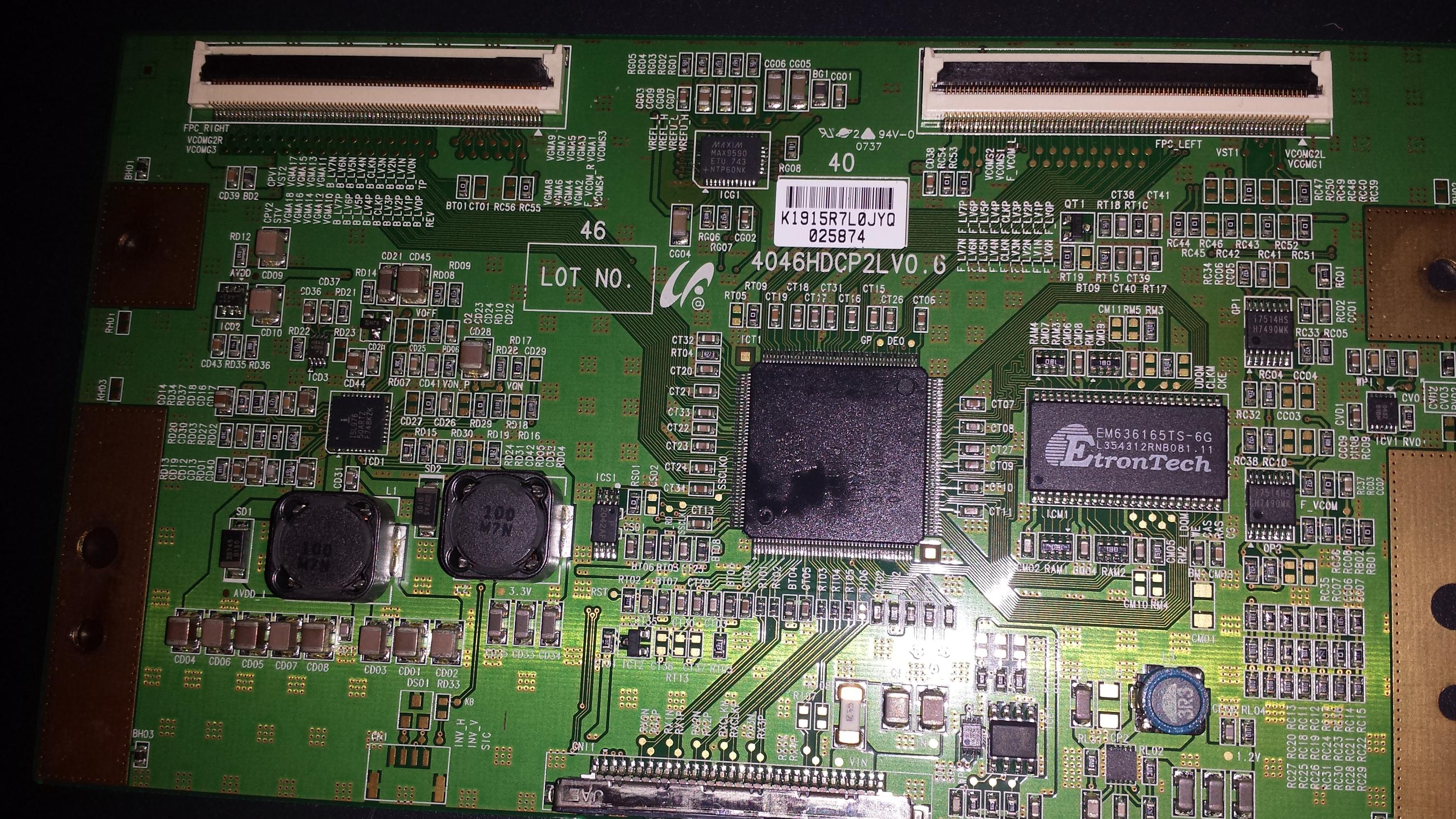

            Picture of t-con please.
              Re: LE40R88BD Black screen with backlight???
              here ya go ..
                On the left hand side of the t-con board, there are points marked AVDD_1, 3.3V, VON, VON_P and VOFF. What voltage do you measure on these? Red probe on test point, black on chassis.
                  Thanks tom66, Hope this info helps
                  AVDD_1 = 15.04DCV
                  3.3V = 3.36DCV
                  VON = 16.3DCV
                  VON_P = 20.9DCV
                  VOFF = 7.51DCV
                    The t-con appears to be working, at least on the power supply front. Try with only one of the LCD panel connectors plugged in (the two ribbon connectors at top.)

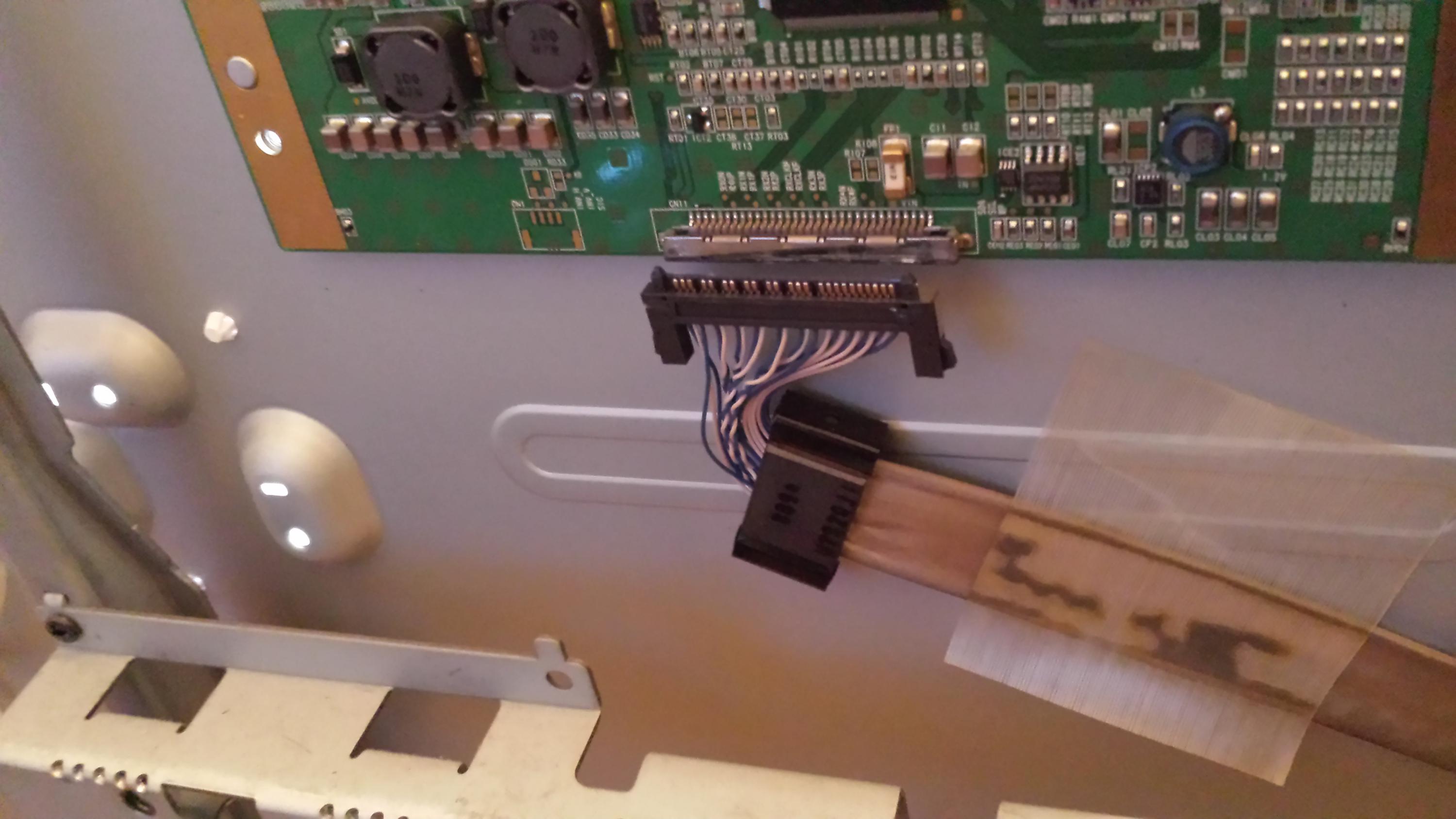

                        Hmm, OK, try with both panel connectors in, and LVDS missing. Full white screen?
                          Sorry mate i'm still learning.. What's LVDS,
                            The cable between the main and t-con.
                            LVDS = Low Voltage, Differential Signalling (the type of signal used to transmit video between main and t-con.)
                              Ok so i think ive removed the one you are talking about, took a pic to be sure, With this out i just get the same black screen with backlight???
                                I don't know what to make of that but I'm not certain if the fault is on the main or t-con. You can try to connect a source to the TV playing audio, just press SOURCE to switch through them and see if you get audio.
                                  Ah ha, Connected HDMI then pressed source button to find it, now the set is switching itself on and off and i hear a clicking relay with the red power led flashing randomly, doesn't appear to be any sort of repeating error code...??
                                    That sounds more like a main board fault than anything.
