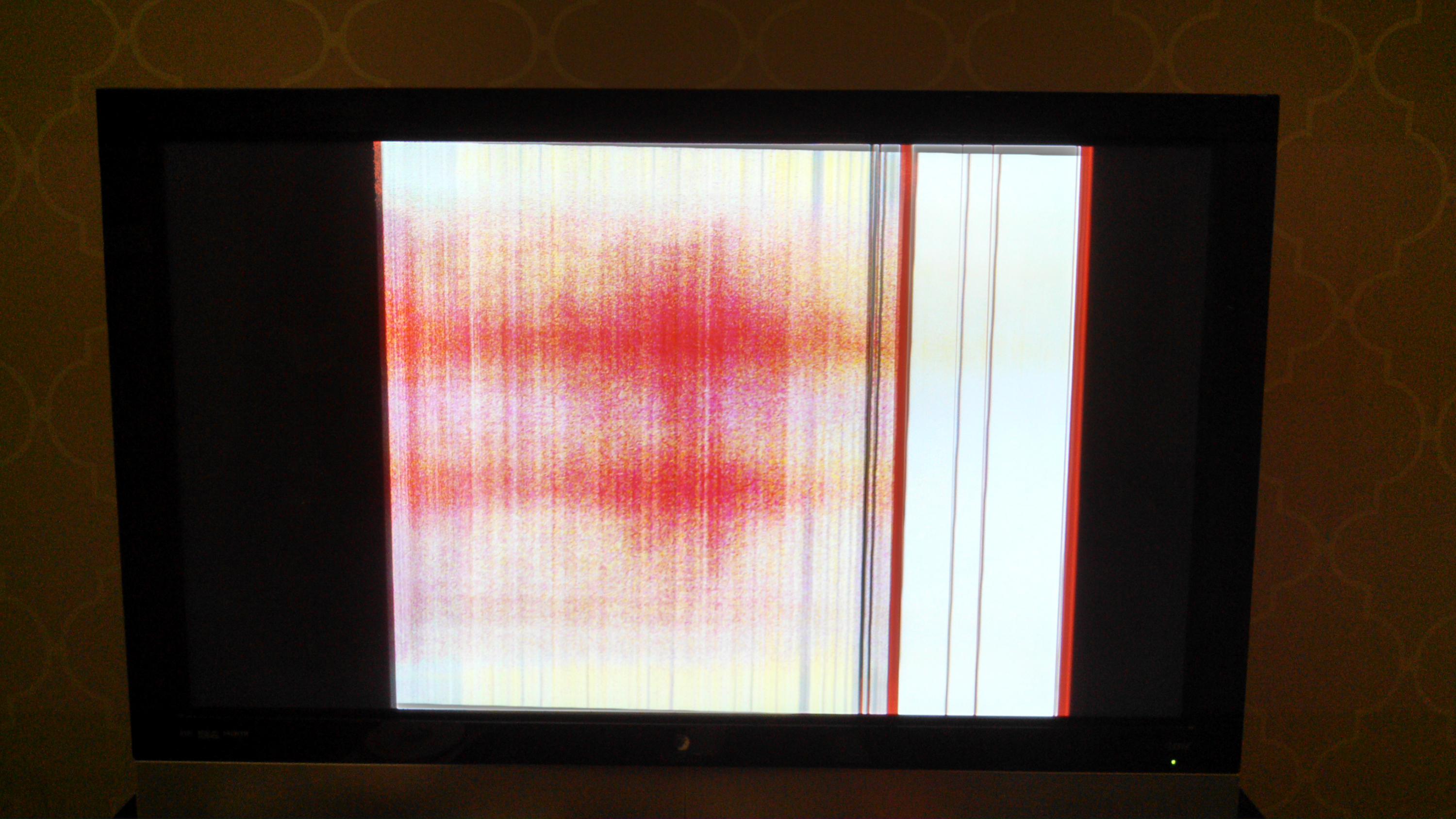

    I have a Vizio P50HDTV10A with this image displayed on the screen. Before this happened it would put a horizontal ghost image down one inch to three or four inches briefly when an image had a bright background over a darker one. Now it just has that image.
    Thanks,
    Kenneth

    Y-buffer board(s)

      One of them or both?
      Thanks,
      Kenneth

        Would it be one of the Y buffer boards or both and is there any test to check?
        Thanks,
        Kenneth

            Should I try one at a time?

              There are methods on the internt which describe how to test buffer boards
              http://blog.coppelltvrepair.com/2010...-lines-in.html

                Common fault is a blown FQB46N16 FET on one of the buffers.
                Ysus may be on its way out as well. I did a similar repair on the buffer and the tv came back to life but only lasted a couple hours before the same FET blew again... I replaced it again and put a heatsink on top of it, but this time the TV started showing signs of flicking picture (symptoms of a bad Ysus)
