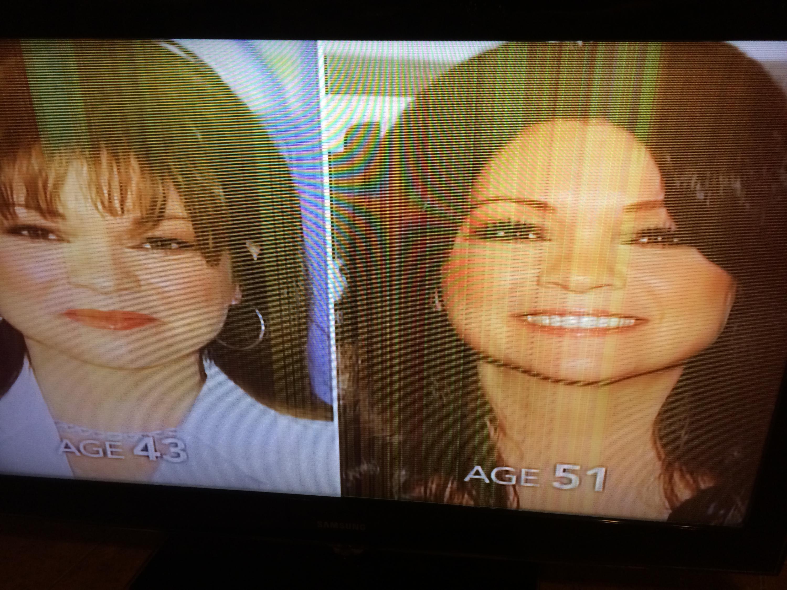

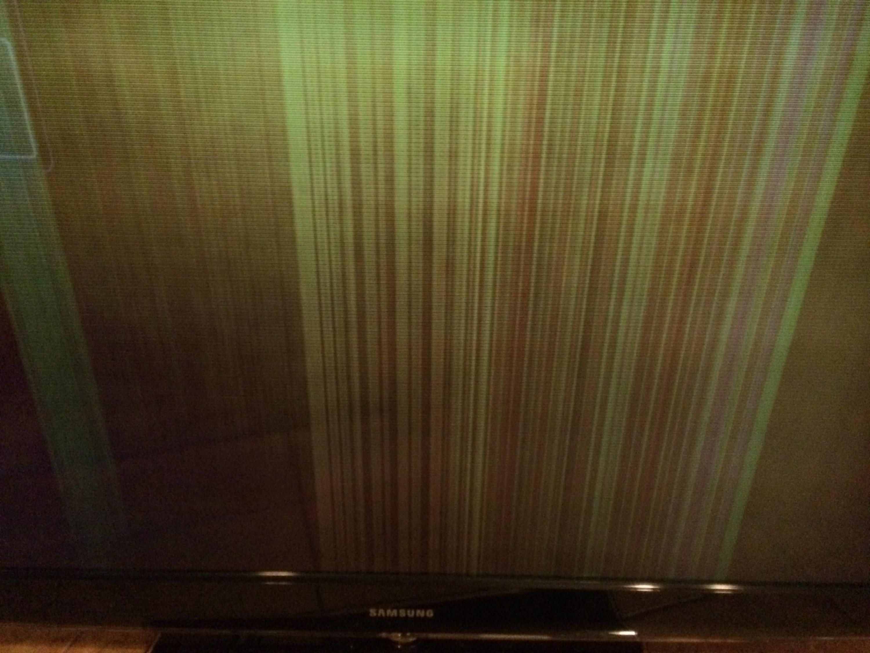

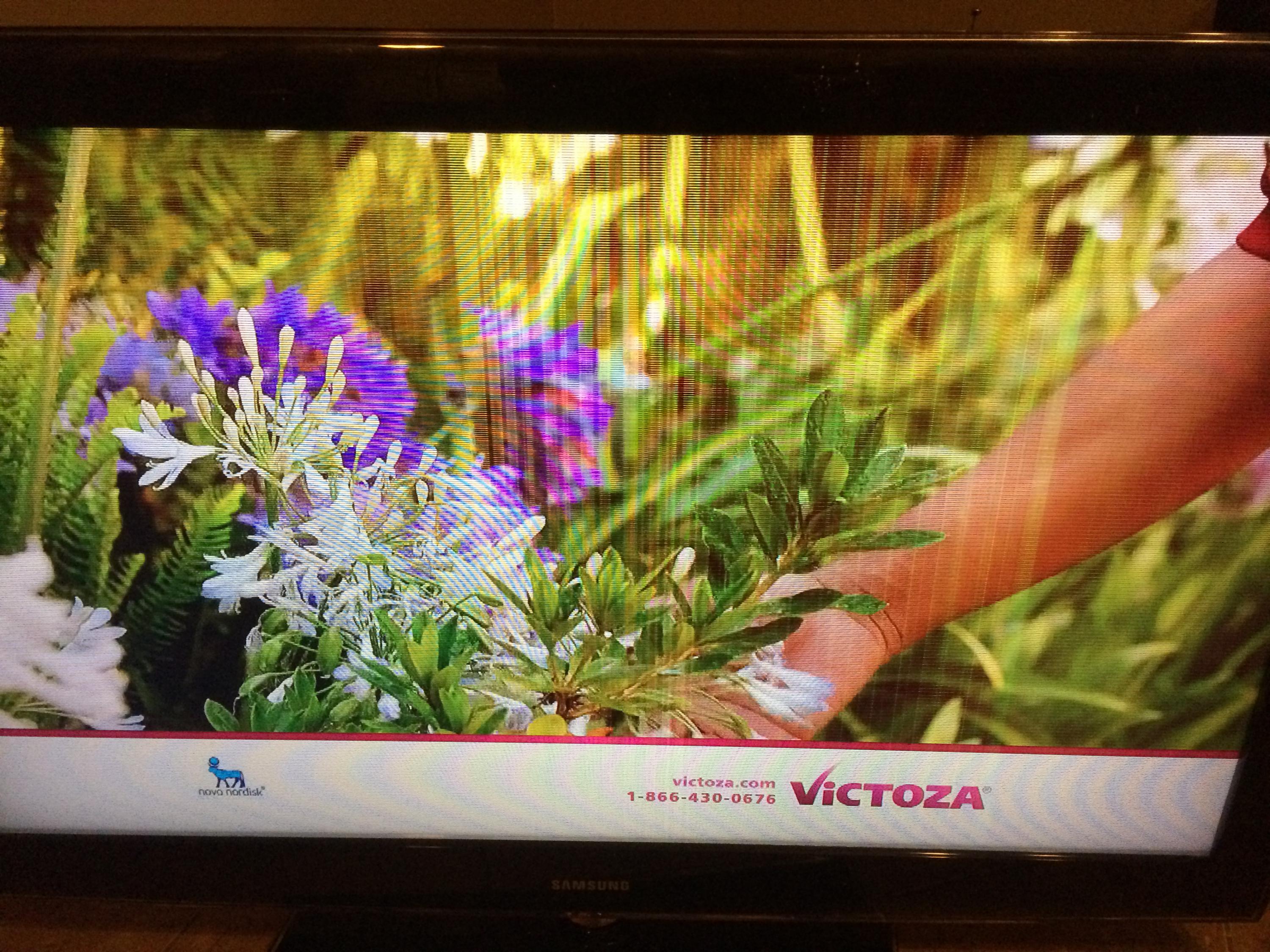

    I have the Samsung ln46b610a5f. Got it from my parents. One day it randomly started showing thing red/green/orange lines vertically. It gets worse up to 5 minutes after the TV is on. The picture can be seen. IE, i can see a show or whatever is on. Sound is great. I changed out the main board, T-con board, and inverter board. None of which helped. I have not tested the power board or anything? Help? I can send pictures soon.
    Re: Samsung ln46b610a5f Display Issue
    If switching the T-con and Main didn't fix it then you are looking at a bad panel.. sorry

        The pictures were just taken today. That black screen was taken switching between channels.

            Bad panel. Not yet aware if anyone has fixed this fault. It seems like it would be something temperature sensitive, but could be a leaky gate driver pulling the VGH/VGL low. In which case not fixable.
