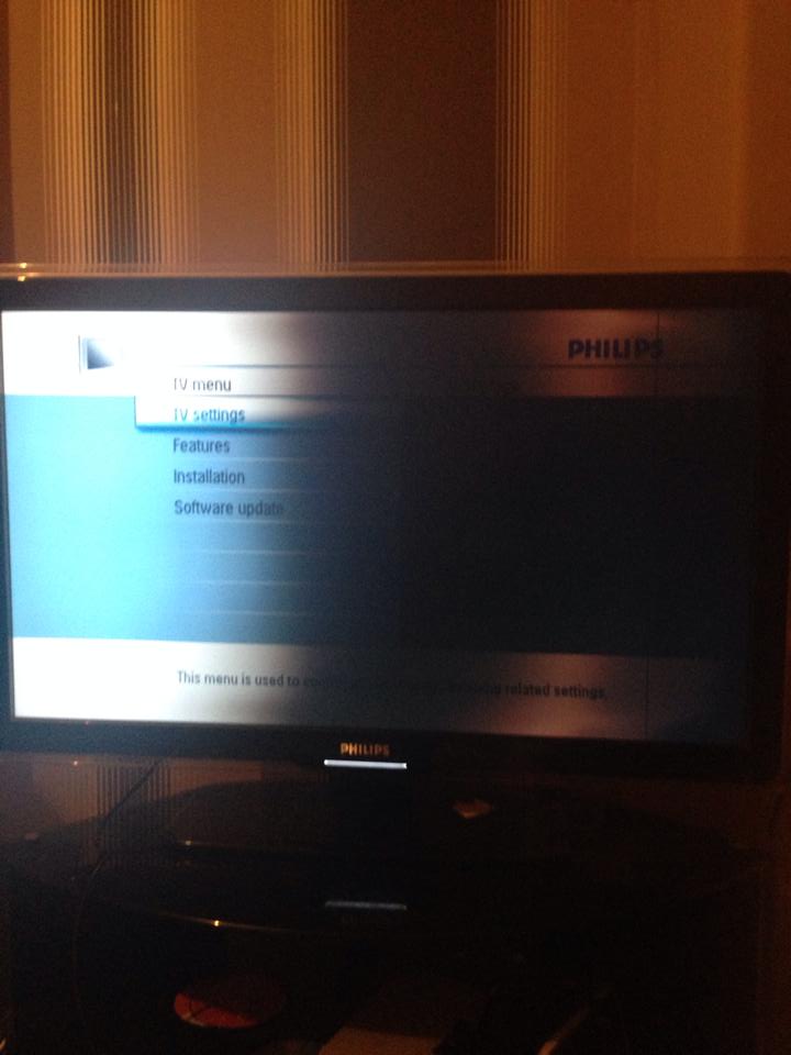

    Philips 42PFL7603D Losing brightness
    Friend is having problems with this set apparently parts of the screen lose brightness and go dim, sometimes it works fine and then goes like this and other times it's like this from start up.
    Power problem?
    sorry for the poor picture
    Re: Philips 42PFL7603D Losing brightness
    Panel tab bonds, sometimes repairable.

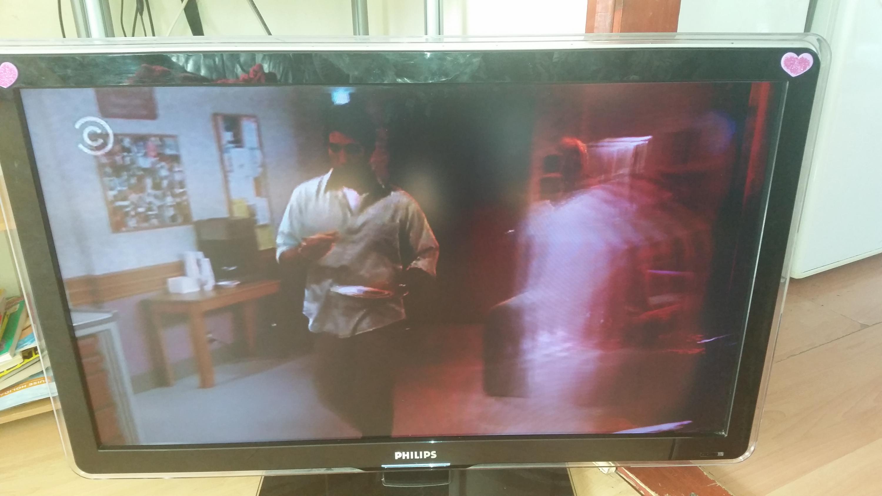

      sorry to hijack this thread but did you ever fix your problem
      got this set today where one side seems to be ghosting images and dark
        Definitely looks like a tab bonding fault...

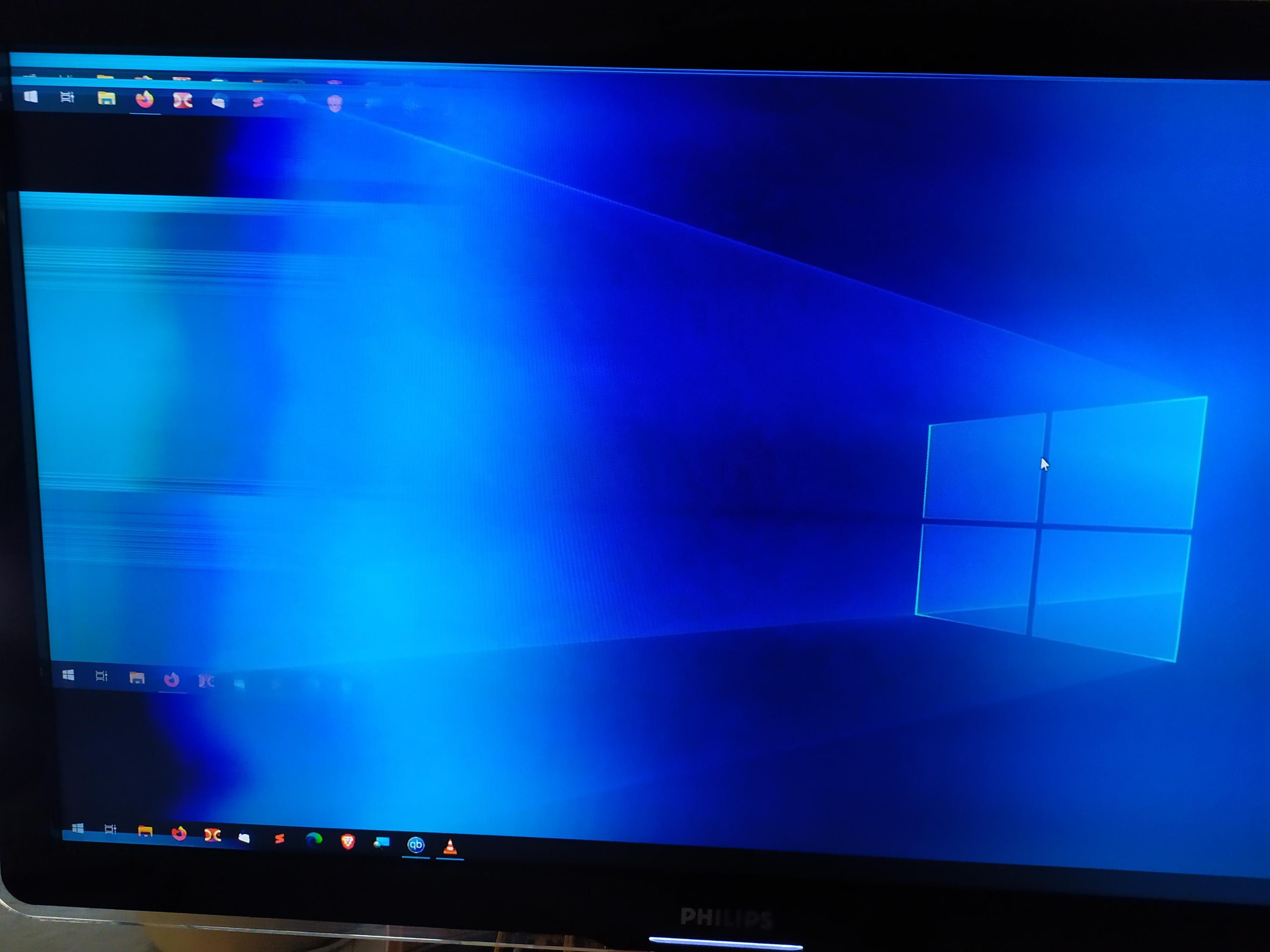

          Hello, did you manage to repair the fault? I think I have the same problem.
          • nomoresonys
            • Jan 2013
            • 12206
            • U.S.
            Probably a backlight issue, 15 years is a pretty good run for those leds.
            • Ta91Ko
              • Apr 2023
              • 3
              • Slovenija
              Don't think it is backlight problem due to image retention...
                      Something that you can try is take your knuckle and tap on the bezel NOT the screen, tap all along it, see if the display ever changes any, like clears up for a second or anything.
                      • Ta91Ko
                        • Apr 2023
                        • 3
                        • Slovenija
                        I tried the knuckle test, you were right. The screen does clear for a moment. Looks like it is bad tab bond contact. Is it possible to repair it?
                        • nomoresonys
                          • Jan 2013
                          • 12206
                          • U.S.
                          Here's a shim job done on a sanyo, he does all of them, I was lazy and just did the one that wasn't getting good contact but its working fine, I guess all the trouble it is to tear down, might as well do them all, there's a bunch more videos on youtube about the procedure, some use flexible tubing and such, just need something that's going to keep a little pressure on it for good contact and not damage it of course: https://www.youtube.com/watch?v=purk_SyiT44
