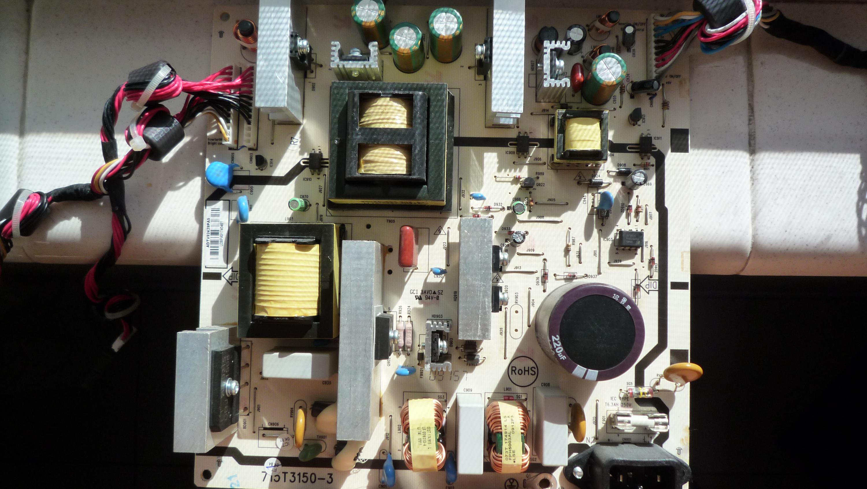

    A few days ago it started turning itself on and off, I would reset the cable box and it would be fine that night. Then I would wake up to hear the TV on. I took the back panel off and everything looks good. Next step is buying a meter to test some caps. I know this is a common problem, I'll try and get some hi-res pics up today because I have no idea what i'm looking for except obvious bulging caps. All the caps in this thing are capXom. Thanks for looking!

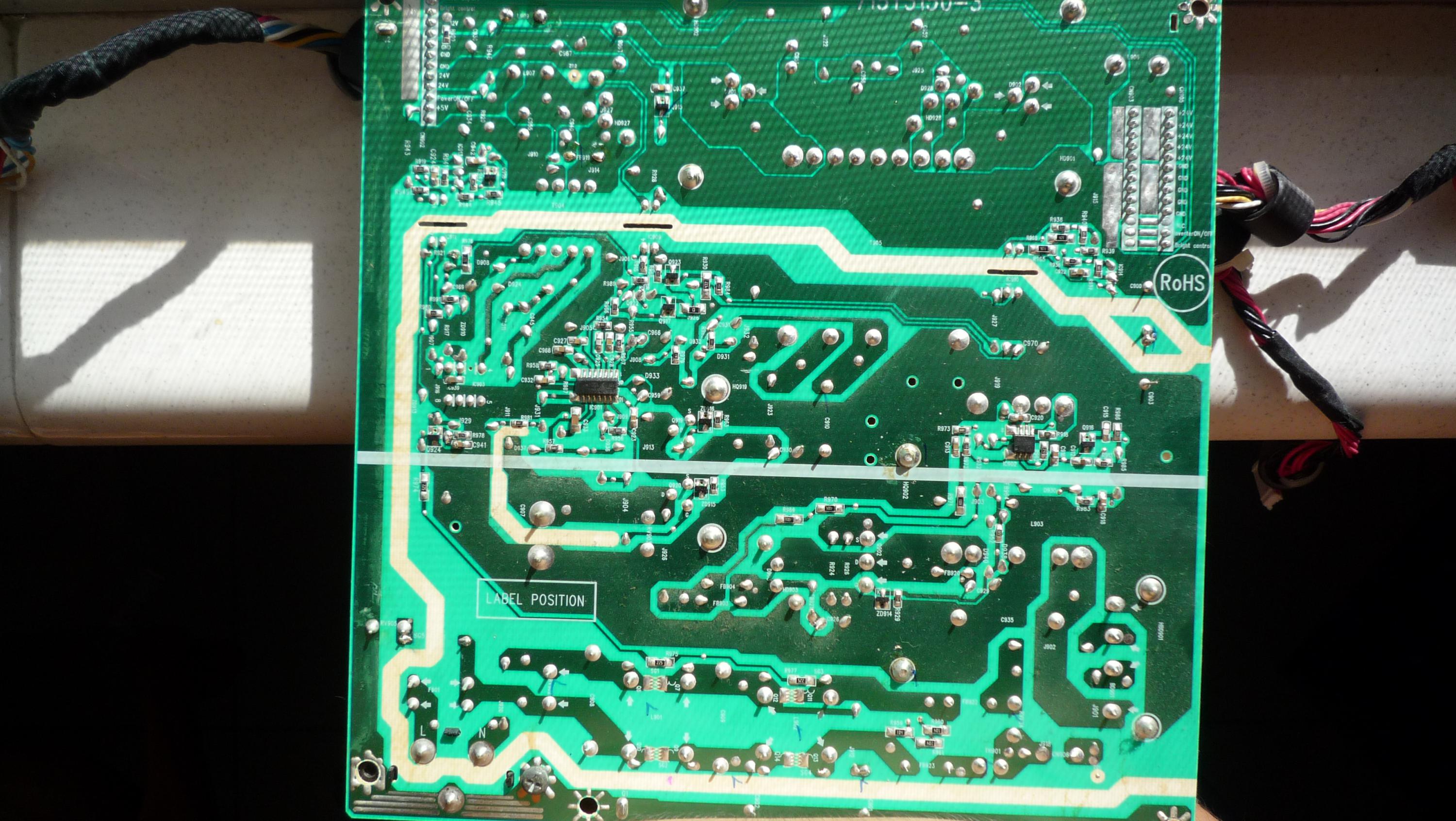

          Heres some hi res pics.

            what are the blue markings on the PCB? Is HQ902 an obvious Cold Solder Joint?

              I finally bought a MM and I tested the 4 big caps out of circuit and they are all reading at their stated values. Did some testing on the pins and the 5v standby by is reading 4.48v when the set if off, and 5.19v when set is on. The two blue wires which are 12v are reading 12.25v when on.
              Most of the caps on this psu are capxon, thinking about changing atleast the 4 bigger one.
              I read through this thread: https://www.badcaps.net/forum/showthread.php?t=18894
              My standby voltage is the same >5v , Since this set is powering on and runs for a period of time before turning itself on/off, i'm not sure if all the testing done in that thread apply to me. Thanks for any insight.

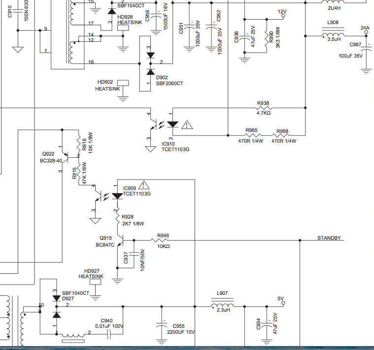

                Odd thing to me is that The Service Manual shows caps that are different than what are actually on the board. I'm a total newbie to this, so I dont know if this is common but heres a screen shot.

                  Ok, so I just did more research and realized there needs to be more effort put in to finding replacement caps. Turns out all the caps I bought are General Purpose, and I need to match the impedance,ripple and uf to a T if I can. Luckily I'm only out $7.50.
                  Can someone suggest if I should match the replacement caps with the ones that were taken off the board or with the values shown on the Power Schematic?
