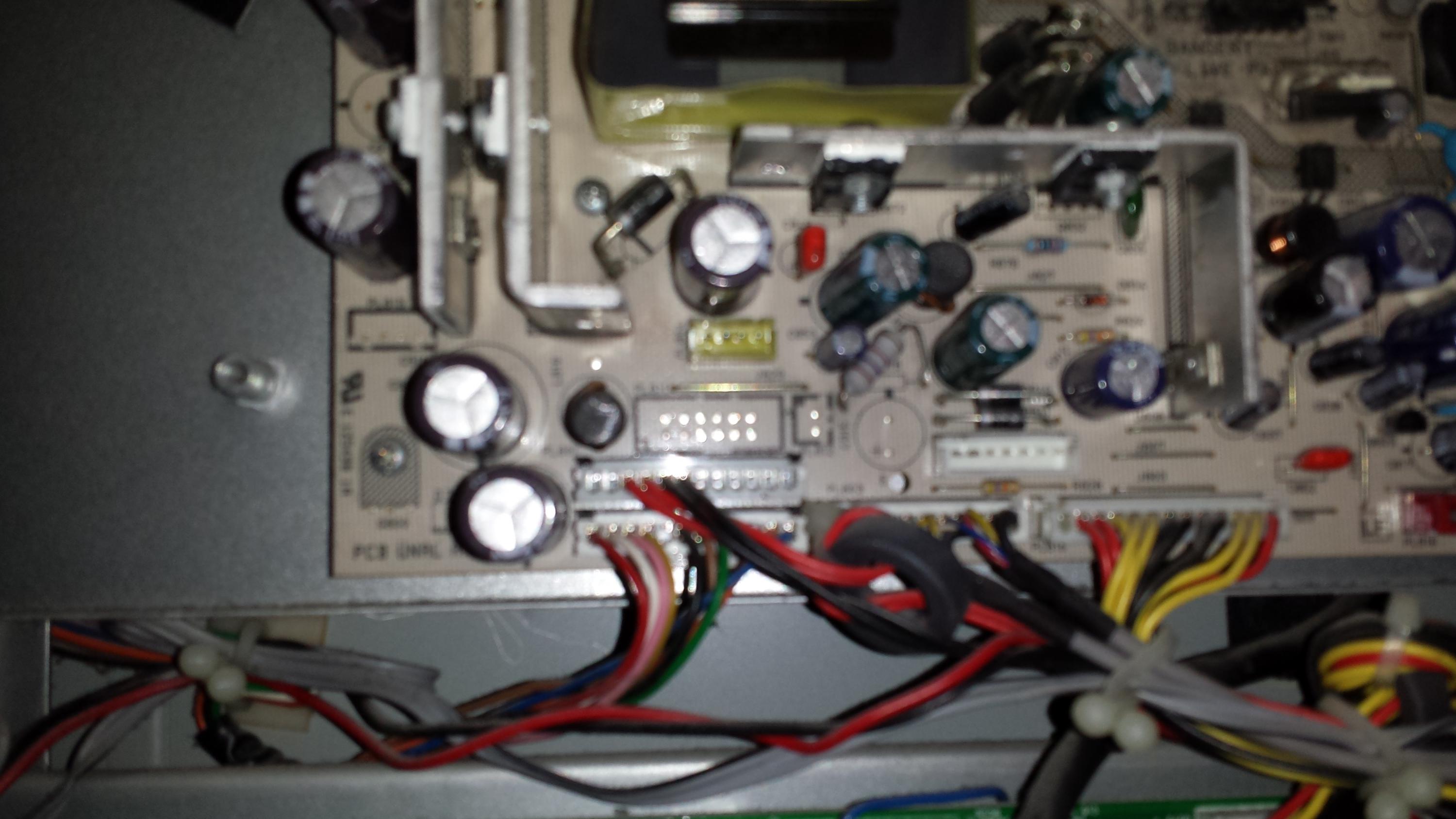

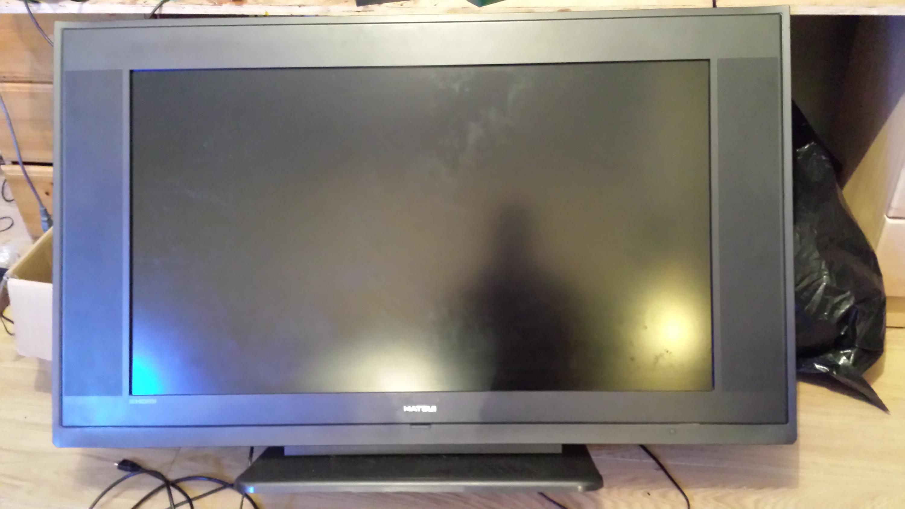

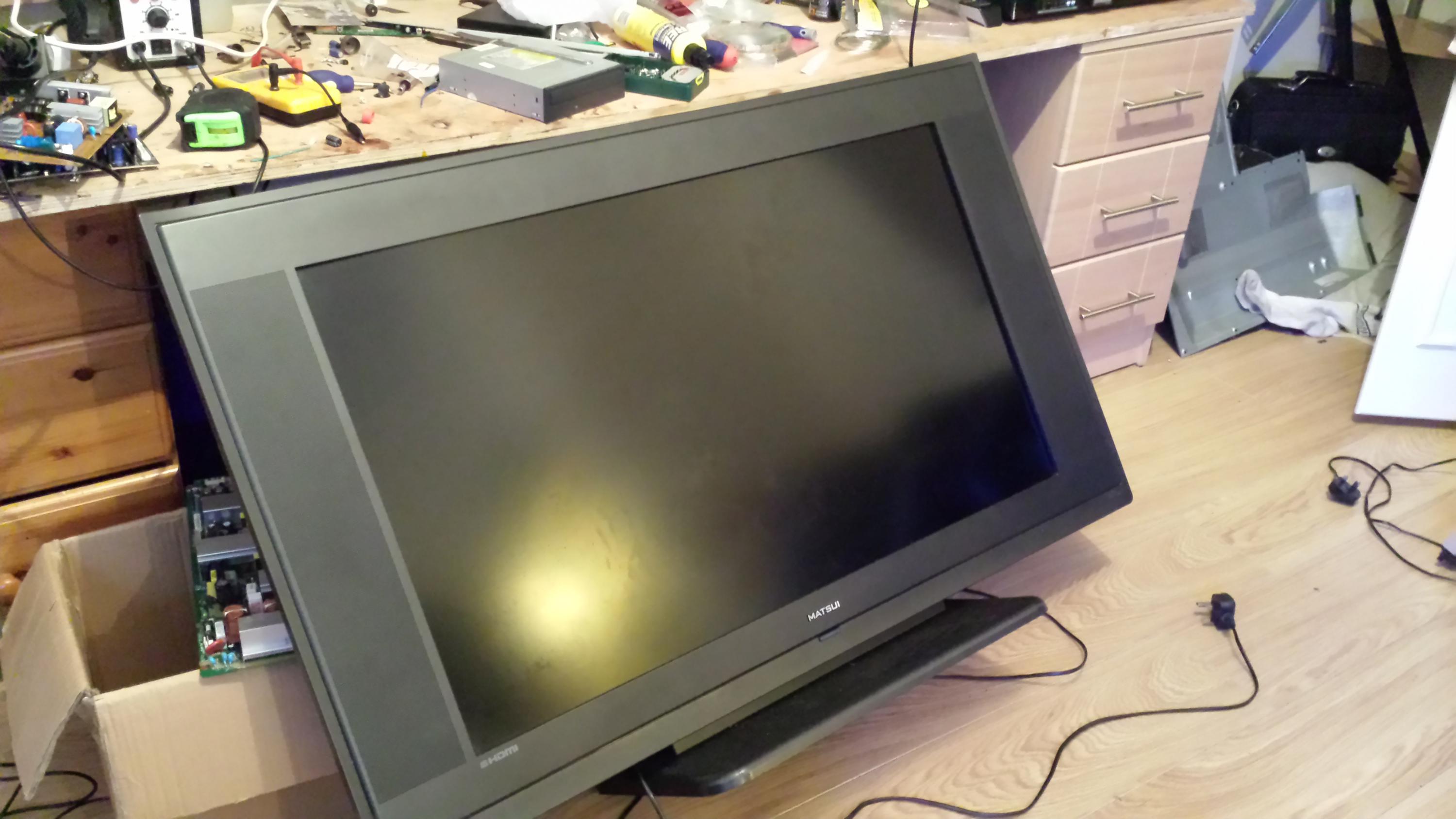

    Hi folks, I have this matsui 42 inch lcd tv, I am not sure about the model as the sticker has been damaged and is no longer readable, I have tested all the caps on the psu and they're all ok, What would be the next thing i should check which could cause this error?? Sorry I'm being a bit vague but i know nothing about the set and have no model number to search for common faults.. :-)

    Re: Matsui 42 inch LCD stuck on standby Blue light

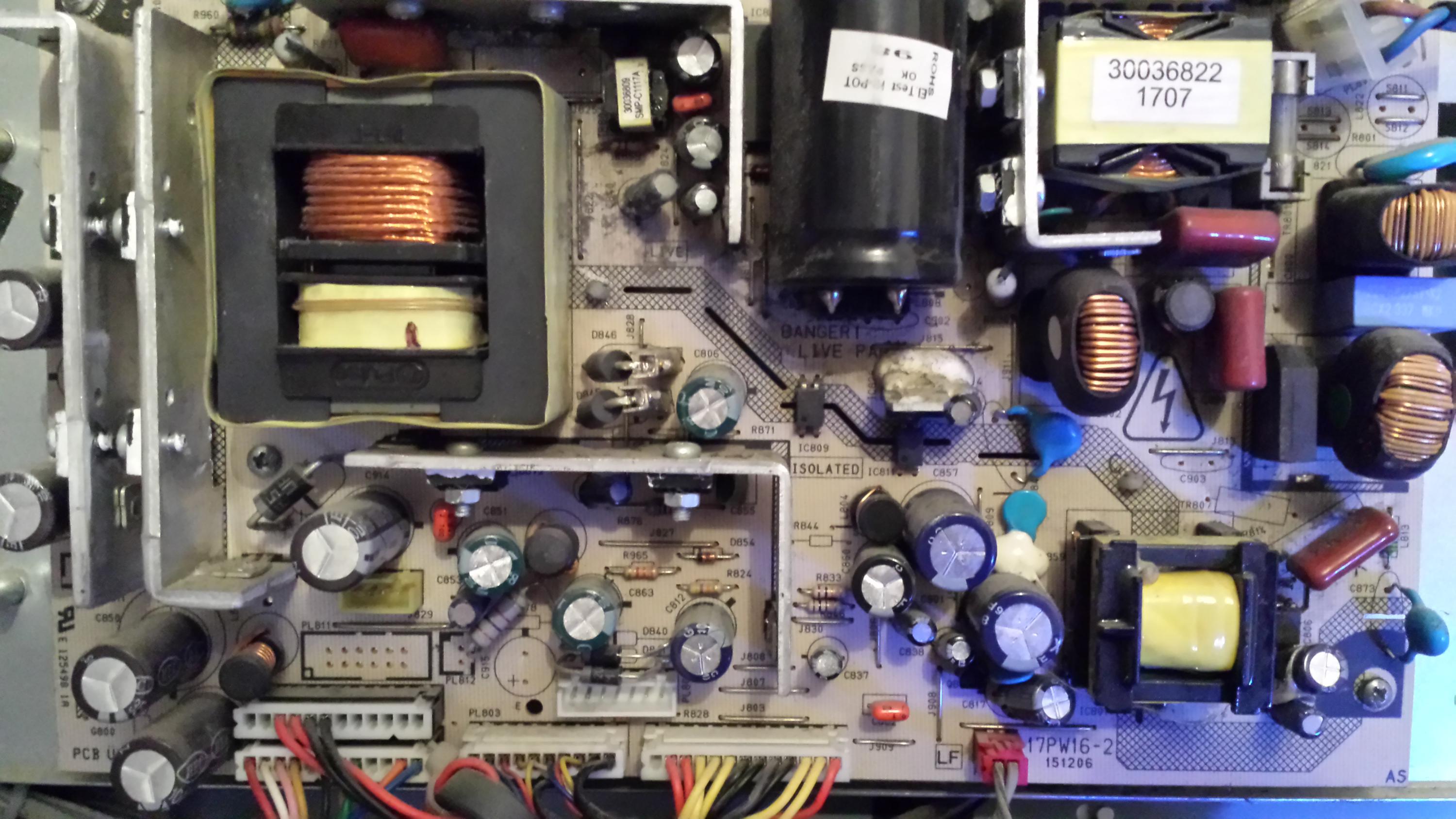

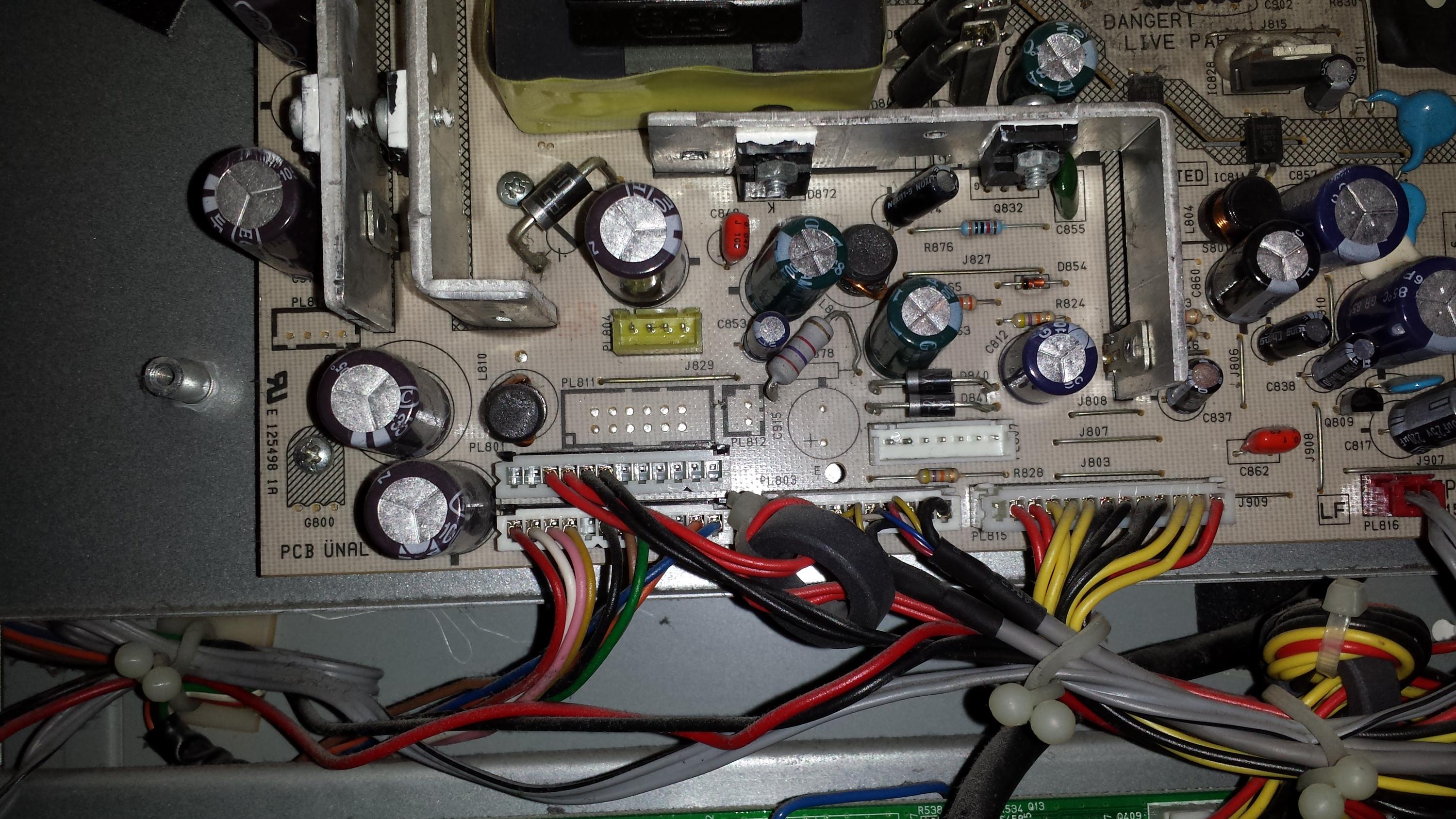

    is there any model numbers on the psu pictures of the back of the set showing all the boards may help us reconise it.
    • Easky15
      • Sep 2013
      • 285
      • Ireland
      Hope these help..

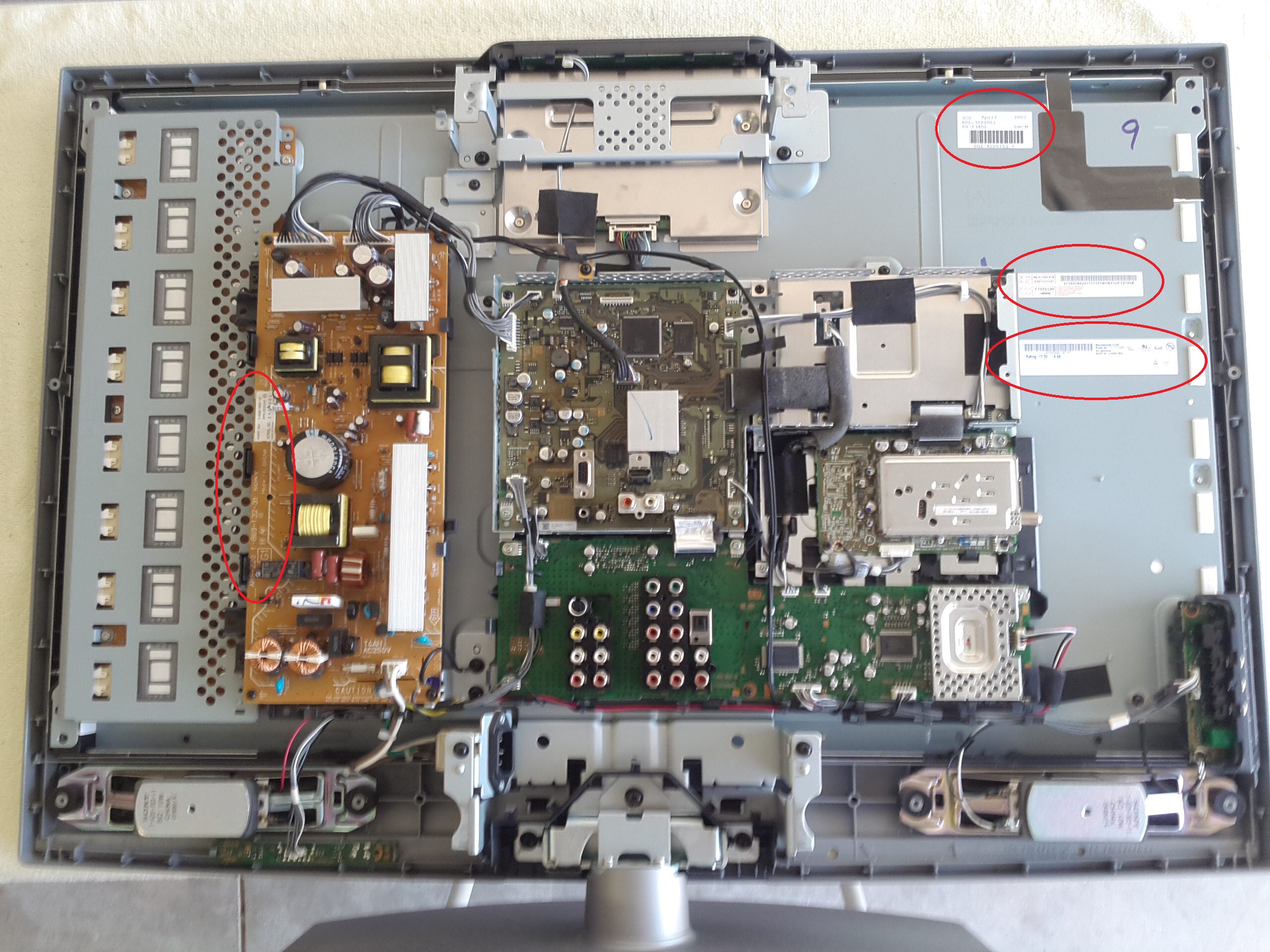

        That's OK.
        Inside the TV (remove back cover) there should be a set of stickers affixed to the panel - similar to this one (see pic).
        On one of them will most probably have the model # and/or the panel id #.
        If you can't find it, just post the power supply part # (stamped on the board).
        If you could take a photo of both the stickers and the power supply board, that would be great.
        • newtothis
          • Mar 2013
          • 1556
          • england

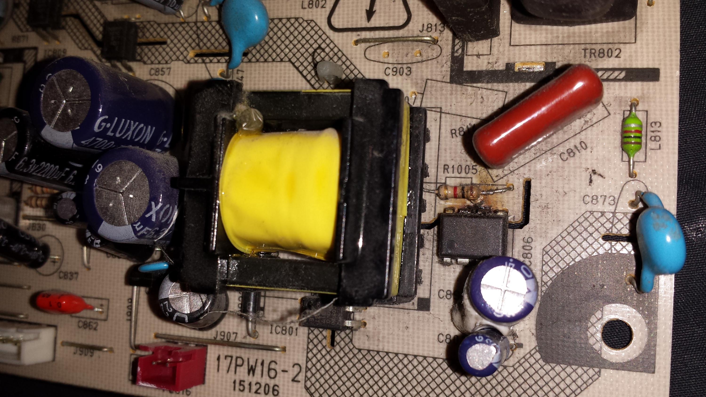

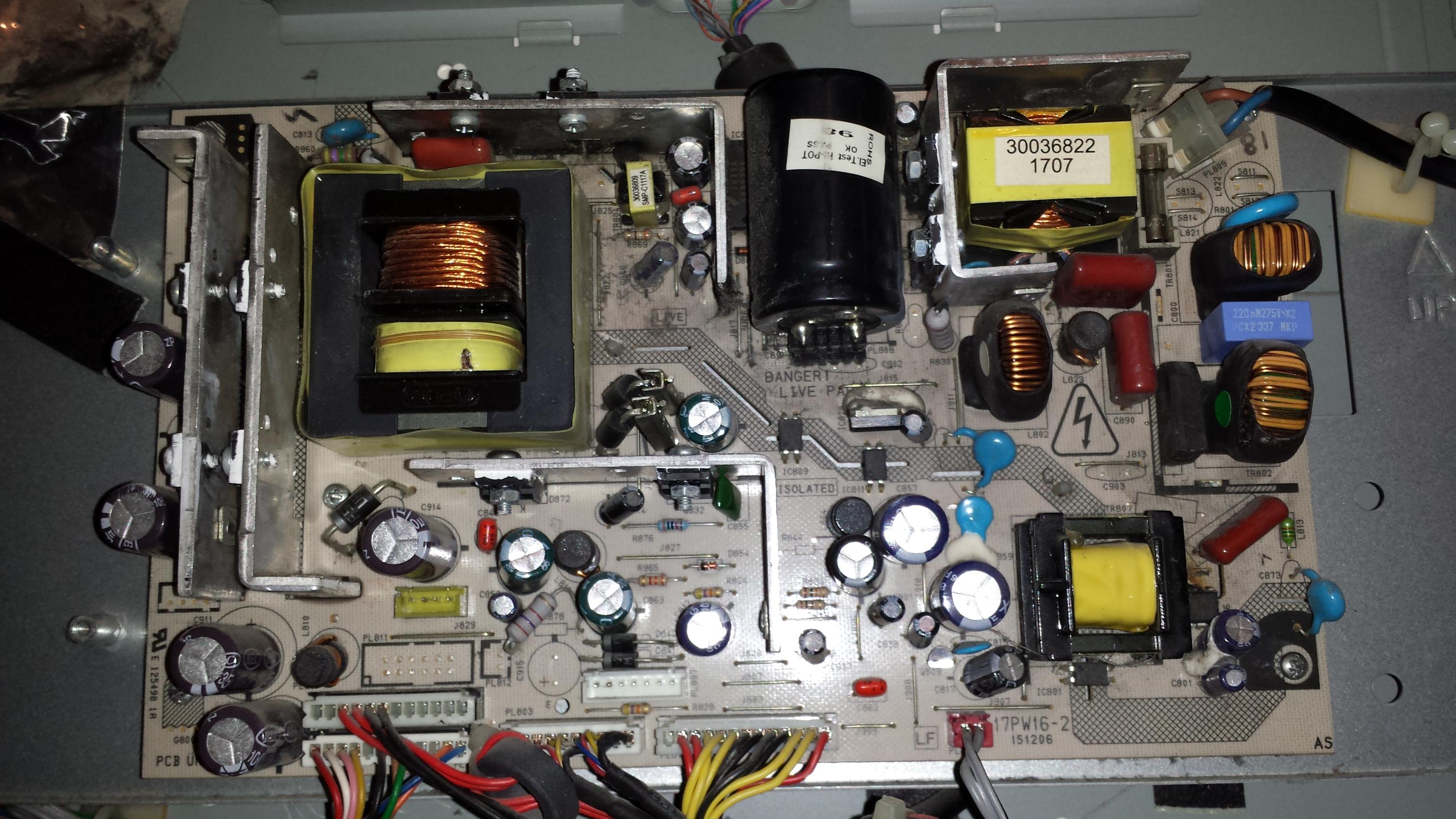

          That is a Vestel PSU 17PW16-2
          Its pretty much the same as the PW15.
          Common fault is C877 C878
          But check :
          IC829
          Q809
          C877*
          C878*
          C817
          C892
          C801
          C901
          R817
          R818
          R819

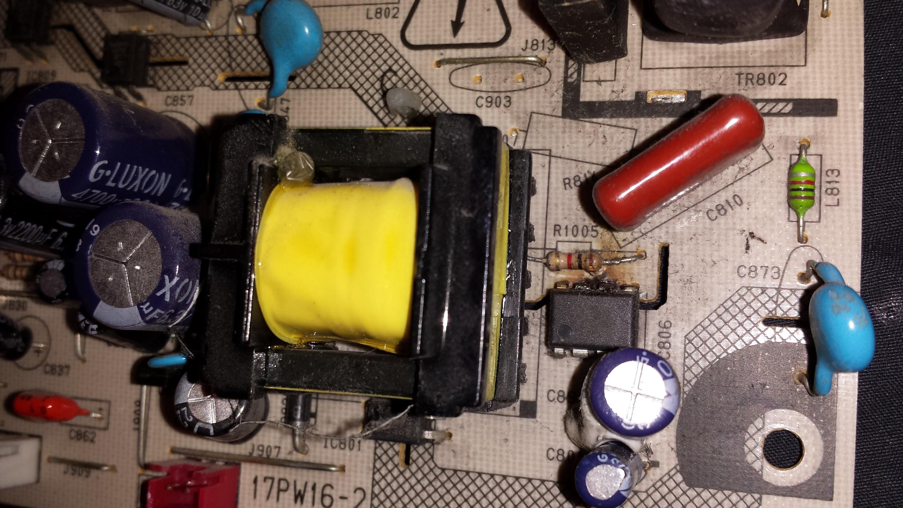

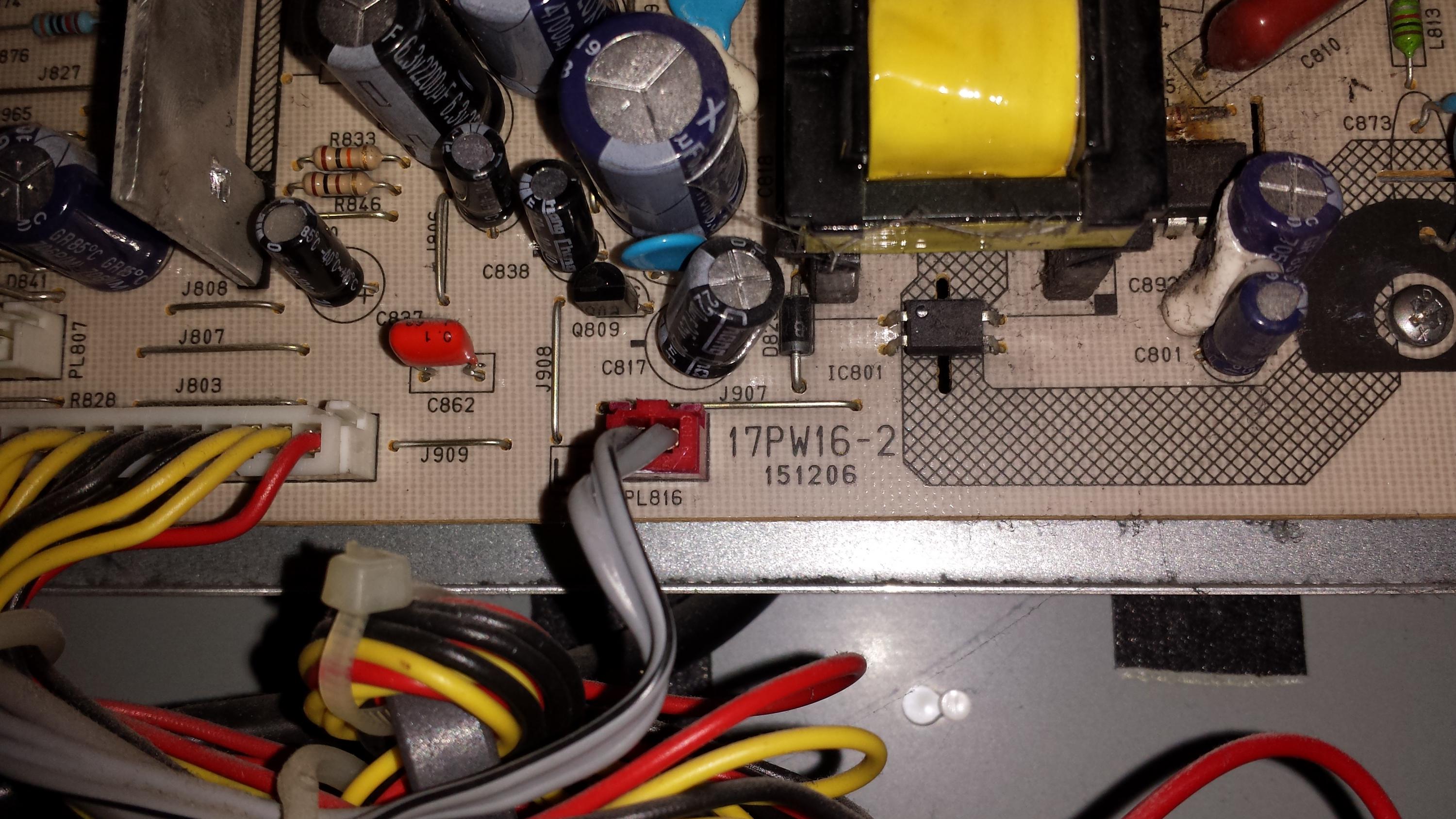

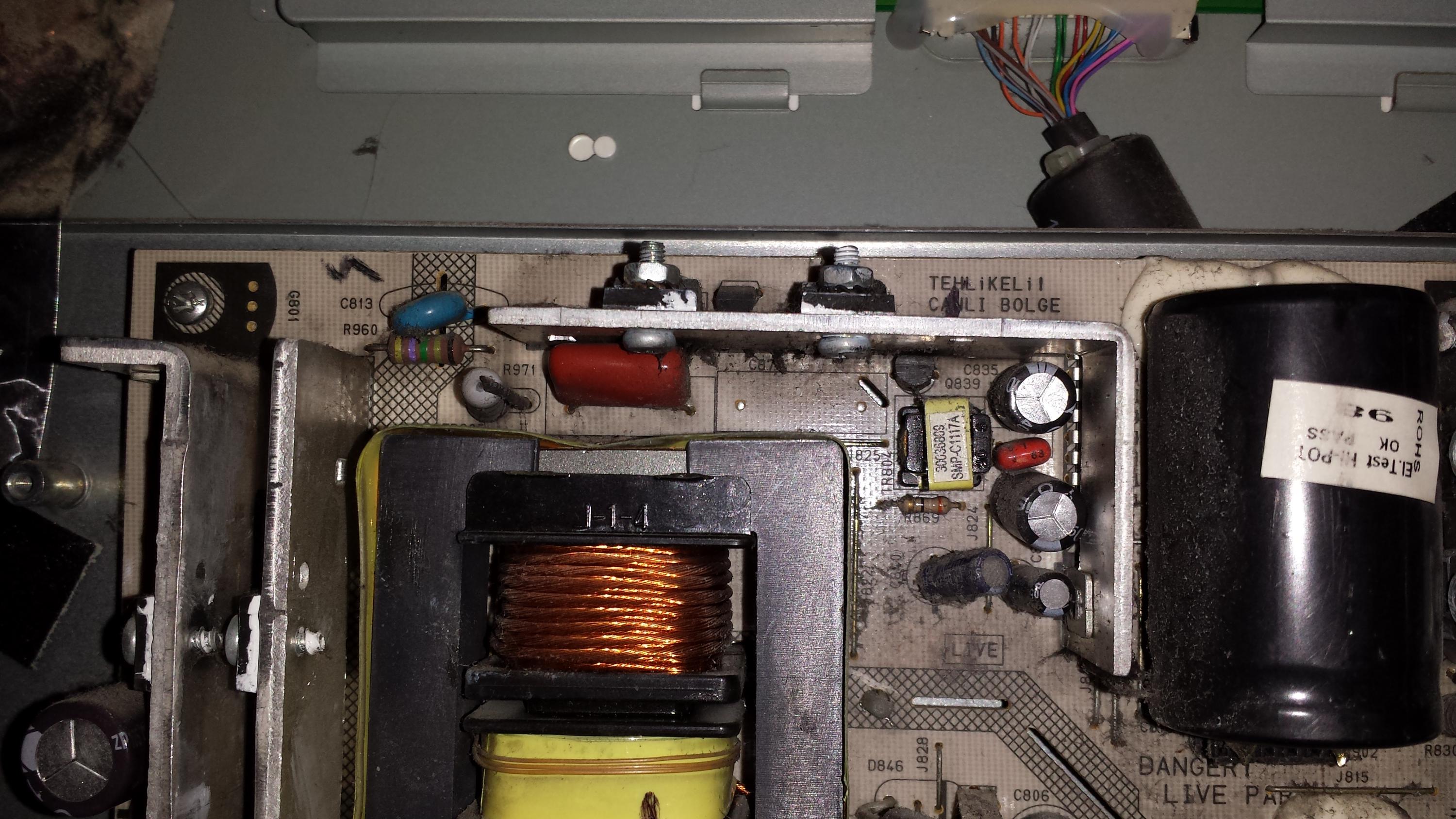

            bottom right of psu by the yellow transformer theres a small ic behind c801 capacitor is the ic damaged the board looks burnt/brown by it.
            • newtothis
              • Mar 2013
              • 1556
              • england
              Well spotted.
              IC806
                    can you take a picture of it close up please?
                      yes replacement would work but lets first see what we are dealing with... Do you have a DMM?
                            i would also be concerned if the board was badly burnt around the ic leg mounting holes etc looks very badly burnt whats the underside of the psu board look like under that ic?

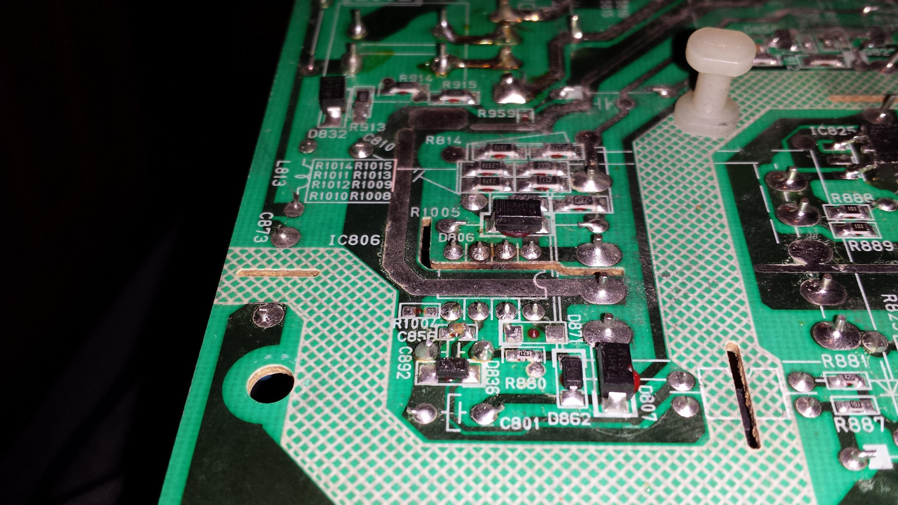

                              • Easky15
                                • Sep 2013
                                • 285
                                • Ireland
                                Closeup
                                • vinceroger69
                                  • Mar 2012
                                  • 6714
                                  • uk
                                  on a close up pic of the back of the pcb the burning looks like it gone a fair way through the pc board you may want to wait to see what other members advice is.
                                    Looks like the 5V standby IC partially blew up; frankly, I'm surprised it works at all!
                                      would the board be ok tom or would the burnt carbon etc cause more issues inc more pcb burning in your opinion.
                                        By the sounds of that then ill just go with the 2nd hand replacement,
