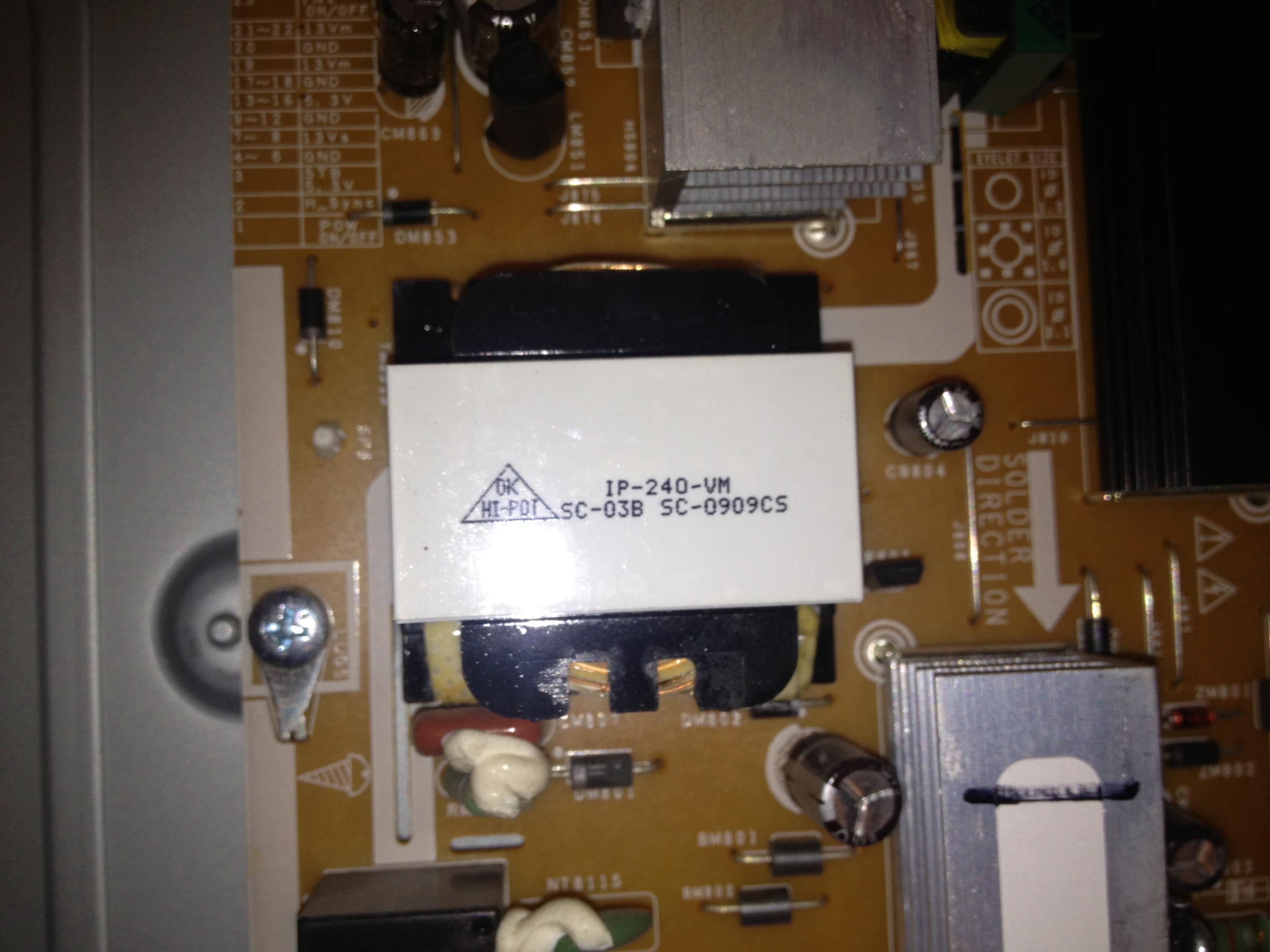

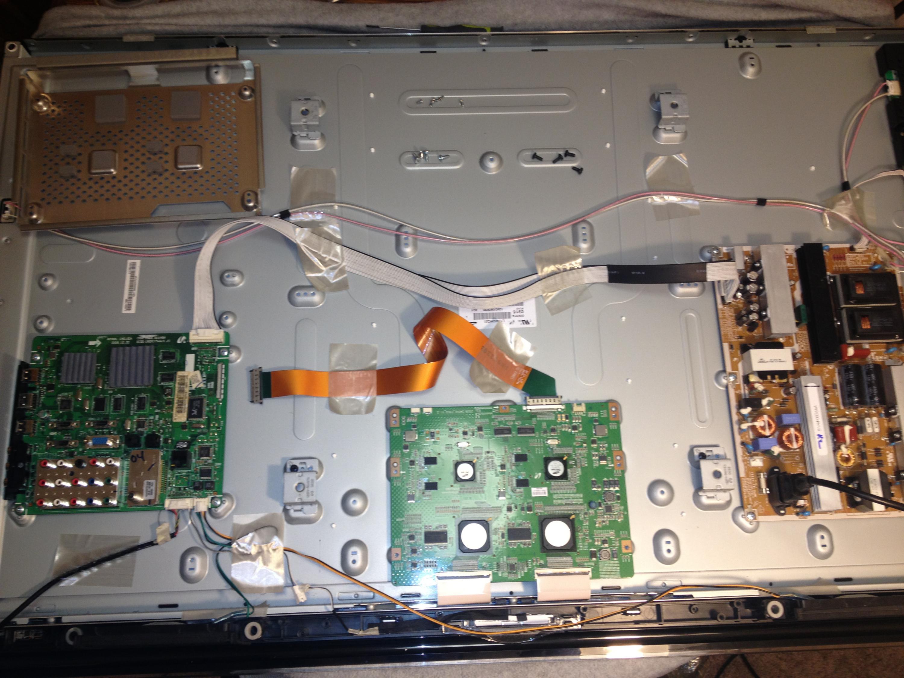

    Same blinking pattern. I am uploading a clip now. Should have a link in a few minutes.

      I do hear a faint on and off high pitched sound coming from this part.
        Re: Samsung LN46B750 power issue
        That may be because the main board is not sending steady ps_on signal to power up the power supply, also not sending Inverter on either.If you check the Inverter on now it probably shows < 1VDC.
        It is getting late so that is for me for today.
          Thank you for your time. I will upload a video and link it here. As well as any new progress. thank you again.
          • dbruts
            • Nov 2013
            • 18
            Here is a link to the video showing how the red light is blinking. http://vimeo.com/81277582
