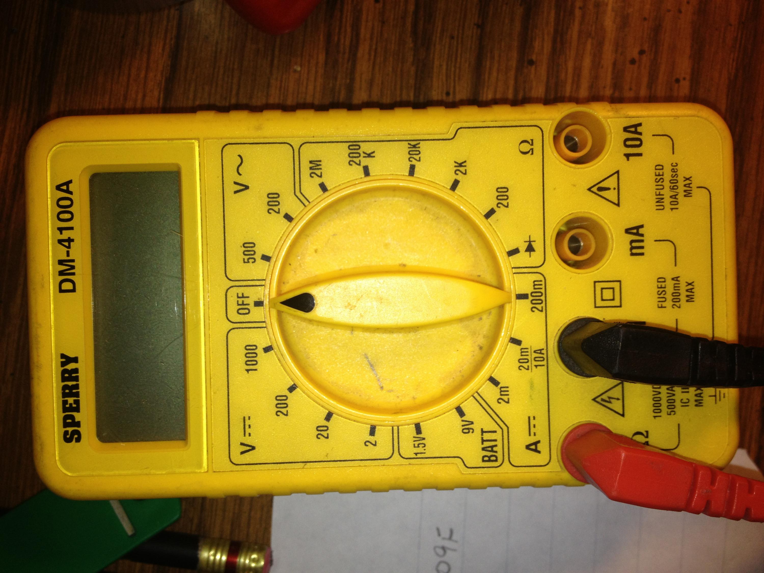

        I am also using a Voltmeter set at 20 (DC line over three dots) for all tests.

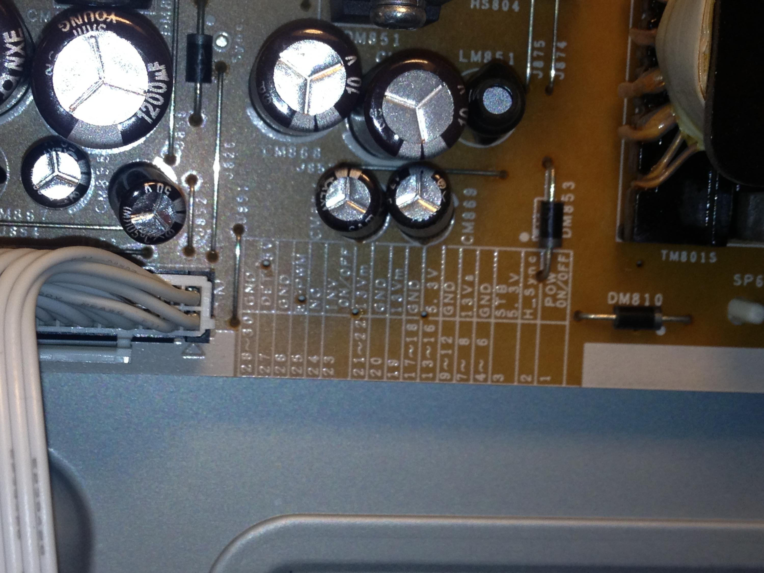

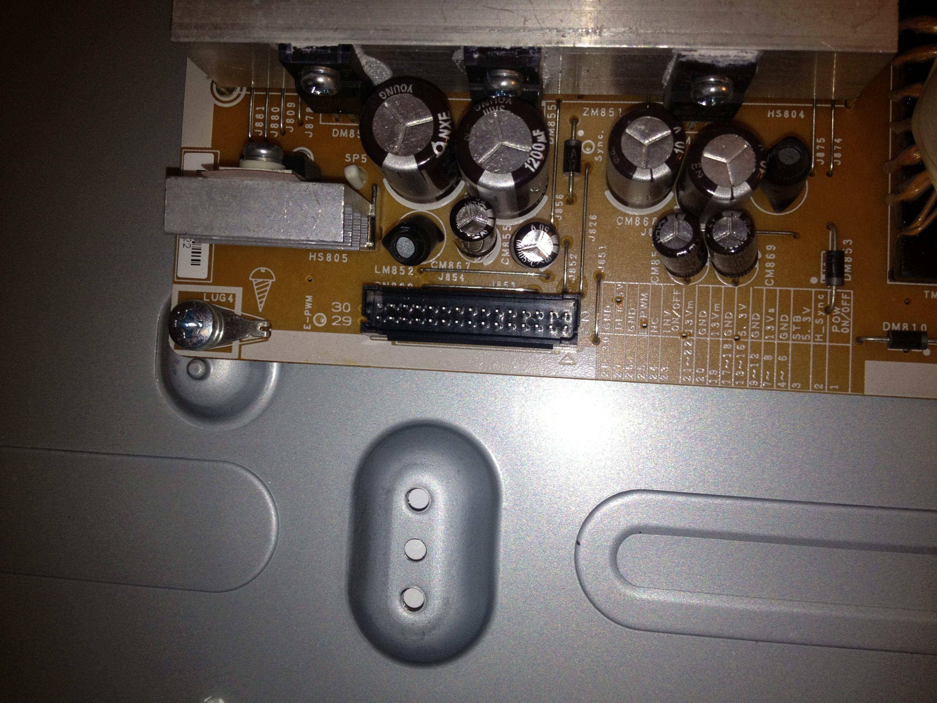

            Re: Samsung LN46B750 power issue

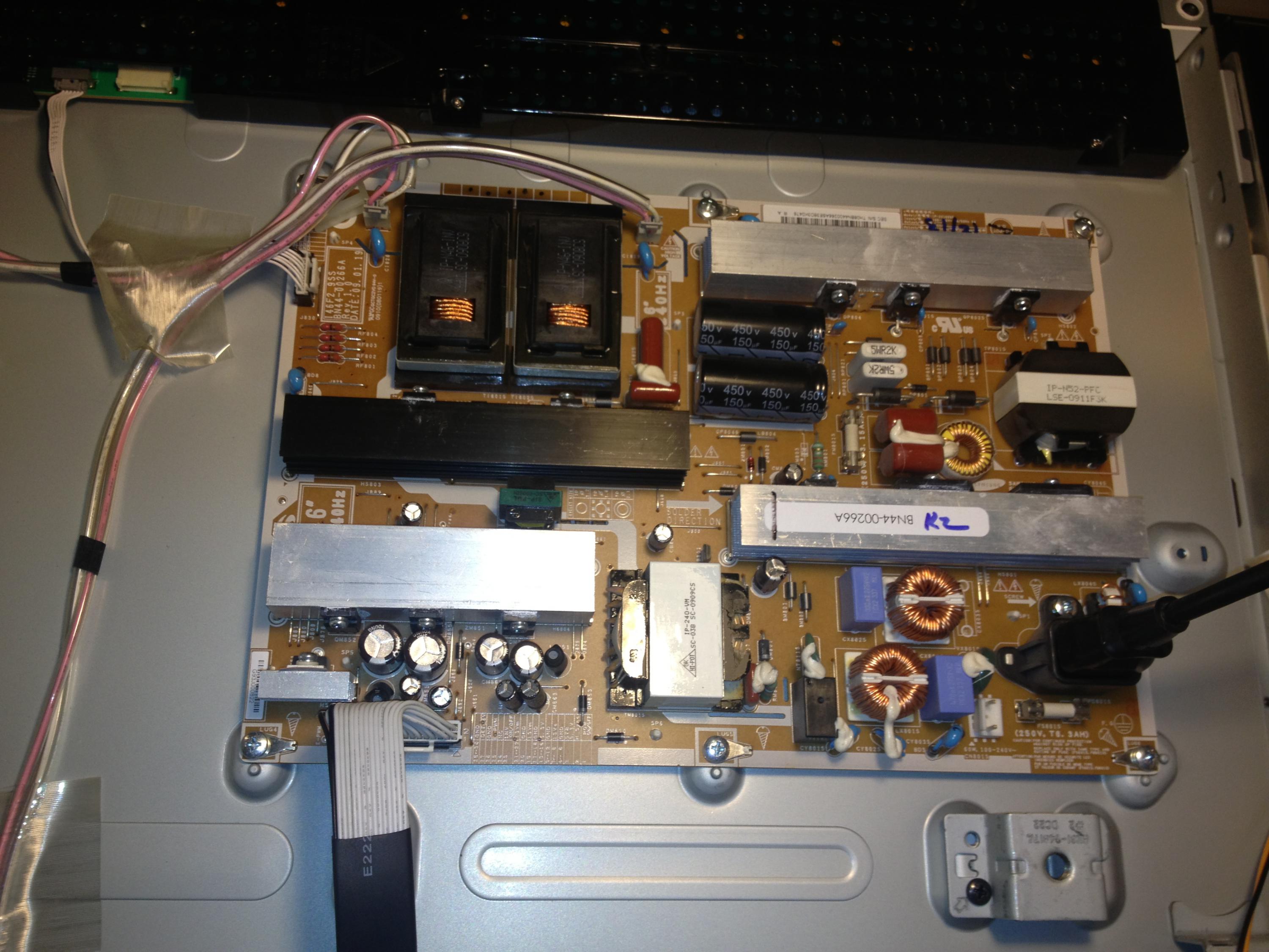

            OK, let start with this test; disconnect the cable between the main board and the power supply board, if the backlights come on when you plug the power cord into the outlet, that means the power supply and inverter circuits are OK.
            Can we also get the good pictures of the back side of the TV so we can see how all the boards are connected?
            "When ordering an assembly board, I was sent an "alternate" part that is supposed to be interchangeable." This does not sound good.
            BTW: What is the power supply board P/N. BN44-XXXXX?

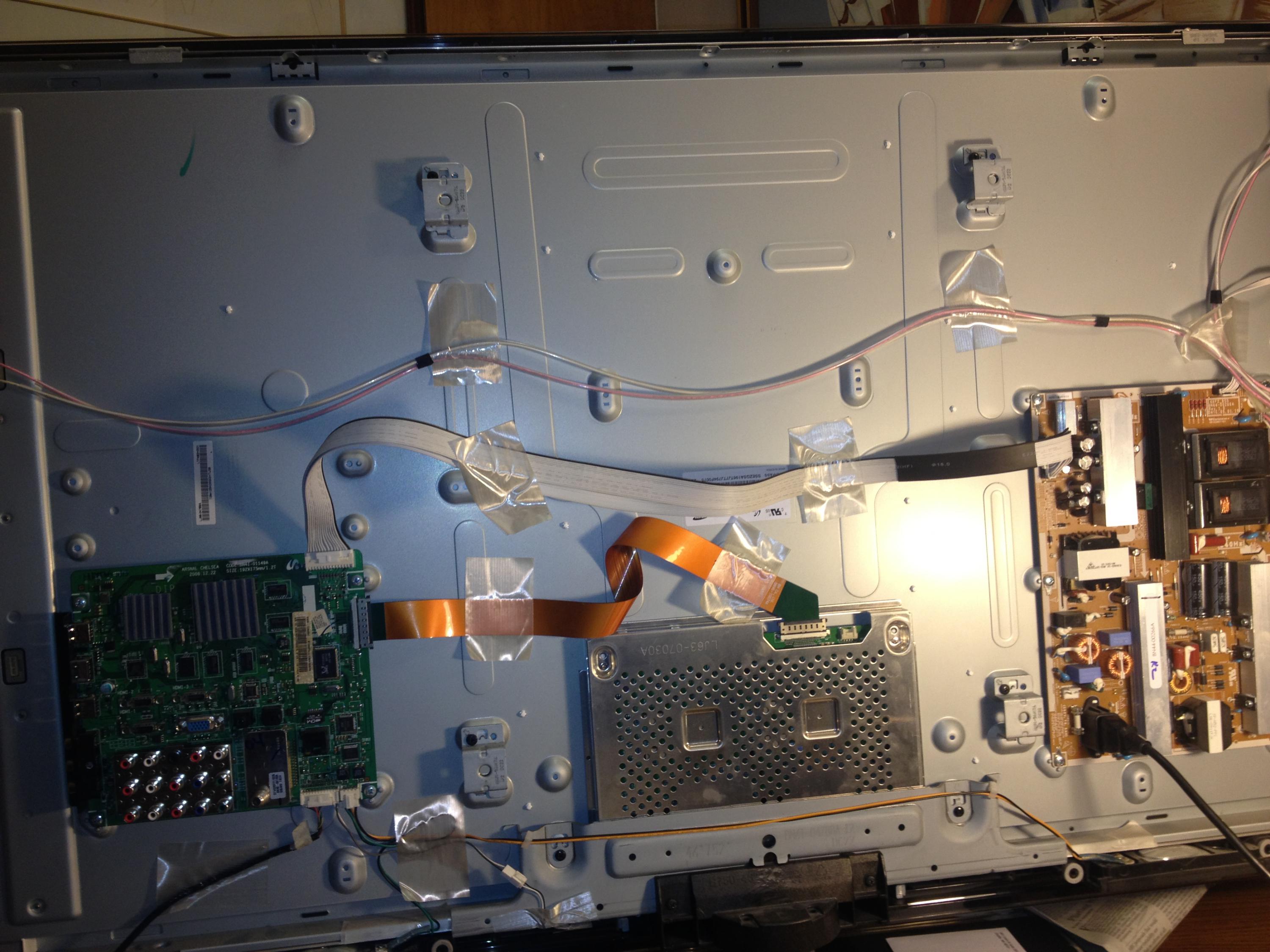

            • dbruts
              • Nov 2013
              • 18
              If you need any other images let me know.
              http://imgur.com/8AhJHhQ
              http://imgur.com/mekoI5c
              http://imgur.com/qDtSXGg
              Last edited by dbruts; 12-06-2013, 11:06 PM. Reason: Images did not appear so including link

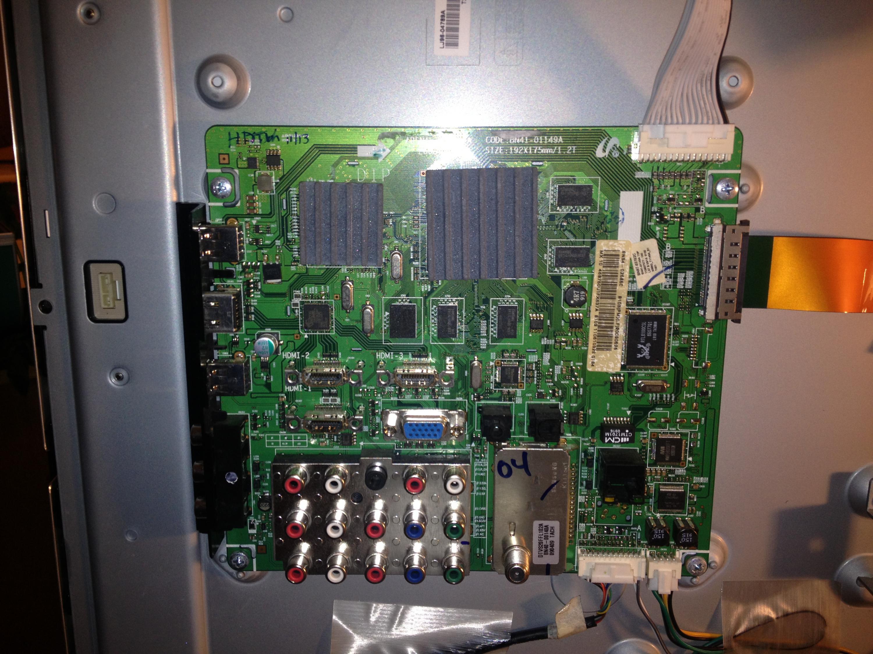

                When i remove the cable between the main board and the power supply, the backlight does turn on.

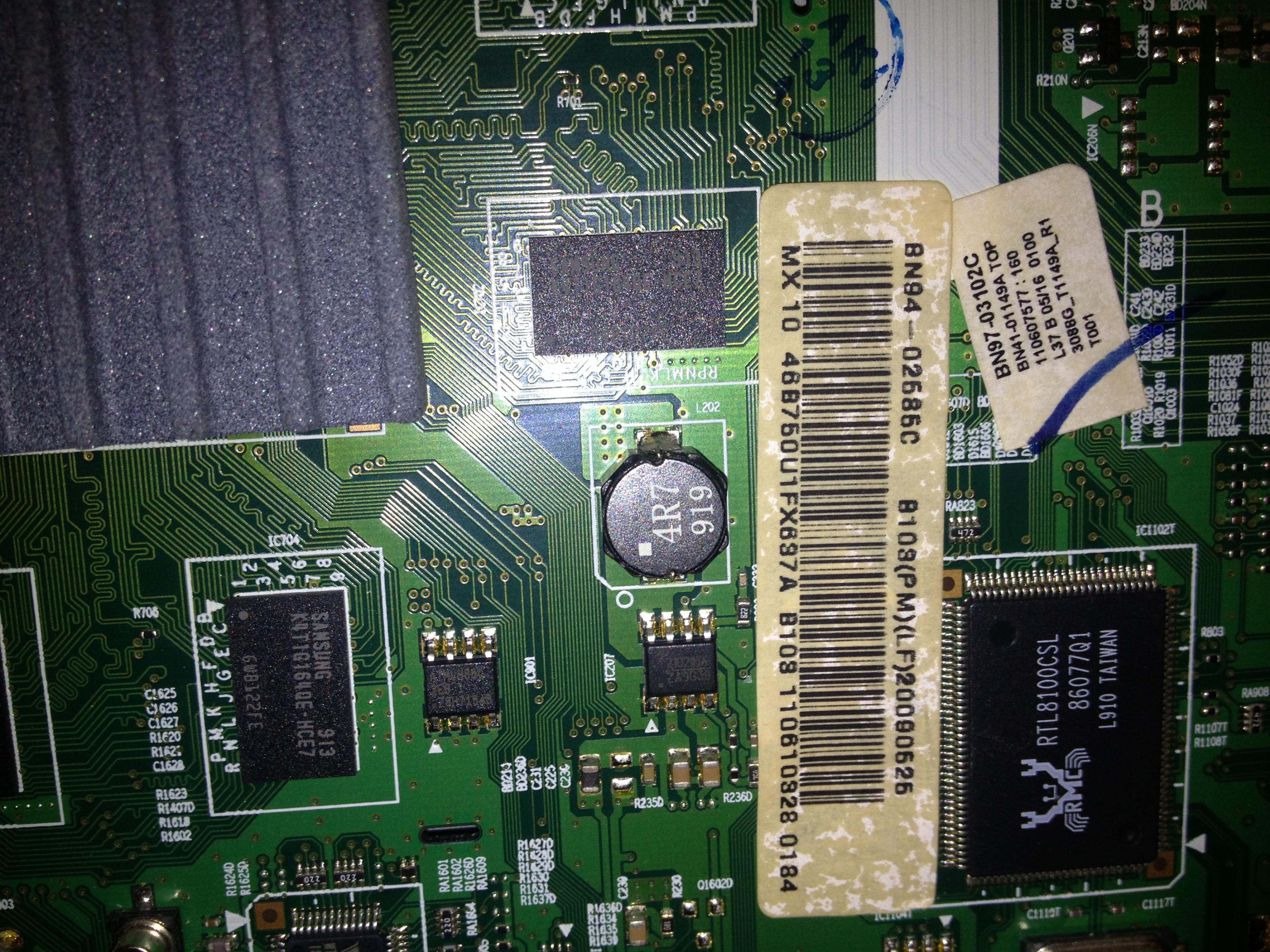

                I have a main board with part #BN94-02585C. I ordered from partstore and was shipped a replacement piece that they said was a "substitute" part.
                • dbruts
                  • Nov 2013
                  • 18
                  Close up of main board. I also returned the main board that I received and purchased a board that matches.
                    OK, your power supply board and the inverter circuit are OK, so your new board is not working, but since the TV was hit with the surge we are not 100% sure if something else is good or not.
                    What is the P/N of the power supply board so we can verify all the output voltages of the power supply. T-CON board will also need to be checked.
                      P/N of power supply board is BN44-00266A

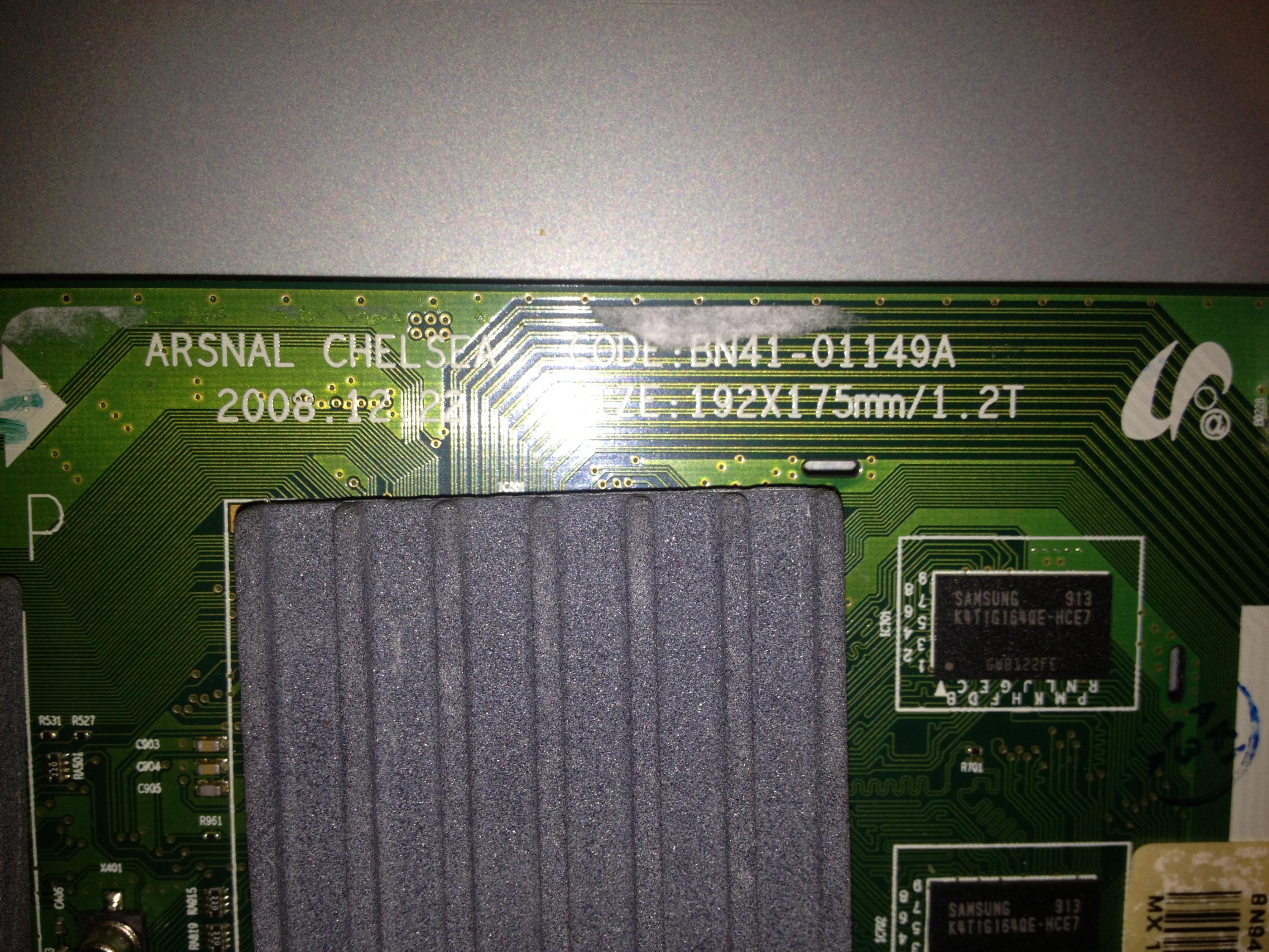

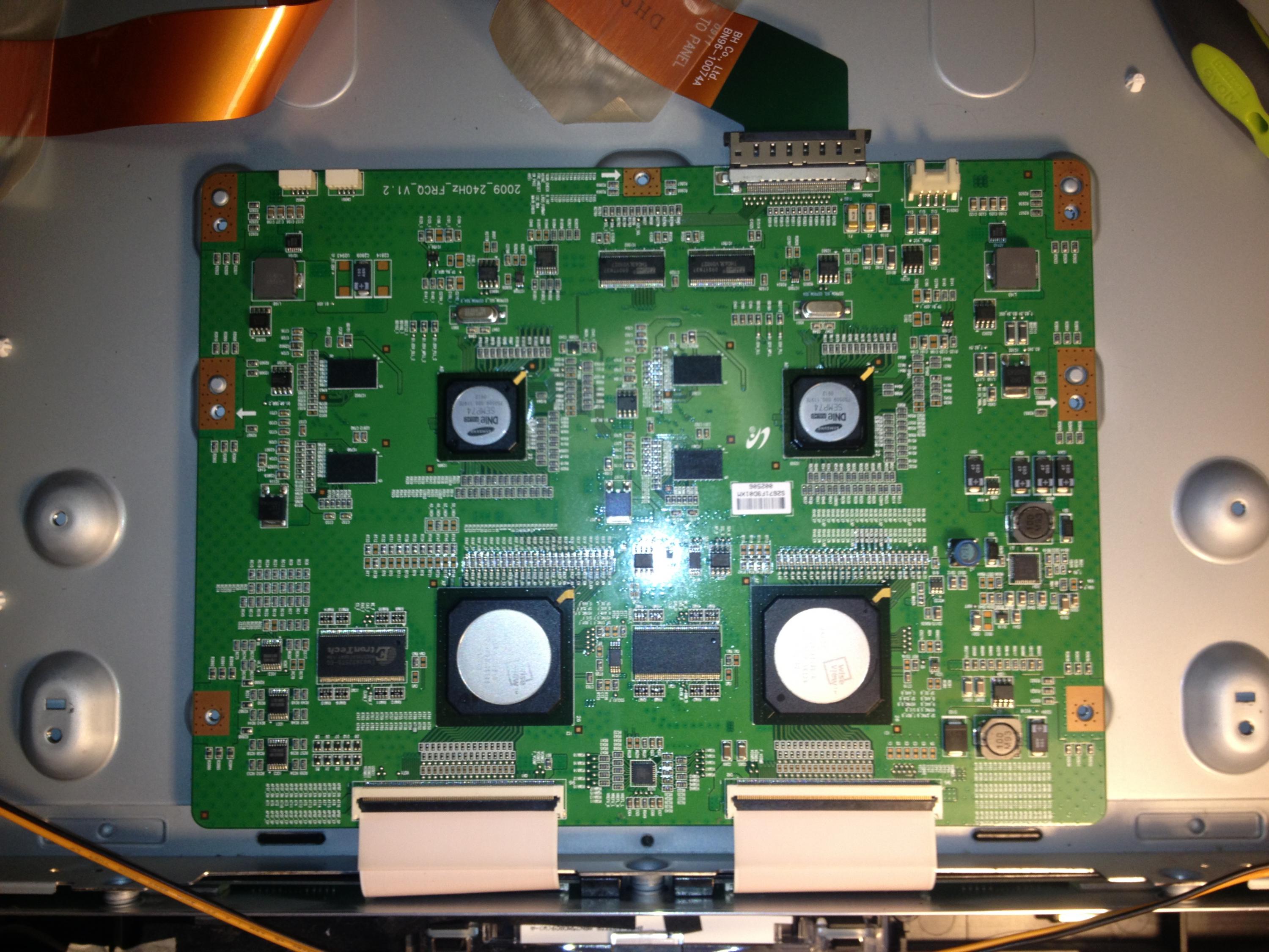

                        I will have to reposition the tv in order to get at the T-CON board.
                          So right now you have the correct main board installed?
                          • dbruts
                            • Nov 2013
                            • 18
                            Yes. It was the replacement with matching codes BN94-02585C
                              T-CON board images
                                OK, right now we know that we do have 5.3VSTBY, now we need to verify that the power supply does have 5.3V and 13V at CN801 connector, still leave the plug off the CN801 to the main board.

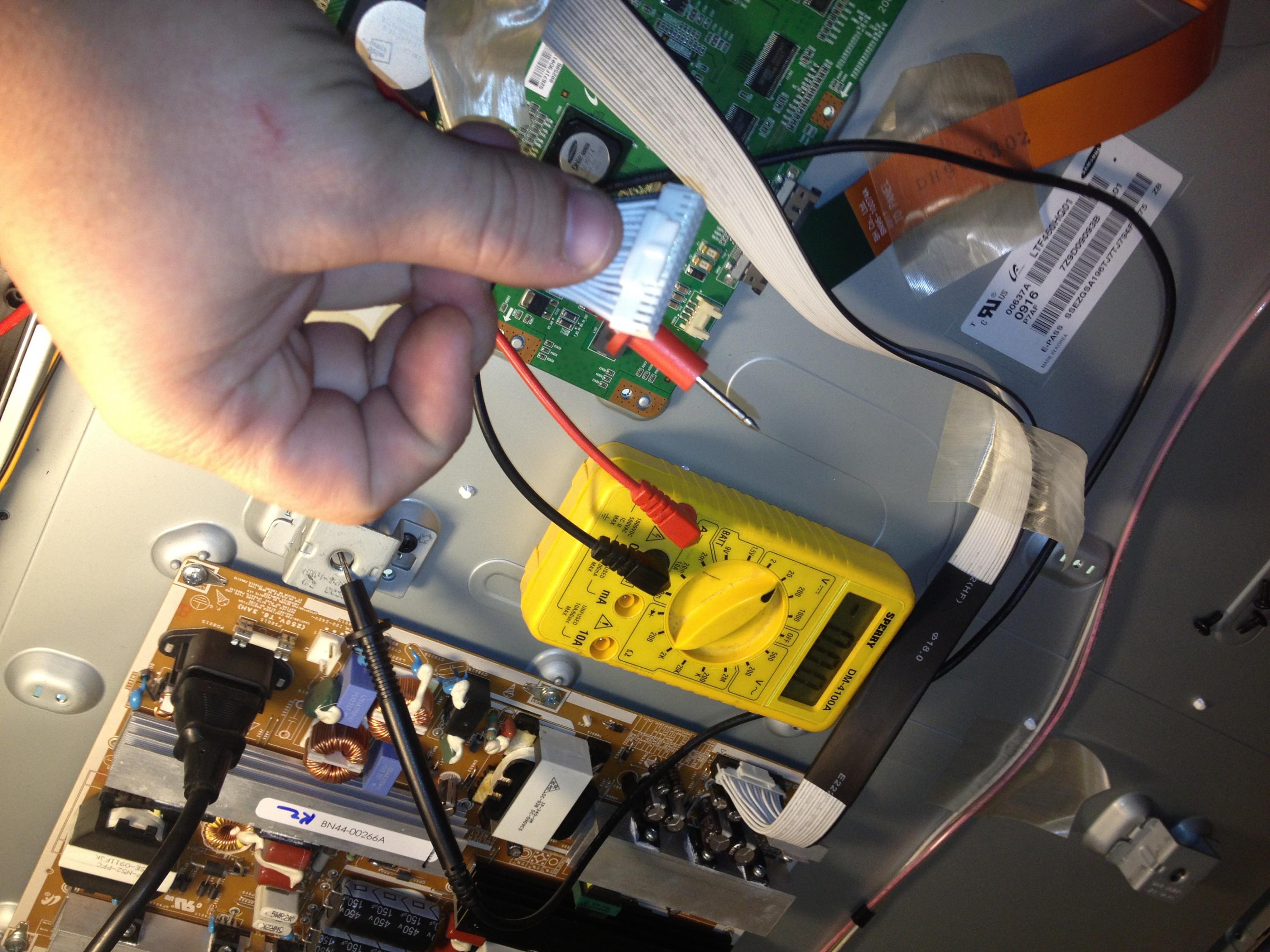

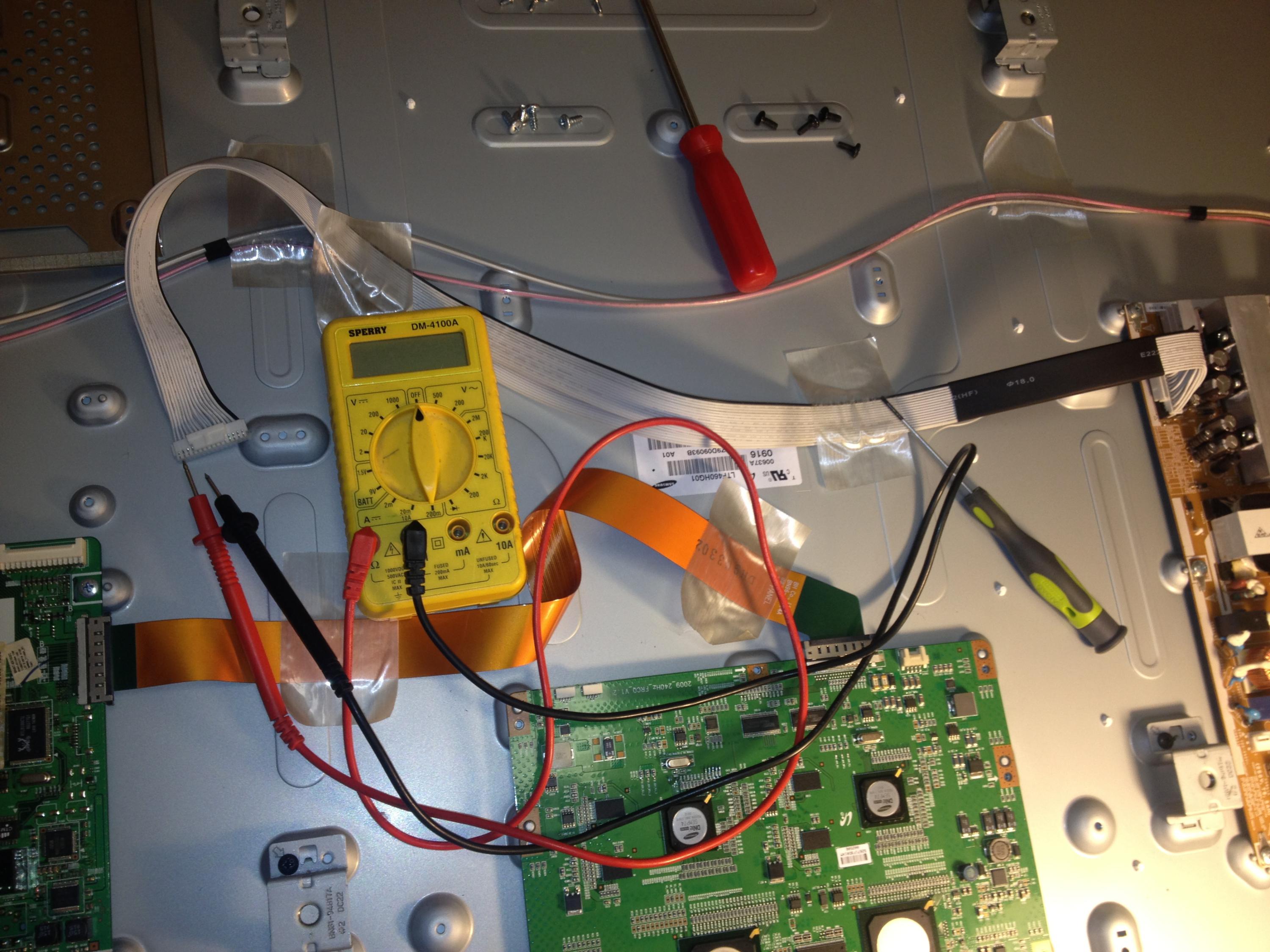

                                  Sorry I am a little confused. When I took the readings, I tested like the layout in the image. Is the other image a close up of the CN801 to be tested?
                                    OK, you can test with the connector still attached to the power supply board cn801, or without the connector in place but more chance of probe slipping.
                                    The black probe of the meter will be connected to the metal chassis. then using the red probe to check each pin and report the readings.
                                    • dbruts
                                      • Nov 2013
                                      • 18
                                      Testing like image.
                                      1 (POW ON/OFF) .8
                                      2 (H_Sync) 0
                                      3 (STB 5.3V) 5.21
                                      4 (GND) 0
                                      5 (GND) 0
                                      6 (GND) 0
                                      7 (13Vs) 12.78
                                      8 (13Vs) 12.78
                                      9 (GND) 0
                                      10 (GND) 0
                                      11 (GND) 0
                                      12 (GND) 0
                                      13 (5.3V) 5.21
                                      14 (5.3V) 5.21
                                      15 (5.3V) 5.21
                                      16 (5.3V) 5.21
                                      17 (GND) 0
                                      18 (GND) 0
                                      19 (13Vm) 12.78
                                      20 (GND) 0
                                      21 (13Vm) 12.78
                                      22 (13Vm) 12.78
                                      23 (INV ON/OFF) 5.12
                                      24 (NC) 0
                                      25 (E-PWM) 4.68
                                      26 (GND) 0
                                      27 (DET_SV) 5.16
                                      28 (GND) 0
                                      29 (GND) 0
                                      30 (GND) 0
                                        Good, the power supply is OK.
                                        Put connectors back in place, but remove the cables between the T-CON and the main board to see if the TV will power up with different LED blinking code.
