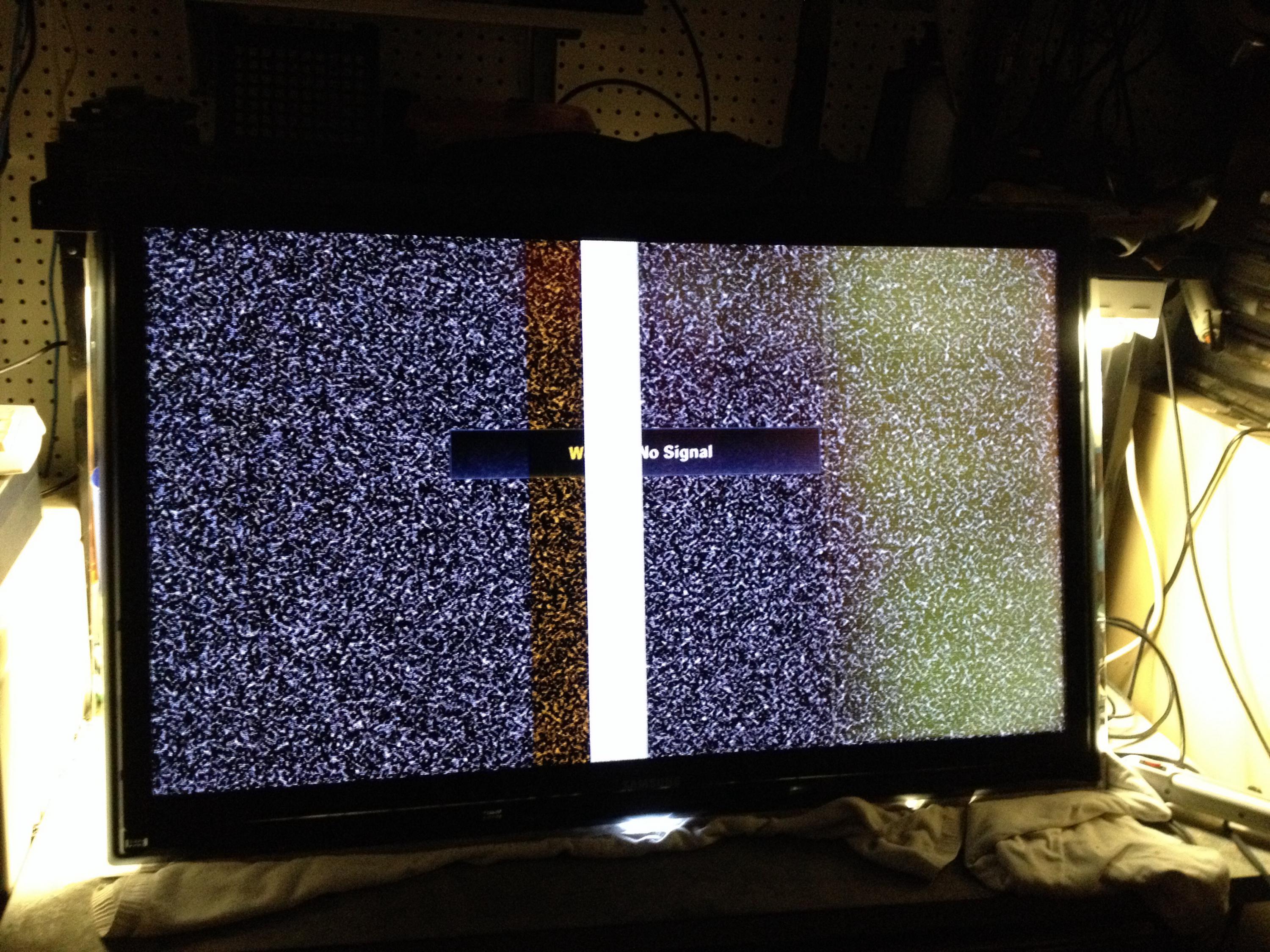

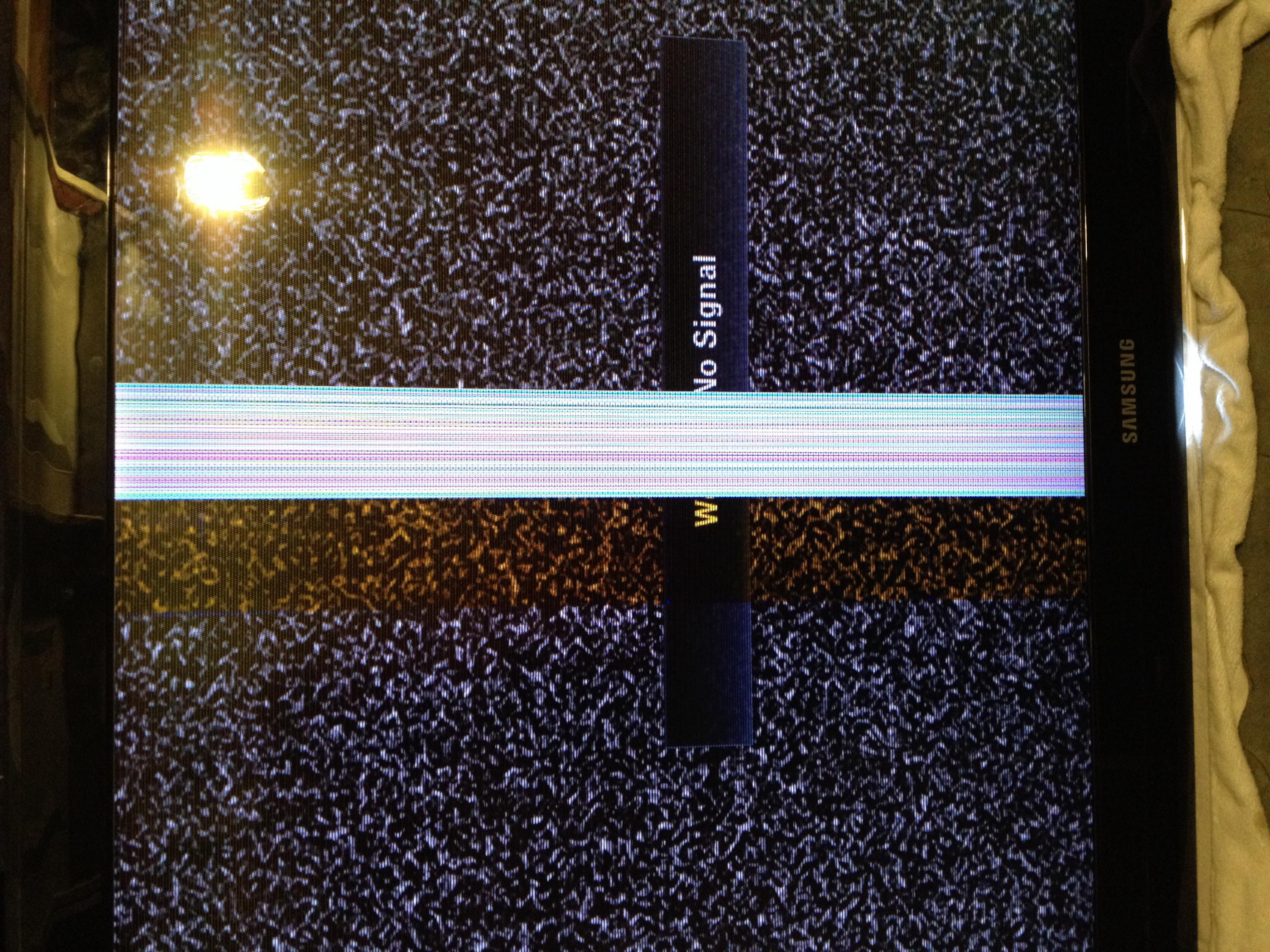

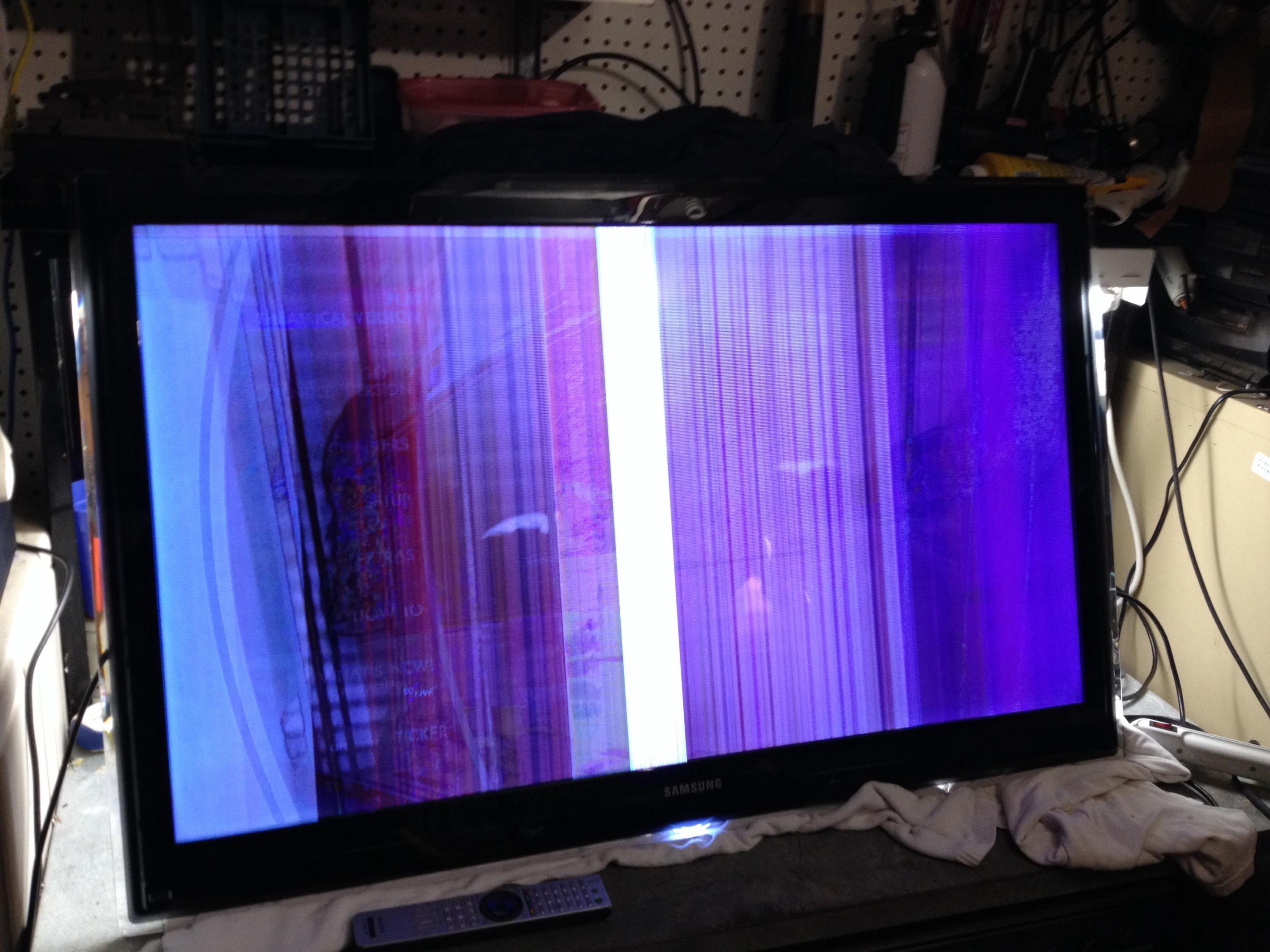

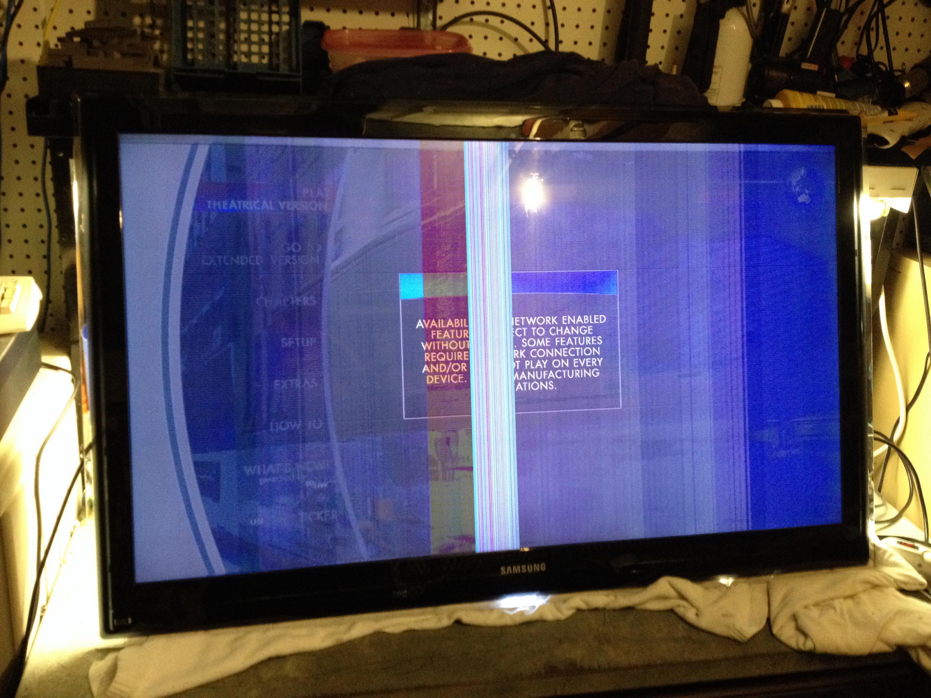

    I already know the answer guys but lay the bad news on me. Was hoping tcon from the persons description on craigslist but now I don't think so. Has 100s of horizontal whites lines plus the two big vertical stripes. Weird thing is it didn't show any image at all until I reseated the cables.

      I guess it could be tab bonds. It's got a severe latency / ghosting effect.

        Lines are getting more prominent after warm up.
          Re: Samsung UN46B7100 bad panel?
          I say bad TFT drive IC.
            Panel, or TFT IC as Budm mentions. Most likely it has been water damaged, extremely common now LED/LCD put tabs on bottom of panel (water just drops right on to them...)

              I'm guessing that IC is embedded on the tabs? I don't see any obvious damage anywhere.

                And also assume that I may as well part it out and call it a wash huh? Man, I hate to do that.

                  I have the thing mostly torn down now. Doesn't appear to be an liquid damage. Really does seem dumb having stuff on the bottom. Just cleaning the screen with liquid could cause issues.
