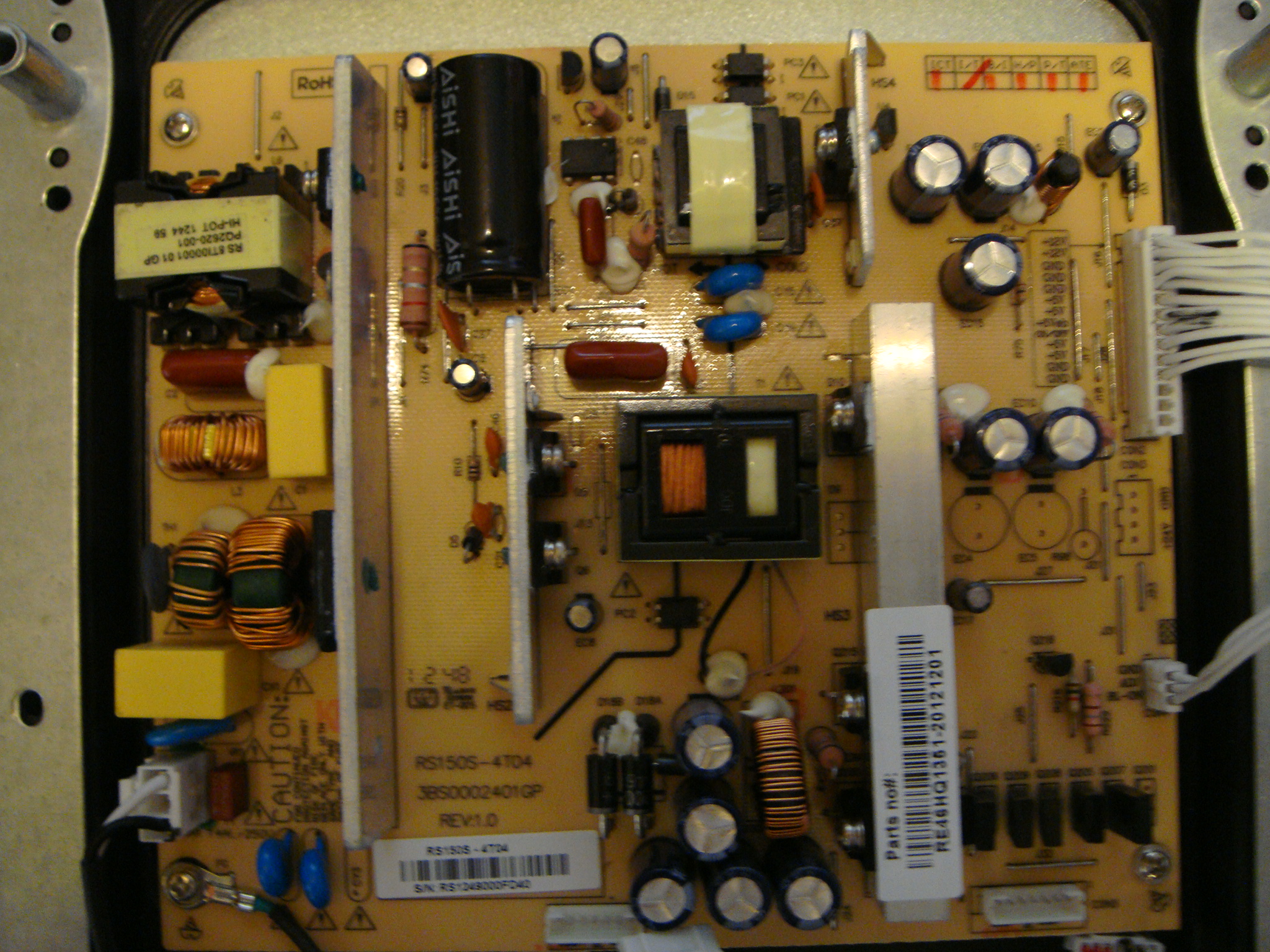

52"RCA Problem.
  • wadenvk
    • Nov 2011
    • 55
    52"RCA Problem.
    RCA 52"
    Model# LK520D3HA88-QYE
    The problem I am having is when you plug the tv in I get a red led As soon as i hit the power button the led goes out and then there is a flash. and then nothing. no sound, no pic.
    All the caps look ok no burns on any of the boards all solder joints look good. What should I look for next.

    • philliesfan30m
      • Aug 2013
      • 542
      Re: 52"RCA Problem.
      what do you mean by a flash? did you check the voltages for the connector on the power supply when the light is still red?

        • philliesfan30m
          • Aug 2013
          • 542
          Re: 52"RCA Problem.
          so it tries to turn on then shuts down completely? did you check the voltages on the connector on the power supply?

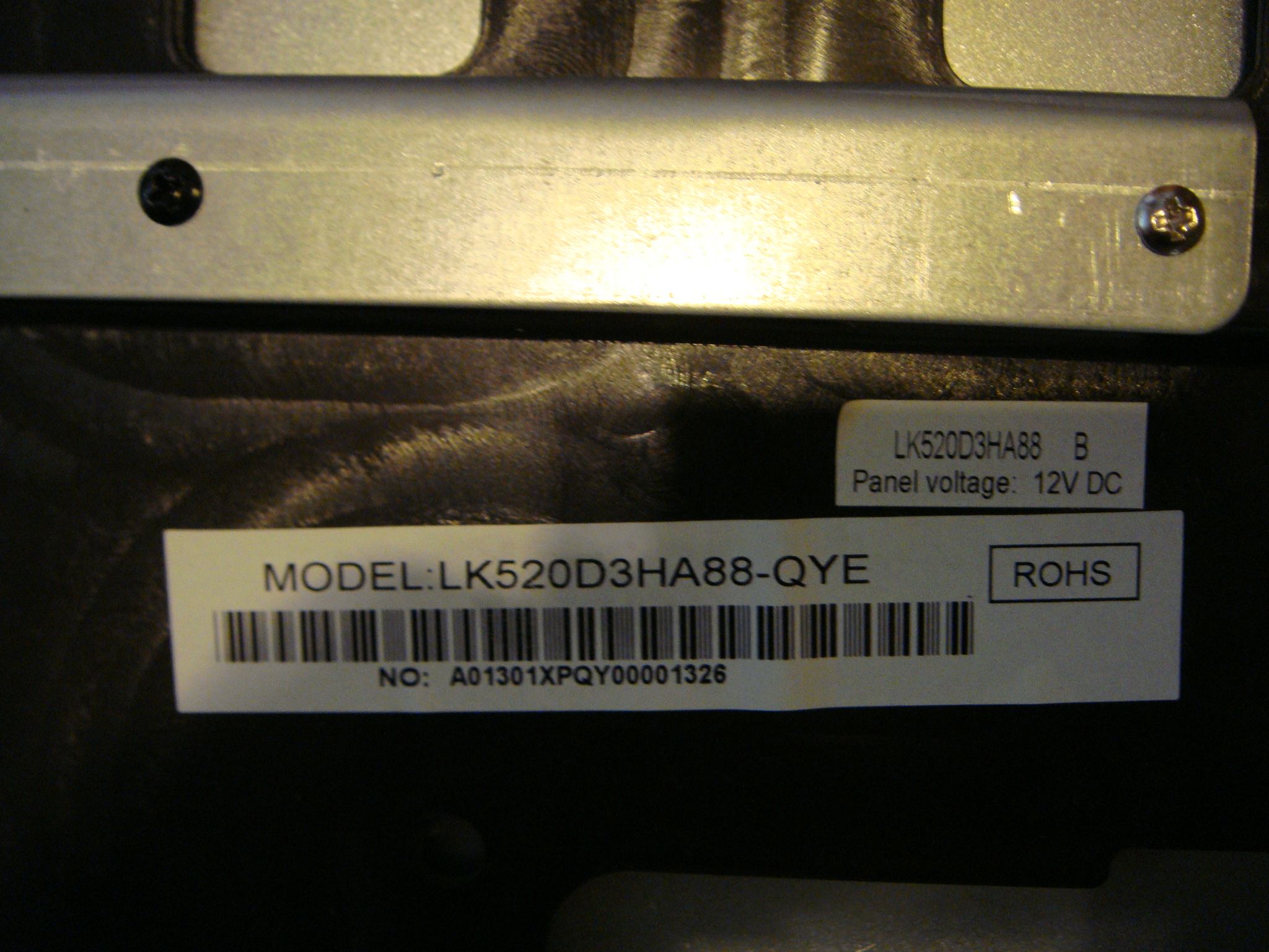

                Re: 52"RCA Problem.
                are you sure that is the right model number? i can't even find that number
                • philliesfan30m
                  • Aug 2013
                  • 542
                  Re: 52"RCA Problem.
                  can you check the small cap in the center of the board to be sure it isn't bulging? the pic is kinda fuzzy
                  • wadenvk
                    • Nov 2011
                    • 55
                    Re: 52"RCA Problem.
                    That cap looks good no bulging. That is the model # on the sticker here is another # on it a01301xpqy00001326.

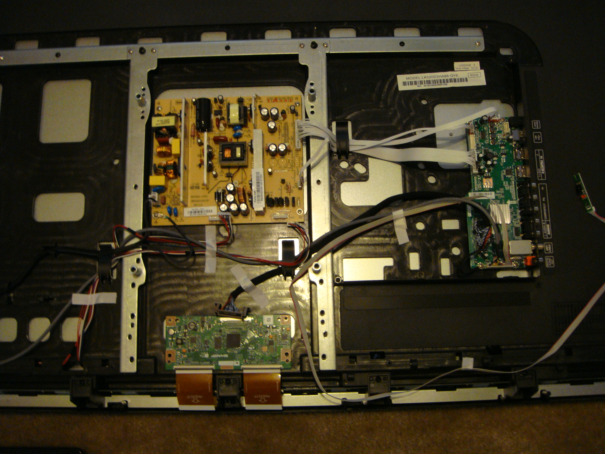

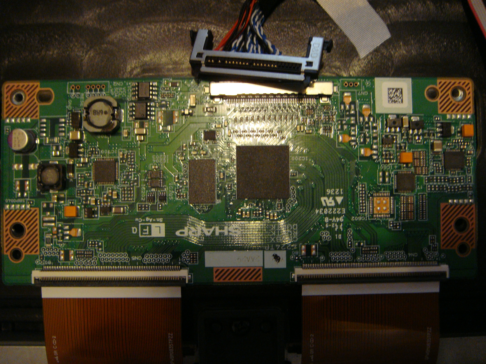

                        • truep
                          • Aug 2010
                          • 373
                          Re: 52"RCA Problem.
                          First thing I see is that the LVDS cable at the TCON is not on correctly. Also the power supply seems to be getting it's power on voltage but isn't putting out any 12 or 5 volts.

                            • wadenvk
                              • Nov 2011
                              • 55
                              Re: 52"RCA Problem.
                              Here is the pic of the tag.

                                      • johnboy1313
                                        • Nov 2012
                                        • 1959
                                        Re: 52"RCA Problem.
                                        Sounds like a nice friend. We can test the power supply to weed that out of the equation. With all of the connectors plugged into the supply and the TV plugged in but not powered on, check the voltage across the big cap. Black lead of the meter on one leg and red lead on the other. It should read around 165V. Power the set on and check again. If that part of the supply is working, it should read around 390V. If you can post clear pictures of all the connectors on the power supply, I'll try to help you attempt to force the supply on using two resistors. I need to be able to read all of the labels for each connection.
