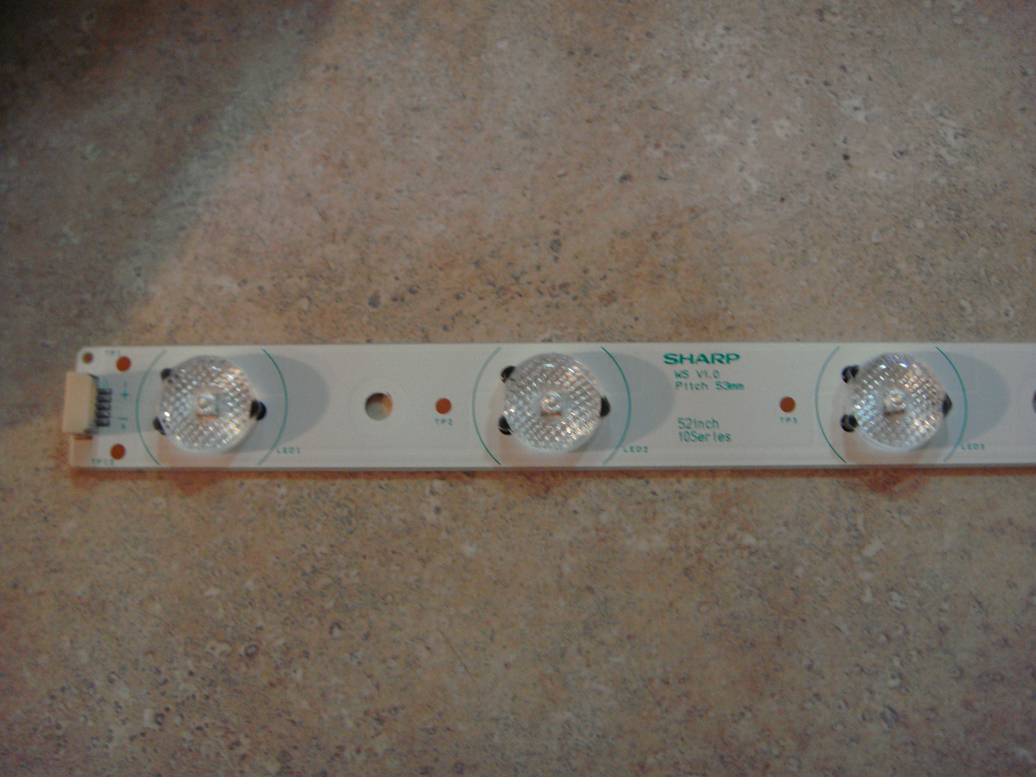

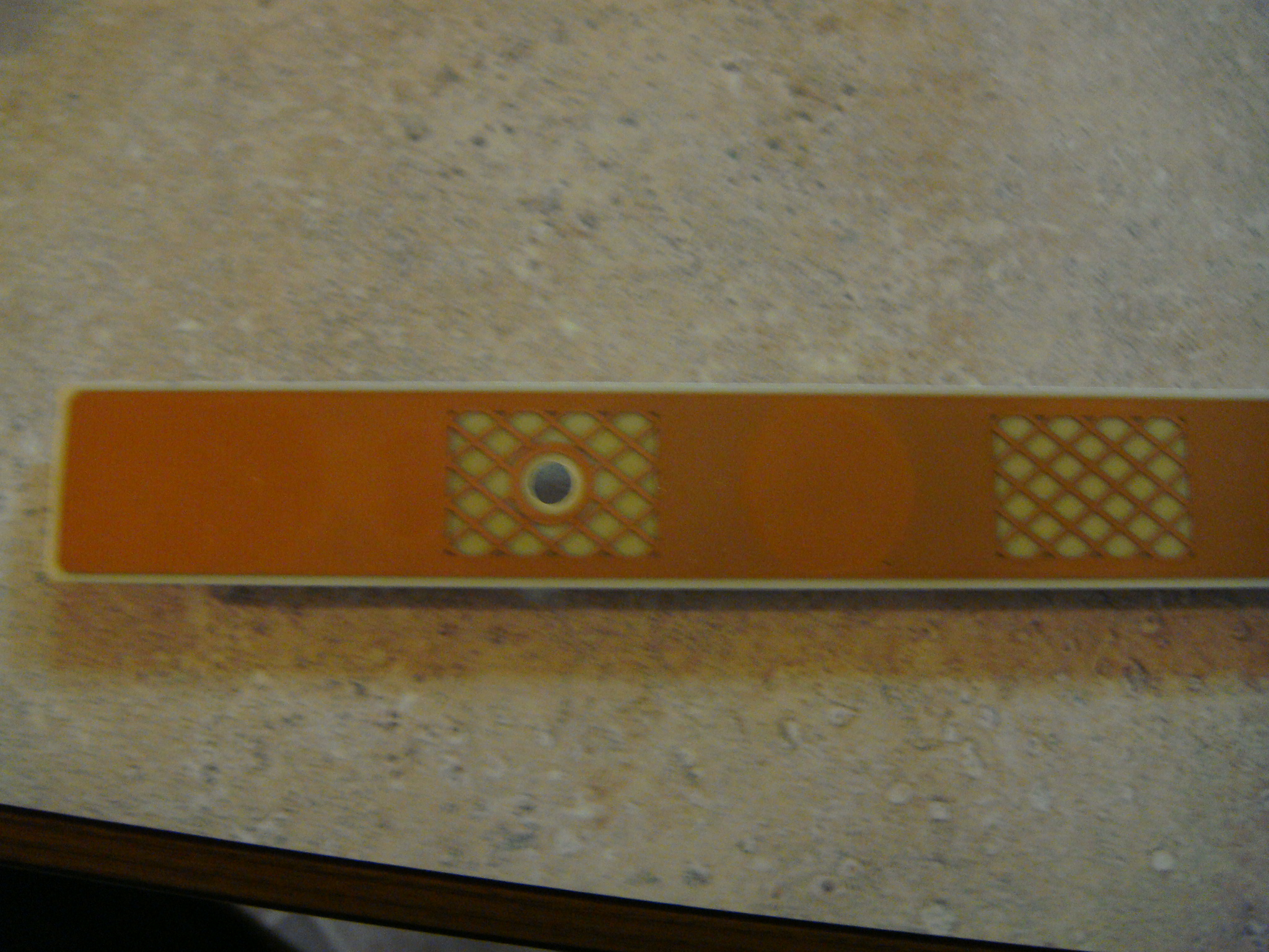

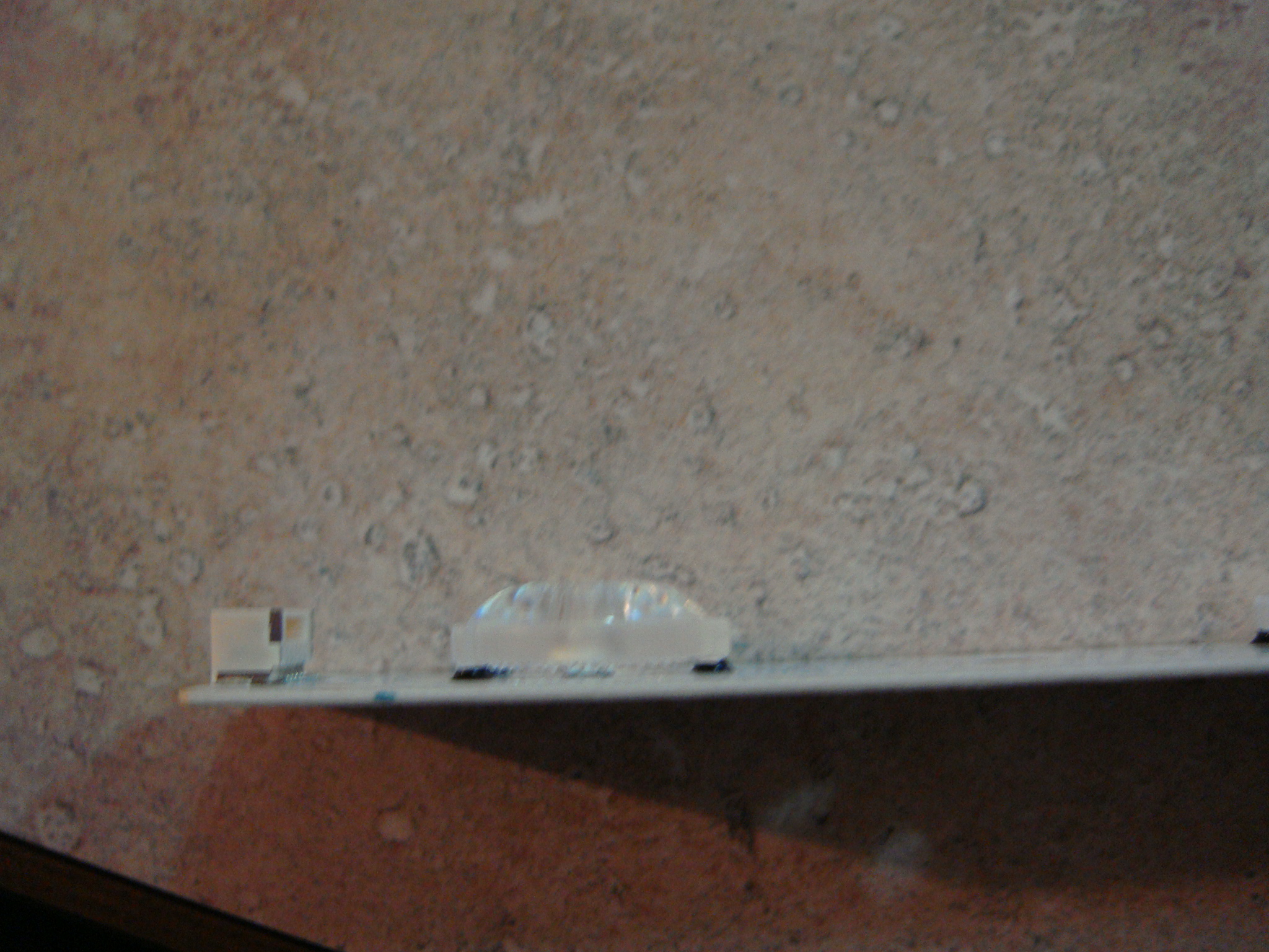

    Here are some pictures could not get the whole strip in there.
      #42
      Re: 52"RCA Problem.
      Wow. I have no idea. At this point, I'm honestly guessing. On the left of the picture of the LED side of the strip, there are two test points labeled + and -. In between all of the other LEDs is a test point. I'm thinking that they are all +. There are also five pins at the connector and ten LEDs on each strip. I would guess that each pin is connected to a pair of LEDs. They are likely all connected to a common ground. I would start by checking for continuity between the five pins when the strip is unplugged and when it is plugged in. I would also check for continuity between each of the pins and each of the test points. Finally I would set my meter to diode mode and put the red lead on a test point and the black lead on the - test point, then swap the leads and check them all again.

        Also, in this pic
        https://www.badcaps.net/forum/attach...8&d=1386285536
        It looks like there is writing between the 2nd and 3rd LEDs and the 5th and 6th LEDs (starting from the center of the panel). Could you post pictures of the writing?
