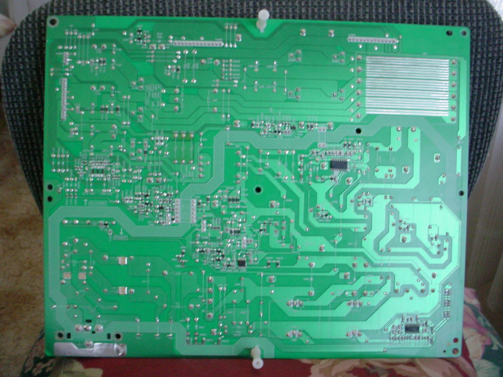

          Re: Vizio E550VL
          Hi budm, I can't see these on the forum yet so if they are inadequate. I will gladly redo with better results. Just say so and I will redo them....geraposi

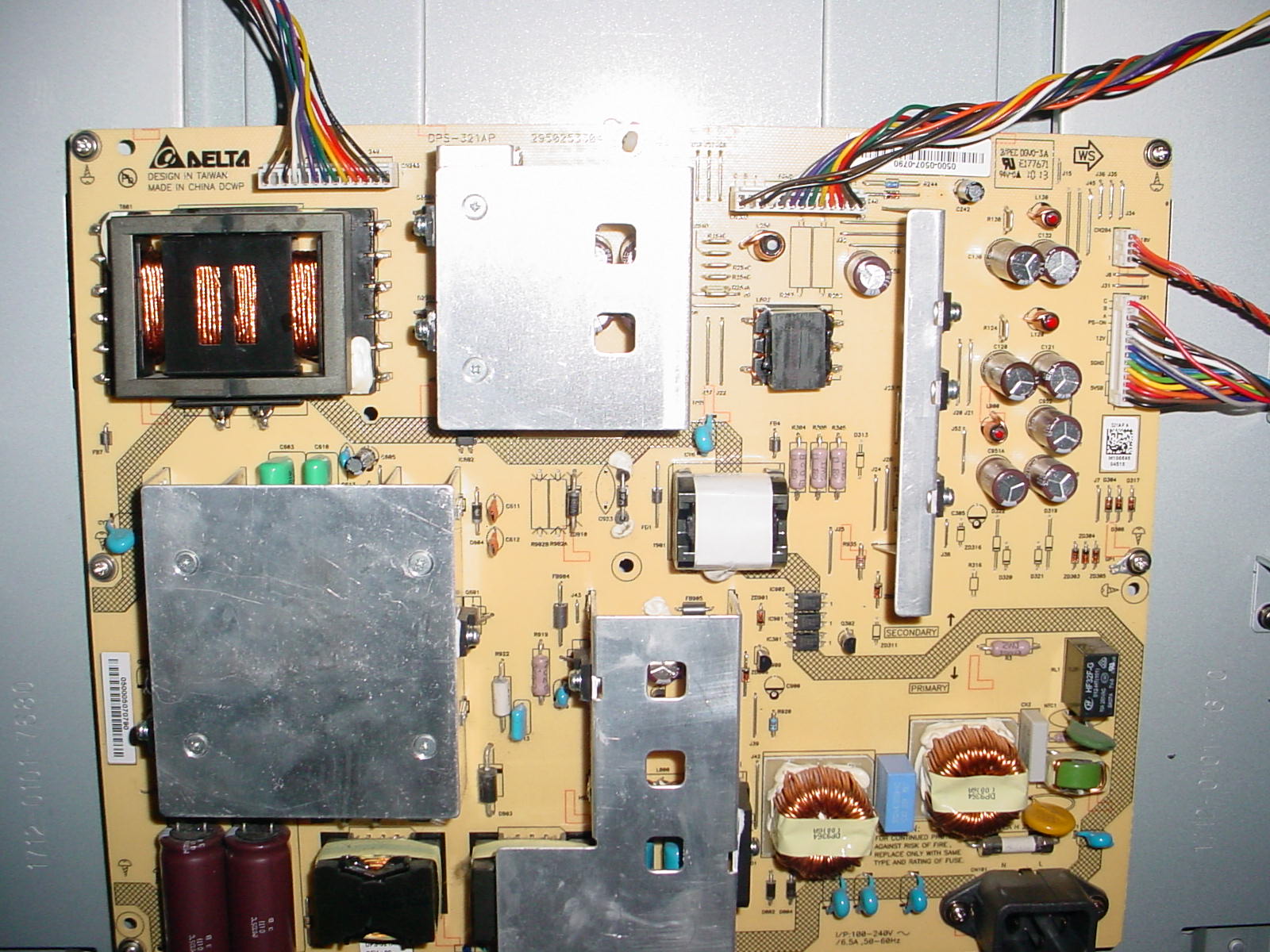

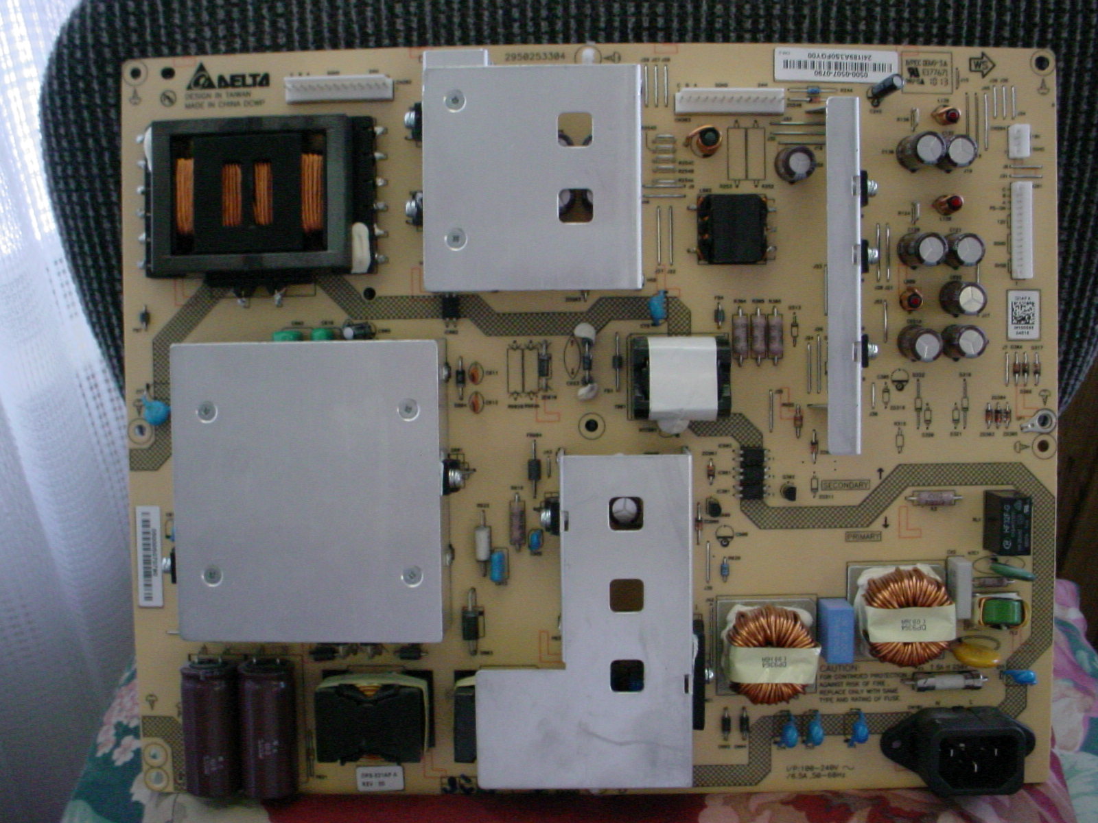

            Re: Vizio E550VL
            Here are better pic's of power board. I see some v pins on the plugs going towar the master and slave boards. Is that the v you were refering to? I am going to look this board over before I reinstall it.

              Re: Vizio E550VL
              I reinstalled board and it has the 24vdc, 18vdc, and the 5vdc. I need help finding the BL_on pin (Inv_on pin)... I see 5vsb, on pins 1,2,and 3 of the cn201 connector plug. Could that be it?
                Re: Vizio E550VL
                OK, on the connector of the power supply where you can see the PS_ON pin, there are 3 more pins next to it with label "A", "B" (not used), and "C". So check the DC voltage of those 2 pins when TV is off and when TV is on. I am not sure which one of these 2 pin is the BL_ON, and Dimming, but we just need to find out if the voltage on those 2 pins will toggle or not.

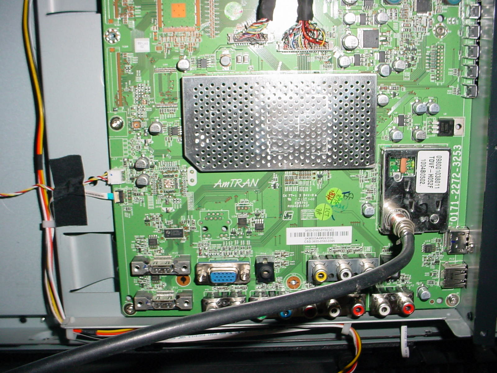

                                        I think this may be one of the problematic E Series with EEPROM trouble.
                                        our main board is Part # 3655-0162-0150 (3C) The replacement board I see on differant sites is Part # 3655-0162-0395R
                                        I read at www.elektrotanya.com about a repair kit for the main board part # 0171-2272-3253/54 for $18.95 or so. I have no idea what it is but it may be an EEPROM.
