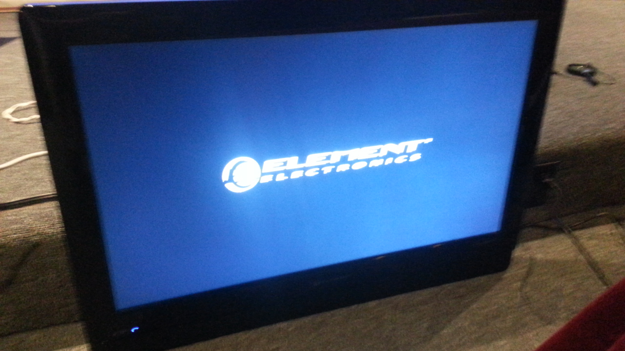

        I'm fairly confident I can do this with the probes as it's an 8-pin ic and only pin 4 is the gate. What kind of results am I looking for exactly ?
          #64
          Re: Element ELCHW321 Catastrophic Failure
          To see if it draw at 0.5A or more, you may see the current surge at the beginning then it should drop down below 0.5A.
          • mmartell
            • Oct 2013
            • 3189
            #65
            Well I'm not sure what to make of that test. I had the lamps disconnected as it's the only way I can get to the bottom of the board.
            With a voltage reading about 1.3v on the 5v line I switched the probe over to AMPs and switched the meter into the amp range as well.
            I was reading 0.00 so I switched to mA scale and now it would read a peak that varied (max about 125ma) but would settle to zero in a matter of seconds. Could only get a reading by removing one of the probes and retouching. Always returned to zero soon thereafter.
            What's up with that ?
              #66
              OK, I would solder the wires to the S and D, connect everything back together, turn on the TV, then short the two wires together to simulate MOSFET on condition, if the switched 5V is OK, then the TV should function, then you will know that the MOSFET is bad.

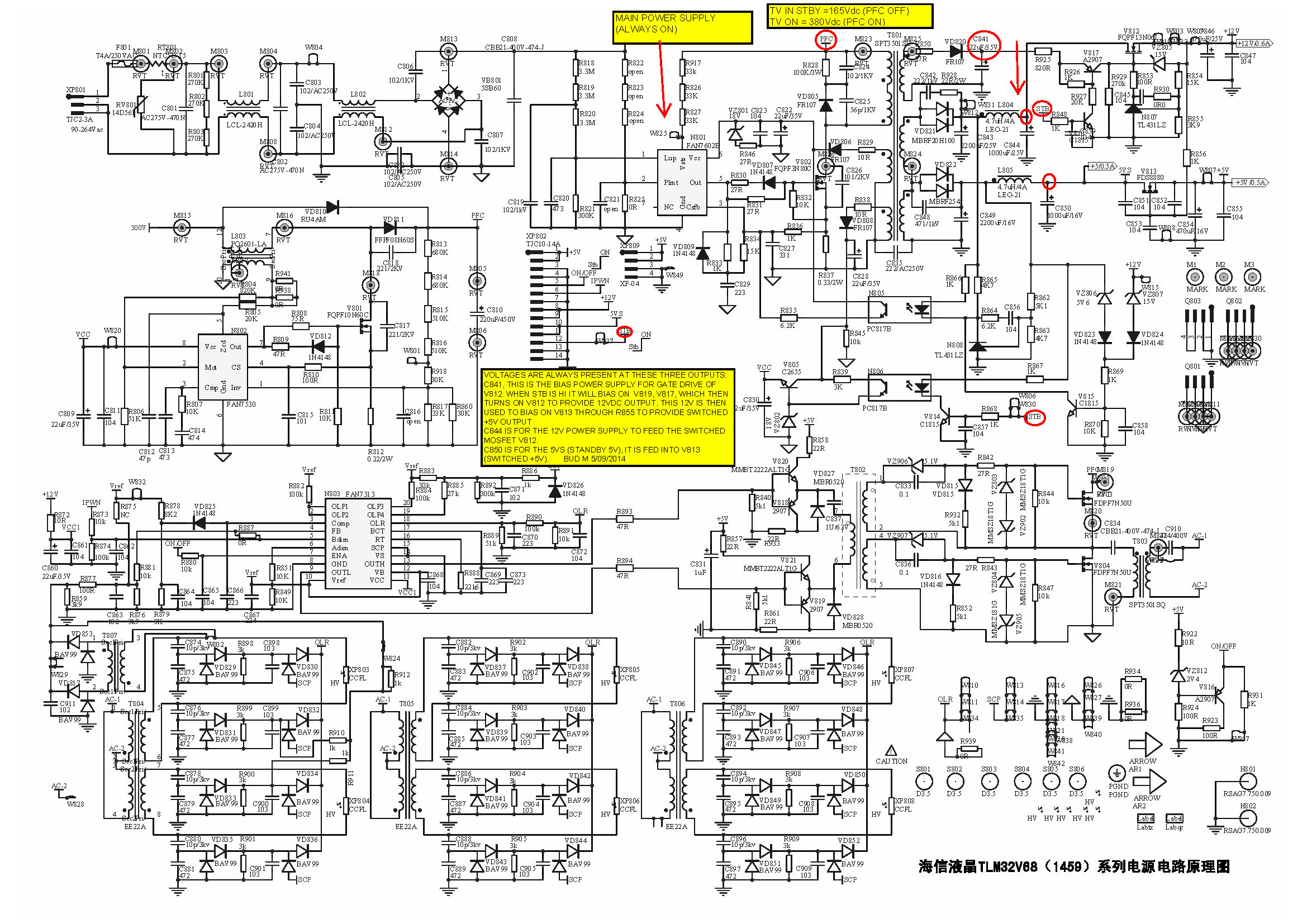

                  Well yoda, you nailed it. Soldered a wire from S to D and set works beautifully.
                  Since the 5v supply is switched by the 12v supply do you see any reason why I shouldn't just leave the jumper in ?
                    #69
                    That switched 5V must be sequenced on after the 12V is on, otherwise they would not have designed the circuit that way. If you leave the wires connected, the switched 5V will always be present even when the TV is turned off.
                    • mmartell
                      • Oct 2013
                      • 3189
                      #70
                      Actually it has no problems with the on/off sequence as it is now, but if you're saying it could damage something down the road I will swap out the mosfet.
                        #71
                        You need to make it turns on after the 12V is on, we do not want the surprise later and I do not think it is good idea to have the switched 5V be on all the time, they have it turned off when in standby for reason.

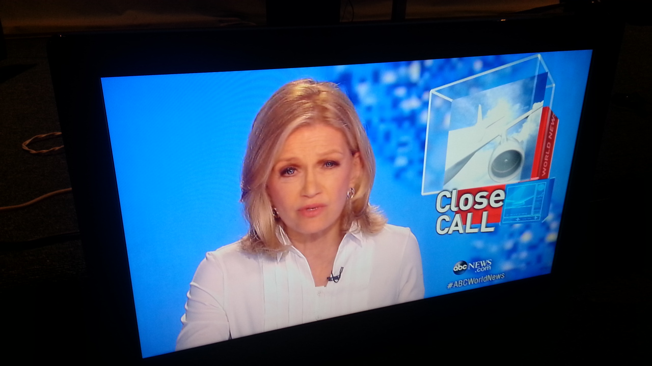

                            Mosfet V813 has been replaced and full voltage to the 5v line has been restored. Set works as it should now.
                            Much thanks budm !!

                              Thanks for the feedback. That was fast, you have the MOSFET in stock? Started on Nov 2013, fixed in May 2014, I am glad you did not give up on it.
                              Also really to have thanks newtothis for providing the SCH, otherwise we may not have gotten this far.

                                Well I let it sit for a long while until I bought this power supply instead of attempting to fix the train wreck that the original one was. Thanks again and here's a pic of the landfill "escapee"
                                As an aside Diane Sawyer just refuses to age !
