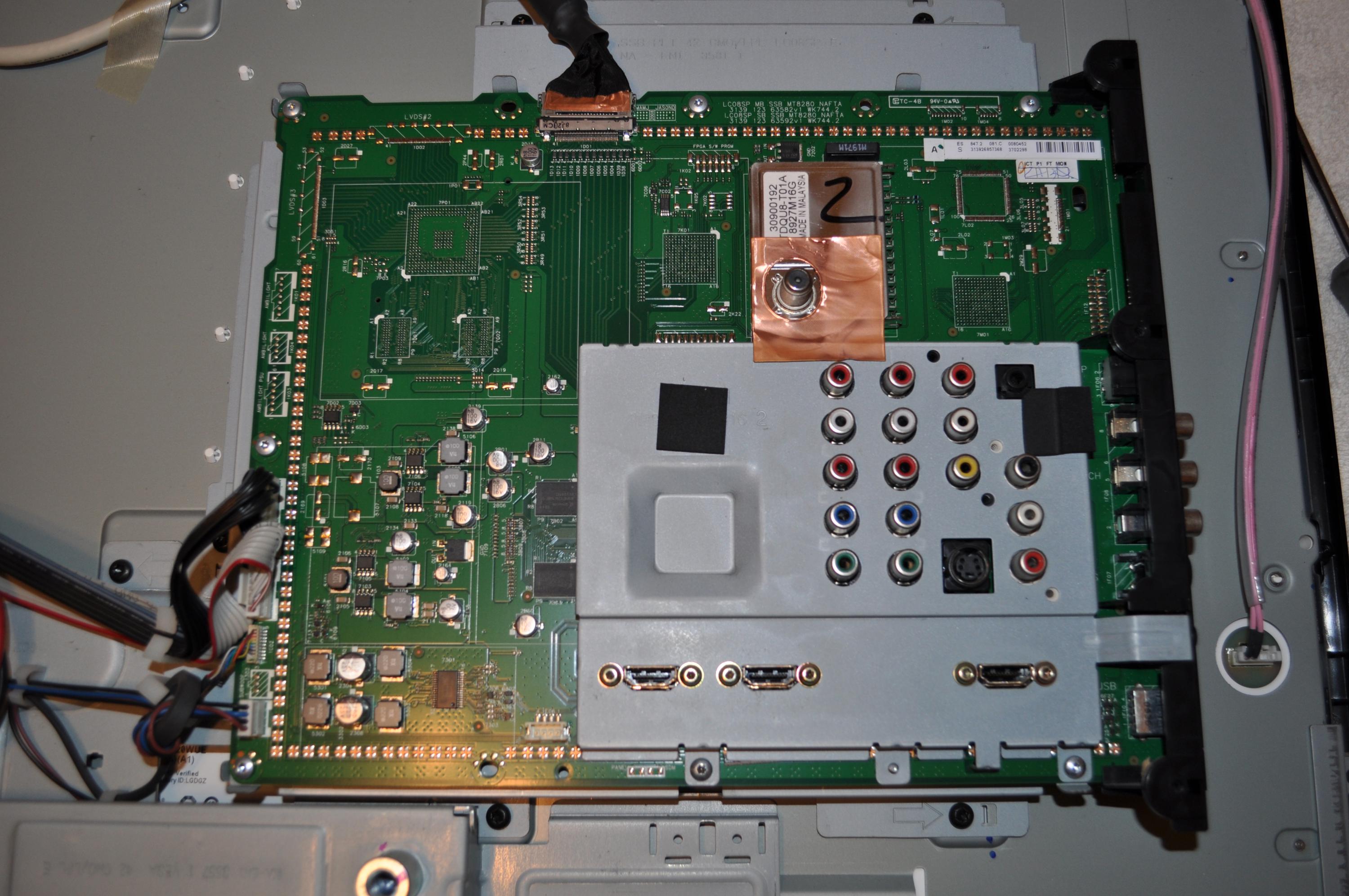

    Just picked up a Phillips 42pfl3603d/f7. Backlights come on but no picture, 12v to TCon both sides of fuse. Any thoughts main board?
    Re: Phillips 42pfl3603d/f7 No Picture
    Here are some pictures of the boards.

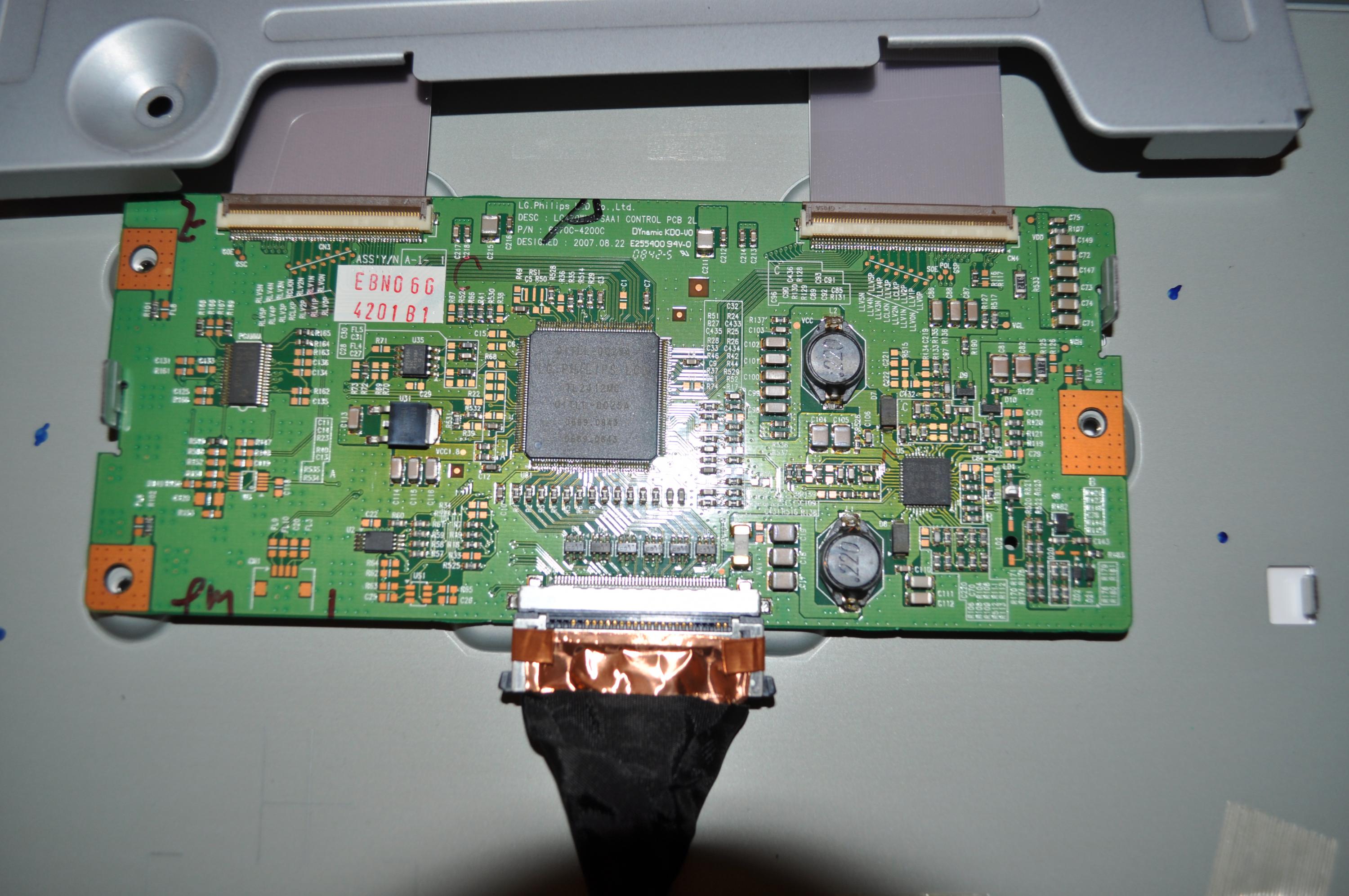

      I would check the VCC and VCC1.8 test points on the t-con. VCC is likely 3.3V.
        VCC is .890VDC and VCC1.8 is 0
          Correction VCC1.8 is .543VDC
            Both of these are low. Are these voltages supplied by the regulator on the TCON itself?
              They are supplied by that small square chip to the right of the larger LG Philips chip.
              Next, check AVDD; this is across the two small capacitors marked C111, C112 near the bottom middle right of the board.
                11.68vdc
                  Suspect Bad Tcon?

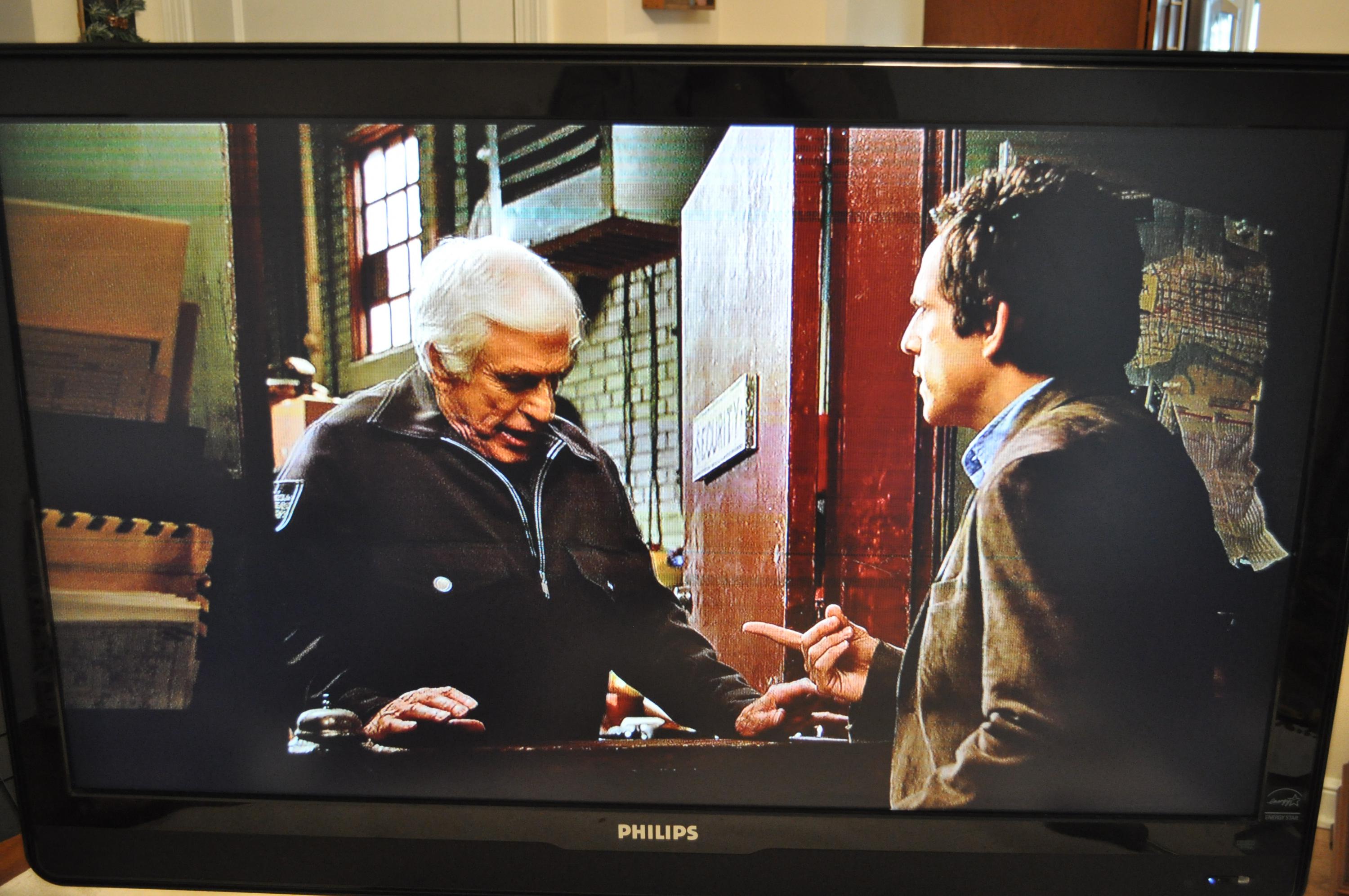

                    Ok I replaced the TCON with a "good" one off of ebay. I now have a picture but it has horizontal flickers as seen in the picture. Most of the research I did still points to a TCON. Do you think this TCON is bad as well?
                      Possibly a bad board... That's problem with eBay
                        Ordered a different TCON same problem. Could a bad main board cause this?
                          Possibly. A panel problem could also do so.
