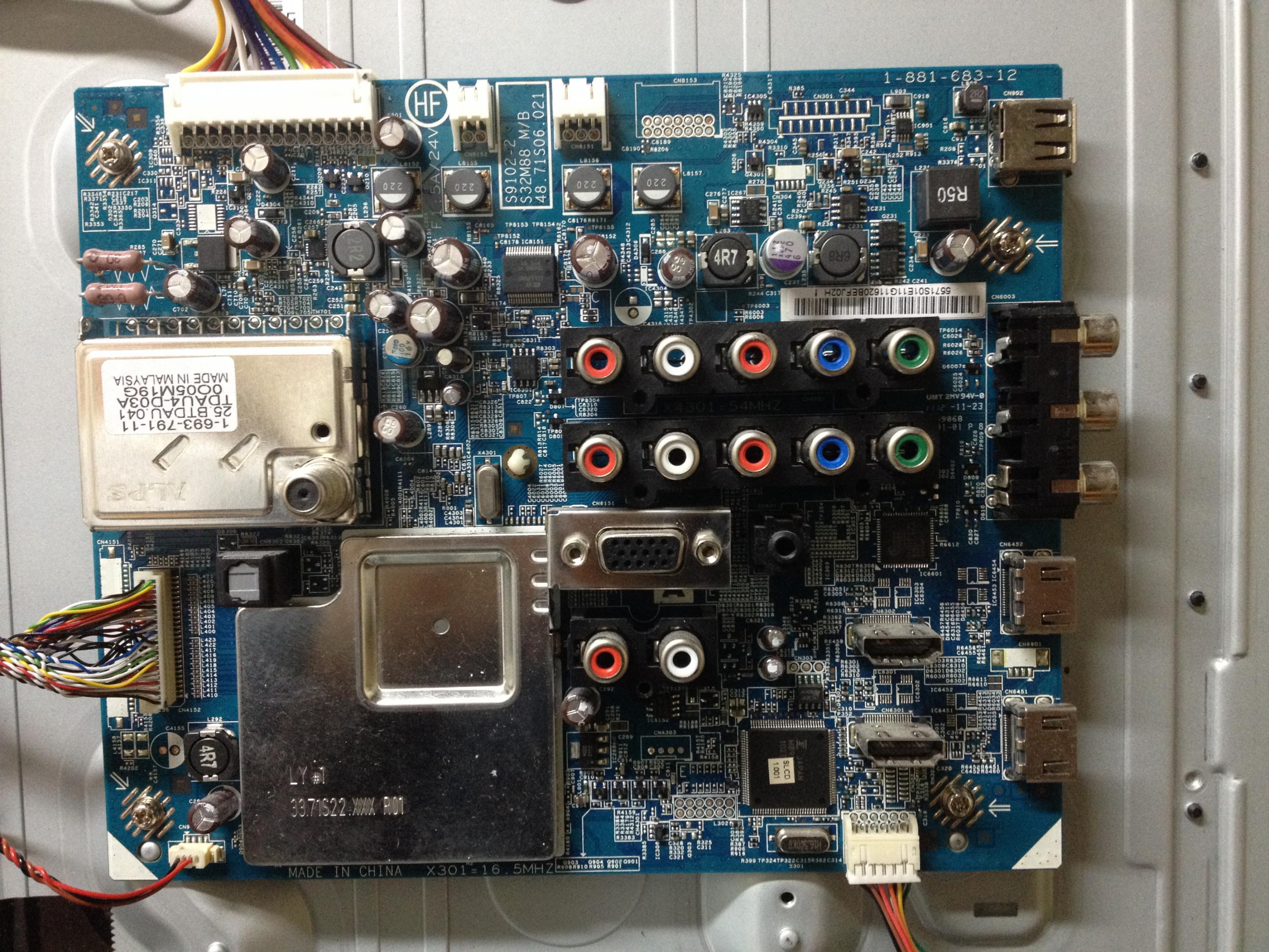

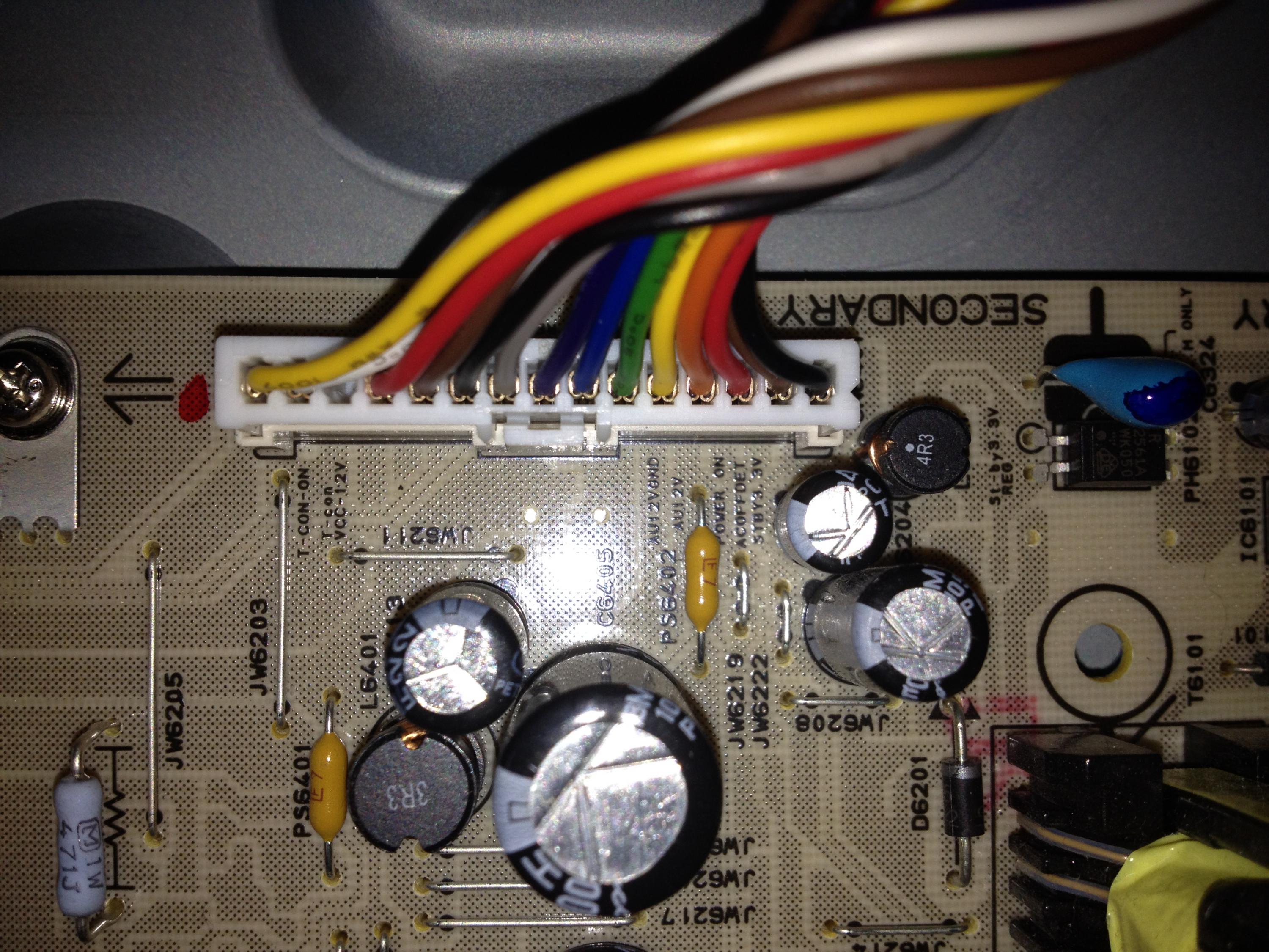

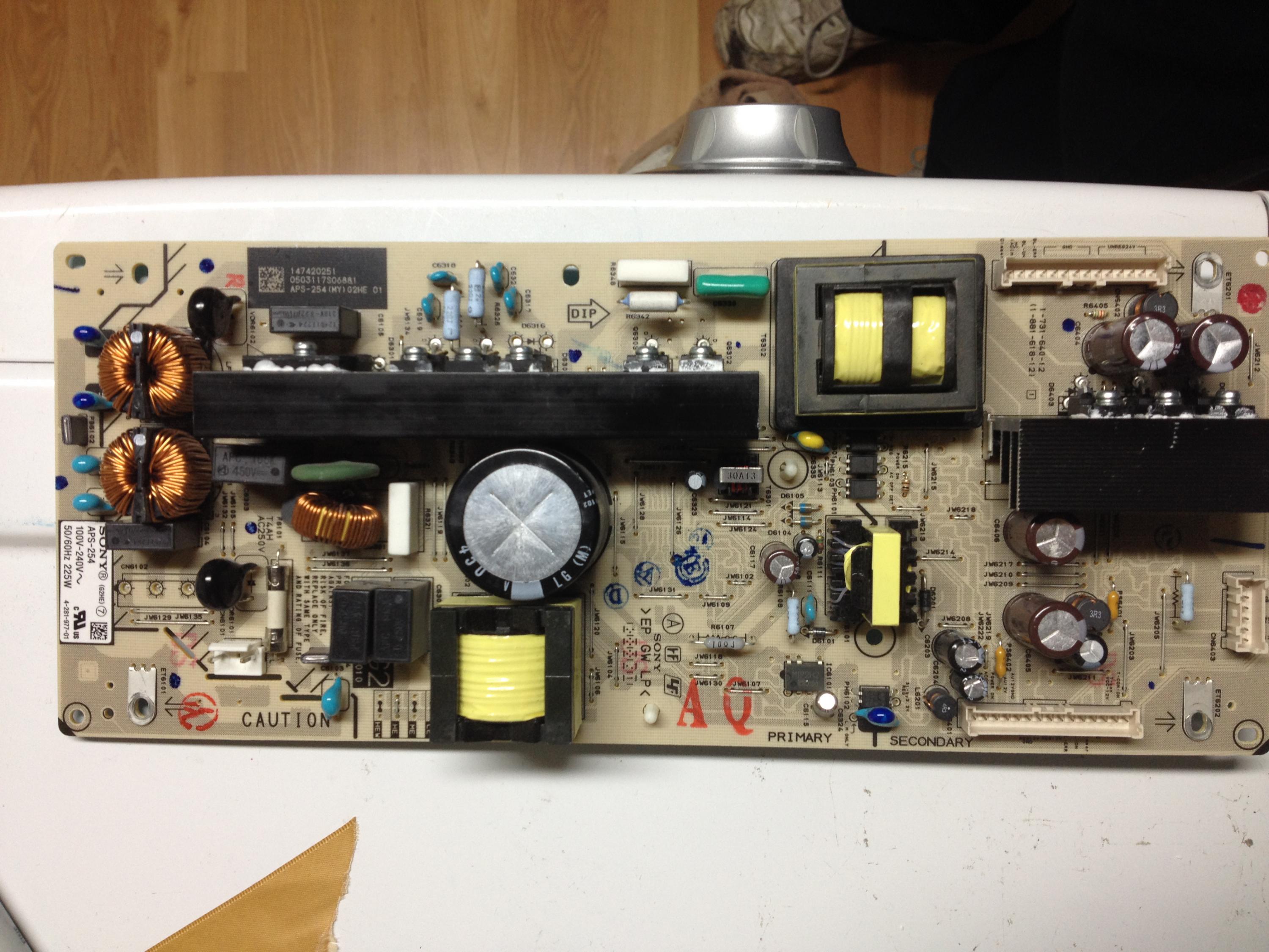

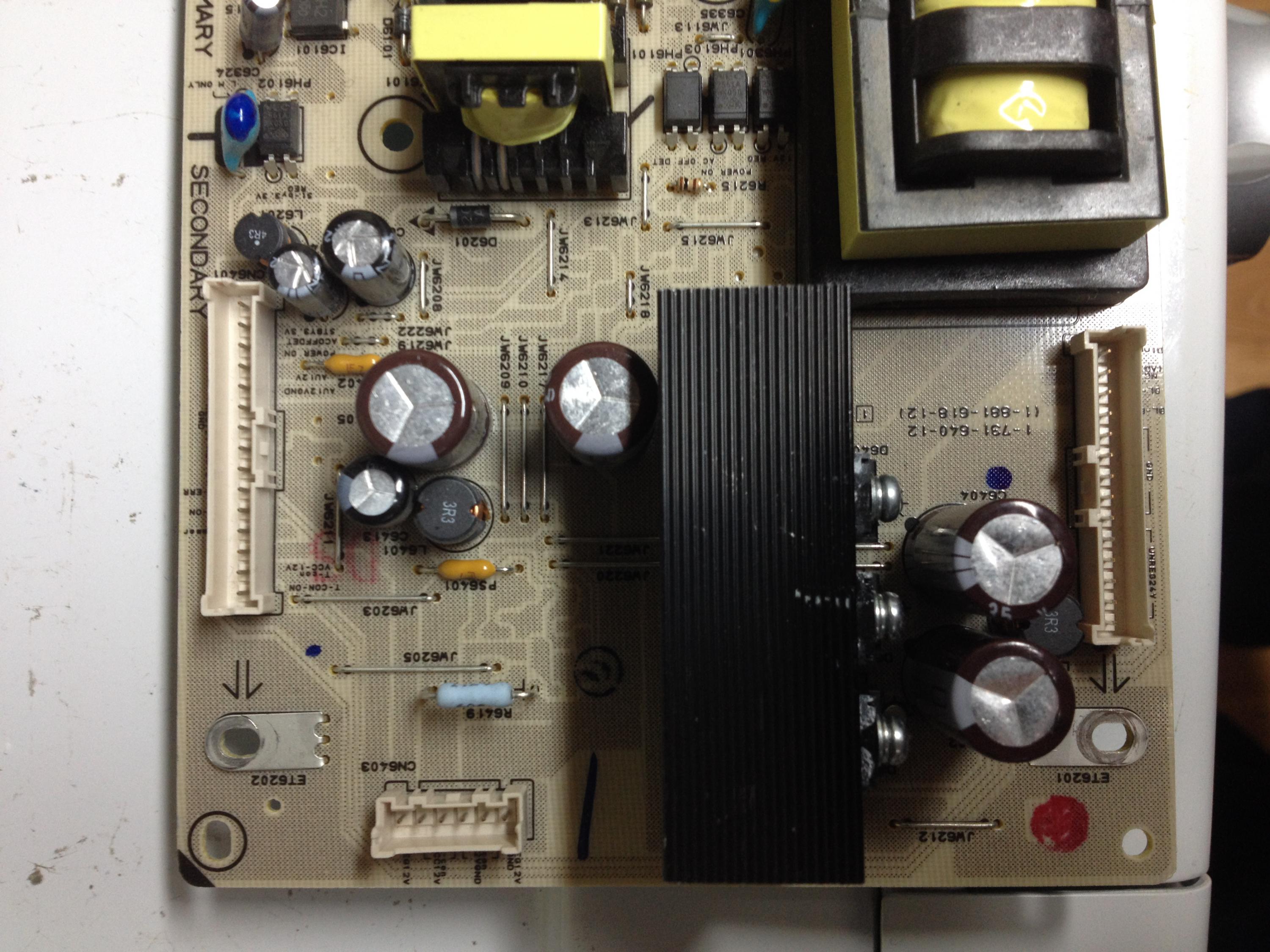

    here are some pictures of the power supply and the main board.

      I received a main board today and it didn't fix it. I did a closer look at the power supply and found C6332 charred. Can anybody help with the value of this capacitor and if there is another one on the board that is can use for this cap. I have another power supply that has the same problem. Thanks for any help.

        Same exact problem with the charred cap. Got a full rebuilt kit including the millipede-looking IC from ShopJimmy and shows NO power (before it would blow the fuse every time). Any ideas?
