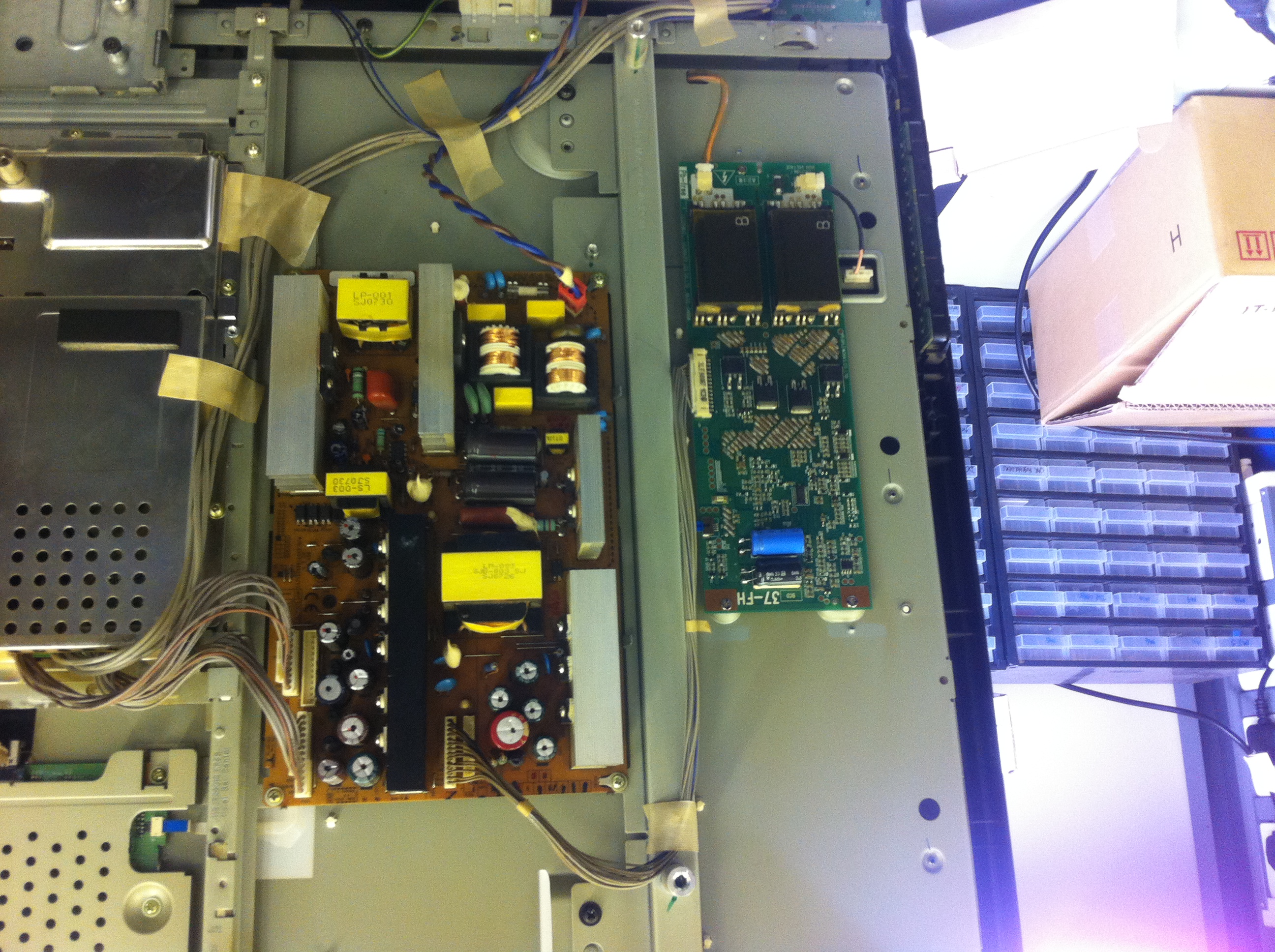

    Good Morning All.
    After searching for my model number and finding a different inverter set from the one installed in my TV and with a different problem I thought I'd post for help in a nerw thread.
    I have an LG 37LF65 which I bought on Friday, The seller said that the TV had sound but no video. It appears to have no damage to the Screen. When powered up I can't see anything with a torch although my light isnt the best and I don't know where the OSD is on these TVs.
    I opened the rear and found that there were two leaking caps 680uF @35V on the inverter board and replaced them with good Low ESR caps.
    I then powered up the TV and got nothing at all. Green light flashes about 5 times, then stays illuminated green. Nothing on the screen with torch. No flash from the backlight.
    I checked all other caps in the TV (main PSU board mainly) and replaced any with an ESR above 0 on my Atlas ESR Meter with a new lower ESR version, Marking each one with a pen mark as I went.
    Powered up again and still found nothing.
    All voltages coming from the Main PSU board are present and correct to labels, I'm seeing a VSync square wave signal coming from the TCon board@ about 100Hz, 24V is present to the inverter board.
    Other voltages are as below:
    Option pin from TCON: Seems to be sending Data to the Config chip during startup and shutdown
    ADIM
    ON/OFF
    BRT
    Status
    All sit low when powered off (and discharge from on fairly slowly)
    When powered all lines are pulled high to 24V.
    I've checked all 4 of the the FETs and none show short.
    The input winding to the transformer is at about 0.2 ohms and the secondary is about 150 Ohms.
    I have a 16W 16CFLD4 but i'm sure its just a standard fluorescent tube rather than a CCFL. Will I be able to test my inverter with this?
    This all appears (Granted to someone new to this) as looking ok?
    Am I looking at a CCFL failure?

    Place the fluorescent tube near the inverter board outputs. Unplug the outputs. The tube should glow slightly for a few seconds if high voltage is present. You might need to use a neon-bulb (small type) in case a fluorescent is too big. The inverter shuts off after a few seconds if no bulbs are connected, so you will have to repeat the test a few times.

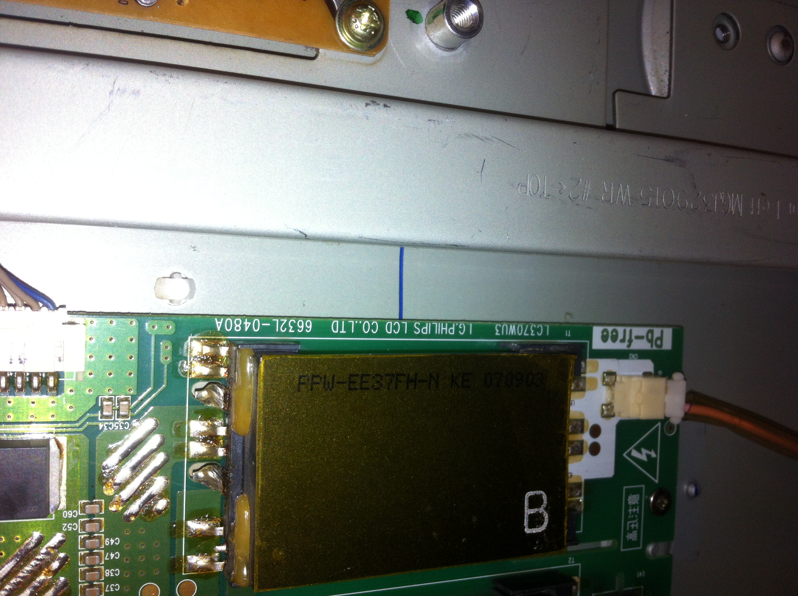

        Tried the tube next to the transformers, not a peep. I can hear a faint detuned channel noise from the speakers.
        Is it worthwhile swapping out the os9966 ic on the inverter board? Do these often go?
        • Repairtechlcd
          • Nov 2013
          • 12
          • Malta
          Re: LG 37LF65-ZC No Backlight
          Check for s/c on the os9966 and give it a close inspection for possible burn marks.I wouldn;t be surprised that it failed due to the ripple caused by those two bad caps you had on the invertor boards.
                        There are many tubes in parallel, tubes would be unlikely to cause this. It's possible though that there's a short inside the panel causing this issue.
                        • Daveatfernie
                          • Nov 2013
                          • 70
                          I assumed they'd be in series as there are only two leads from the inverter board rather than a bank of cables as I've seen in other TVs?
                            If it's an LG panel they are all in parallel. One wire goes to one end, the other goes to the other end. EEFL tubes, high reliability.
                            • Daveatfernie
                              • Nov 2013
                              • 70
                              Ah right, How about the driver IC, Are these known to be reliable?
                                They frequently fail.

                                      I'll swap the IC and hope for the best then...
