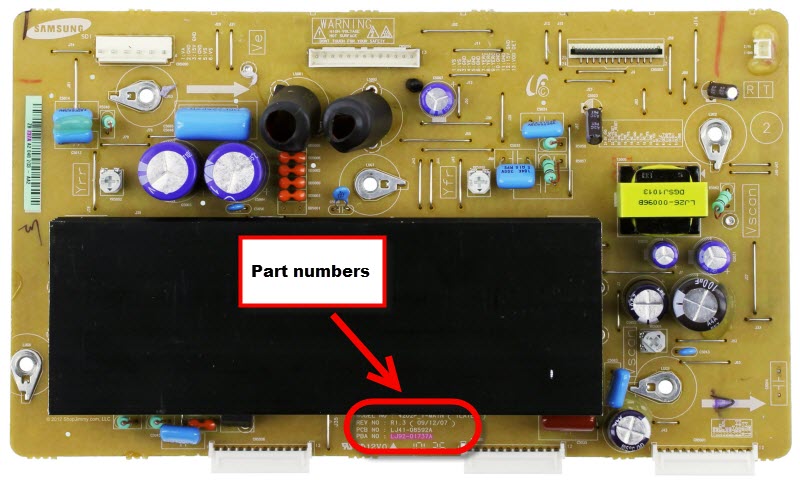

    If your X-main is bad, it could damage the Y boards. It's best to replace them all at once. I've got a few boards lying around from that lesson
    Edit: It looks like you didn't select the correct boards on Shopjimmy.com; all the parts you selected are for the 42" Insignia. There should some part numbers on the boards. You can also enter your TV's model number to try to match parts: http://www.shopjimmy.com/catalogsear...q=ns-50p650a11

      Oops, this whole time I didn't realize I had entered in the 50" model. I have the 42" model, Insignia NS-42P650A11. So the parts should be right now that I corrected my mistake?
        Re: Insignia NS-50P650A11 clicks
        Yes, I believe those are correct. Check your boards to be on the safe side. Also, yes, the firmware should be updated after you install the boards. I can't remember if I was able to find the Insignia firmware on their site - don't believe so. There could be an available Samsung update, since this is basically a Samsung TV, but I'm unsure of compatibility.
