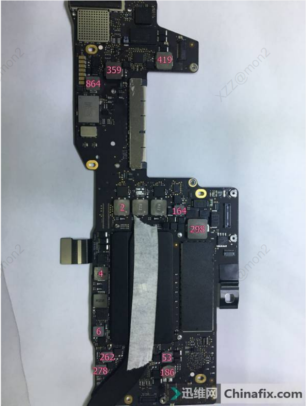

    Hi everyone.
    I have MacBook Pro A1708 with a confusing issue.
    The laptop doesn't turn on. Strangely, the trackpad clicks and fan spins. Caps lock doesn't turn on and no chime.
    Initially, the amp meter didn't turn on at all on one of the usb c ports. On the other port, I got 20V and half an amp tho (no battery connected).
    I replaced the bad CD3215 chip and now it works as well. Both ports turn on with same amp readings.
    The initial issue however remains.
    No boot. No backlight. No chime. No keyboard. Only signs of life are clickable trackpad and fan spin.
    Amp meter shows 20V and goes up to 0.55 amp and after a few seconds stays at 0.49 amp.
    With battery I get same results but ofc since the battery is charging, the amo meter goes to 2.1 amp.
    Disconnected trackpad with no luck ofc. SMC reset using keyboard works as the amp goes to zero and back to half an amp again.
    Board history not known but the bored was in pristine condition. No marks of water damage or corrosion. No prior repairs most probably as well.
    Bad CPU maybe? Anyways to confirm?

    What is the voltage of PPBUS_G3H? Is it stable?

      13.12V and stable.

        What is the voltage to ground of ALL_SYS_PWRGD?
        See attached on inductor check measurements. Believe these are performed in DIODE mode. Red meter probe to ground. Remove all power. Black meter probe to the inductor to test.
        Post any suspects.

          ALL_SYS_PWRGD is 3.24v​
          I checked all the inductors and wrote my measurments on them.
          I see maybe 3 or 4 suspects! But specifically L7900 and L806 seems to be too low. L7030 seems to be a bit too high as well.

                No. To me, the diode readings will be much lower if the CPU is fried. Also, the power good signal ALL_SYS_PWRGD​ = '1' so this is a good sign which implies all power rails being monitored by this circuit are within specification.
                What is the history of this board? Would you have access to a known good bios for testing? There should be some in the bios forum. Be sure to backup the original before erasing and reflashing. If required, can check my database of the same.
