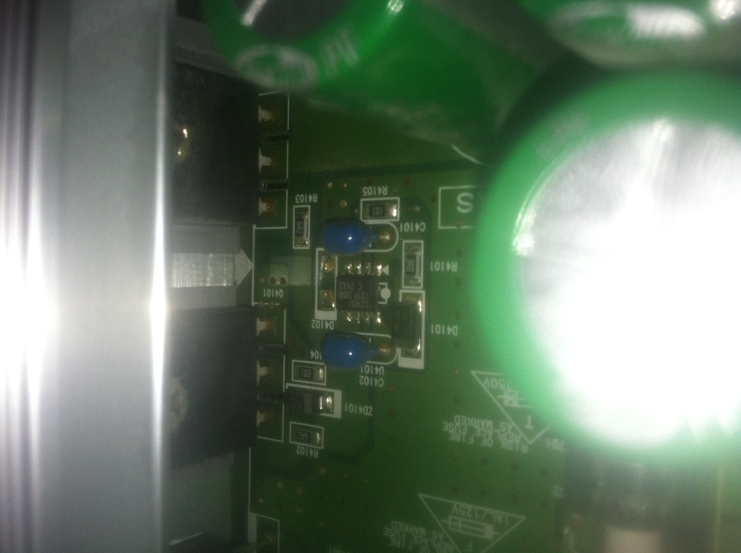

    Hi I recently picked up a vizio vp50 with samsung boards. I have no video and no sound when the tv turns on. It does stay on. I checked the voltages with a DMM and they were all reasonable. I inspected for bulging caps and found none. anyone have any idea what I'm up against?

    Which voltages did you check?

      Re: Vizio Vp50 hdtv20a no video no sound
      I checked ve and vs. not sure where va is
          Okay so I went over the boards and the only thing I found was a missing diode on the z sus board. D4012. Now I'm not sure if there is supposed to be one there but by the looks of the solder it looks like there was one there before.
            Did you have any luck with the set yet? I'm working on a couple of these that both have no picture and no sound. I replaced all the bad caps in both of them. The voltages all seem fine Y an Z heat sinks get warm (but not very warm) but the long heat sink on the bottom of the set stays very cool. It appears that it's working (green light stays on).. No sound on any input select. Both the Y and Z boards make a hummm when its on.
