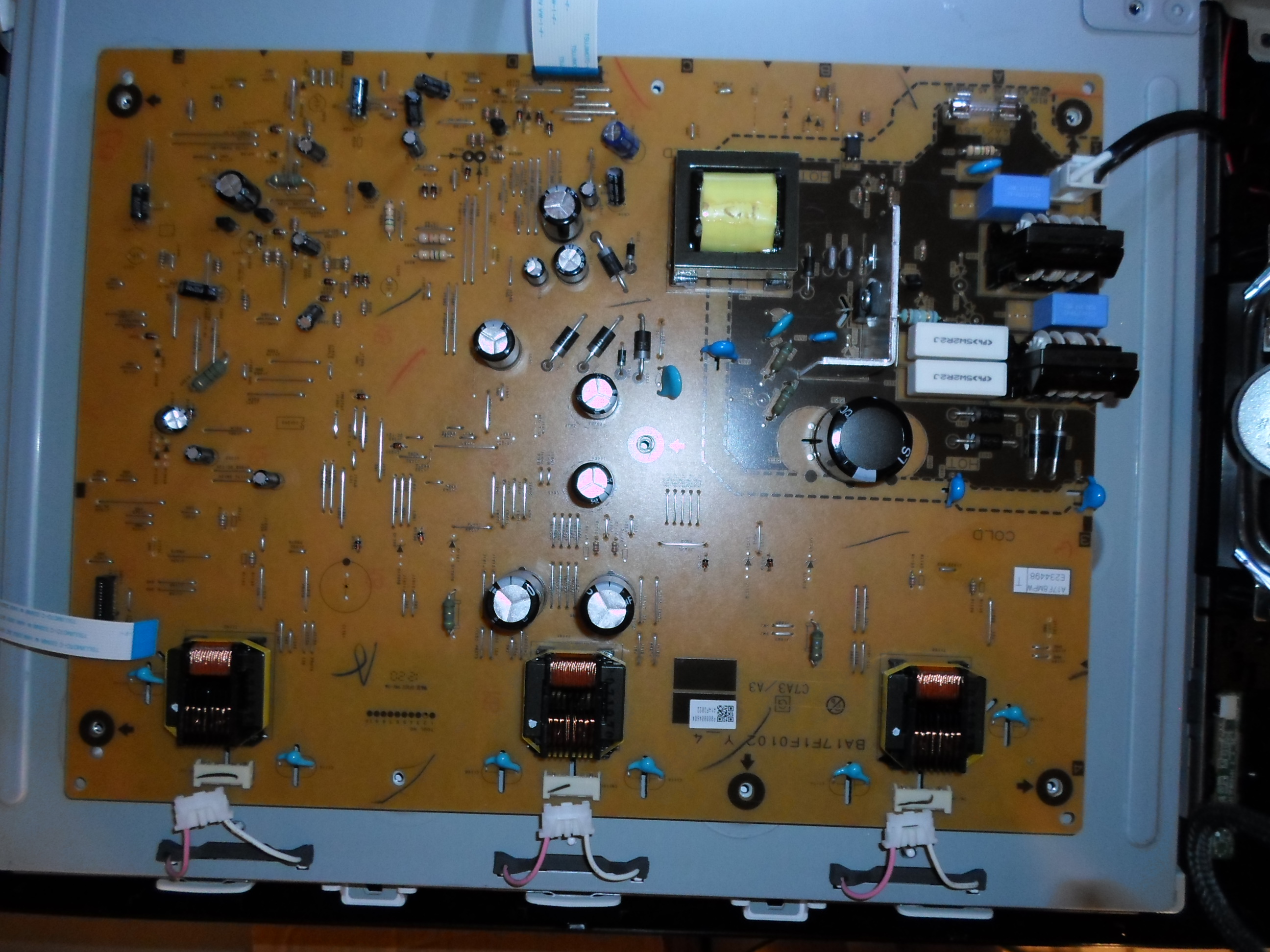

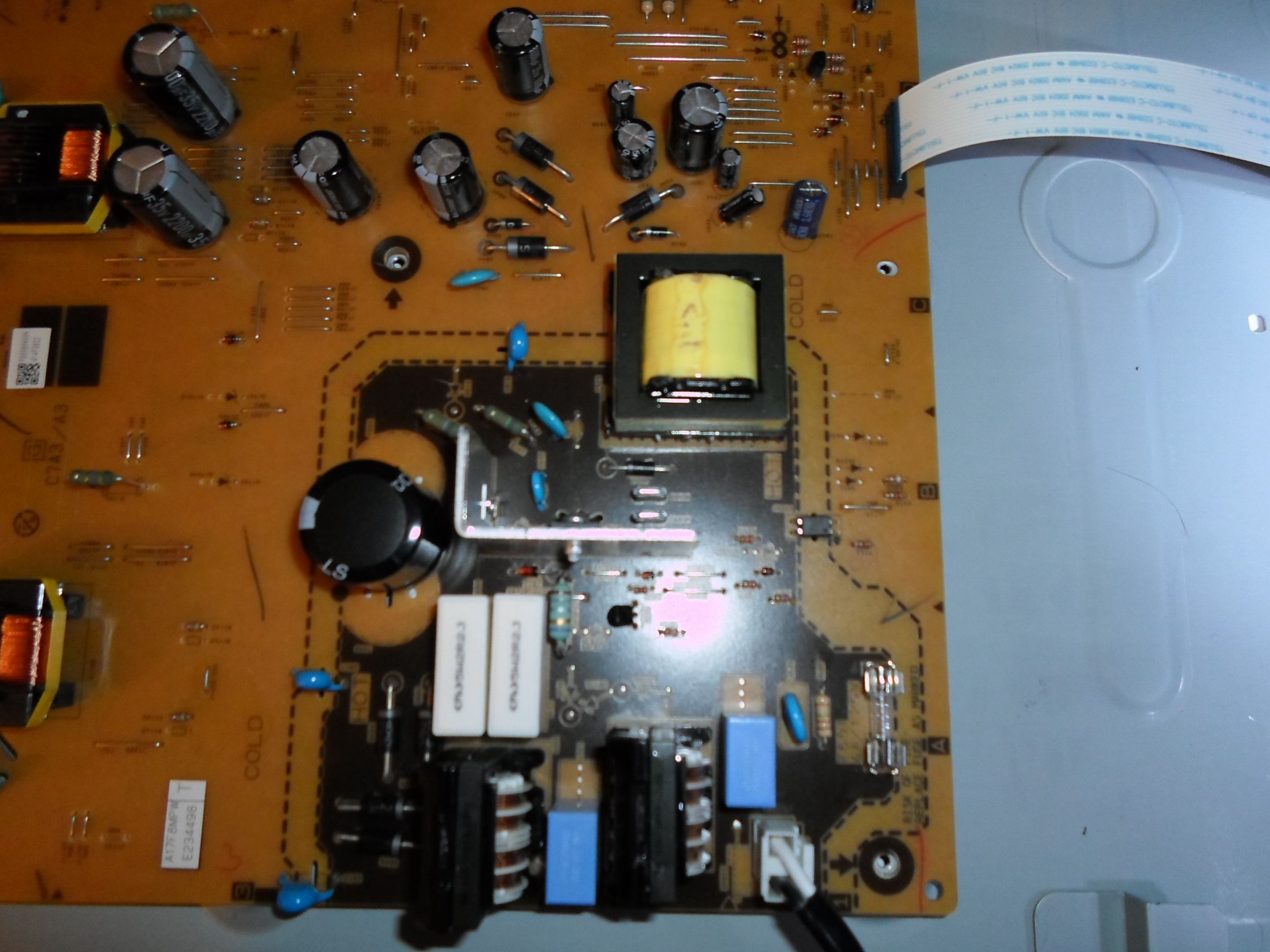

    TV was dead, and main fuse open. Had worked on a few these before, so was hoping just a bad diode or 2. Found these usual suspects to be bad and replaced:
    F601 (4A 125V)
    Q601 (TK10A50D)
    D610 (1ZB36 36V 1W ZENER)
    D640 (SS210-TP)
    R608 (PNP300JR-73-0R18)
    TV still dead. Fuse is not blowing now though, and have 165VDC at main cap.
    Tried replacing Q600 and IC601 photo coupler just because I had the parts. Still dead.
    I suppose there may be an open resistor but I haven't found it, and down have schematic.
    Anyone familiar with this one? I see many posts before, and have checked all regular failures..

    Did you test anything on the secondary side yet?
    Did you test those white ceramic power resistors also?

      Ive tested most diodes on the secondary side. Ill look some more and try to find some voltage test points.
      Anyone know what chassis this model is to try to find a SM?

        Hmm I see, it looks like D610 36V zener shorted again.

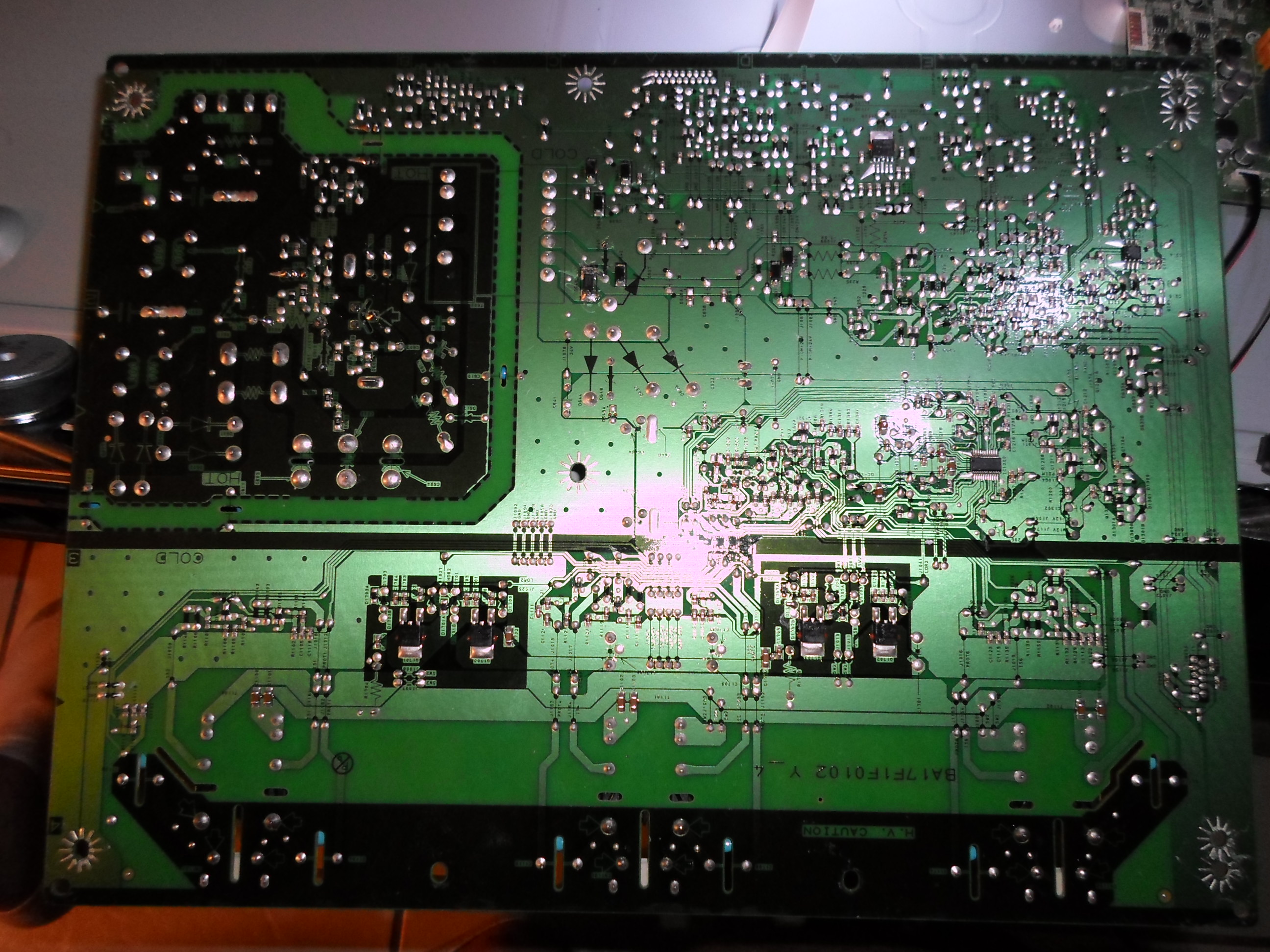

            After lifting D610 and D607 they both still test good and I still get 165V across main cap. I tested the main board connector pins for short to ground and everything was good.
            How can I further T/S now that nothing is blowing up when plugged in? I was thinking of removing the transformer T600 as when I test each cold side pin of it to cold ground it shows a short, is that normal?

                  Are the Diode in the secondary side are all OK, they are known for shorting out and will cause the primary side circuit to shortout, this is about the same circuit you have worked on before but may have difference values for the parts.
                  This is an interesting read, I think his original problem caused by shorted in the secondary side to begin with which caused him to blow up the new parts as well. When this circuit shorted out, it will take lots of parts with it.Make sure to check the opto also.
                  http://elektrotanya.com/?q=hu/conten...t-start-solved
                  By the way the reisistance of the power transformer will show low resistance (DCR), the transformer is fed with AC so the impedance will be much higher than the DCR (DC Resistance).

                    That was good reading, but my board does not have that diode on the secondary and I just spend an hour or so and could not find anything bad on the secondary side unfortunately. I also get no voltage on the secondary side anywhere, where I have the 165V across the main cap, so I was thinking maybe it was the transformer. Could that be a possibility?

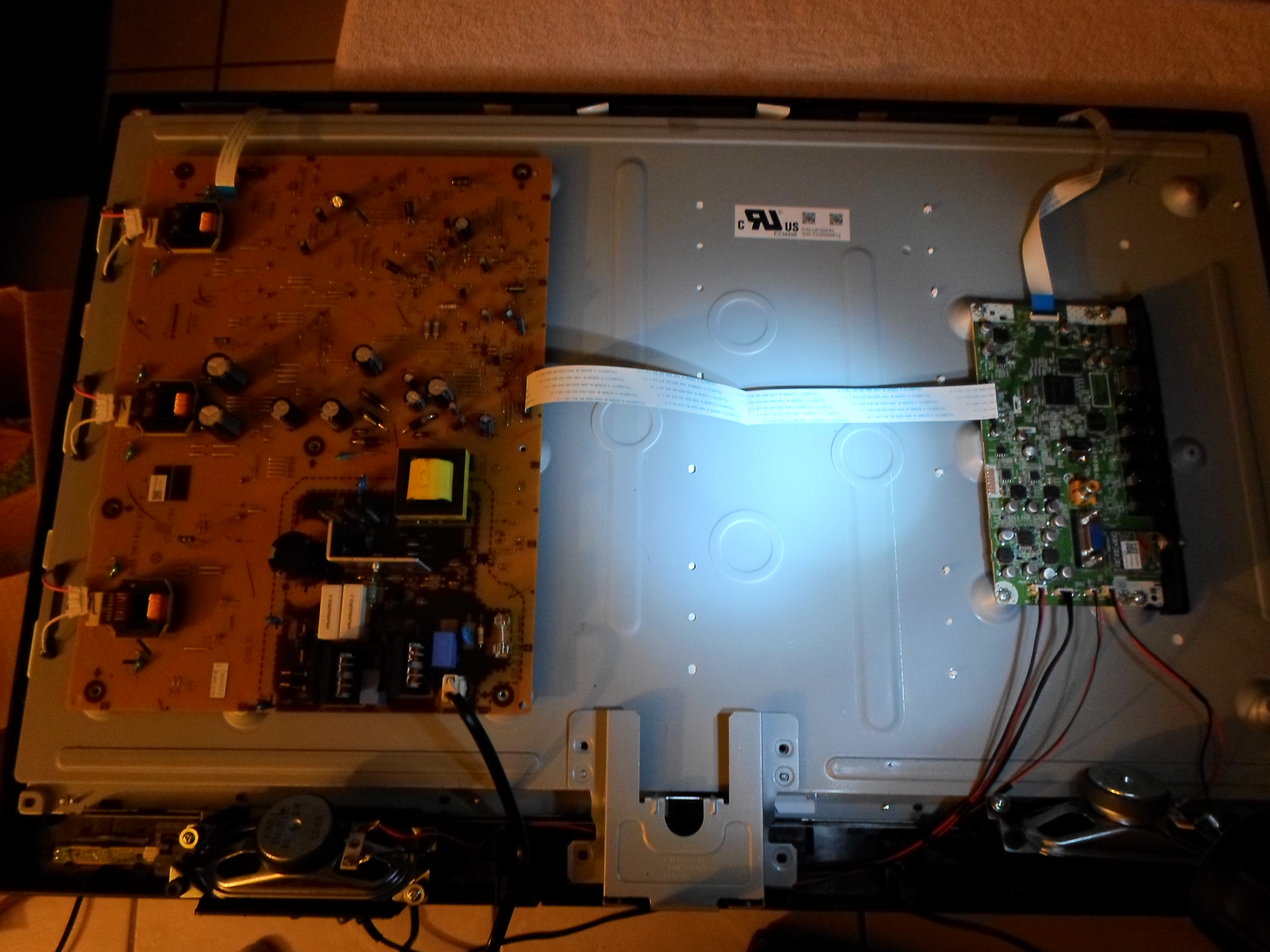

                          Received similar revision PS board and TV worked. Swapped the suspected transformer but that wasn't the problem. Unfortunately unable to determine what was wrong on the original board besides what I changed, so I'll run with the new PS board for $25.
                          Bummer, was hoping to find the fault.

                            If this helps anyone. We just came across an Emerson LC320EM3F and, it would power on and light up for a second then blink red light constantly
                            After a lot of testing voltages we found that it had a broken florescent bulb after replacing the bulb walla working again
                            Just thought I would ad this in the event someone comes across this problem
                            Obviously according to my research this is common with these TVs
