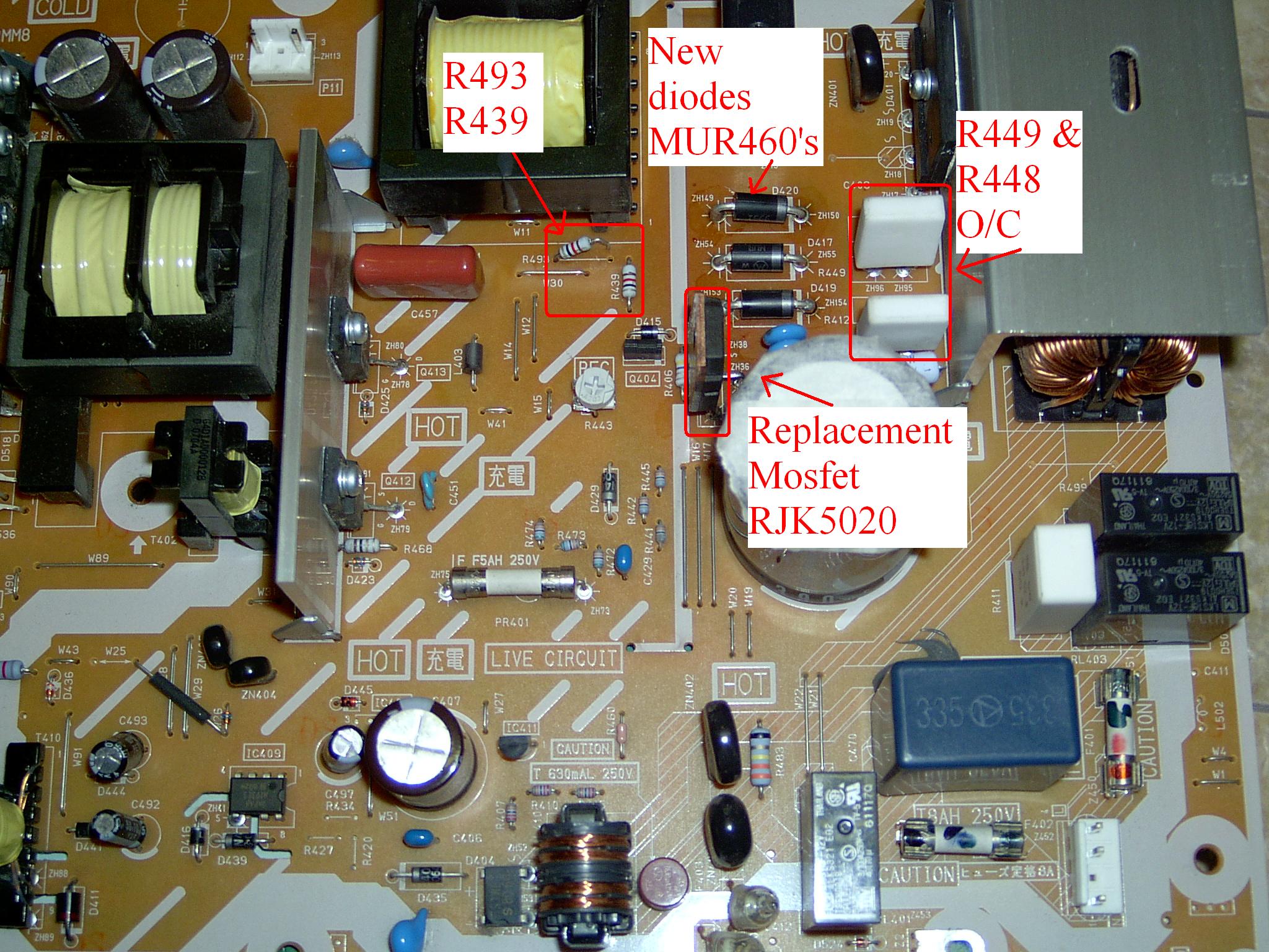

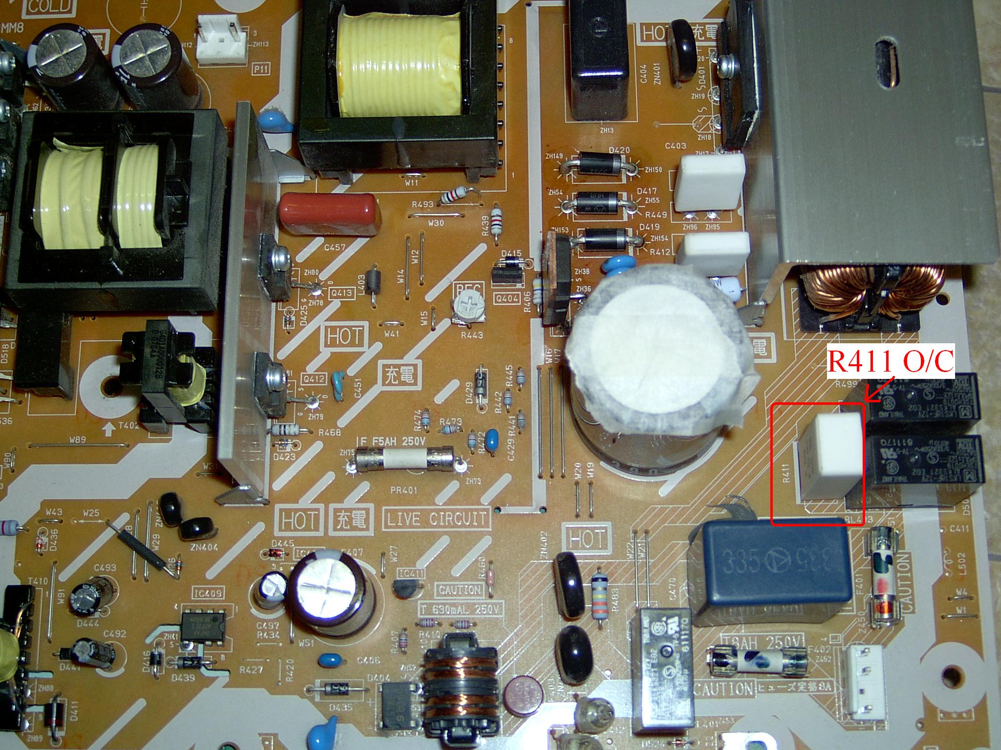

                  Update time. I feel i am in need of some further help.......10 blinks now.
                  With reference to the video that Tom posted above - https://www.youtube.com/watch?v=OuykZxLURis.
                  Before even looking at the tv i pre-ordered a replacement Mosfet, (RJK5020), along with the 3 x MUR460 diodes. I also ordered a replacement bridge rectifier, just in case i needed it. I was hoping this would be an easy fix i could do with the tv still at my daughter-in-laws house, instead of having to lug it back down to Devon with me.
                  I looked at the tv at the weekend, and sure enough, the mosfet was indeed shorted out. The shorted component was a RJK5010, which i replaced with the RJK5020 that i had - i presume that this would be a suitable replacement? Please correct me if i am wrong.
                  Like in the video, i checked the large diodes that are connected in parallel, i only had 2 on my board, and both checked out ok. But i decided to change them anyway - seeing that i had replacements. My board only had 2 of these diodes fitted, (SBK69) but the holes where there for a third one - like in the video, so i went ahead and fitted all 3 of the diodes (I replaced them with the MUR460), i figured that seeing that all of them are in parallel it would do no harm, again, correct me if i am wrong.
                  I also checked the other components that the guy checked in the video, i believe these are connected to the fet that i have just changed. All of them seemed to check out ok.
                  R406 - 5 ohm
                  R439 - 11.9 ohm
                  R493 - 12 ohm
                  D415 checked out ok, and i found no shorts on Q404.
                  From the information in the video, all of those readings seemed good, and hopefully meant that it was just the blown fet.
                  After changing the fet and the diodes, i reassembled the power board back into the tv and plugged all cables back in. I then plugged the set into the mains and turned it on. I heard relays clicking a couple of times, this was followed by that unmistakable sound of something shorting out. I did not see any magic smoke, but did smell a bit of it briefly. Unfortunately i was standing in front of the tv at the time i turned it on, so did not have chance to see any evidence of the fault location.
                  The 5 amp mains fuse however did not blow, neither did any of the fuses on the power board. But all i am getting now is the ten red blinks when i push the power button, these follow the green light flashing a couple of times, along with a couple of relay clicks.
                  I took the power board back out of the tv to give it a visual check - looking for any sign of a burnt component. I could find nothing obvious. I then made some checks with my meter. The mosfet i had replaced was not shorted, neither were the diodes. I also checked carefully with my magnifying glass to make sure i had not splattered solder and caused a short somewhere. all looked ok.
                  I then discovered that some of the components i had checked earlier were now damaged.
                  R439 is now reading 'open circuit', but no visible signs of burning.
                  R493 is now reading 22 ohm (was reading 12 ohm before), again, no sign of burning, but obviously it is now damaged.
                  Both of those are 12 ohm surface mount resistors.
                  This time around i also checked the two large white 5w 0.12 ohm resistors that sit beside the diodes i changed (R449 and R448), both of these are reading 'open circuit'. But because i did not check these out before i fitted the new parts, i cannot say if they were blown before or not.
                  So, by replacing the Mosfet i have gone from having a dead short that was blowing the mains fuse, to a 10 blink code with at least two components damaged when i powered up - R439 and R493. And of course i have discovered that the two large 5w resistors are open circuit.
                  How do you guys think i should proceed from here? Obviously i need to replace the parts i know are fried - R449, R448, R439 and R493.
                  Could it be that the two large 5w resistors were originally blown open when the original fet shorted out? And that powering the set back up with those blown 5w resistors still in place caused the damage to the previously good R439 and R493?
                  Also, could the fact that i replaced a shorted RJK5010 with a RJK5020 cause a problem? Or could the fact that i put three diodes back in place of the original two cause a problem?, bearing in mind they are all connected in parallel.

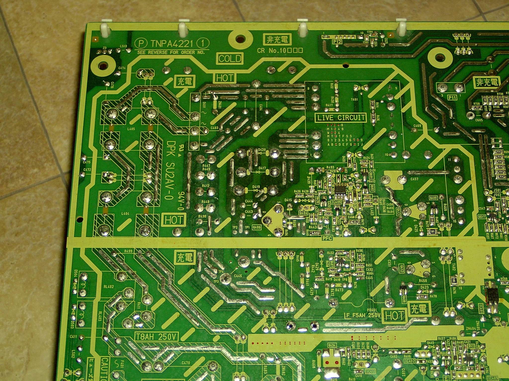

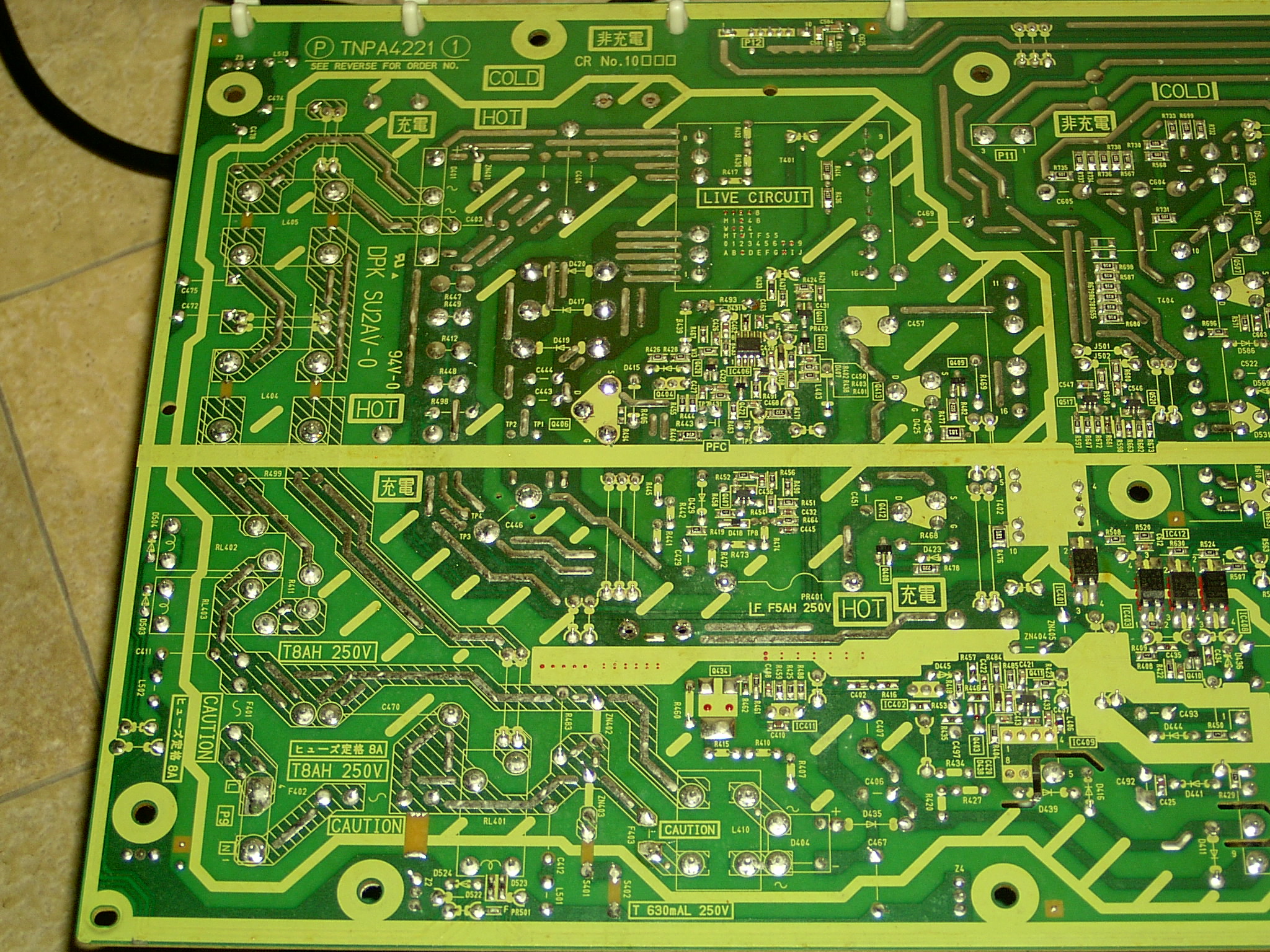

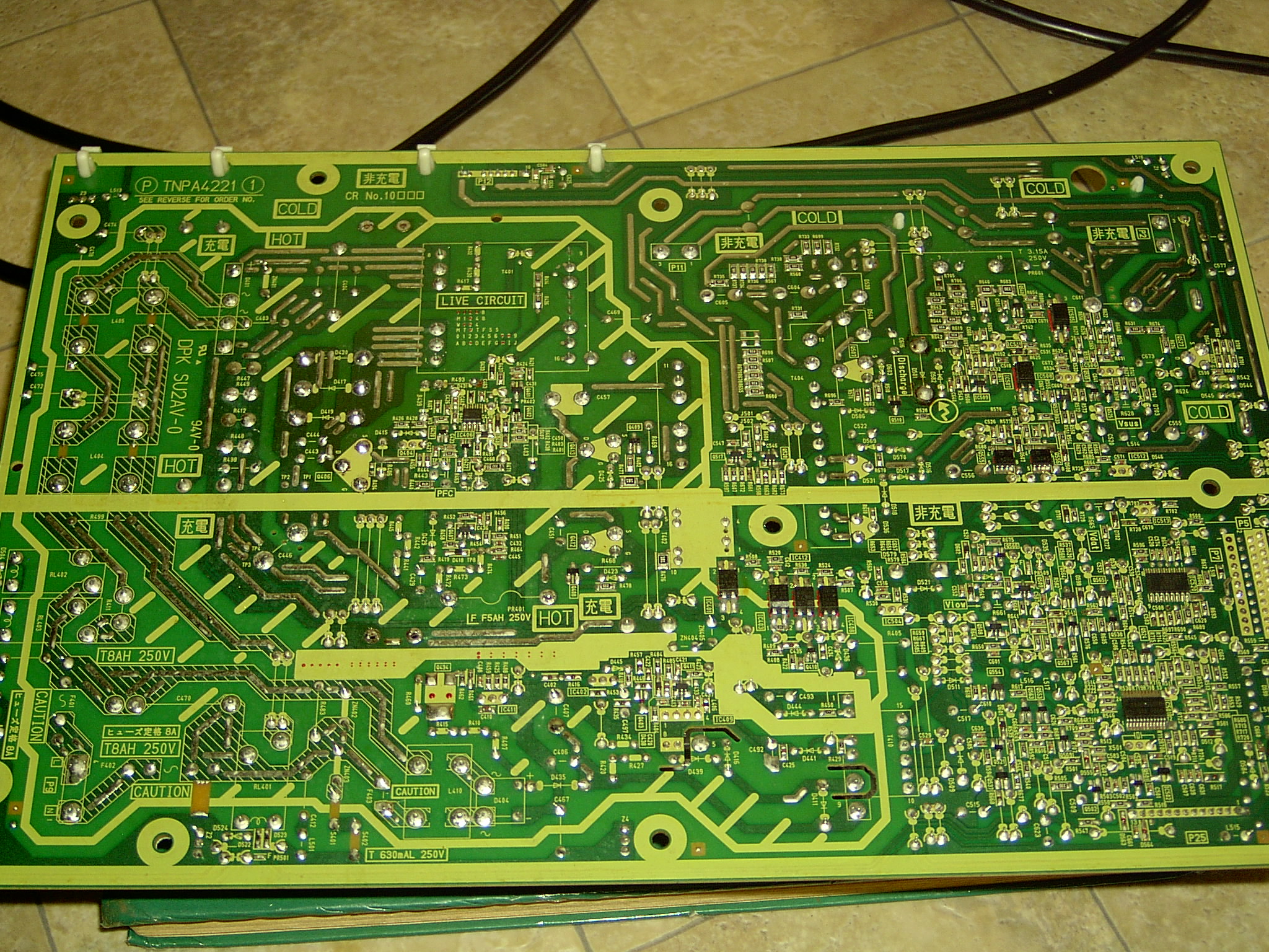

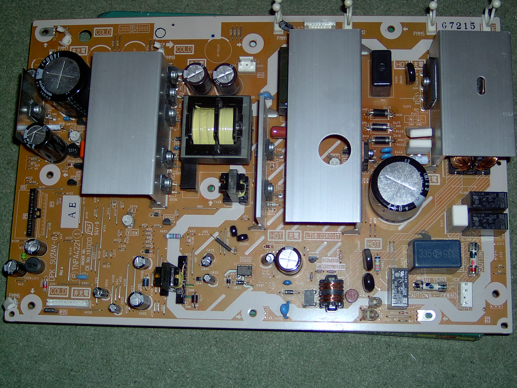

                  Once again, any advice on how i should proceed will be much appreciated. I have attached a couple of pics below.
                  I have marked the components concerned in one photo (Heat sink removed for better view). Also please ignore the tape on top of the mains filter cap, that was just to stop reflections from the camera flash.
                  EDIT: Yes, i know that one leg of R493 is not attached in some of the photos, i wanted to confirm that the resistor was in fact reading 22ohm, rather than the 12ohm that it should be reading.

                    Been doing some more checking. I have found another of the large cement resistors to be open circuit, this one is R411, a 5w 10ohm.
                    So that is all 3 of the cement resistors on the board reading open circuit. Is that something that is possible with the faults i have had? Or am i doing something wrong when trying to measure this type of resistor. I am just using my normal meter on it's 200ohm range, i am not getting any reading at all. I have checked that the probes are making good contact with the pads. But all three of these cement power resistors are giving me an open circuit reading.
                    this is a photo showing R411, which my meter is reading as being open circuit. Question, this type of resistor should be measurable with a normal meter set on a low ohms setting?
                    All help greatly appreciated guys.

                              Re: Panasonic TH-42PX70B Blowing mains fuse.
                              Just to clarify.
                              Before i fitted the new main mosfet i checked R493 and R439, they checked out good. I also checked D415 and R406, they were good. And Q404 was not showing any shorts, so i assumed it was ok.
                              But after fitting the new mosfet and trying to power up the set, i found that R493 and R439 had gone bad, one completely open circuit, the other had nearly doubled it's resistance value.
                              So like you, i am also a bit confused, i know the insulator was in place because it's stuck tightly to the heatsink. I am kicking myself for not checking those large 5w ceramic resistors before i tried to power it back up, it might be useful to know if they were already blown, or they blew when i applied power.
                              I have done some checking on the board, but have not found anything else that is shorted or blown open, but when it comes to something like a chip, i really would not know how to check it. I notice that there is a small 8 pin smd chip very near to the Q404 circuit, i am wondering if that's been damaged in some way.
                              I am wondering if i would be better off getting a replacement board, i might end up spending £20 on parts and postage, only to find that it's still faulty. It is annoying, the parts cost pennies, it's the postage that stings.
                              I will keep looking tonight, if i can find the parts i know i need, then i will order them, if i can't find them i will probably grab a replacement board from ebay, there is an 'AE' version on there at the moment for £30 + £10 postage, i am very tempted.
                              I will let you know. Thanks again tw2005, i will keep you informed on how it goes.

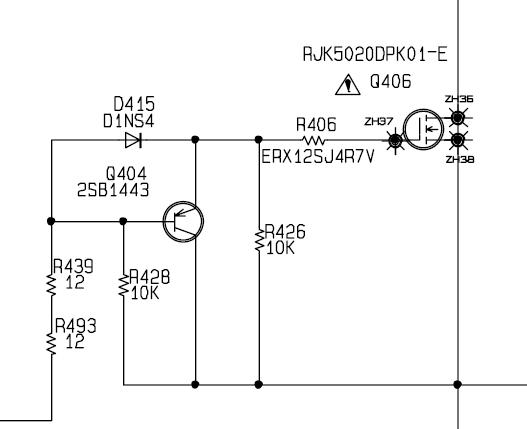

                                Have started looking through the schematic for the P board, have come across something that's really confused me.
                                You will remember that earlier i had noticed that both R448 and R449 were both o/c, they are the 5w ceramic cement ones. this is what is written on the actual resistors...
                                5w 0.12ohm
                                According to the schematic, they should be either 10r for the AB / AD / AG / versions of the board, or 12r for my AE version of the board.
                                So am i interpreting the numbers wrong on my R448 and R449? Or have i actually got 0.12ohm resistors instead of the 12ohm that is stated in the schematic?
                                I was about to order up some 5w 0.47ohm ceramic cement replacements, hoping that they would be close enough to the 0.12ohm that are blown, now i am left wondering what to order?
                                Any ideas?
                                  As far as those 0.12ohm resistors go, you've mixed up what the schematic states. In cct yes they simply have 12 so you could think 12ohms. The parts list definitely tells you 0.12 ohm 5w, the note in the schematic actually says R10 or R12 not 10R,12R.
                                  Treat the R as a decimal place, so R12 = 0.12, 12R = 12, 1R2 would be 1.2
