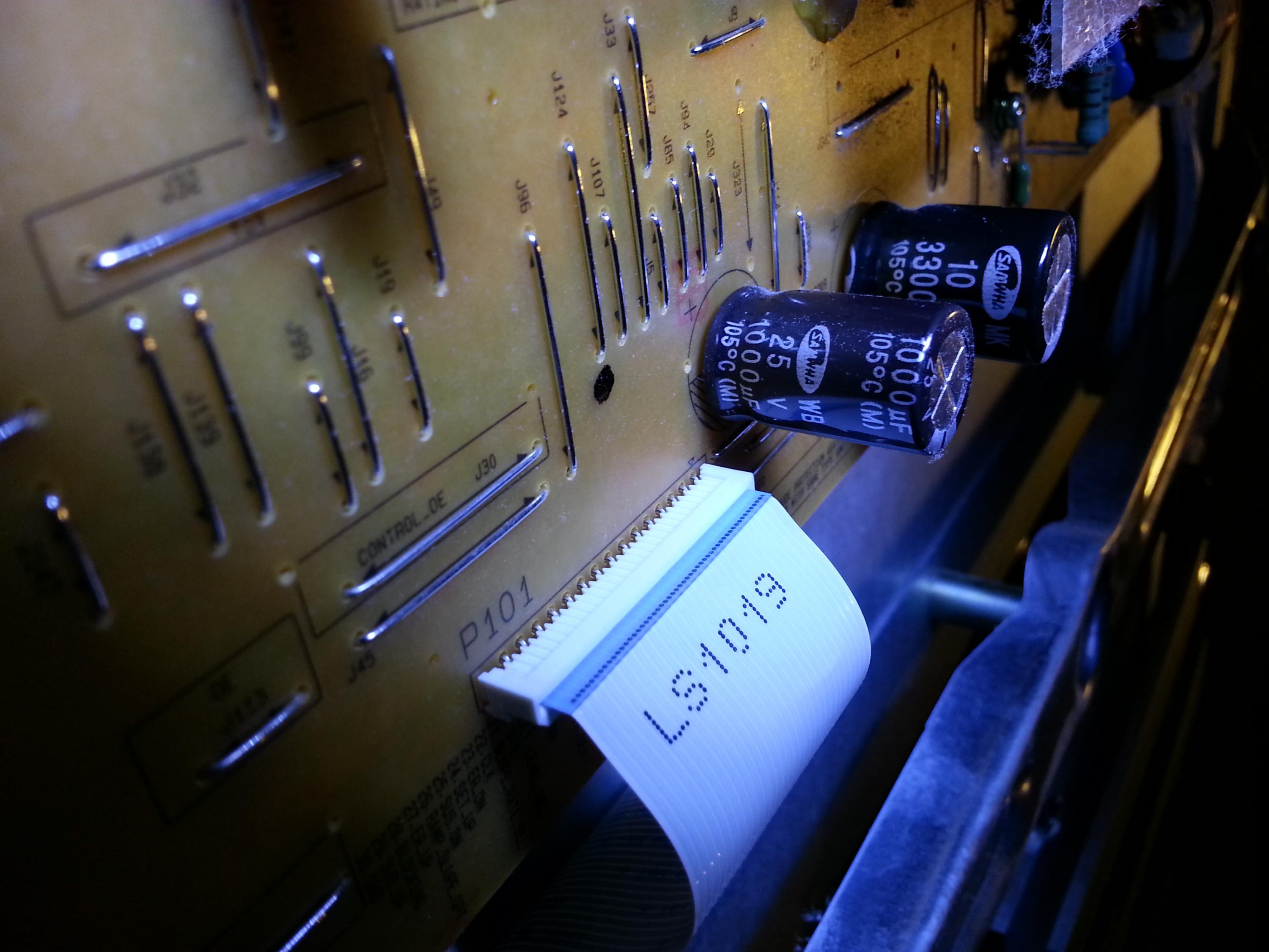

          Ok so upon further inspection I noticed I seem to be missing a capacitor on this board c105 ga102 ga517 it's in the location right next to where the long flat white ribbon connector is corner from the long aluminum/chrome heatsink is. you can see in this photo the capacitor is shown. Does anyone know what size that capacitor is ?

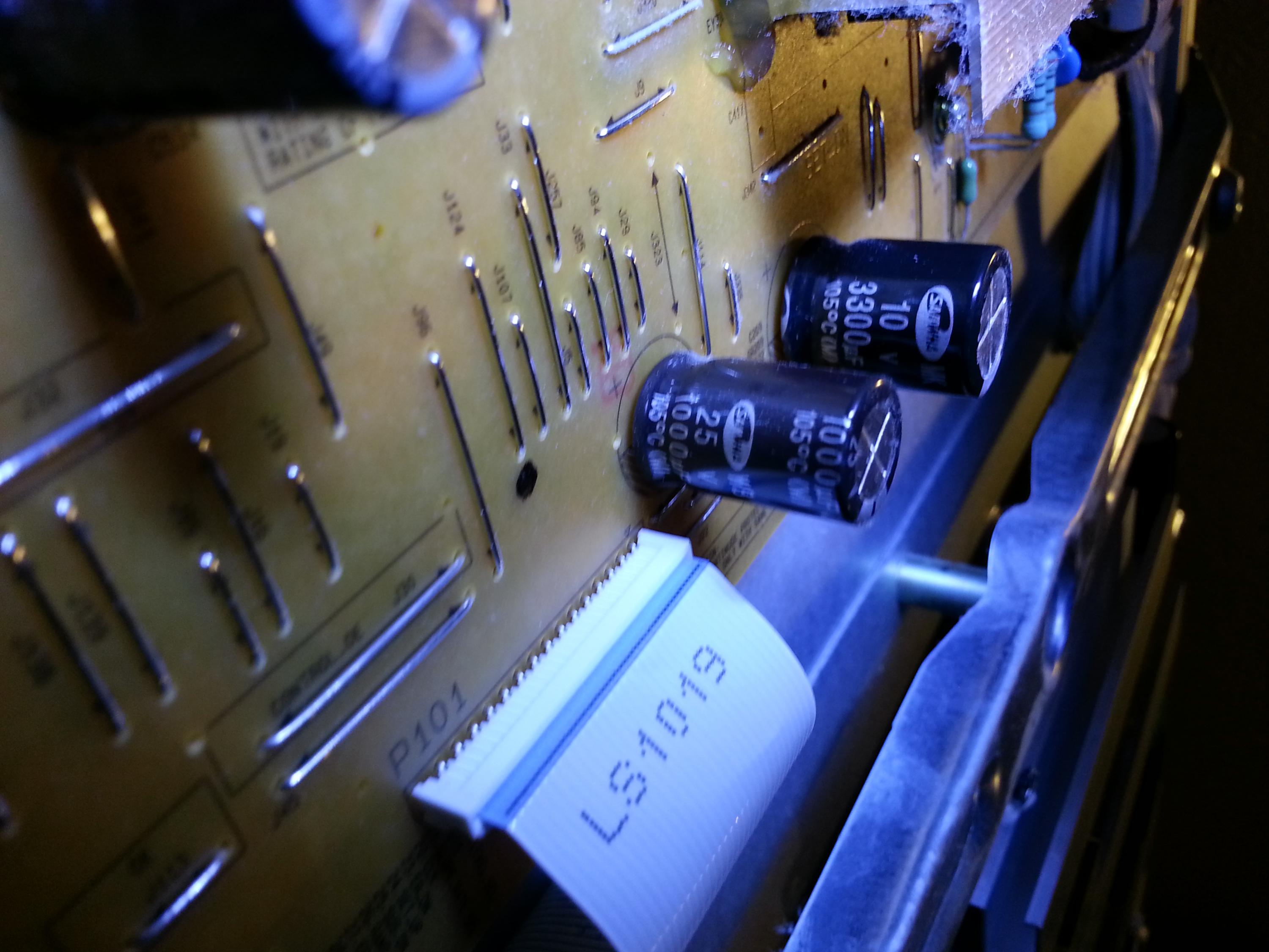

                I will absolutely keep you posted Soog. I ordered a new Ysus board tonight though the place I ordered it from now shows none in stock and a very different price so I am a little worried they may not have the part I ordered. I will get it figured out one way or another and will post back with an answer. Have you tried unhooking boards 1 by 1 yet to see if there is a shorted board elsewhere. when I removed the large white thick cable connector going to the Ysus board (Big board on left if looking from the back) to the power supply board (big board in the center ) the TV would suddenly not click back off or cycle like it does if it's connected. obviously only disconnect them when the power plug is off and all residule power is cleared. Does your Ysus board have the 2 capacitors I mention in the post above ? if so could you get me the numbers from the one circled in this photo

                  Manufacturers sometimes change production runs, like for example removing a cap, without changing a part #.

                    Here is the capacitor your looking for.
                      Re: Z50PJ240 Powers on then back off clicks but no picture
                      This one is a little clearer. Still sideways though, sorry.
