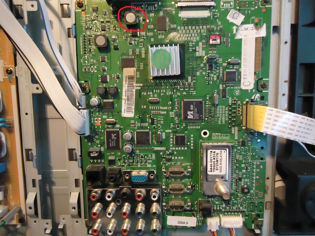

        The inductor gets hot by de ripple,check it.

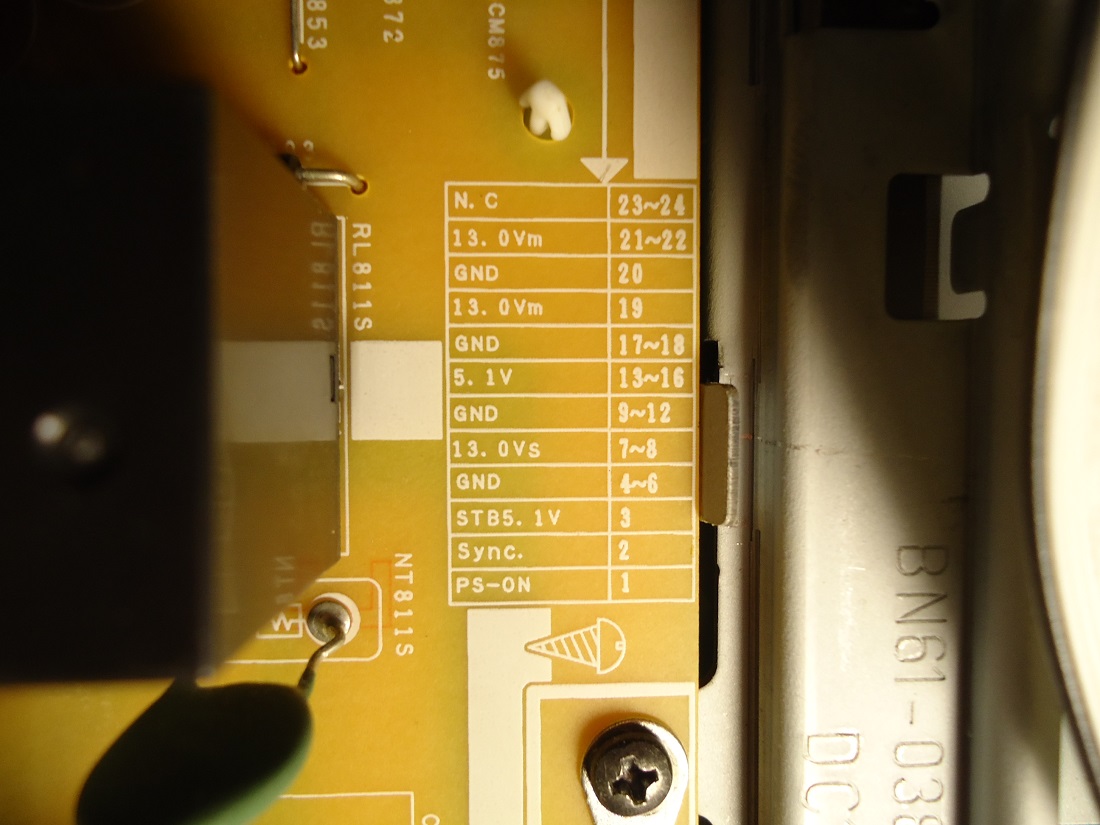

            Here are some pics of the caps., and hot inductor.
            The power outputs are on next pic.

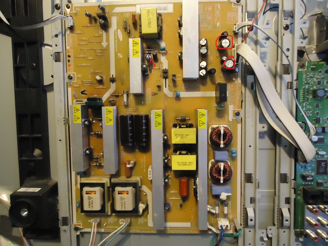

                All the caps are factory except the two circled they are Nichicon H0828
                The inductor in question is on the main board, as circled in red.

                        I bought new caps at my local electronics shop.Enough to do the whole board.
                        What about the two caps that don't mach the drawing.
                        CM-872 & cm-873 print says 25-v 470-uf for both.
                        Someone a Wise Person I guess soldered in 25-v 1500-uf
                        When I re cap the board should I change them two caps per the print.

                          Use the values as designed in not as soldered in

                            Those 1500uf caps Would they make the inductor on the main board very hot.
                            Are the caps I bought OK for this board? Were the value coming out of CN-801 to specs?

                              I recapped the whole board even the caps that checked out ok.
                              I changed the caps with 1500uf-25-v to specs 470uf-25-v
                              Now the inductor is running ay 125-c and not 175-185-c shut off point.The picture is beautiful now what a difference.
