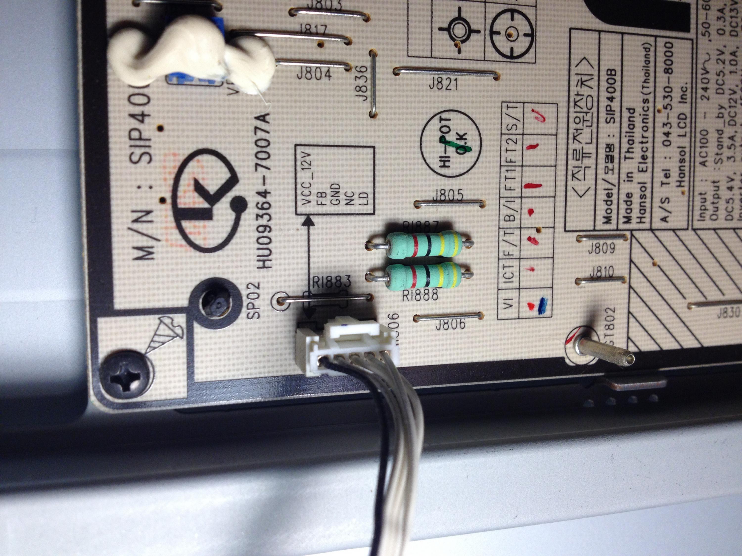

      There is a small connector with 4pins? ON THE BALANCER BOARD. Can you see the label of those pins like FB, LD, ETC?

            Thanks guys. I'll look at the video and check out those solder joints. Here is the connector.

              I have 12.3v on the 12v pin with the TV on and 10.02v on the LD pin.

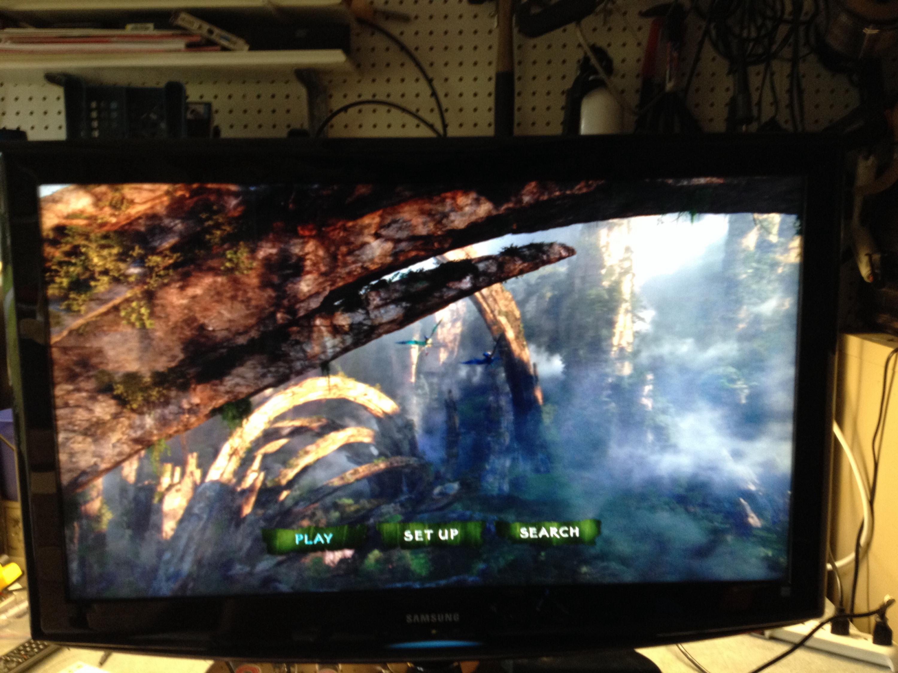

                      Update for everyone. There were two issues. Balancer board was indeed bad. Got the new one yesterday. It did not resolve the issue but upon following the video again after swapping the board there was clearly one transformer with too much current draw. I bypassed that one using the instructions from the video and the TV is working now. Can't really even tell the one bulb is out.
                      Thanks for the help as always guys. Was a new learning experience.
                        Re: Samsung LN-T4066F Backlight Issue
                        Glad to hear you got it fixed, bad lamp drawing too much current. I think your AC reading is not as high as the one shown on the video is due to your meter does not have the same C frequency bandwidth as the FLUKE he is using (you are trying to measure about 70~80KHz AC voltage). If you look at your voltage ratio between high and low, it is about 1:4.
