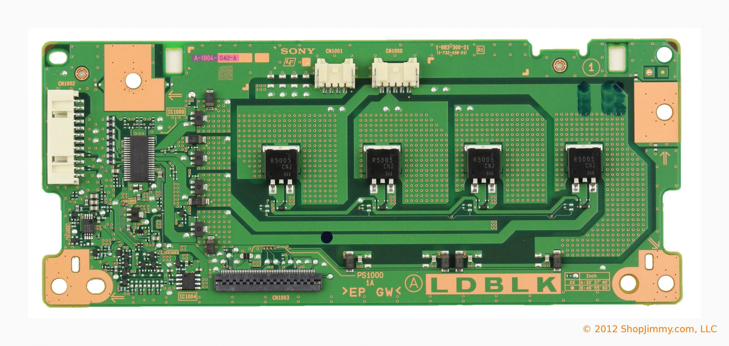

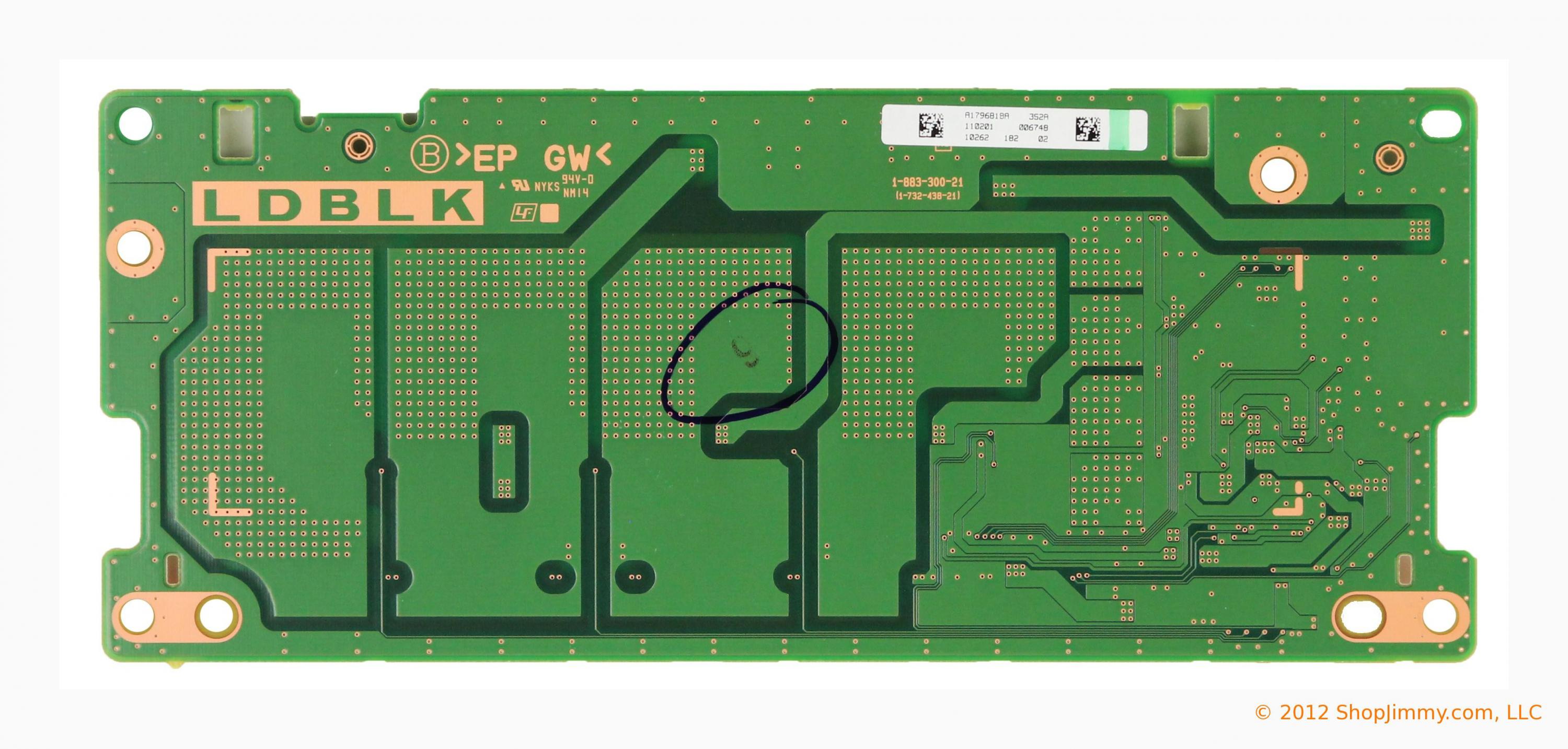

        Replaced the LED driver board and unit is back in operation. Total investment $16 plus time.
        Sony A-1804-042-A LDBLK Board
        Attached images courtesy of ShopJimmy.com

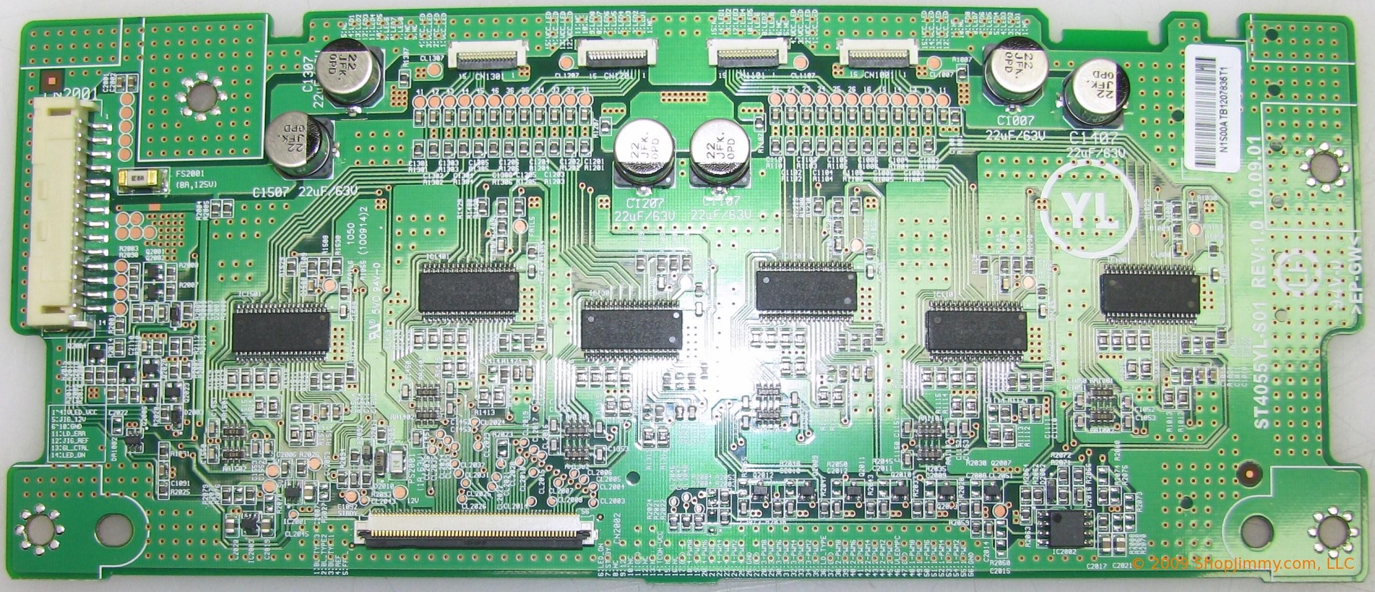

          Nice cheap fix. Mine it was more, but still happy that the driver board was at fault and not the LEDs.
          This was mine, much more complex then yours:
          Sony ST4055YL-S01 YL Board
            Re: Sony Bravia KDL-46EX723 - 4 blink code
            Wow! That's a bugger
            I would have tried the bypass on the chip, but as you can see nothing is marked except the IC's and the components are super small. The board is only 7.5" x 3" (19cm x 8cm) and the transistors I'd have to work with are 1mm x 2mm (left of IC1004).
