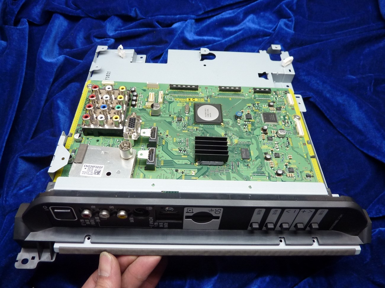

    hi.
    this came dead no stby led.
    check p.s ther is 5v and by powering it with main switch nothing happand.
    no hot ics in main board.
    service manual needed.

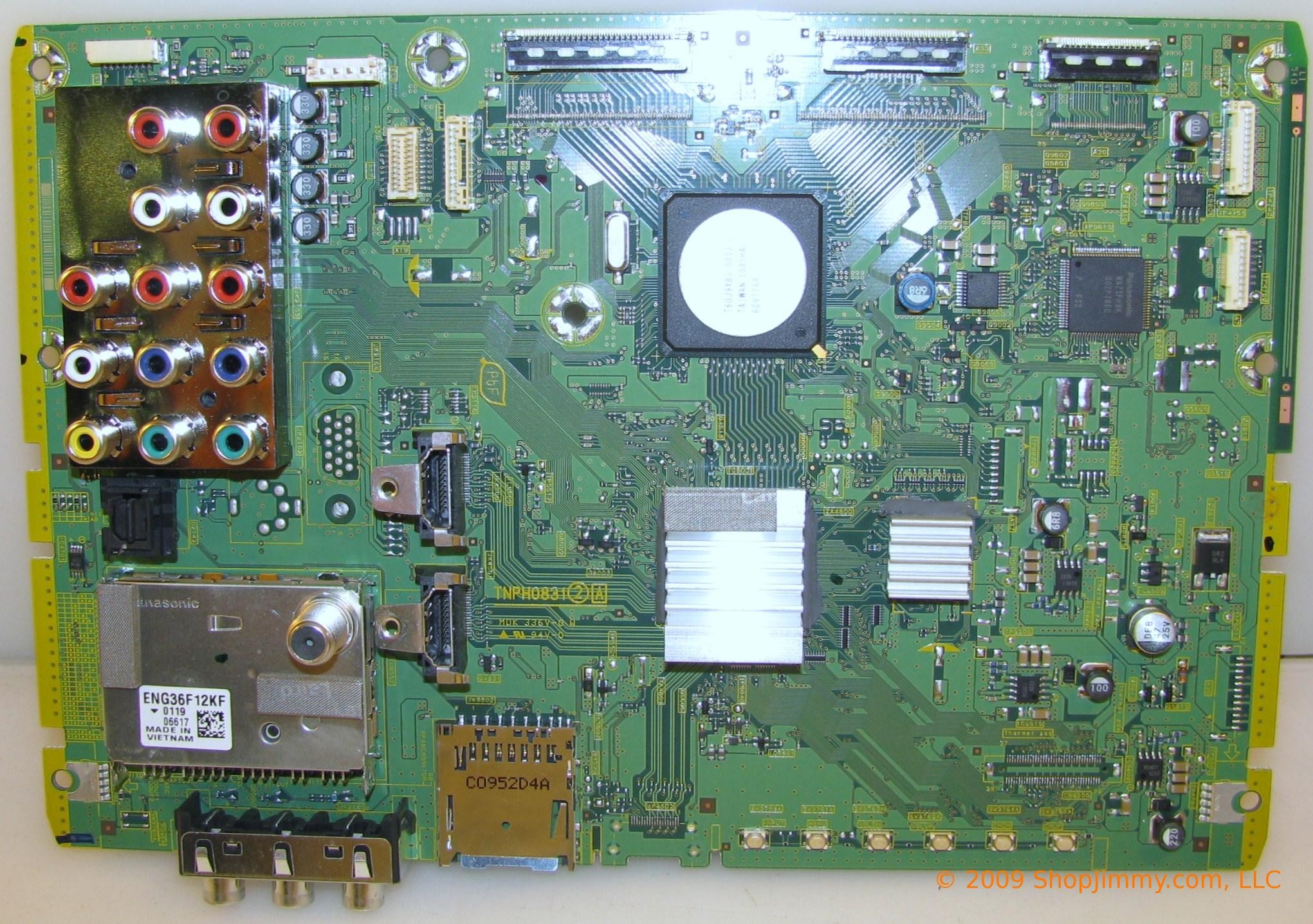

    Re: panasonic th-p46x20m
    Probably going to be a tough one to get but here's my tips. On the surface it's looking like a 720P HD 2010 Model. I have an Australian 2010, 42X20A, one of my few failures but inside yours I'm expecting a TNPA5072AB SS board, they commonly fail shorting Vsus in the 42" at least.
    I'm expecting a SN board(combined SC,SD,SU) TNPA5066 no Rev stamp.
    If it has these, hopefully the A-board PCB number will be TNPH0831 (Mine is not)
    and that would make the US model service manual for a TC-P46C2 of some use.
    I had no luck tracking down a training guide for this generation, i found one In Thai for TH-P50/42X20T,TH-P42A20T and found it near impossible to use even using a translator.
    So maybe identify what boards you have especially the A-board and try a search on that and see if you get any hits. I would use the PCB number only with no revision suffix.
    Rarely do I find Australian model manuals but you can still get an idea from closely related models in other markets.
      thanks for answering.
      my power supply is LSEP1287.
      A BOARD IS TNPH0842.
      NOTICE -when pushing mian switch can see that the 5v come back to the p.s but no clicks no stby led.
      checking the A board and i can thn mesuer a small resistance 9.6ohms in one of the pwm output that is leading to the big ics i think its wrong becouse other pwmout mesered almost 1k.
        Maybe try using a combination of manuals. TNPH0842 (42C20C/50X20C) comes up in the Chinese market, We have 0840 (42/50X20)but i think the TNPH0831 (46C2)is closer. It does not have the main switch on the A board but the rest of it looks very close. the chinese manual at least the schematics and block diagrams are still english.

            Well, I might as well hijack this thread as it appears I have the same problem.
            - 5 VDC standby good
            - No click, no display with Power nor Power Button pressed
            - No voltage at Panel_Main_On when Power Button Pressed
            Thoughts?
            • brnrubbr
              • Jun 2013
              • 37
              I finally found some more time to check out this TV. I found an IC getting warm on the Power Board (LM7805), obviously 5VDC regulator.
              I disconnected the Main Logic board and regulator stopped getting hot.
              Focusing on heat, I reconnected the Main Logic board and found IC BD8656FS to be getting warm. I am guessing it is similar to a BD9796FS, but I cannot find any relevant information on the former.
              • brnrubbr
                • Jun 2013
                • 37
                Boom! Found it with help from Panasonic......
                IC = C1ZBZ0004161
                Hell if I know what the IC is, but given that IC part number I found this this service manual
                Crossing fingers!
