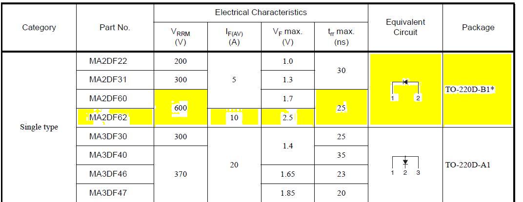

                Here's some subs suggestions open to debate / comment
                Q661 RJP6065DPP-90-T2 , RJP63F3DPP
                Q621 RJP3034DPP-90-T2, RJP30E2DPP, RJP30E3DPP, GT30F125
                Q622 RJP3034DPP-90-T2
                Q421 GT30G123, GT30G125, DG402RP, (Pana) DG3D4020CSRP
                Q422 GT30G123,
                Q423 GT30G123,
                D421 MA3DF40 , RFUS20TM4S RF2001T4S
                D422 MA3DF40,
                D618 RF101L4STE25
                http://www.utsource.net/ cheap postage= long delivery time , slow but reliable. Not everything is cheaper but seem to find the harder parts here.

                  Thanks for the recommendation. I've asked for a quote. So far at least on my board it seems as though just these parts are bad. I may take the plunge and try them. Will keep everyone updated. I believe the board Caleb is working with took a much worse hit.

                              Re: Panasonic TC-50PS14 10 blinks
                              I got no hits for the transistors, just the SMD diode
