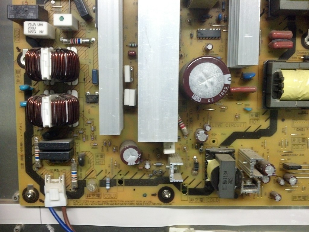

    Panasonic TC-50PS14 10 blinks
    Well here it is, the scariest looking hack mod Ive yet to open. This set arrived at its former home after giving it original owner 10 blinks, The guy I got it from tried to implant all the boards from another model. None of the screws lined up sooo duct tape was the method of insulating and fastening the boards to the tv, a few wires were twisted around the grounding points. All in all it looked ready to go up in smoke at a moments notice.
    Fortunately he gave me all the original boards, after about an hour I got everything back into the chassis and am getting the 10 blink error, hopefully nothing else got screwed up in the interim. Heres a big pic of the power board, this one doesnt have the MC modules that caused the 10 blink on my other panasonic. So Master Tom is there another common fault on this board that causes trouble.
    Off to ElectroTanya to see if I can find a service manual.

    Re: Panasonic TC-50PS14 10 blinks
    Found the manual Here if anyone else needs it. According to the manual the 10 blinks on this model is caused by the A board, However it appears from the schematic that the a board converts the 15v supplied by the power board to the rest of the required voltages. I put the scope on the 15v output on the power board and got nothing, but that was with all the harnesses plugged in, I will have to pull out the pins on the connector to isolate the a board fully as the same connector has the power supply on signal. I have to work the next 7 days straight but I will check in regularly.
    Edit, found another thread on this model where a shorted sc was causing 10 blinks. Went and unplugged the sc and I have 15v to the A board momentarily and fault changes to 7 blinks, vs header is reading 280 ohms.
      After an 80 hour week I finally had a few minutes to finish troubleshooting this tv. Both the su and sd are shorted out, the main short on the sc cleared when i removed the buffers, however the tv cant pass the startup test with the sc connected. I noticed a blowout mark on D618 and sure enough it tests shorted. I have a few of the same diode on another sc I swapped out a while back. I will swap it out tomorrow hopefully that is the only fault as these sc's are made of unobtanium.
        Unlikely just the diode, I'd expect shorted FETs too, IGBTs FET driver ICs etc. Check the P-FET Q604, I've seen one of these boards posted before with that diode blown and Q604 was reported short as well.
        I can't remember if anyone has successfully repaired these at component level yet which is a shame.
        You know about the SC50 jumper for SC testing minus the buffers? Although with that diode like that I'd expect nothing good.
          Yes I used the jumper to test the buffers, did you have the link to that other thread? I was looking over the schematic last night and was noticing this diode was tied into the drain of two fets so I was kinda expecting at least one of them to be blown. Im going to try and fix this at the component level as I cant really justify sinking 200$ into this tv, if I can get it to pass the self test I will buy some buffers for it. At least I have a schematic for this one I will test out all the components around that vsus circuit.
                        No problem Aaron, maybe between the two of us we can figure out the sc failure, I used this TRAINING GUIDE to isolate the sc although both my buffers are blown as well.
                        So far
                        D618 (8894) shorted and one pad blown off board
                        R613 (473) tests ok but also had a lifted pad
                        Q601 (RJK6026) tests .2 ohms across all leads
                        Q660 (RJK6026) tests .2 ohms across all leads
                        Q661 (RJP6065) tests 9.2 ohms G-C and G-E and .1 ohms C-E
                        L699 (471B) broke 1 lead while removing to access D618
                        Testing resistance across vsus to ground is now 700k, What is the likelyhood that those tiny driver transistors survived? Or do you guys think I got it all or should I continue to look for more before I order parts.
