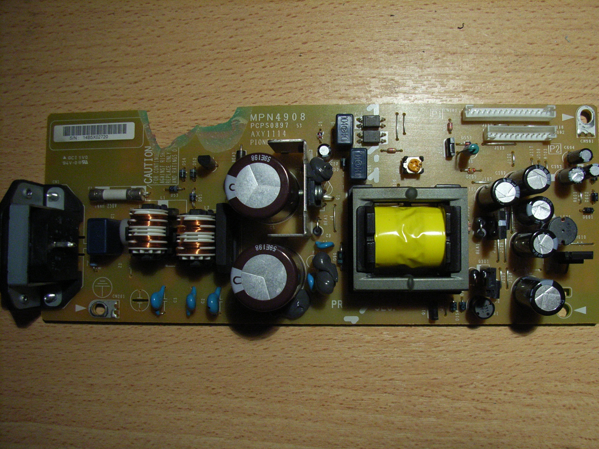

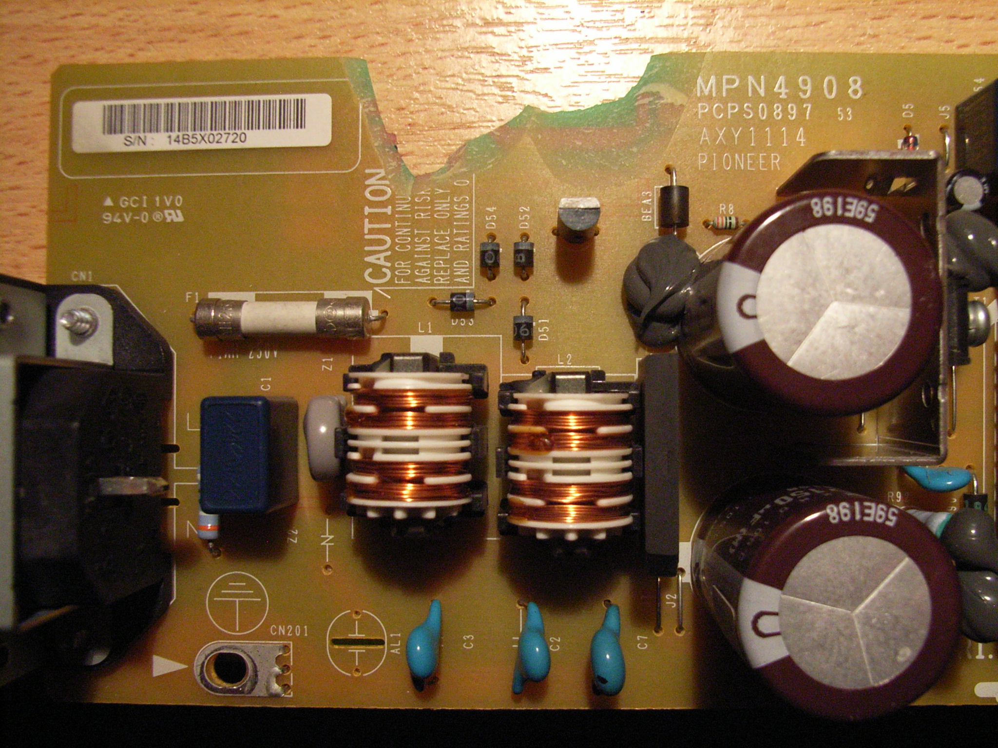

    Have a new project: A Pioneer PDP-R06G Media recieiver that someone else 'had a go at' before passing it onto me.
    Trouble I have is a triangular part of the power supply circuit board is missing!!
    I cannot find a circuit diagram on the net apart from a high level service manual. I cannot even find a photo of the reverse side of this board on the net.
    So...I know it's a long shot, but does anyone have one of these media receivers lying around (or a similar model) and can photo the reverse side of this board?
    Or can anyone hazard a guess as to how these circuit paths go?
    The board part numbers are AXY1114 / MPN4908 / PCPS0897

    axy1114 (pdpr06xe) is your board number!
    google it and go nuts!

      Re: Missing part of circuit board. long shot question
      That was the first thing I did and when I came up empty I thought I would ask on here to see if someone else has one of these boards that they can photo the circuit paths of.

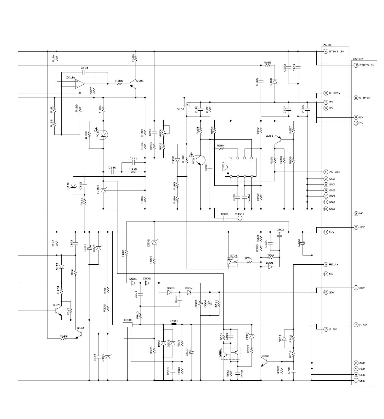

        Thread is closed, Have been contacted by a local tech who saw an advert of mine and sent me a detailed schematic of this board and I managed to rebuild it using wire and old resistors.
        Voltages test within spec but I have a different problem now.
        8 blue flashes = mainboard interface problem.... somewhere.... groan... Oh nooooo.
        This project might be headed for landfiill!
              PDP-R06G Power supply schematic.

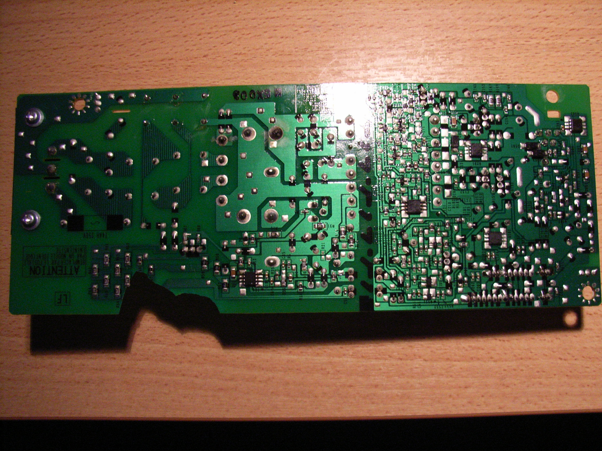

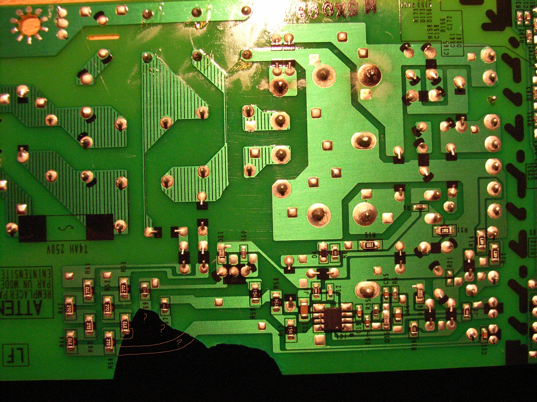

                    Hi, found this in google so joined the forum to checkout your images and schematic on other post.
                    Given to me by a friend to fix after another bright spark bridged the fuse that had blown on the PCB and started it cooking at R31.
                    Your hires image on underside of PCB has at least told me the value of R31 which the schematic does not so that was a help thanks very much.

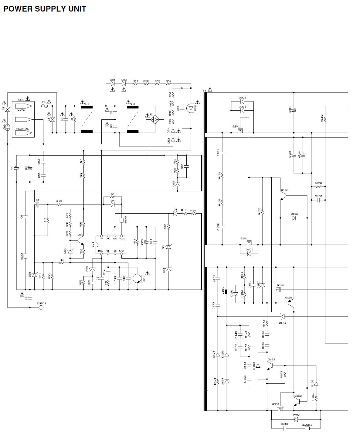

                      Due to problems in the power grid, media player (pdp-r06fe) got 400v instead of 240v and burned some electronic parts. However, I failed to find more details and don't know what the specification of these components are.
                      Also, can you give me more suggestions what to replace? As I can see diode Z1 is completely burned. Could be that just a problem? Where can I find what kind of diode is that?
                      I found schematics in the previous posts, as well as, the service manual on http://service.minjja.lt/files/?id=3184
