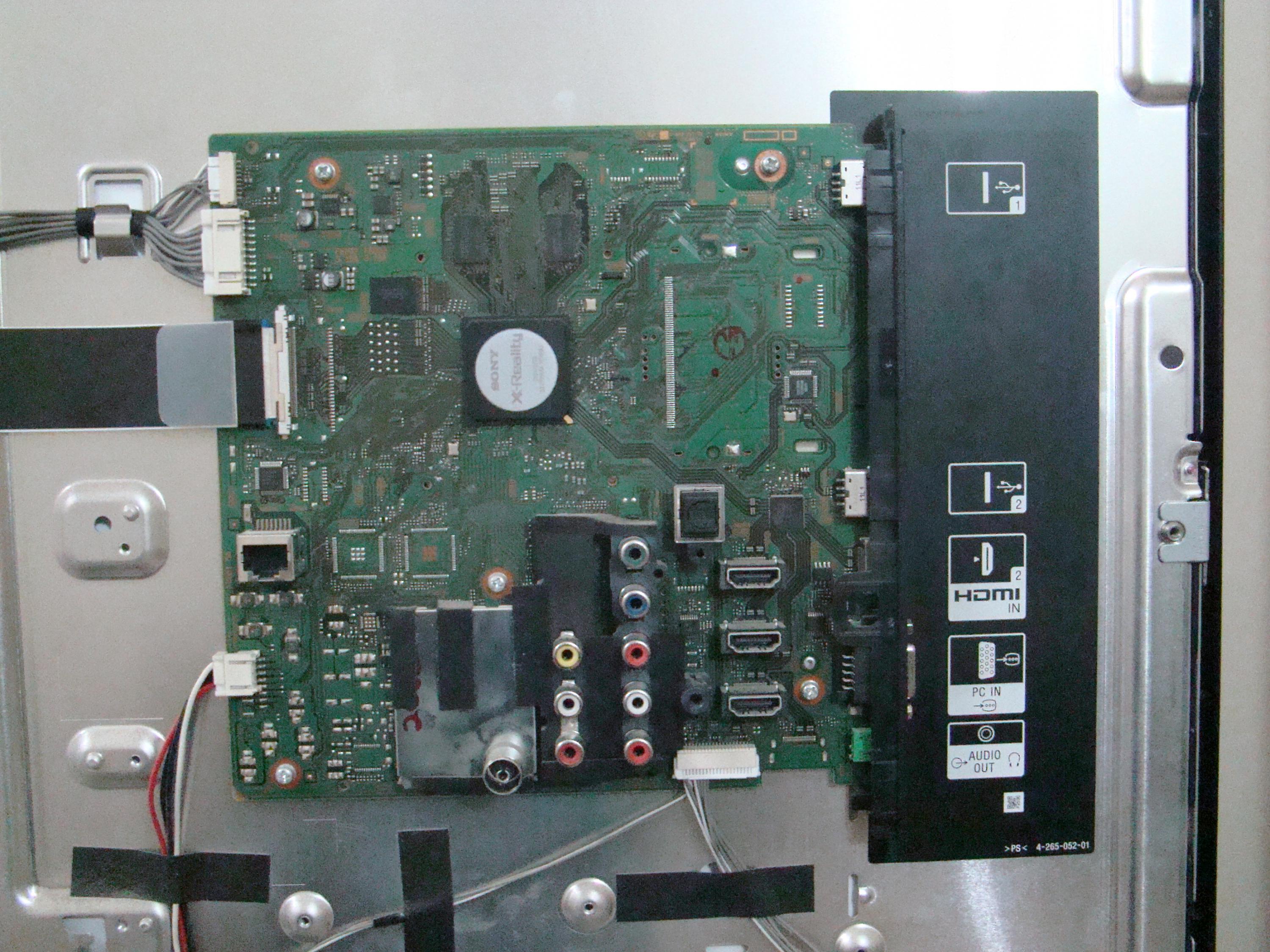

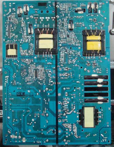

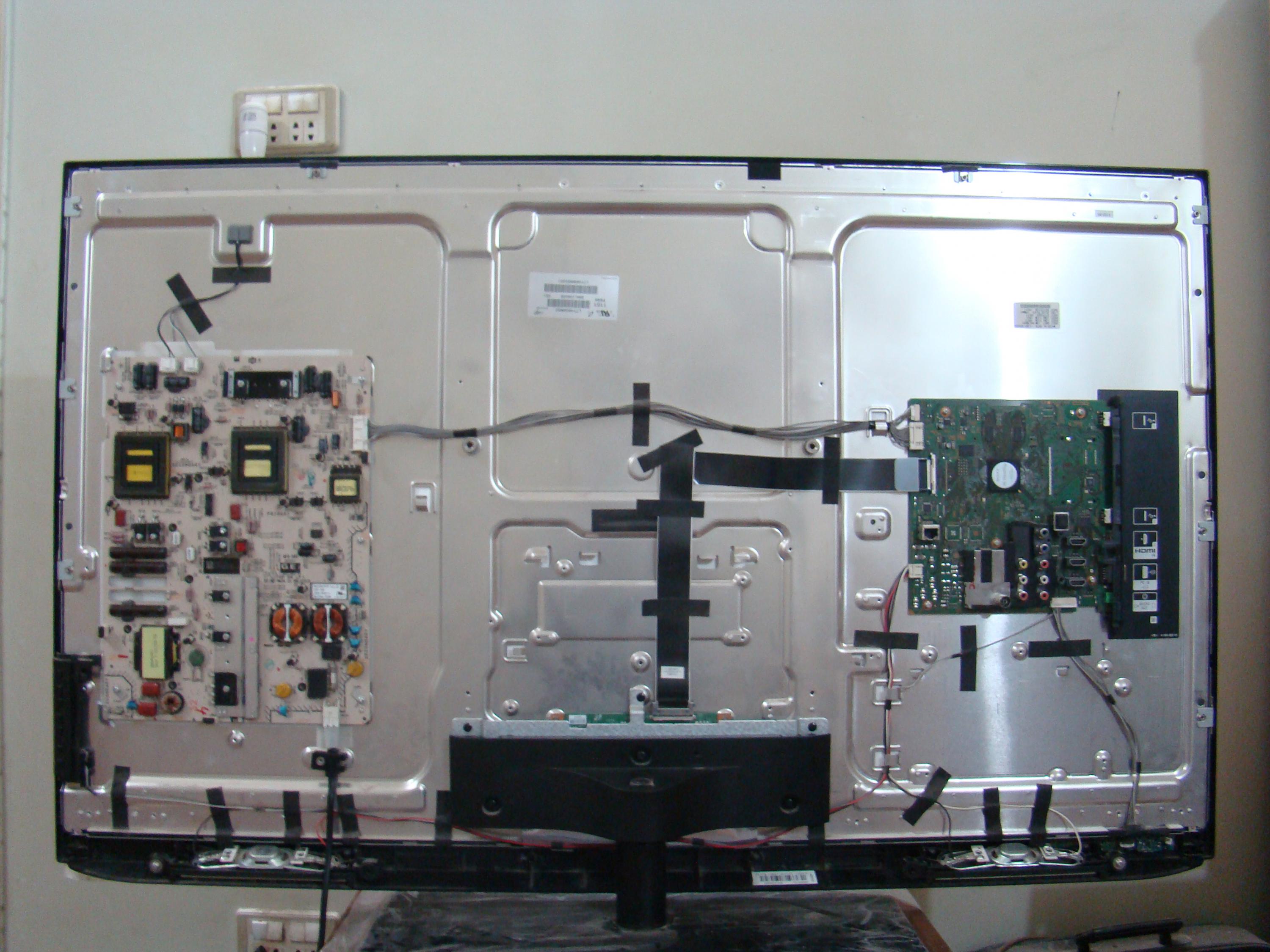

    Please guide me to troubleshoot my TV Problem:
    Sony LED TV KDL-46EX520
    No Picture, but the Sound is OK.
    TV Channels are working without picture.

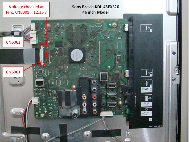

    Backlight appears when the TV is Plugged-In

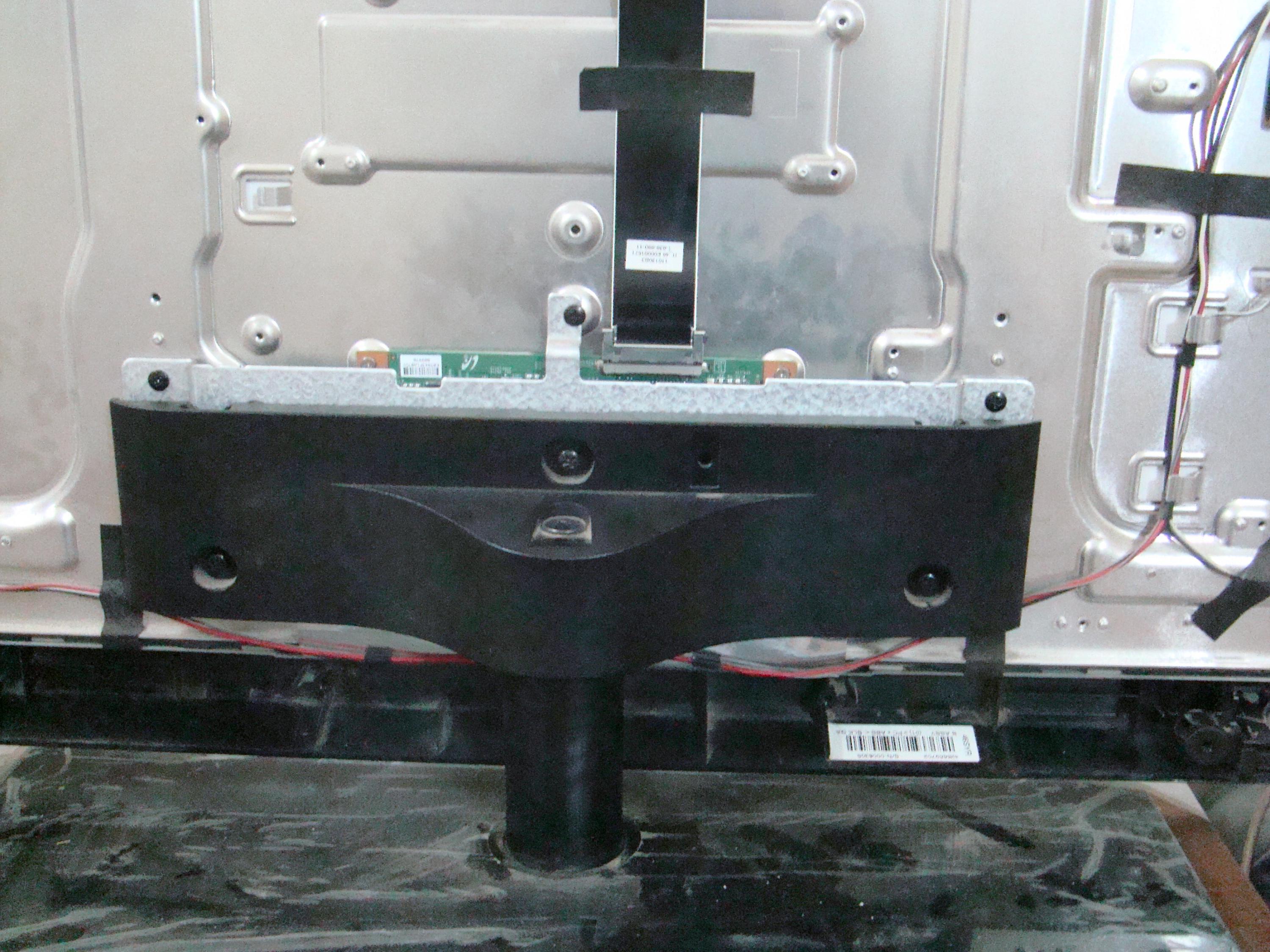

    Fuse on T-Con is tested and is OK
    In the start of the problem, the video came for few seconds and then gone.

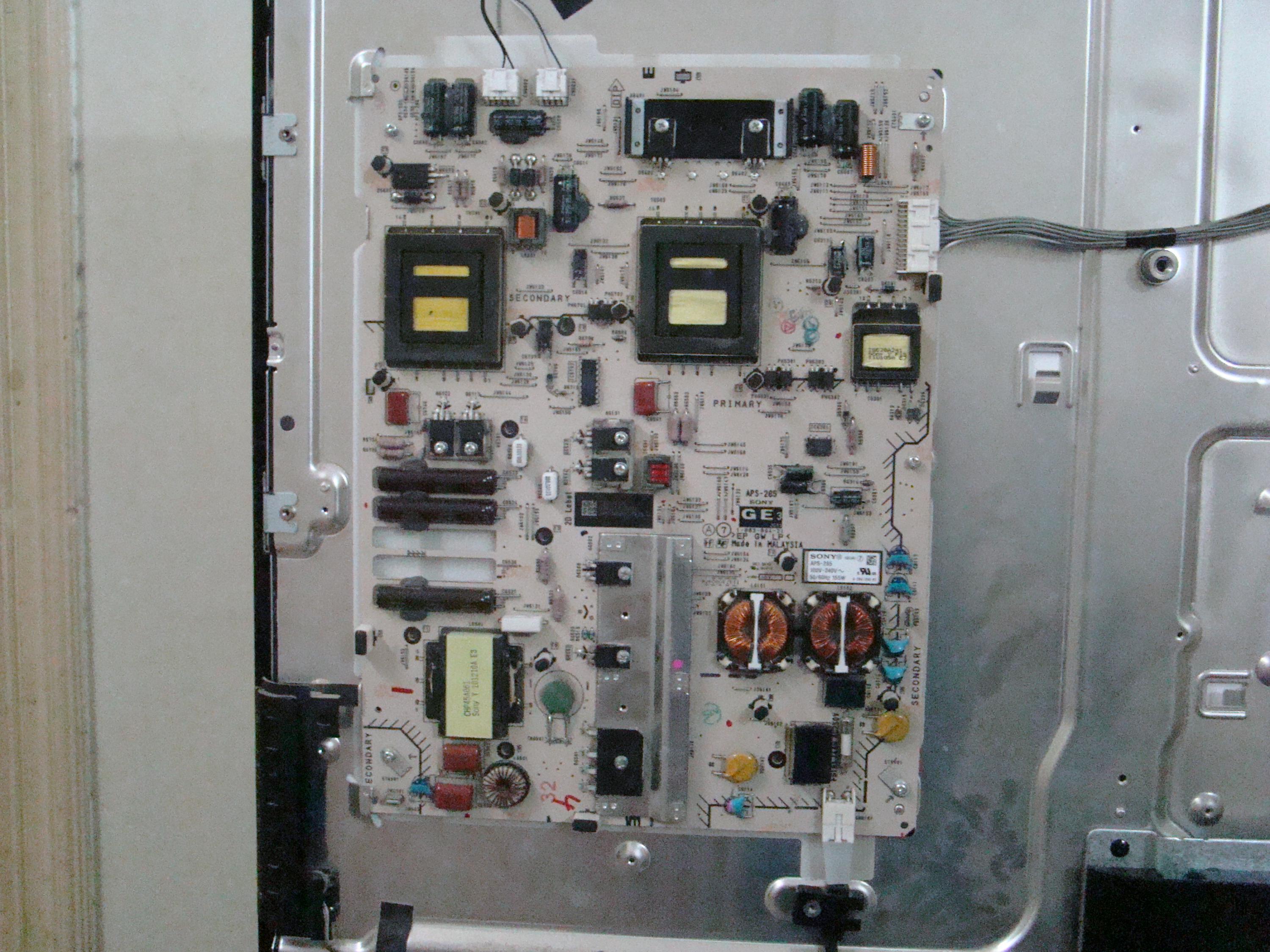

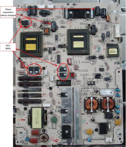

    I replaced the capacitors as shown. But no effect (No video but only sound).
    I also tested and replaced the FETs (KF 5N50).
    There is dim blue light on the screen. Sound OK Channels are Tuned, But No Video
    Regards.

    Re: Sony LED TV KDL-46EX520 No Video, but the Sound is OK.
    Have you tested all inputs? Does the Menu show up onscreen? Does the tcon fuse have voltage?
        Mr. Caleb
        First of all Thanks for the reply.
        T-Con Fuse is OK
        There is no startup screen.
        I've no voltage chart to check the Voltages
          Like CALEB asked,check both sides of the T-CON fuse for voltage,and tell us what the voltage is....
              At T-Con fuse it is 12.35 V
                                Long Live ---- Mr. Caleb ---- Long Live
                                I disassembled all the boards and then reassembled.
                                Sound is Back and RED Light is not Blinking.
                                But when Powered OFF from Remote Control and then Re ON the TV RED Light again started blinking and there is again no sound.

                                    It most certainly sounds like a t-con board. You are receiving the 12volt to the t-con board and im going to assume all the output voltages are proper from the power supply? Try some spray on the t-con board and also disconnect the t-con from the lvds cable and power on. Do you still get the 5 flash error?

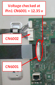

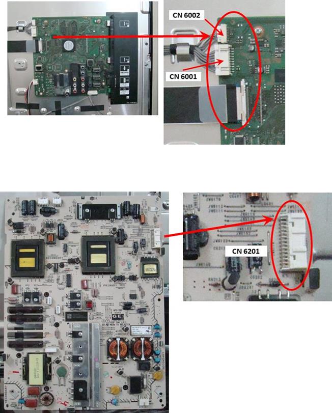

                                      Voltages Observed at CN6001 & 6002 are attached.
                                      All the Capacitors and FETs have been replaced.
                                      All the resistors have been checked.
                                      All the Diodes have been checked.
                                      Important:
                                      When Channel is changed, flikering on the screen can be observed.
                                      • Hamad
                                        • Sep 2013
                                        • 22
                                        • Pakistan
                                        Sony Bravia TV
                                        KDL-46EX520
                                        Sound is OK but No Video
                                        Observed Voltages
                                        Pin # Connector #
                                        CN6001 CN6002
                                        1 12.35 0.00
                                        2 12.36 0.00
                                        3 12.36 3.30
                                        4 0.00 1.64
                                        5 0.00 0.35
                                        6 0.00 3.30
                                        7 0.00 0.01
                                        8 12.39 3.23
                                        9 12.39 2.80
                                        10 3.26
