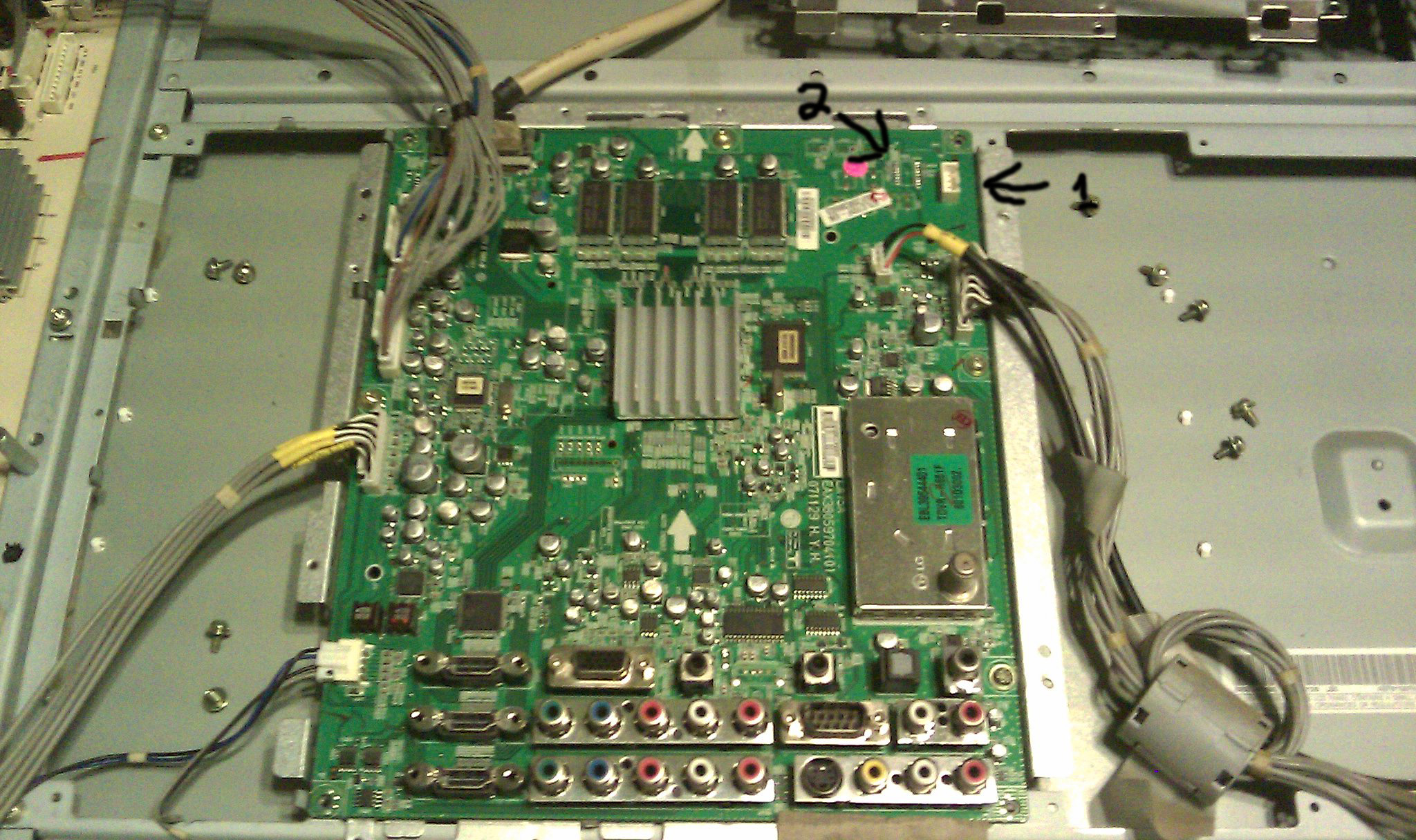

    What i have done so far (besides invading someone's thread) is replace the 2 large caps(450v 150uf) and the fuse(250v 5A) near it that was blown and i still have the same problem and the TV works exactly the same as it did before i did anything and with or without that fuse installed, which is now blown just like the original.
    I own a Fluke 87 and am a novice at using it. just would like to know where to attack from here but my lack of experience is holding me back.
    Power supply model = P/N : 2300KEG021A-F
    Main board model = LA75A EAX38059704 (0) 071129 H.Y.H.

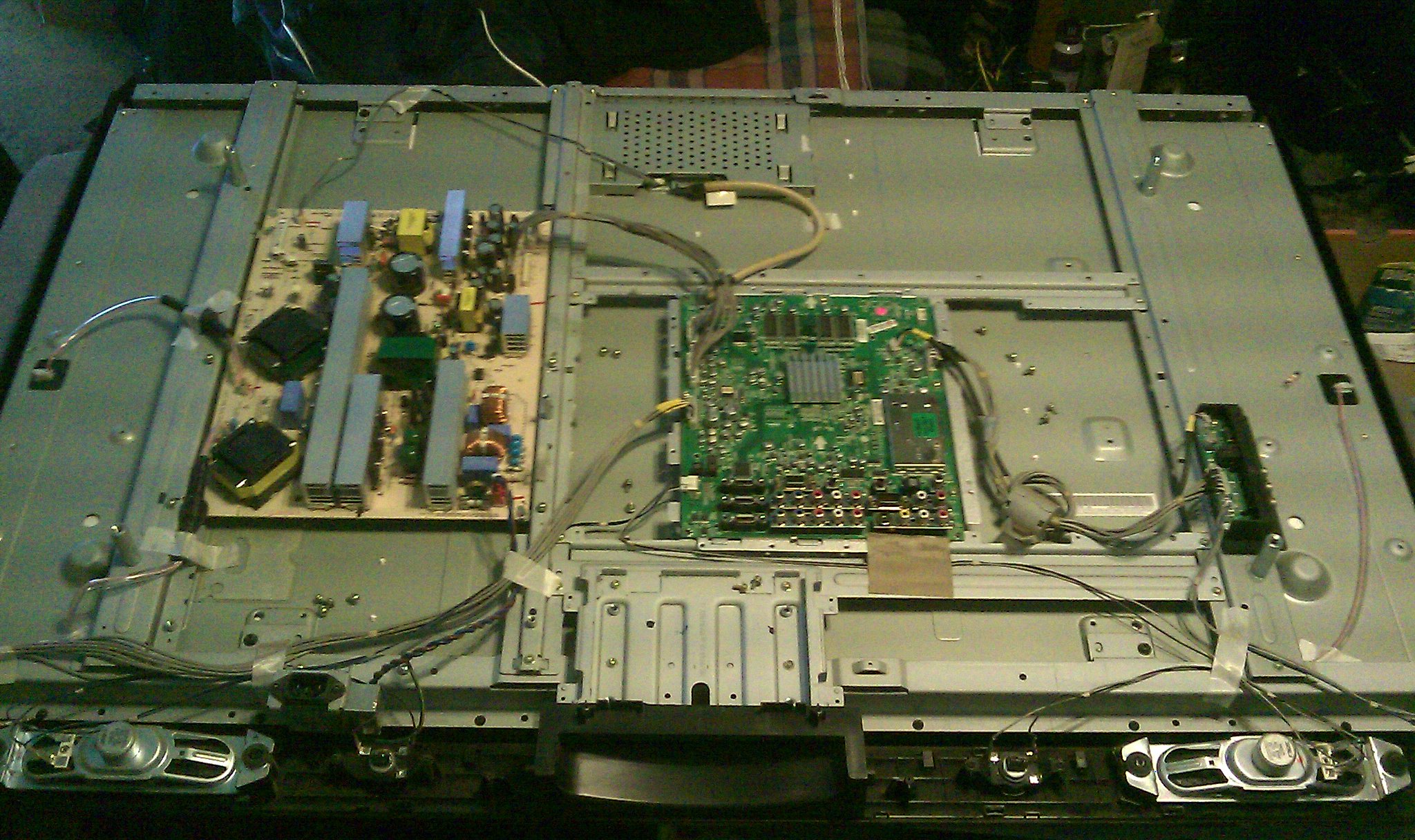

    Pics are of my TV and i include the plug because my TV is a UK version not a UB version and just trying to find out if it is the wrong region or i have the wrong cord. The version matters because i cannot find any sort of Service manual besides the UB version which is different from mine. The UB version of my TV have separate inverter board and the way i understand it mine has that integrated into the power supply. Also included picture of the cover to the power supply to show the plastic that was distorted due to heat.

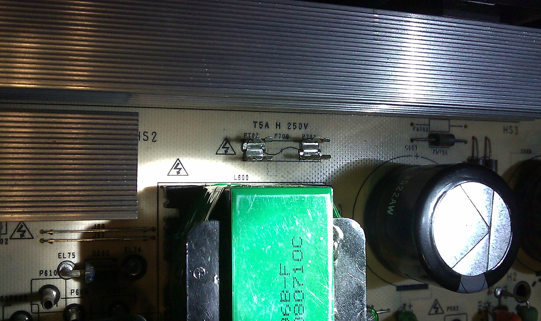

      Re: LG 47LC7DF-UK Sound but no Video
      When last i had it on to the best of my recollection it had nothing at all.
      As stated in original post it performs the same with and without the fuse and i don't have another fuse (replacement blew) to use but could this test be done without the fuse either way?
        " i did anything and with or without that fuse installed, which is now blown just like the original." So the fuse is still blowing?
        OK, just read the post 3 just second before I post. So you do have badly shorted circuit that blow 5A fuse. We will need real good closed up pictures of this power supply-inverter board combo to see what circuit this fuse is feeding. Good top and bottom side of the board, then small section of both top and bottom side so I can clearly see the traces and component to be able to trace out the circuits.
          What i mean is the things i replaced were the 2 caps and the fuse which was not working and after i put it back together with the new fuse it blew again. I took the fuse out and still does the exact same thing no video but sound. I do not have another fuse to use atm and before i made another order from digi i was looking for some more advice because ordering 10 fuses wouldn't help me right now, at least i don't think

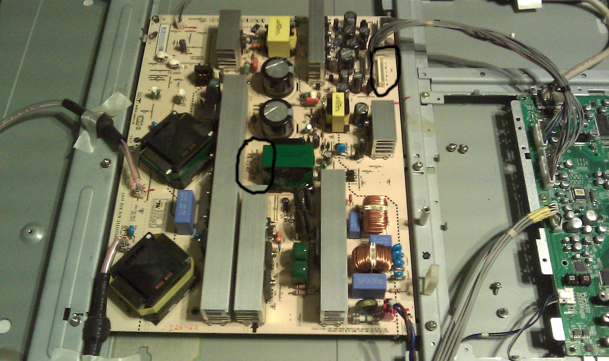

            We will need the pictures to find out the function of that fuse. I would not keep putting in the new fuse since you can cause more damages until we find out why the fuse blew.

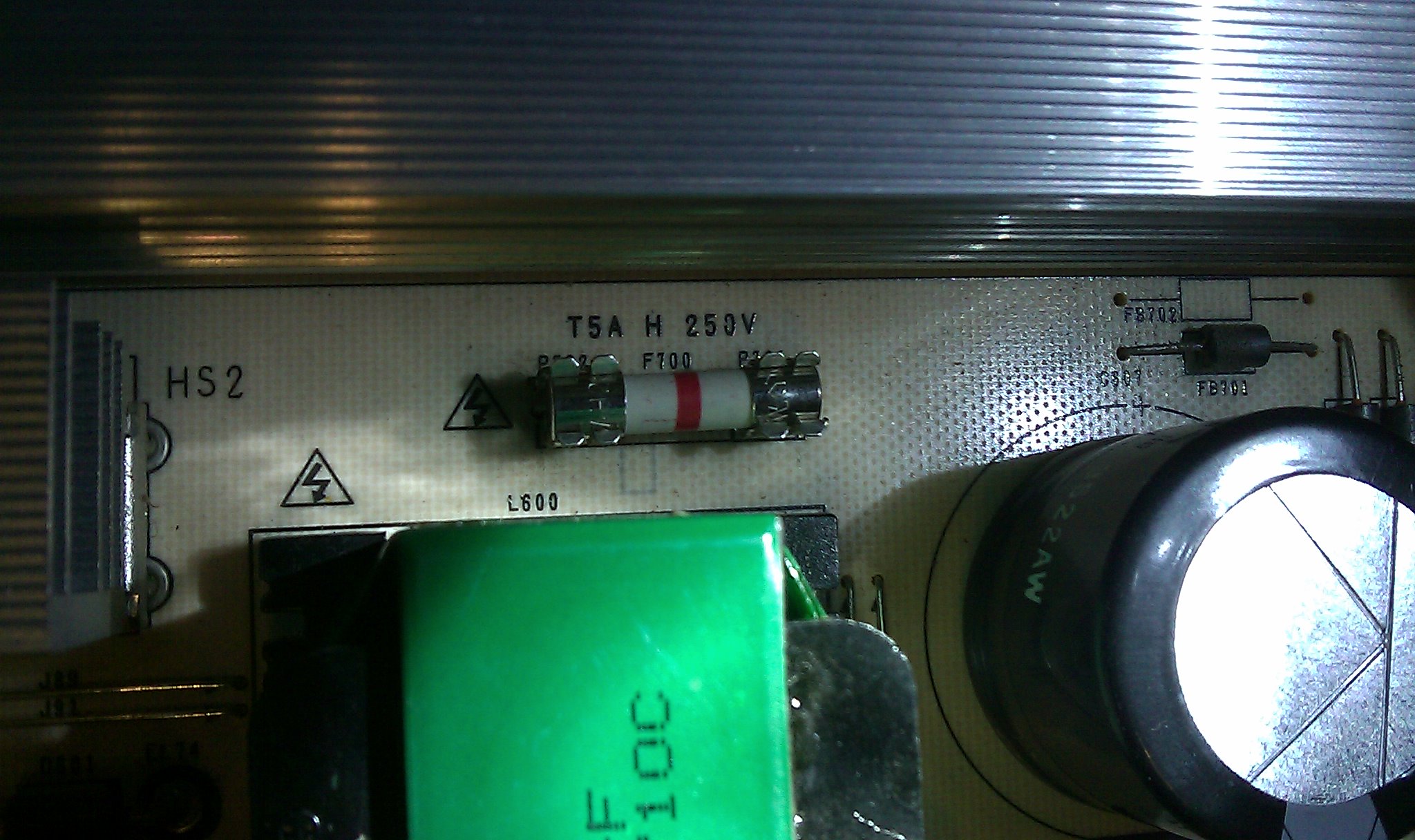

              http://assets.shopjimmy.com/media/ca...36781302_1.jpg
              OK, I see the fuse now, that is probably the fuse for the inverter circuits, so more likely that the inverter circuit has shorted out power MOSFETs (they are mounted on the longest heat sink close to inverter transfromers)
                I already have some pics of the board and you even linked me differences the UB and UK versions of that same power supply so i don't think you are asking for that so i took some more pics of the fuse itself.
                As i am a novice i did the best i could to research what fuse to buy to replace this i bought the one linked below.
                http://www.digikey.com/product-searc...&formaction=on

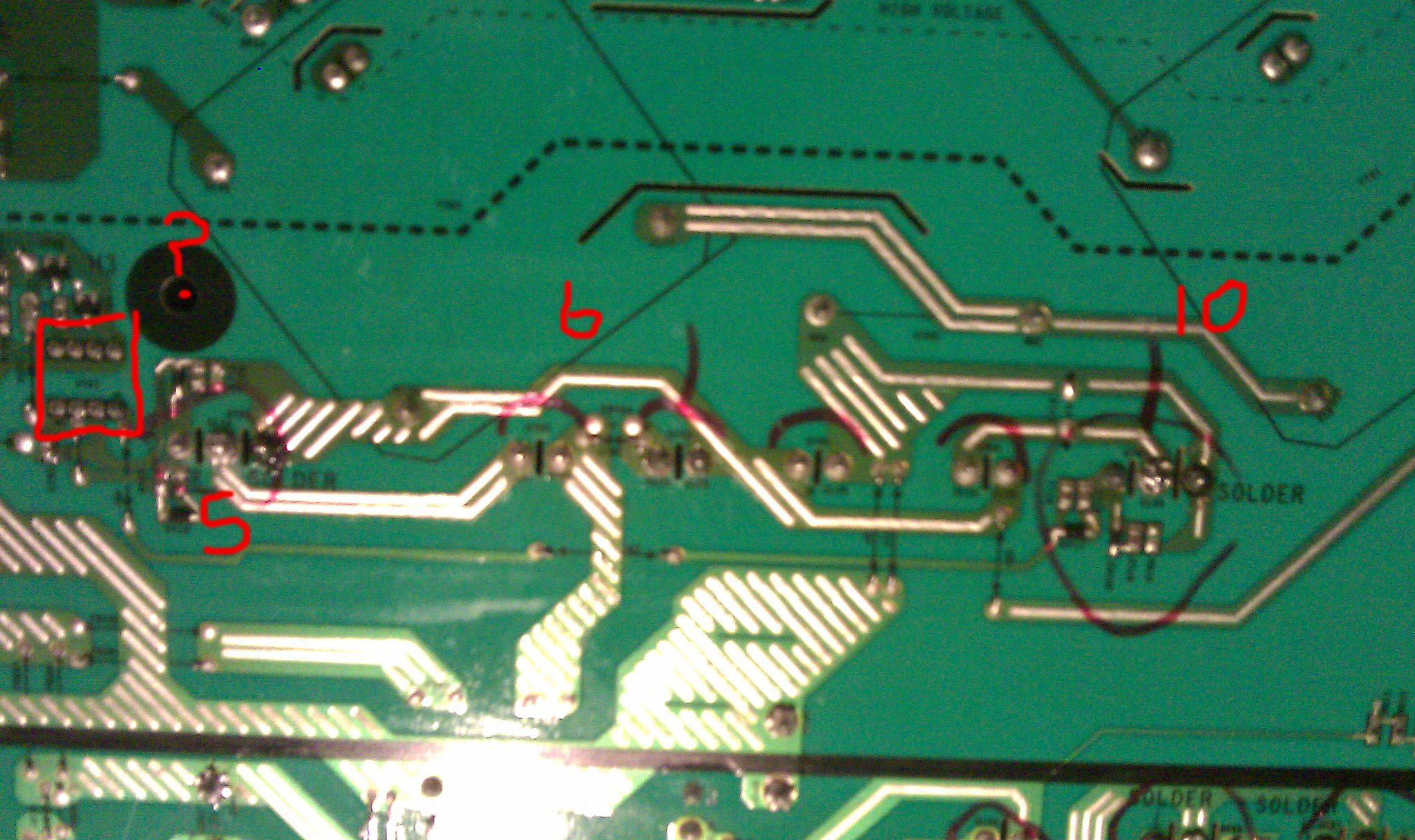

                  As i was putting together my last post with pictures you are talking about the very thing i was reading about but i have a lack of comprehension but know the pieces you speak of that are screwed in to the aluminum heat sinks.
                  • Mongor62
                    • Sep 2013
                    • 83
                    • California

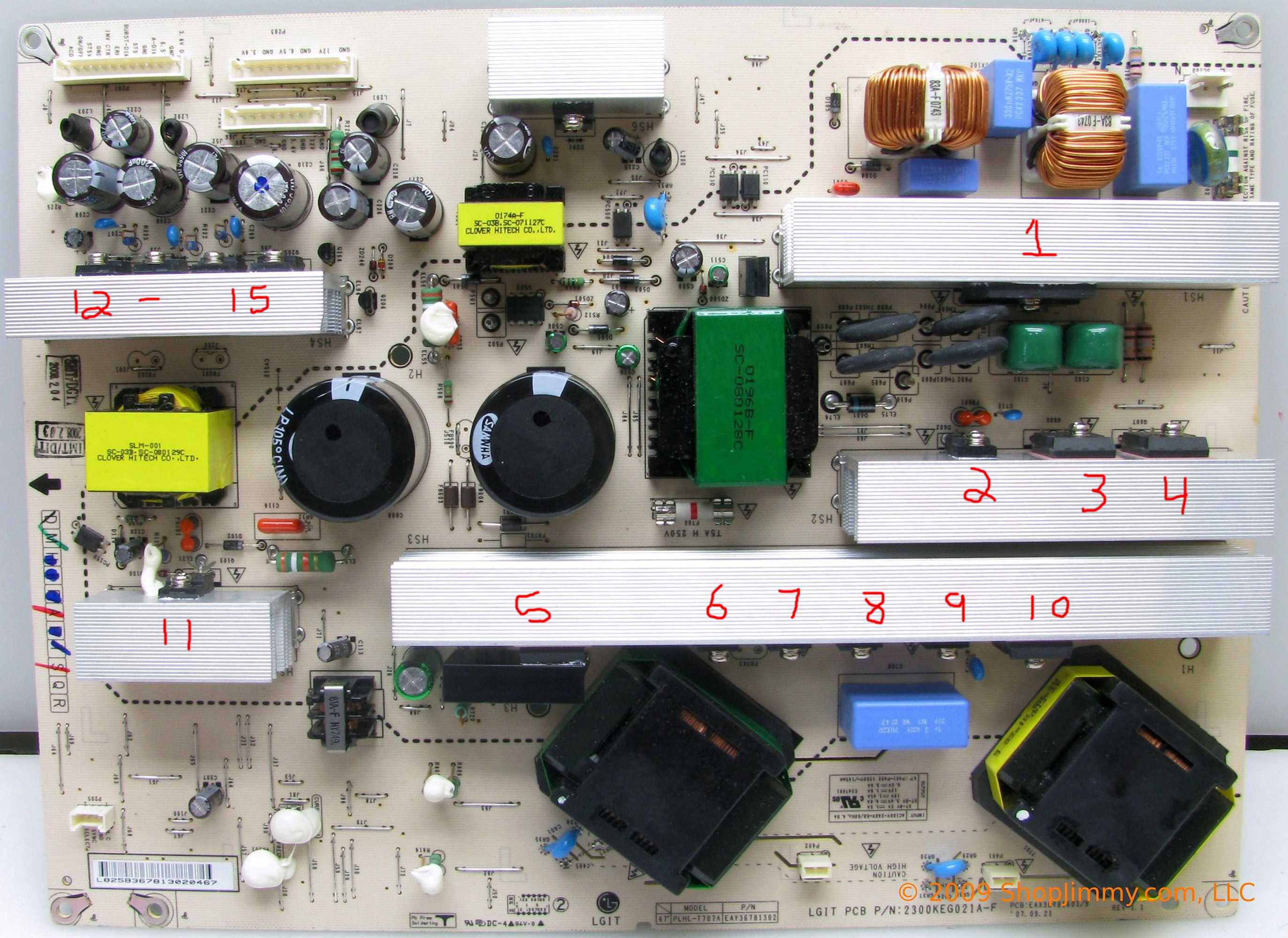

                    I numbered the items you speak of to help me understand what you are talking about so if you could take a look and tell me a little more
                      6~10 are the components you need to check for very low resistance reading. I cannot tell much more until I can see the bottom side of the board to see how many MOSFETs and how many Diodes for those 6~10 components.

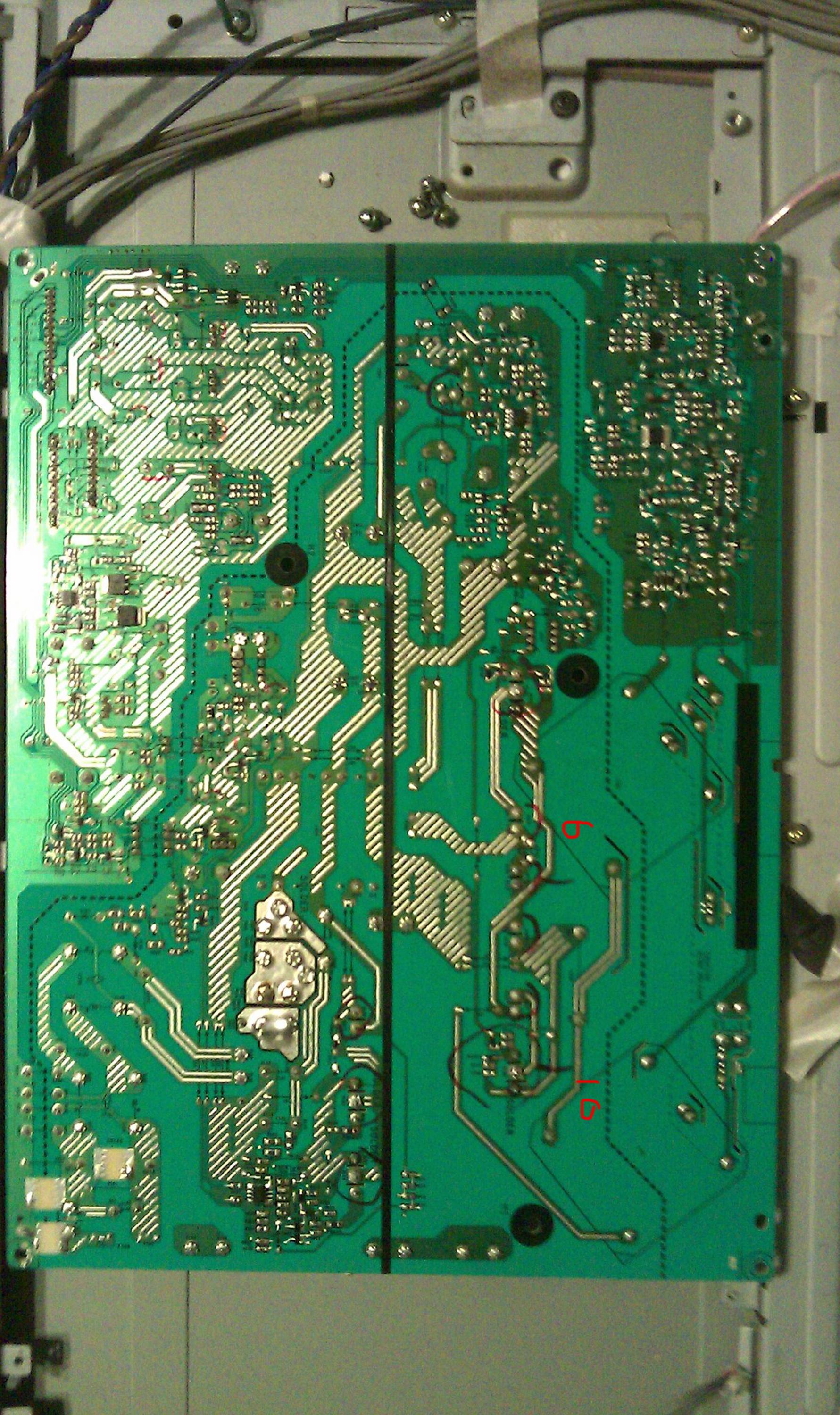

                        These are pics of the bottom of the board and i will take some time to make sure i get the numbers written on those items and get back to you
                          Ok, the pictures are kind of blurry. Can you tell me which one of the components form 6~10 has 3 legs?
                          OK, 5 and 10 are the MOSFETS that we need to test for low resistance reading.
                          if you at it facing you:
                          Left pin is 1
                          Middle pin is 2
                          Right pin is 3
                          Use the Ohm meter to test:
                          Pin 1 & 2
                          Pin 1 & 3
                          Pin 2 & 3
                          Test both ways (swap the probes around after)
                                  1. 4pins D15XB 60 B018D ("8" has a dash over it and "D" has a dash below it)
                                  2. 2pins MURF1060 SSG A09182
                                  3. 3pins SD20N60 GBY908
                                  4. 3pins SD20N60 GBY908
                                  5. 3pins cannot find any numbers or letters on this item?
                                  6. 2pins 920 SFAF508G
                                  7. 2pins K16 R860PF2
                                  8. 2pins K16 R860PF2
                                  9. 2pins 920 SFAF508G
                                  10. 3pins SD20N60 GAY908
                                  11. 3pins 04N60C3 GAB 918
                                  12. 3pins N 9B FCH10A20 K7A
                                  13. 3pins N 9B FCH10A20 K7A
                                  14. 3pins N 8K FCU20UC30 339
                                  15. 3pins F1 K15 FQPF 27P06
                                  I will be testing the 3pin ones first.

                                  • Glitcher
                                    • Mar 2013
                                    • 673
                                    • USa
                                    # 10 looks like the culprit looks like all three pins have been shorted on it, replacing it should fix the problem. You should also test 6-9 for shorts also just in case.
                                      I would replace #5 and #10 at the same time, including the PWM IC (8-pin device next to #5 that drive these two MOSFETS, the resistors/Diode network on the Gate hsould also be checked for damaged.
                                      Take the MOSFETs out and test them out off the board.
