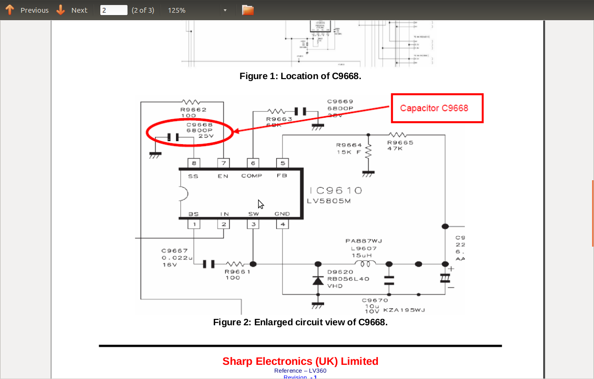

    Fault description: intermittent refusal to power up. Green LED lit, but set does nothing. No backlight, no image. However, after a lot of playing with on/off buttons, the set will power on and then works great.
    The particular fault is identified in Sharp service bulletin "LCD 2010 07 05".
    The 3.3VD line measures just 2.35V. The LED on the main board blinks continuously and the set does not power up. Upon freeze spraying suspect area, the 3.3VD rose to the correct level, and the set powered up and worked perfectly. Therefore, I will replace the indicated capacitor.

    Might be a good idea to replace the other cap on pin 6 which is the same value as that bad cap ( extreme drifting in value with temp?).
      Re: Sharp LC-32DH66E green light no power fixed
      There's three other converters of the same design. I think I'll replace all three 6.8nF capacitors.
      I think it's the same thing as 10 blink Panasonic failure. The capacitor becomes leaky, but not shorted. Hence the SS voltage can't reach the full amount. Once the capacitor cools down, somehow it stops becoming leaky and set works.
      Question: Why does only this capacitor become leaky? Thwo other converters, for 1.8V and 5V, also exist with same design but there are no bulletins for them. Points to perhaps some design change not reflected in schematic? Or perhaps different temperatures in that area?

            If you can test the capacitance and leakage resistance with heat and cooling, it may give you a hint to what is bad about this cap. Is it ceramic disk X7R, 5Y, etc. or MLCC? I alos wonder what that SS pin on the IC is for.
              I'll see if I can do that. Will be interesting.

                    Forgot to say this got fixed a few days ago, just replaced capacitor on main board, fired up immediately no problems.
                    Lost the original 0402 capacitor unfortunately :/ so can't test it.
