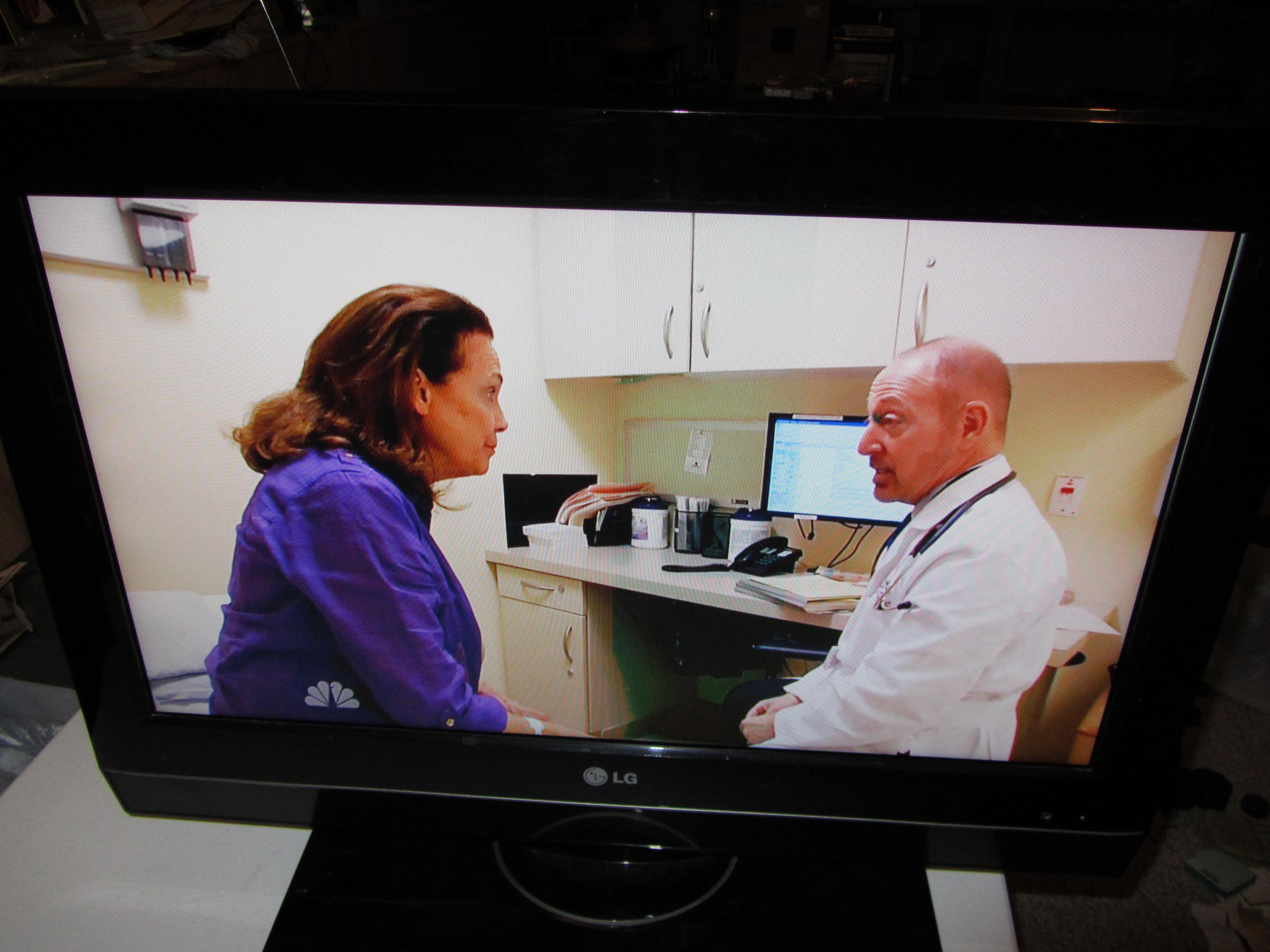

    LG 26LC7D with Wide Discolored Vertical Line
    Trying to figure out what is causing this wide line on this set. I first thought it maybe a cable that wasn't in properly but have messed around with all of them. Cleaned all of them and get the same. Would the T-Con board do this to the picture, or is this a bad panel?
    Does this on all inputs and shows up when you have the menu up.
    -In the picture you can see the line start about in the middle of the screen and go over about 5 inches to the right. It usually gives off a green color.
    Any Help?

    Showing up on all inputs and on the menu screen tells me it's likely panel related. Beyond that maybe someone else here can tell you where to look.

      I have a32 inch vizio doing the same thing. It comes and goes with heat. I can trip it up wirh a solid blue screen and it will go away for a Lil bit

        That is what I was thinking also...I thought about trying a new T-con board to be sure. If that didn't fix it...use it as parts...
