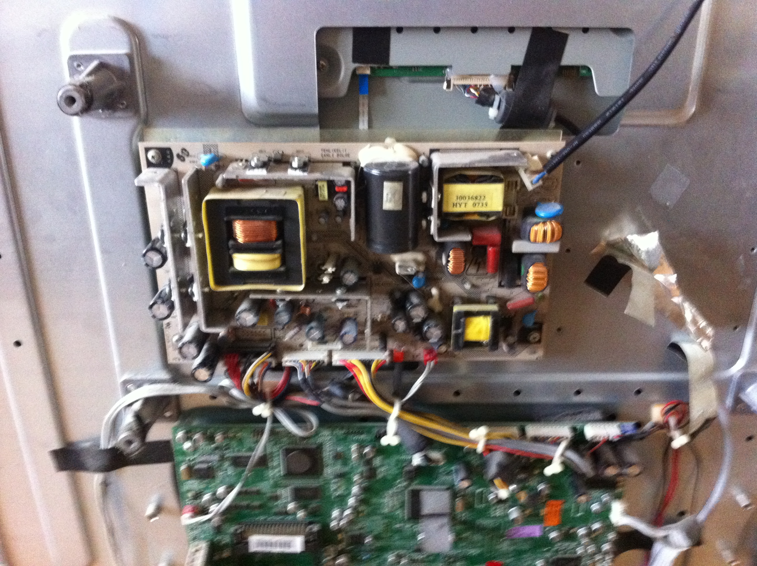

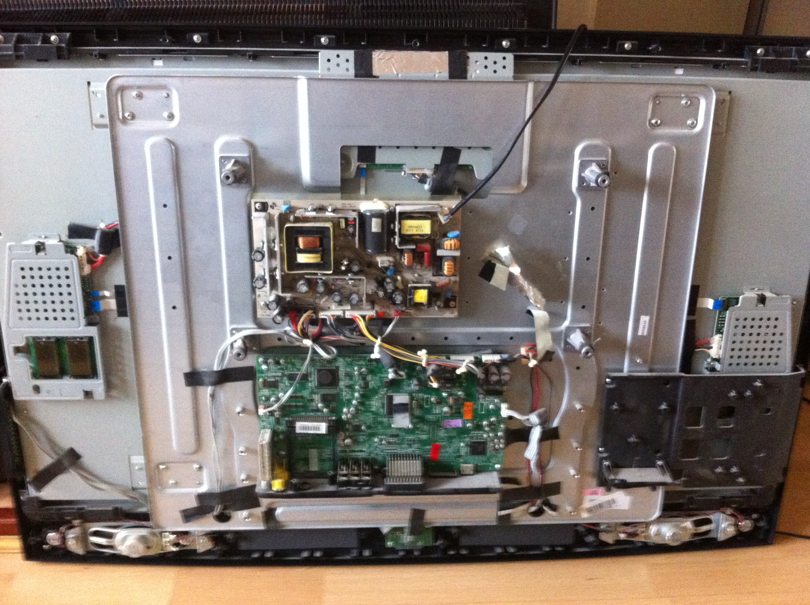

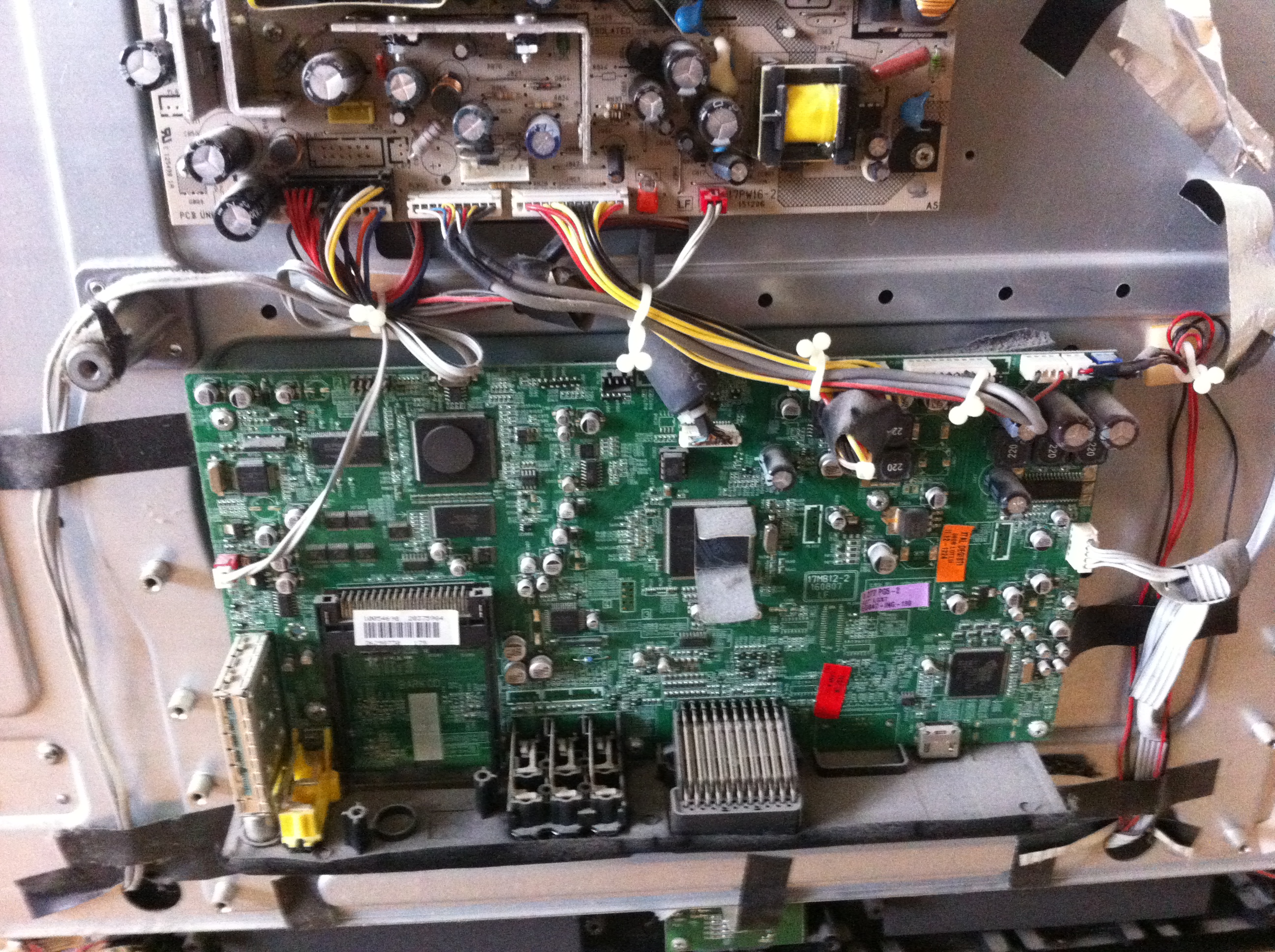

    hi guys got a Acoustic Solutions stuck in standby anyone had this problem before ?
    thanks
  • sordids999
    • May 2013
    • 2161
    • uk
    Re: 42762hdf
    ok update tv wont turn on so swopped another power unit i had but still the same no backlight or picture so disconnected the invertors one by one and the backlight tried to light up running off one invertor
    so would u guys say its the invertors thats the problem ?
    i know @tom has worked on this kind of tv
      Re: 42762hdf
      I have not worked on this TV. I have worked on some Vestels, but not this model or chassis.
      Probably not the inverter... how sure are you that your spare PSU is good? 90% of failures are due to poly caps on PSU board.
      • sordids999
        • May 2013
        • 2161
        • uk
        Re: 42762hdf
        opps sorry tom my bad it was a different model i watched on your youtube videos
        the power supply is 17pw16-2 i have a spare i removed from a working tv but still the same problem
          Re: 42762hdf
          Check the 24V supply to the inverters when both and when just one are connected.
