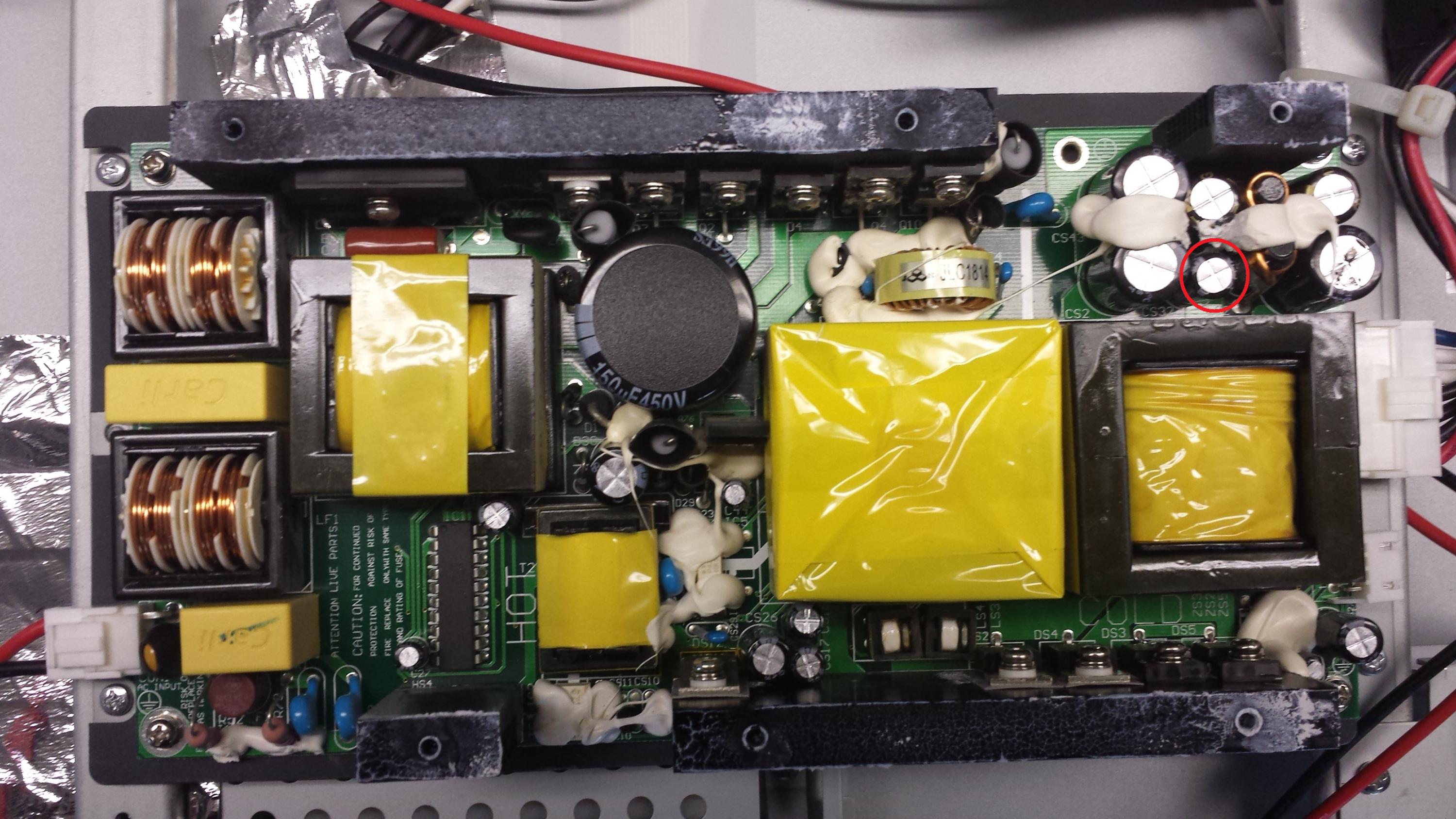

    I got this tv not working. I replaced a bulged capacitor and another capacitor that frequently goes on this model from my research. Now the tv works but takes several presses of the power button (both on tv and remote) to turn on.
    Also sometimes when the tv is on it doesn't always respond to the remote. Yes, the remote has fresh batteries.
    Has anyone else fixed this problem?

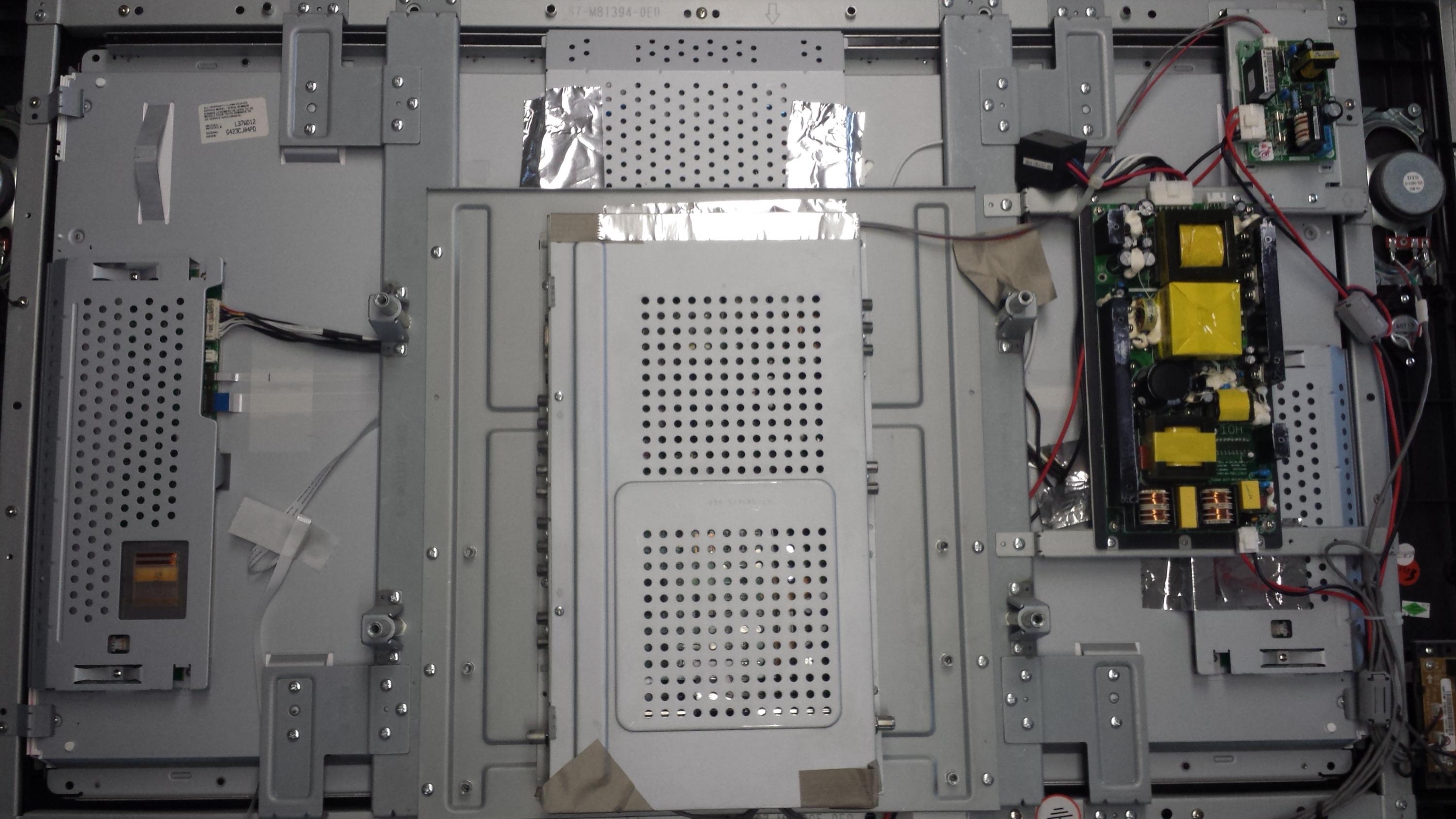

      Get the back off and get some pics of the chassis and power supply. My guess is you either have a loose solder joint, or bad caps that go back into spec when they heat up.

        Sounds like you have more bad capacitors...

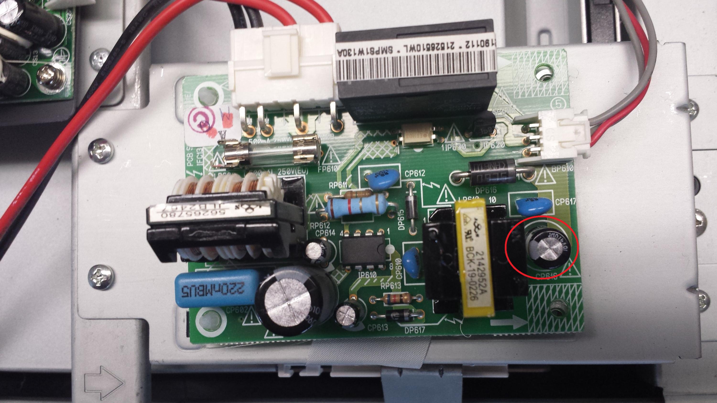

          You have a small seperate 5v stand by board in the set. Could be either of these listed here.
          http://www.shopjimmy.com/catalogsear...ult/?q=L32WD12
          RCA LA60691121 SMPS P-SMPS Board
          RCA 274595 SMPS P-SMPS Board for L32WD12YX9
          The last one I fixed not only had bad caps in the main SMPS but also on this board. The cap I found was not buldged but read bad with my blue esr meter. It was the medium sized cap next to the transformer if memory serves correctly but check them all any way.
          Start there and report back your results. Cheers!

            Thanks everyone for your responses. I don't yet have a meter to check the capacitors.
            I'm posting some pictures of the tv as requested. I put red circles around the 2 capacitors I already changed.

              change the others too,
              except the big one
              with quality
              low internal
              resistance
              types

                    The first capacitor you should replace is the circled one in my 3rd picture. From my research that's the most likely one to fail.

                      I just got through replacing all the capacitors on the power supply and 5v board. I'm still having the same exact problem. Could my power switch and IR receiver be bad? Any other ideas?

                          Sorry for the late reply! I finally got my replacement caps from Digikey and into Replik8tr yesterday. We replaced the single cap on the W1 board (your pic #3) which had already been replaced once, as well as all six on the SMPS (cap cluster in your pic#2).
                          Previously, the tv wouldn't come on with the power button, just the red static light. Now the light turns green on power and starts blinking, as well as a small backlight flicker that comes on about once a second. Unfortunately, we don't seem to have a picture yet.
                          Any suggestions? I have pretty good test equipment available, I just don't know how to use a lot of it. I'm still game for cross-testing parts if you have the time!

                            After replacing some of the caps on the SMPS, I tested the 12v and 24v lines coming out of the SMPS and I didn't see any voltage when it wasn't plugged into the Main Board. If I plug in the MB connector and then test the same pins I get voltage, but it's not the correct voltage and seems to vary quite a bit (3-16v, etc). When plugged in like this, I can also see a red blinking light on the scalar board. any ideas?
                            Looks like there is something wrong with the SMPS, but I'm not sure how to test or trouble shoot from here.

                              You'll only get outputs from the SMPS when it is turned on, in most cases this will only occur when the PS-ON signal is brought HIGH and it has good AC voltage going into it.
