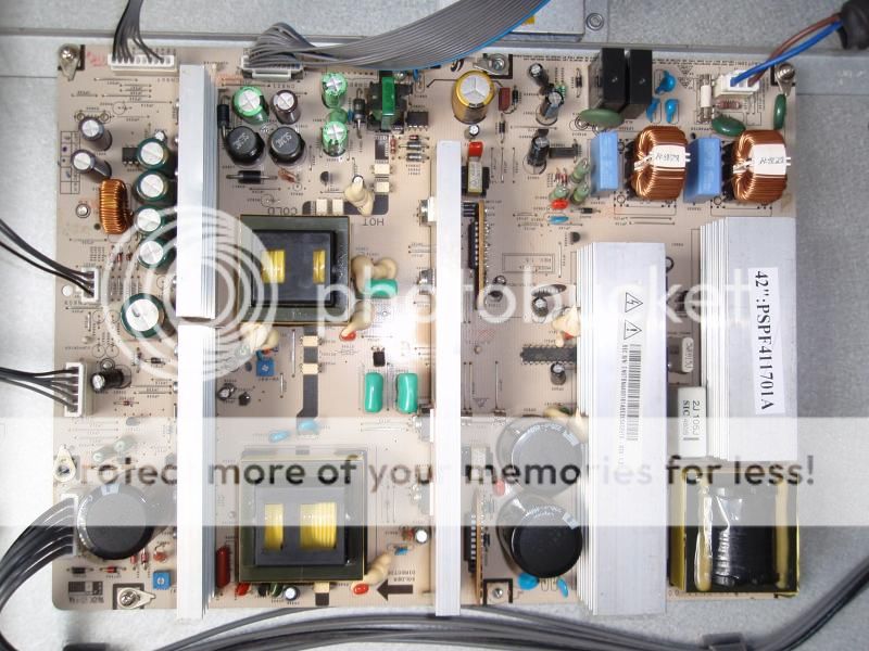

                          Re: ps50q96hd no picture
                          have added pictures of everything
                          this cap near lower buffer connection looks a little funny due to someone incorrectly fitting it and ruinng the via so I took it to the closest positive point in track
                            "SD" cap is not low ESR and may cause problems.
                            Any chance of a higher detail picture of the Y-main board? I want to be able to see any test points visible.
                              tom after testing allsorts lol
                              disconnected y from buffers still the same so buffers seem ok not heating up etc
                              disconnected x main and problem still exists
                              I finally found the vscan adj and test point
                              so my findings are the when tv first powered I get 195 as on the panel sticker but soon as I get the green led on y main voltageon vscan drops all the way to 0.0
                                That is normal if there is a fault -- you need to track down why the LED is lighting up -- would suggest checking Vset and +Vsch (if available.)
