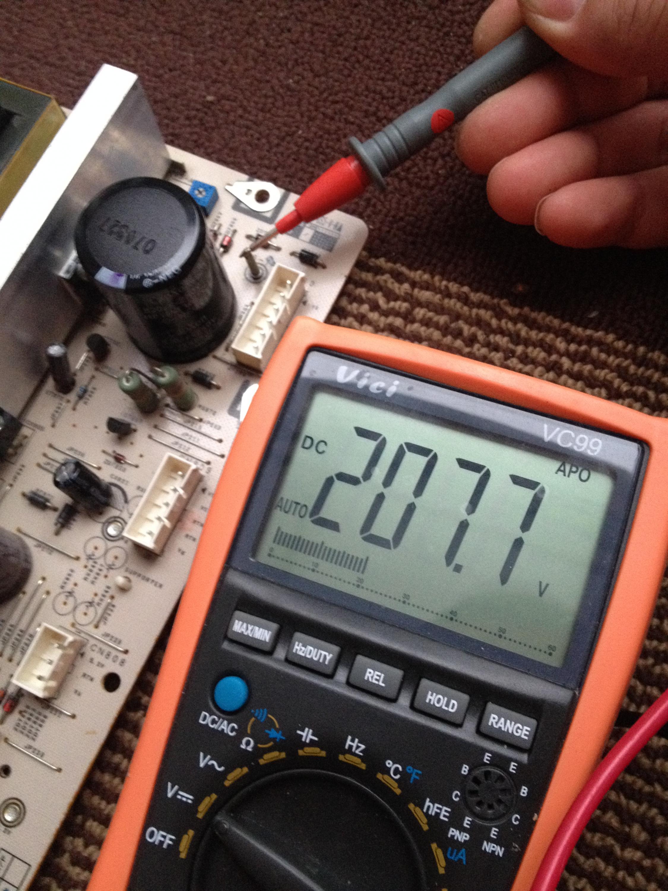

          tom tested the the green small fuse on xmain I get 206v both sides this is with set powered
          y main I get 015von that little green fuse both sides could this fuse be my problem

            Re: ps50q96hd no picture
            I went ahead and replaced that fuse now I have vscan up to -194 but when I plug control board flex ribbon back into the ymain I get green light on the ymain
            so if I have the x and y al powered without the control boards flex cables I get correct voltages at vs and va and vscan voltage is right but why wont screen light up I cant go ahead to fault find if the panel don't fire can I?
            or coud something else stop the panel lighting up
              The LED will light up if the Y-main encounters a fault, when it does the control board shuts it down. Faults can occur due voltages being out of spec or a short being present on the board.
              Voltage both sides of a fuse is fine, 15V is fine for the small fuse.

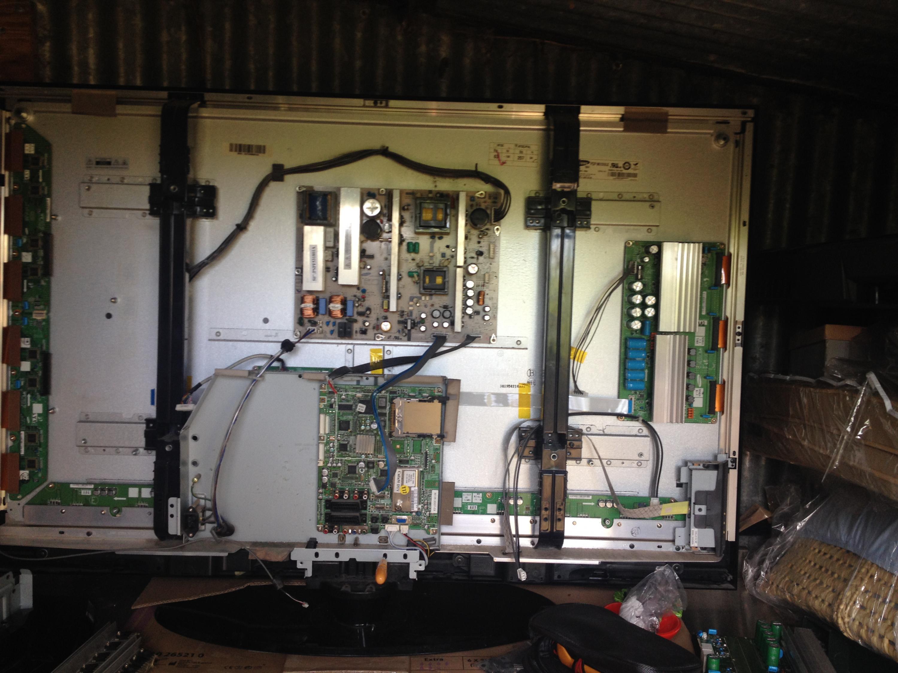

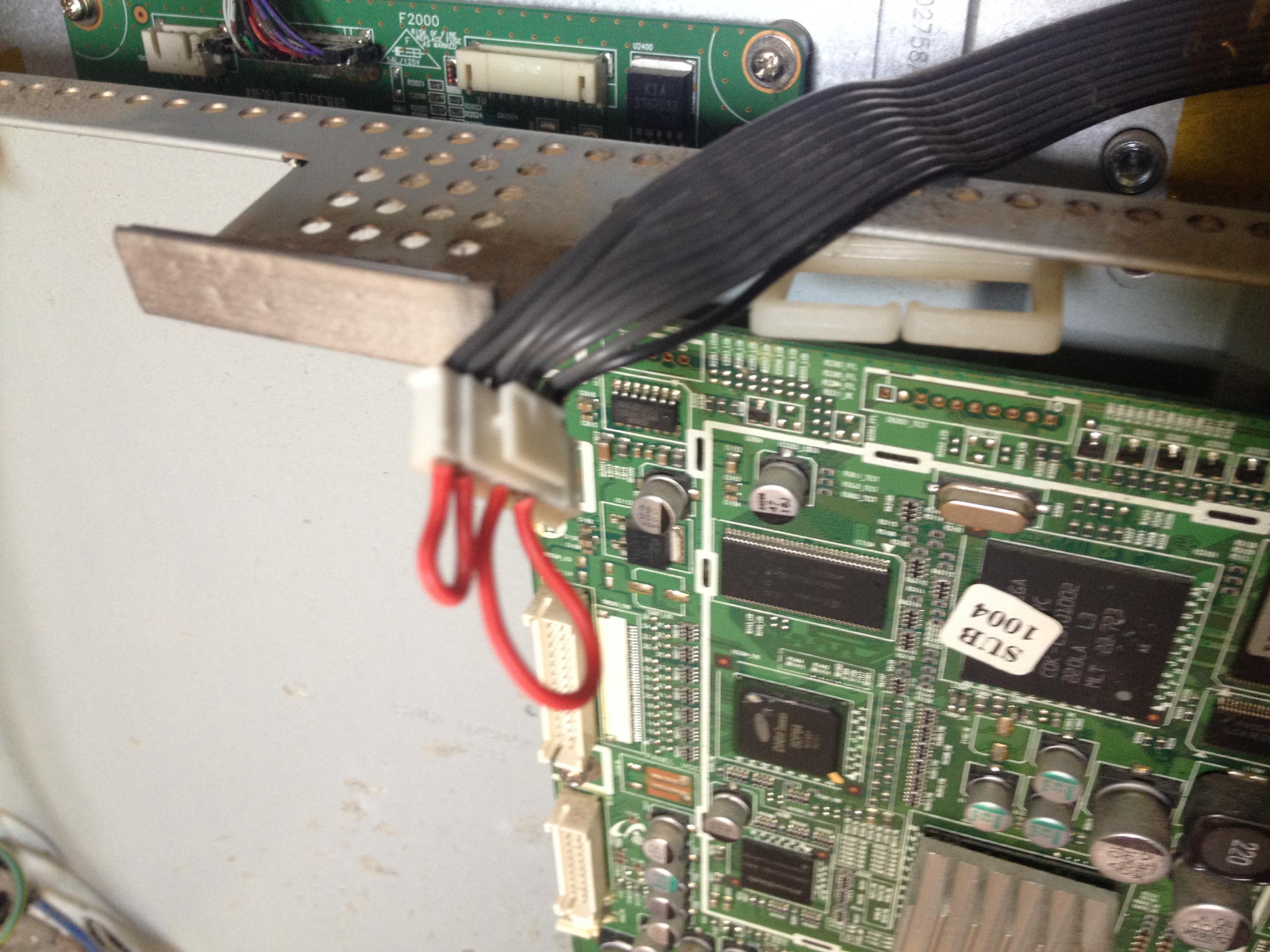

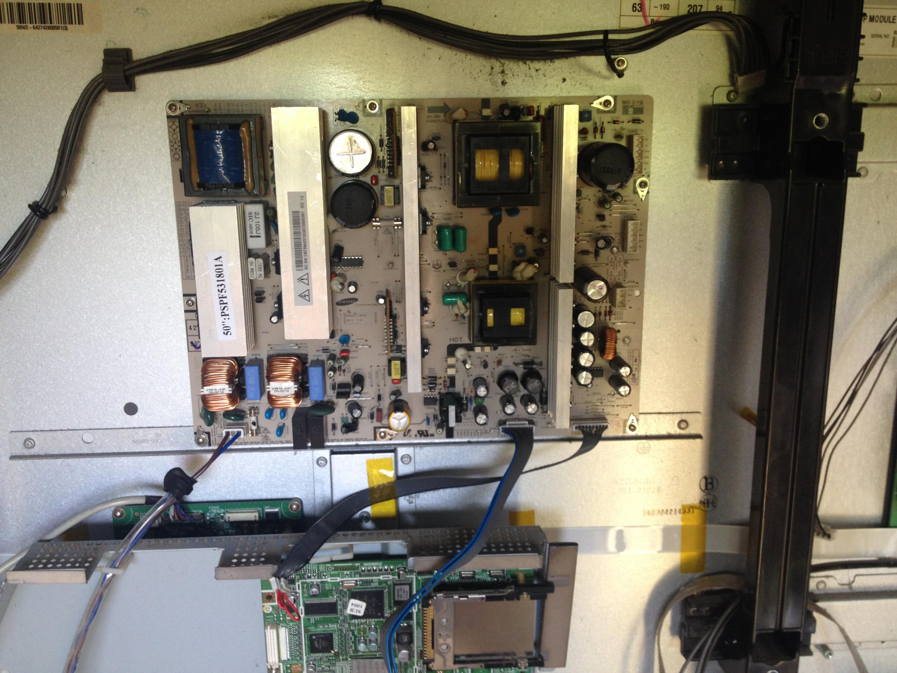

                        hello,I have the same tv and will not power on just cliking .
                        I have a good power supply ,if you cold start it have good readings.
                        The problem is when plug in only the main board and the CONTROL BOARD to the psu the tv just clicks ,is the main board faulty ?
                        Is this tv should start only with this 2 boards connected ?
                            I mean turn on PSU without main board and control board by shorting 2 pins together .vsON/5vStB and psON/RTN I have good reading from both VA-63.2v and Vs-207v
                            After I try to connect the control board and main board to the PSU I hear the clicking and shuts off .
                            What is the next step please ?
                            Should the PSU start with only this 2 Boards connected to the power supply ?
                            and no x,y,buffer board connected ?
                            I am thinking the main board is faulty (already changed the ic 24C256BN )

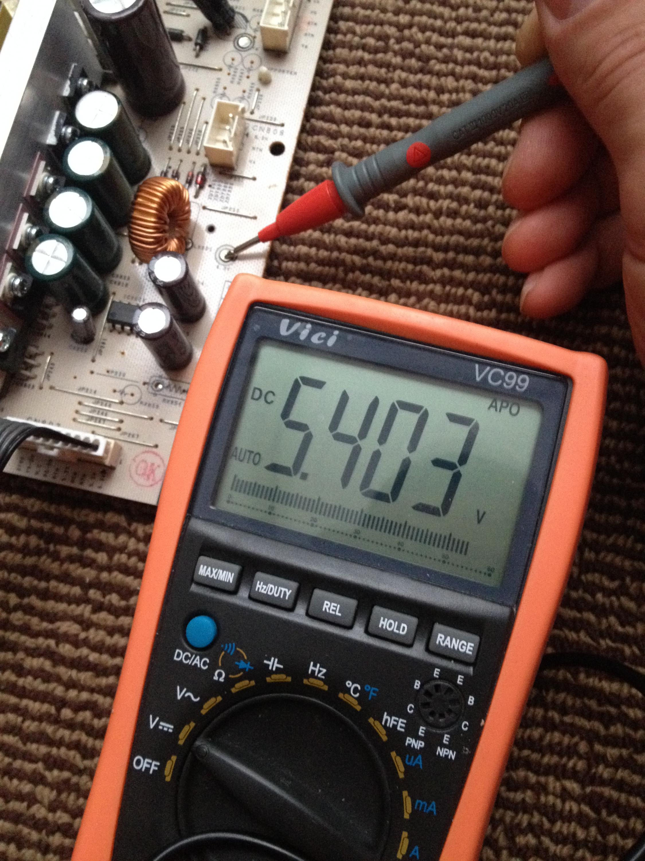

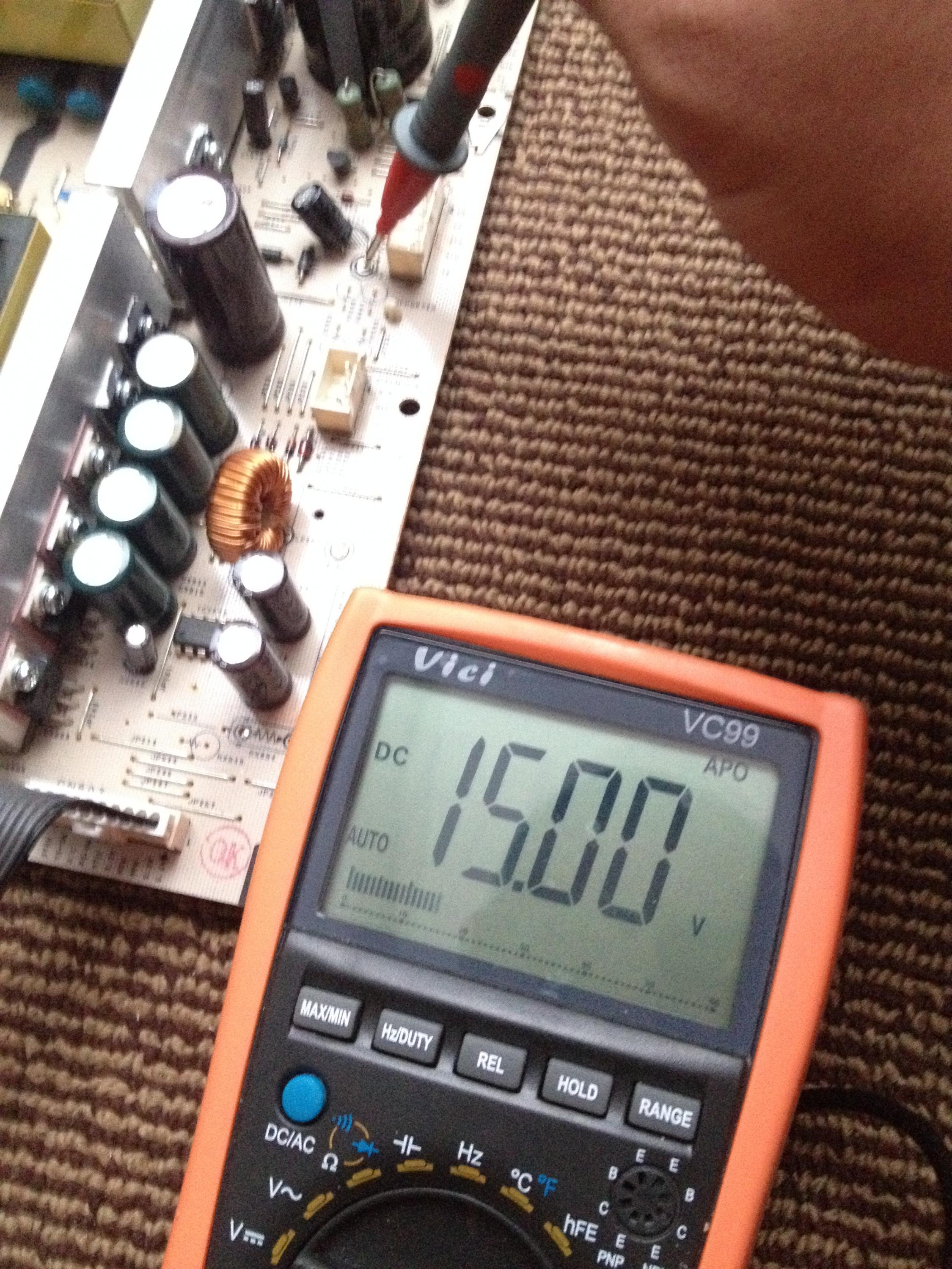

                              Check 15V, 5V ,etc. as well when you jumper -- cold joints can cause these to go missing.

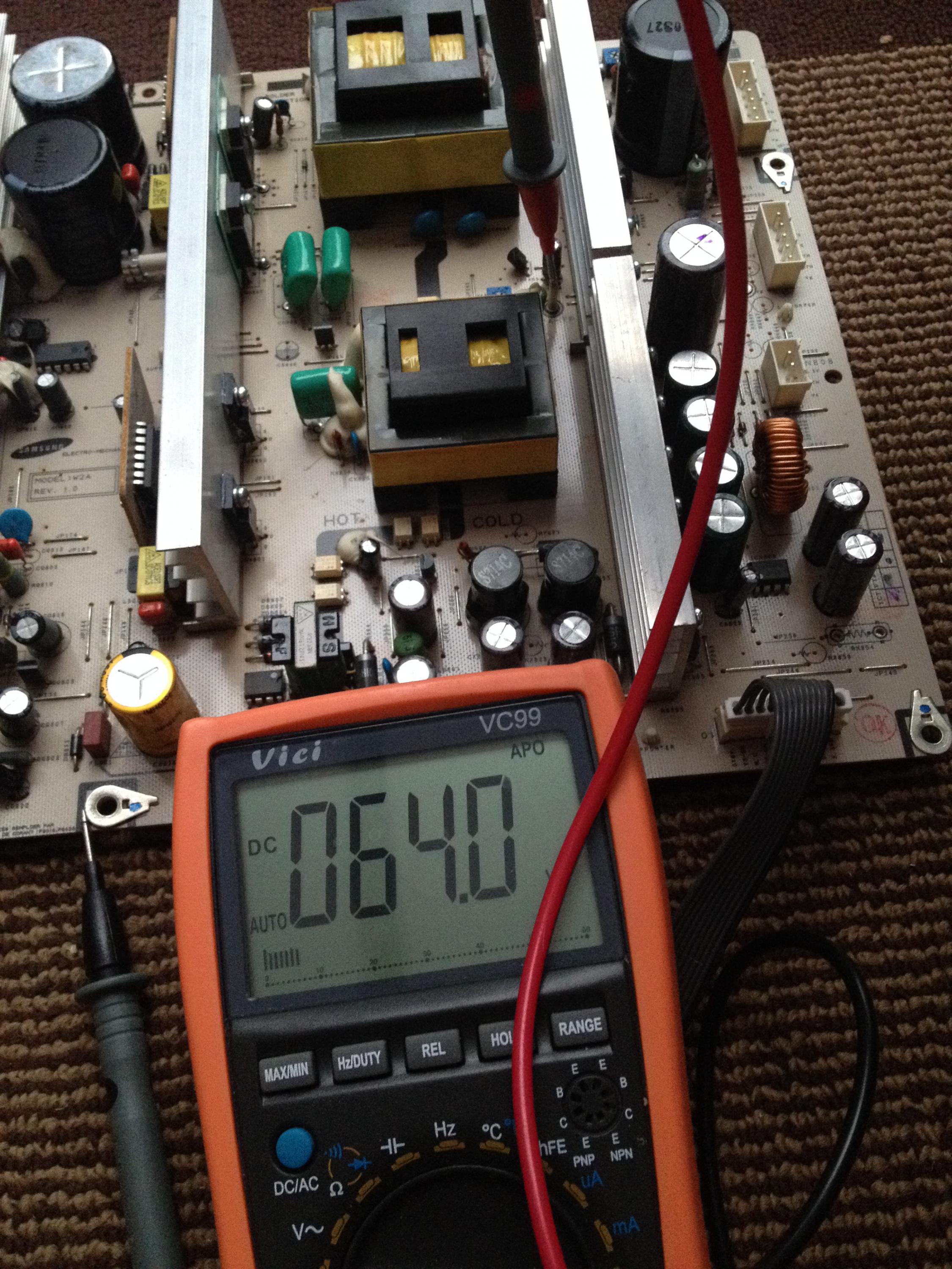

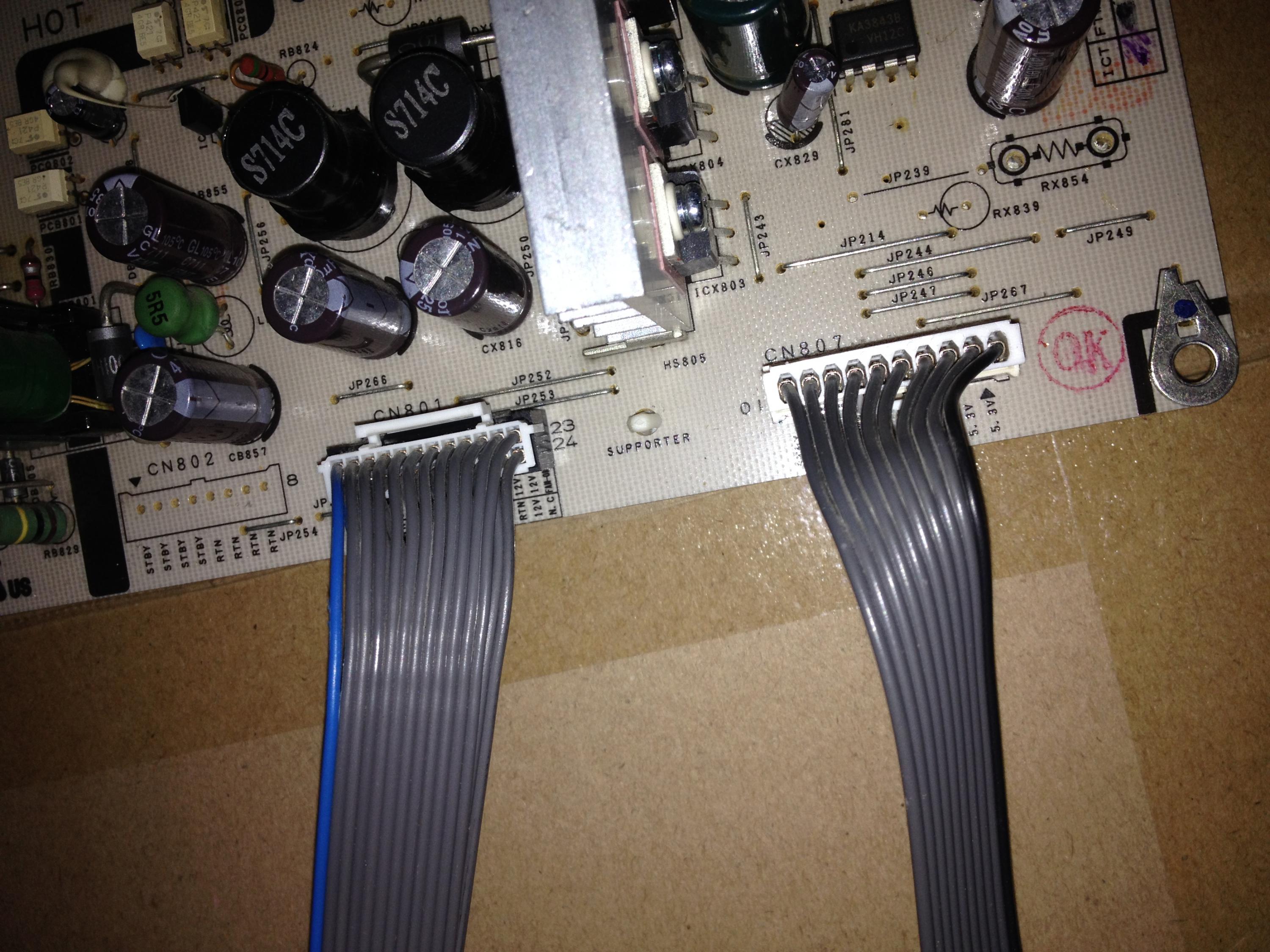

                                Just jumped again and you can see in the photos all have good readings including CN801 and CN807 connector .
                                What would be the next step please?

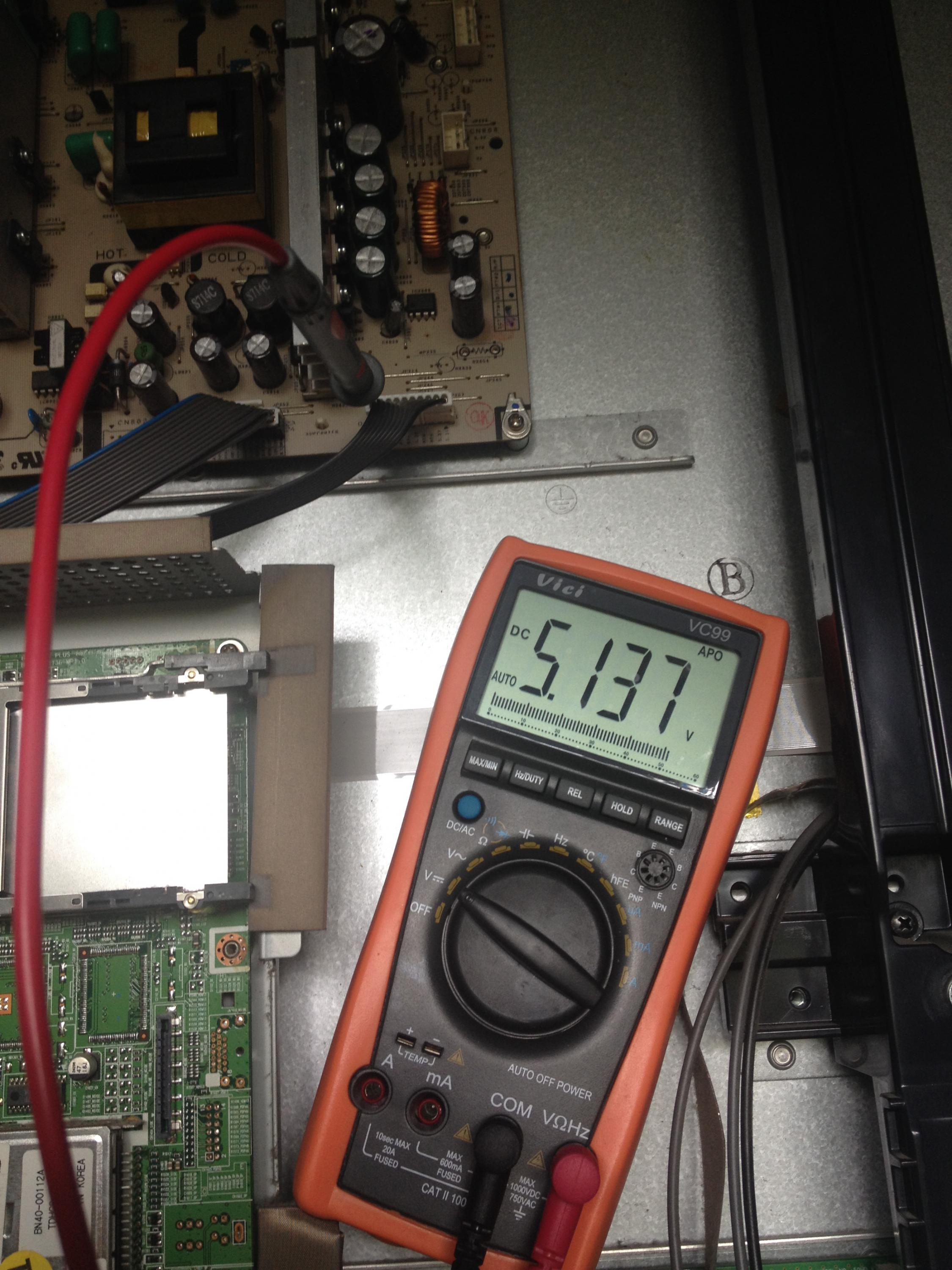

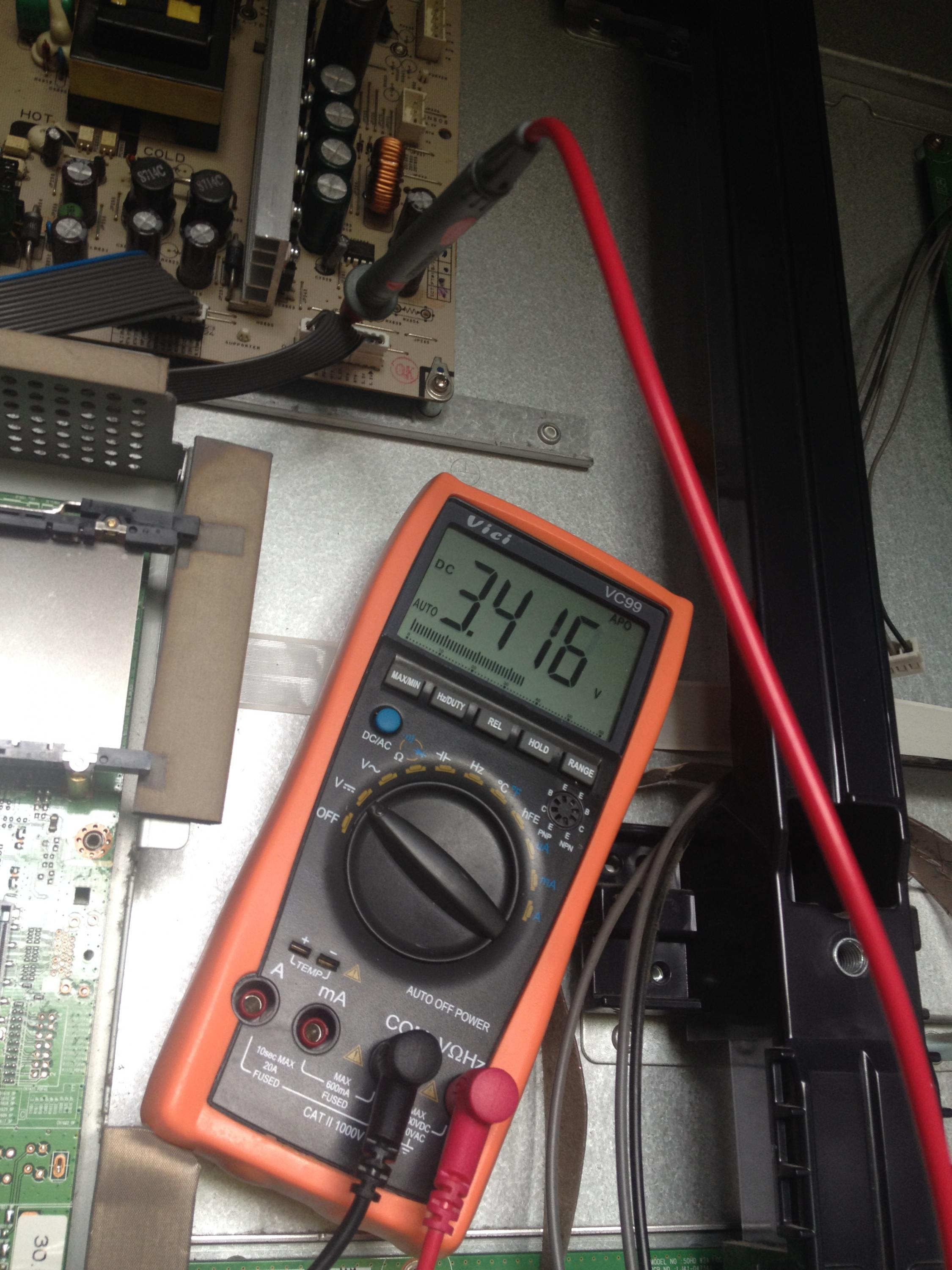

                                        #39

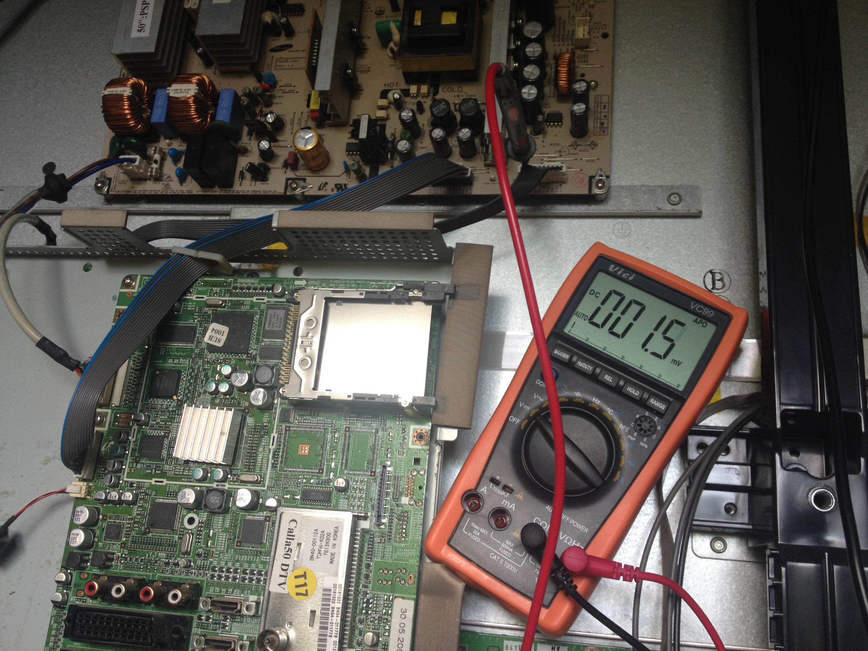

                                        I have put back the power board ,connected the main and control board
                                        the readings are :
                                        standby :5.137v stay on all the time
                                        PSon : 3.416v when clicks drops
                                        VSon : 001.5mv no reading
                                        • flocko
                                          • Nov 2012
                                          • 1121
                                          • uk
                                          #40
                                          so no VSon from control board try with just main board connected / I would expect the power supply relay to click and stay in but with only low volt outputs from it no VS
