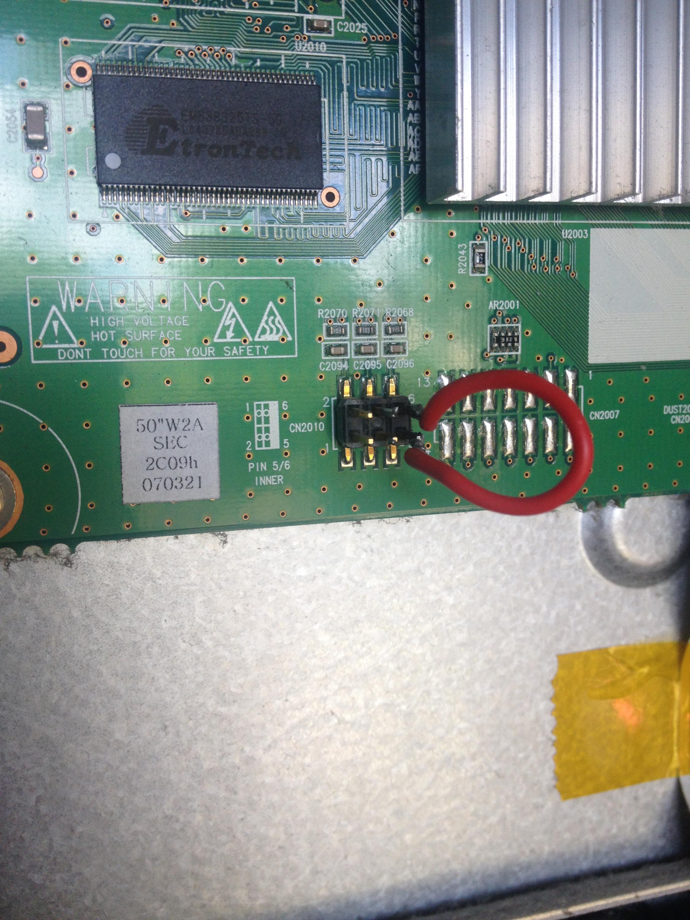

      looks like main board fault as not holding PSon, you could try running test patterns on the set have you ever tried this? you would need to replace all the connections for all the boards apart for main to power board, jump PSon to ground on power board and jump test pins 3-4 on control board .When you plug the set back into main the set should show test patterns

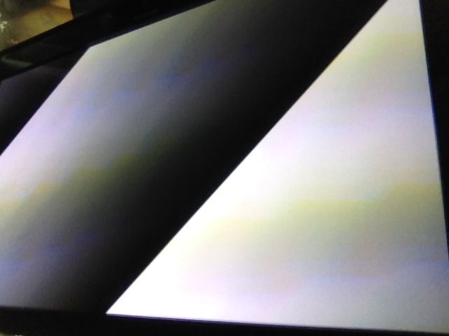

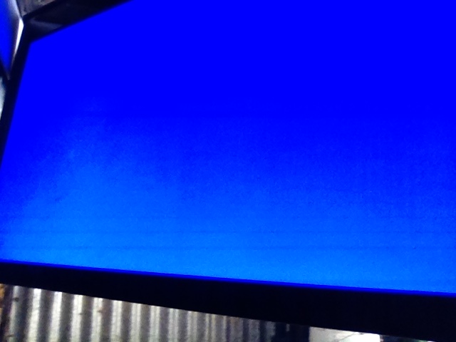

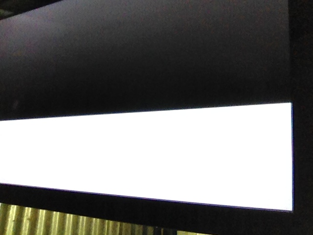

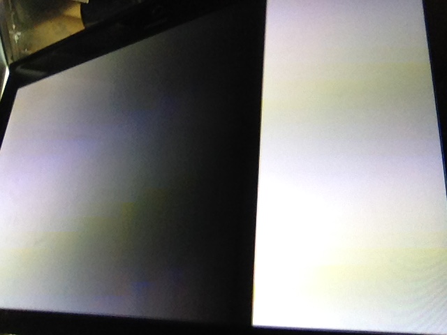

            I have done the test pattern ,do you have to get a picture on the screen or something ?
            What I have is just like a backlight all around the screen.
              #46
              Re: ps50q96hd no picture
              I checked again and the pin you have to short are 5 /6
              And I got the test pattern and all looks good .
              This mean the power supply,x,y,buffers and control board are ok and I need another main board ?
                #47
                sorry I should have looked to see what control board was fitted to your set ,normally its pin 3+4 or hole 3+4. When you look for a main board you need to match the BN94-XXXXX this is the part number that you will find on the bar code sticker , do not go by the BN41-XXXXX as this is the bare board number and can be loaded with any components for any model Let us know when you have it fixed Flocko

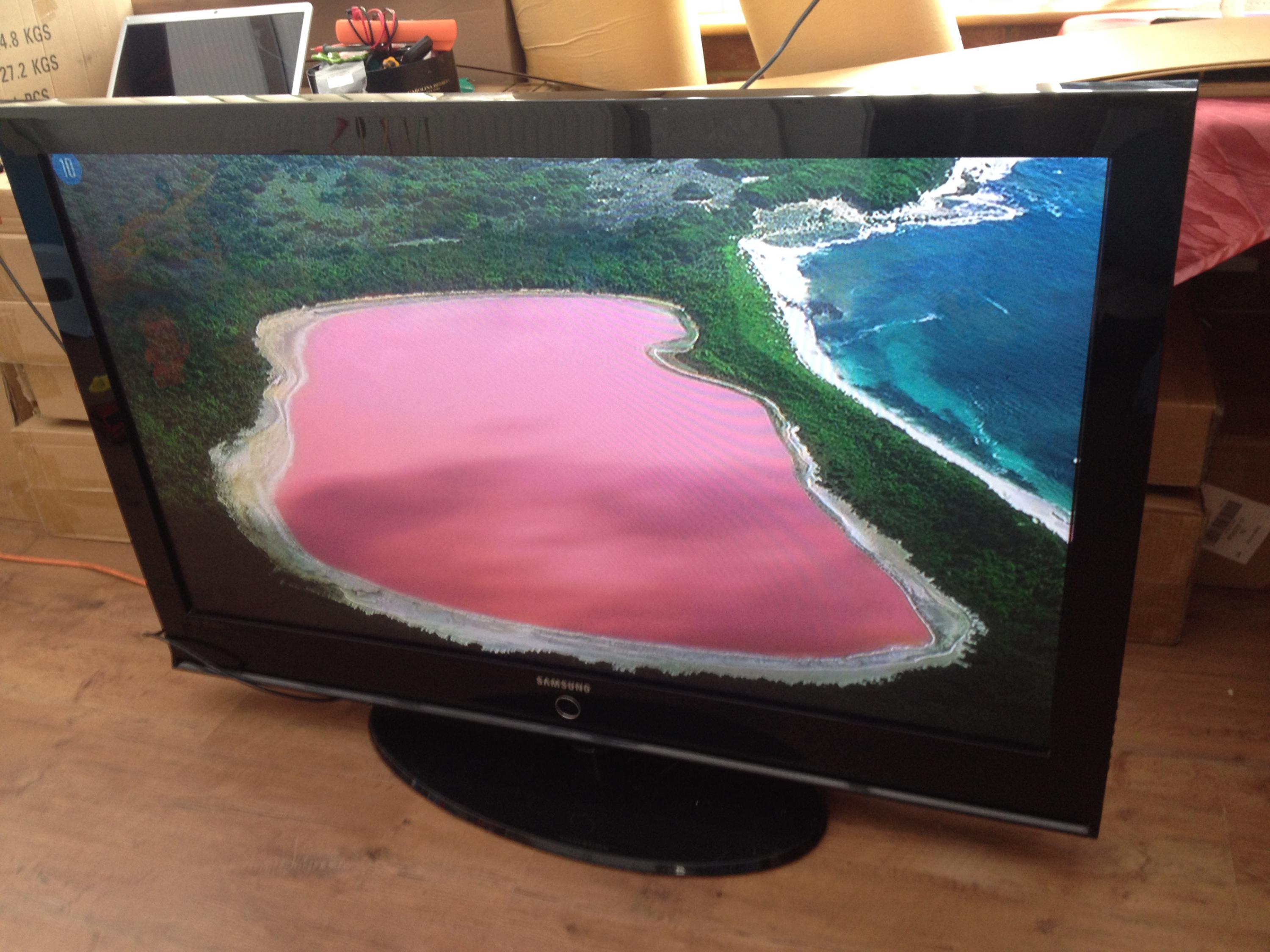

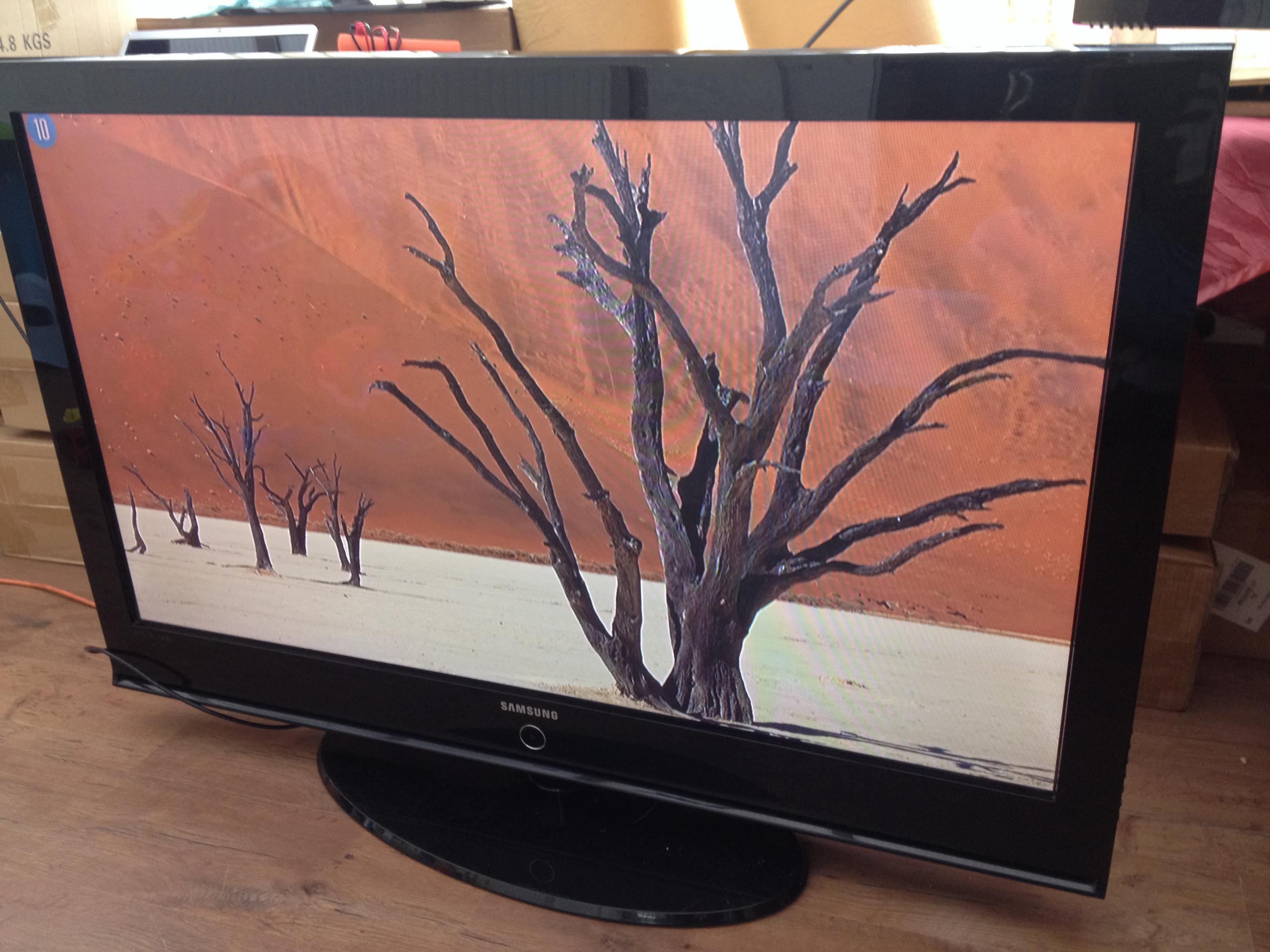

                  Thank you flocko !!!
                  I received the main board (BN94-01177B on ebay for £23 incl postage)this morning and another tv fixed ))
                  I realised the side HDMI connection is not working and is connected to the main board and keeps restarting the set ,I left it unplugged and tv is working properly.
