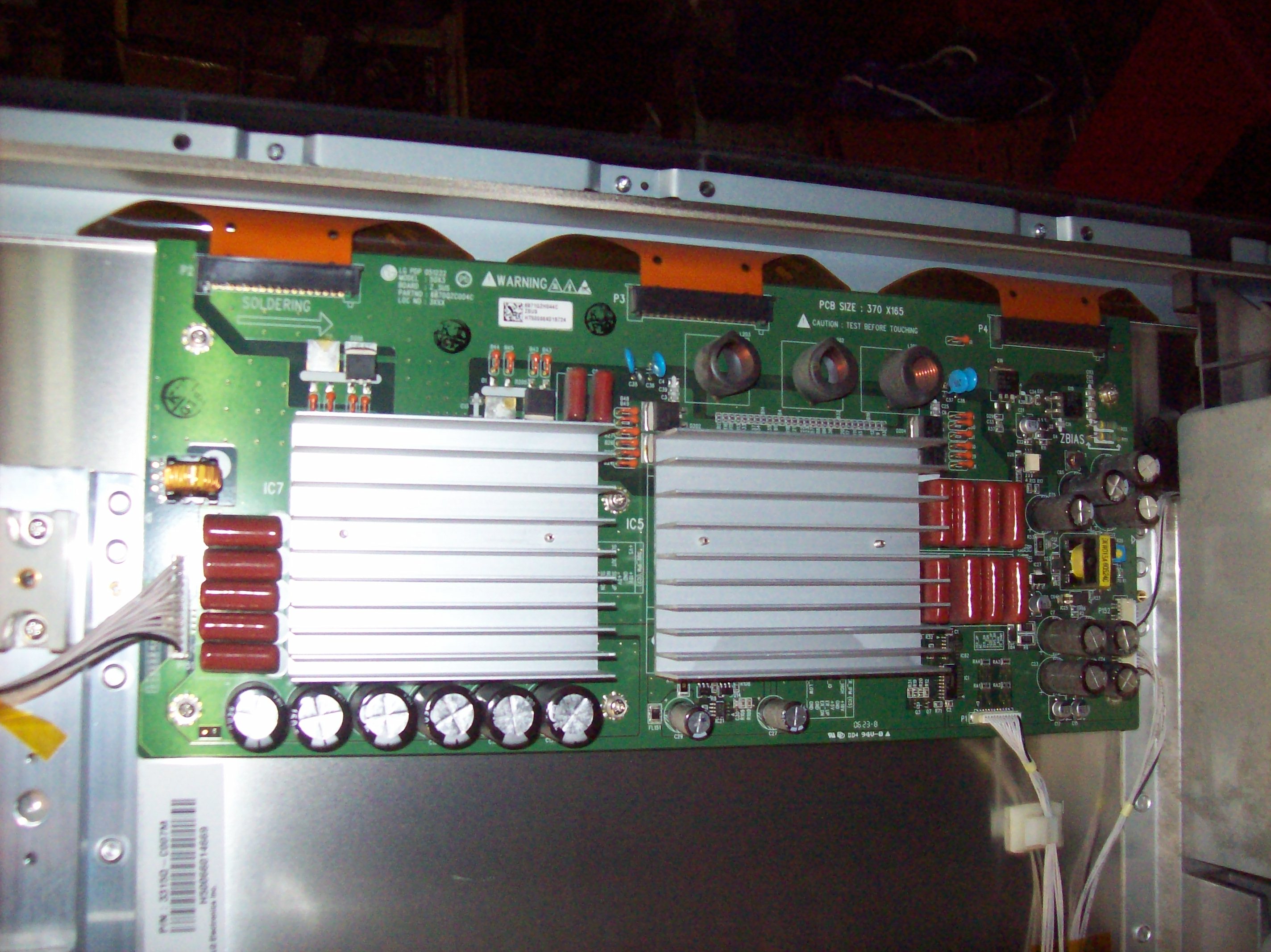

        OK, if you disconnect the Z-sus and Y-sus does Va still drop?

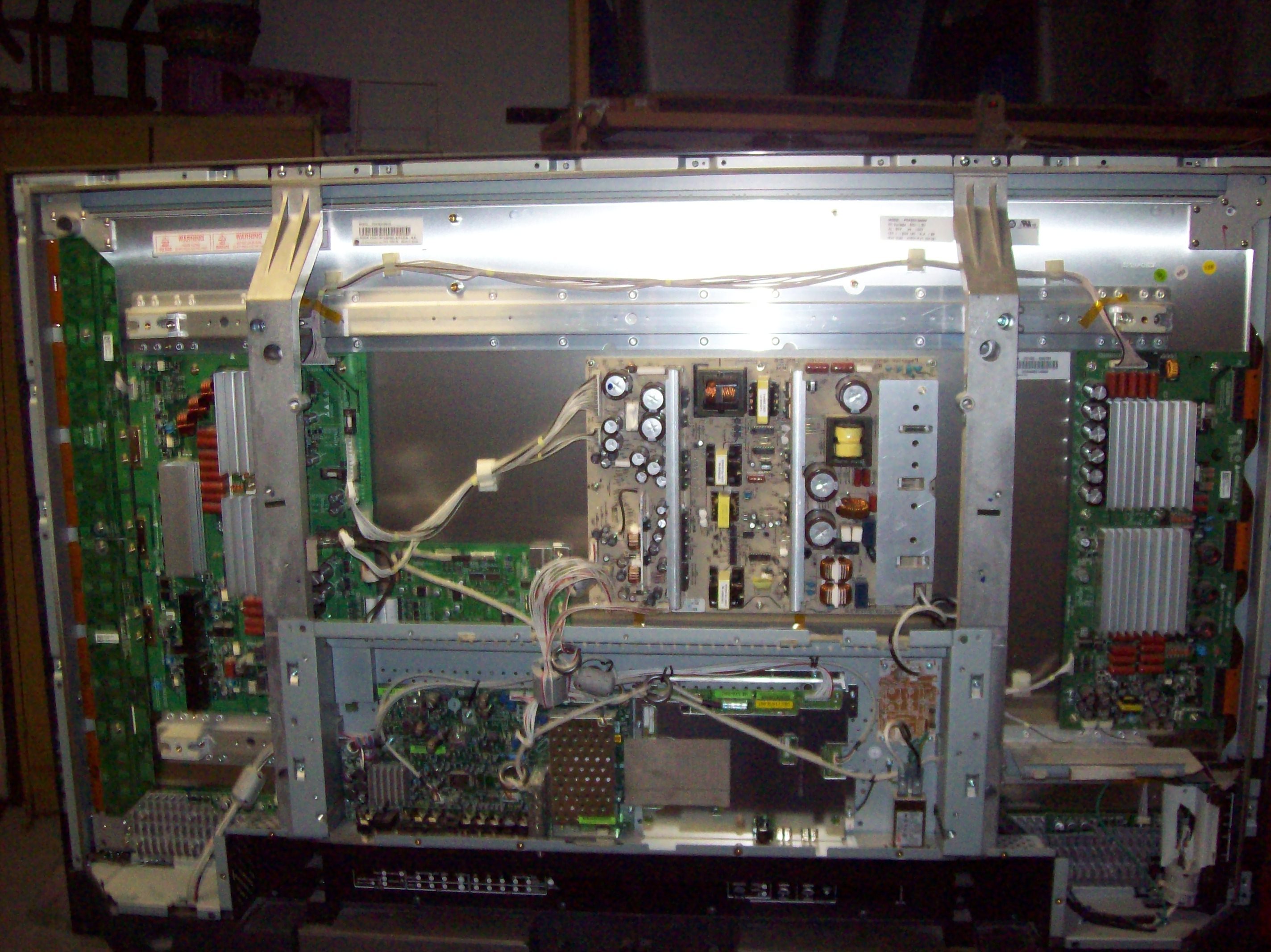

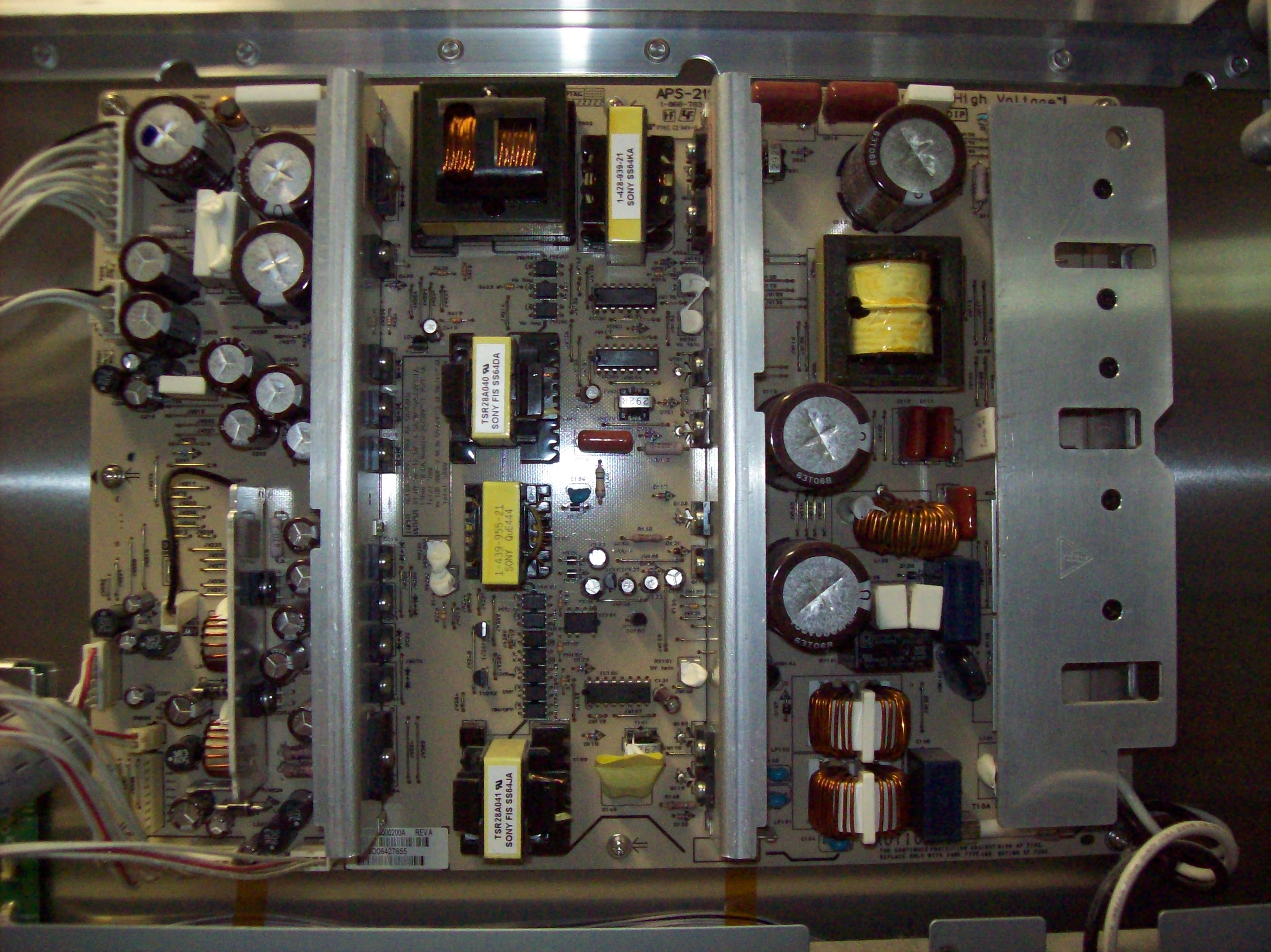

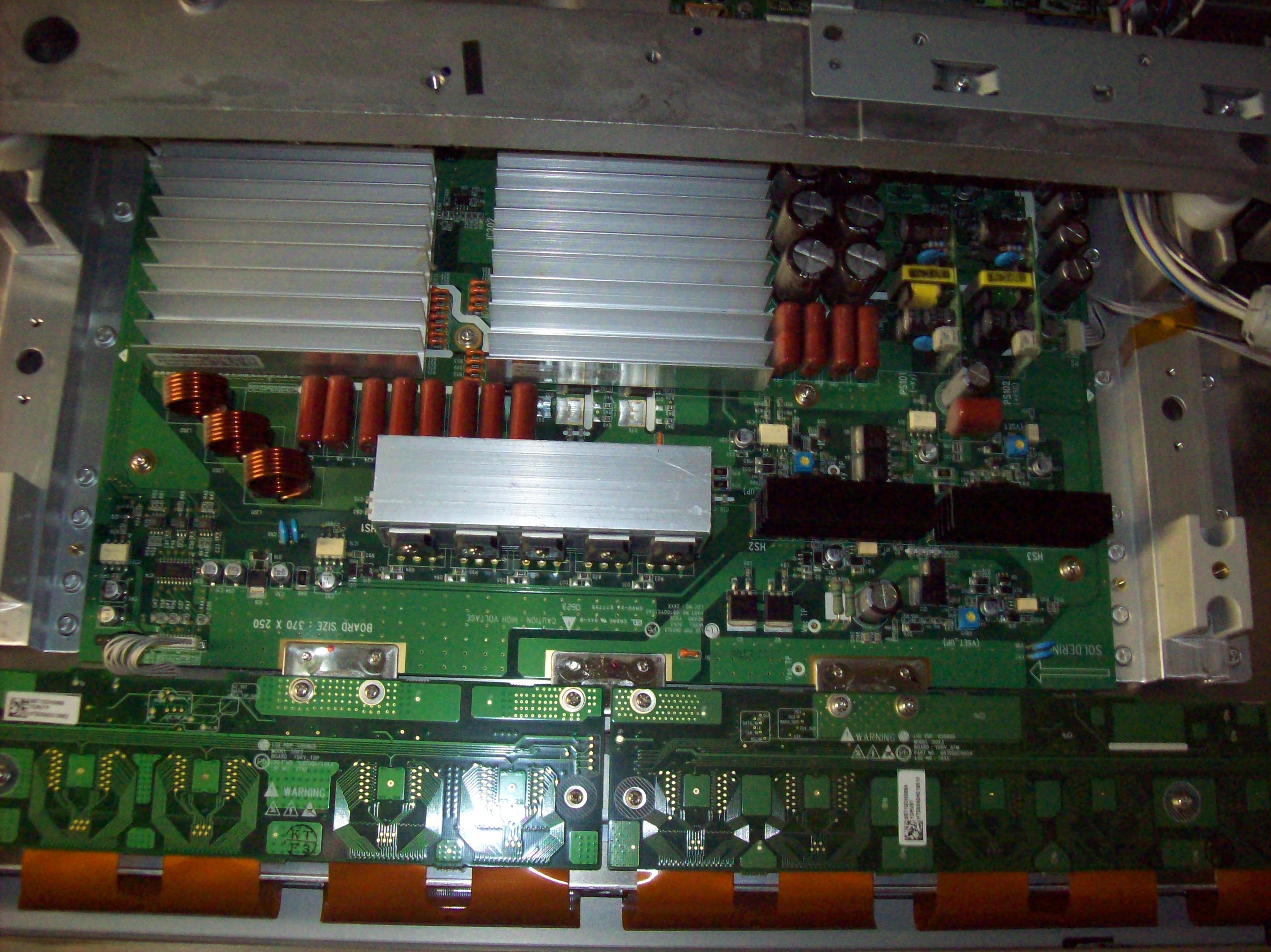

            OK, can you post a picture of the chassis layout? Clear and in focus please.
            • joe904
              • Aug 2013
              • 27
              • usa

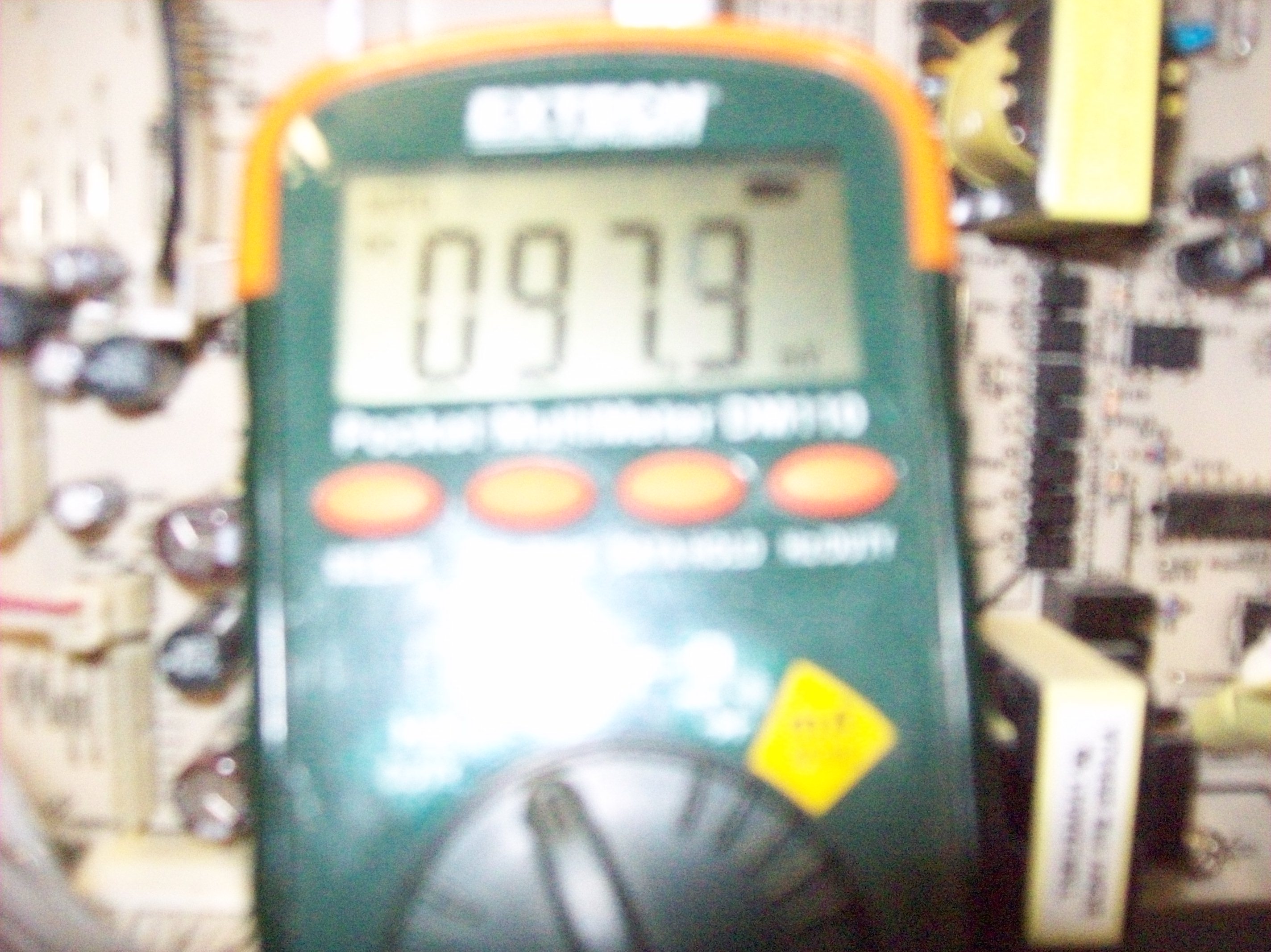

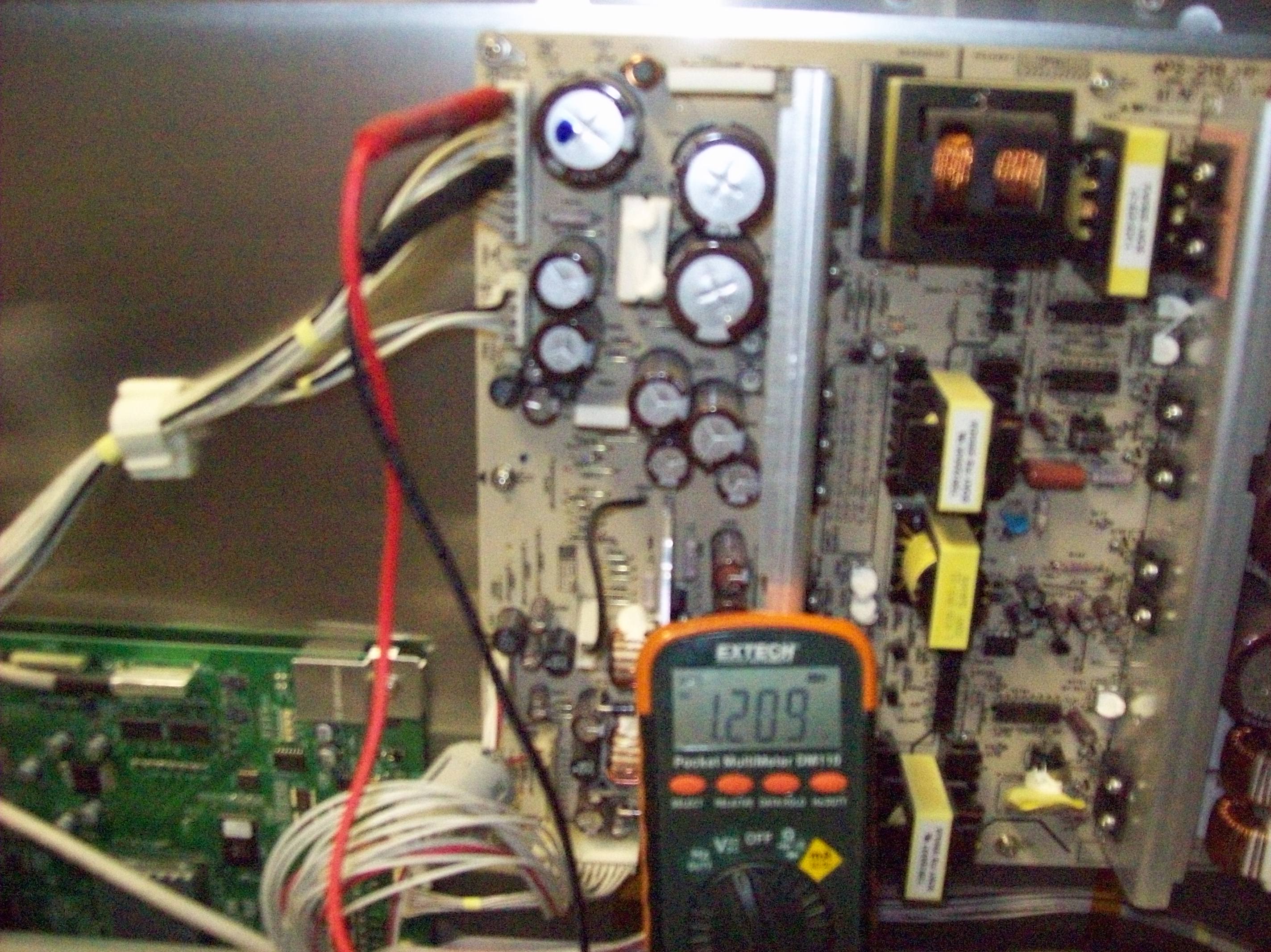

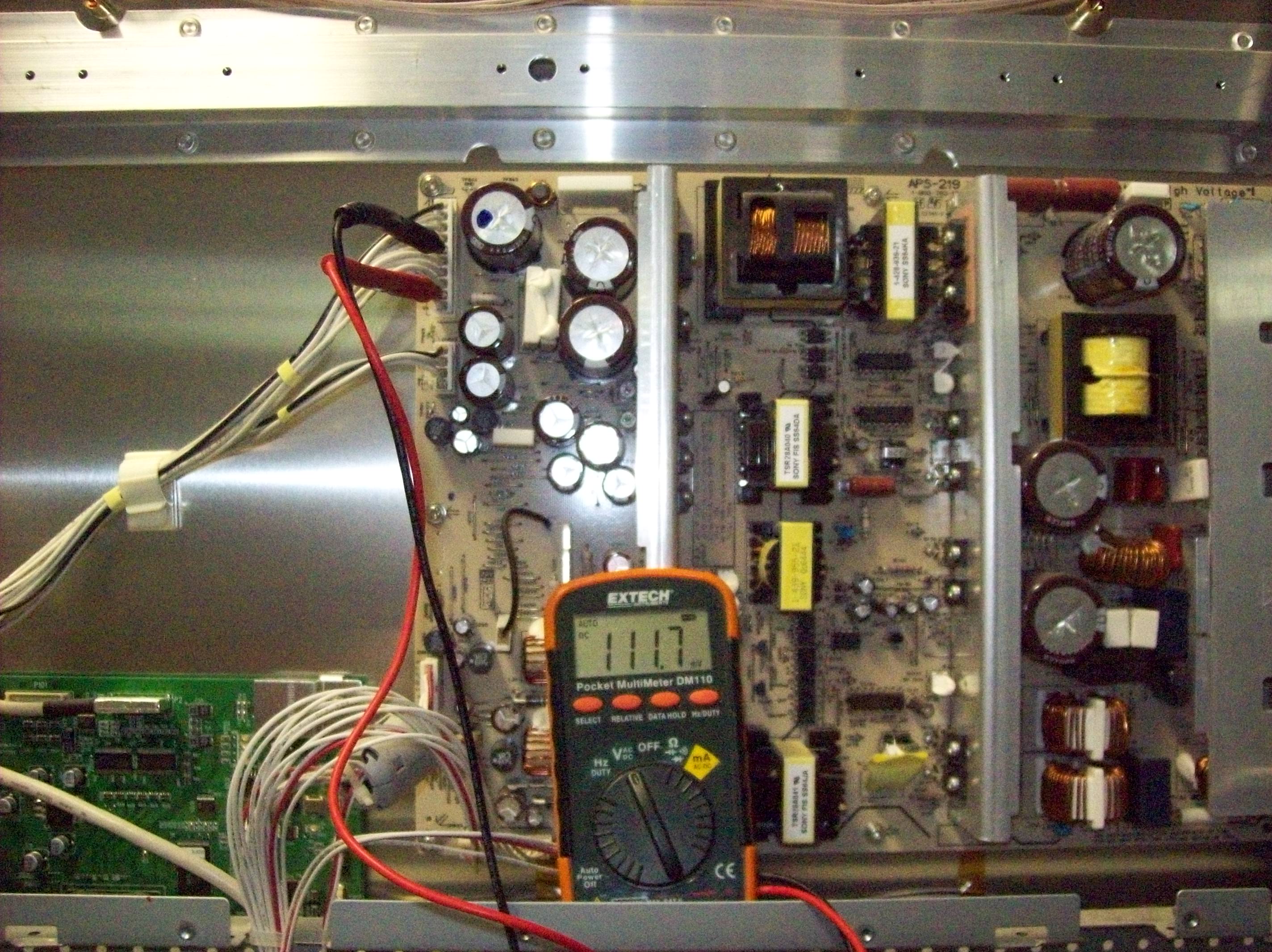

              Re: toshiba pdp50x3 power supply issue
              hope these come out clear. both va and vs drop way to low? thanks
              • joe904
                • Aug 2013
                • 27
                • usa
                sorry left out those readings are mv vs 1.209 v va .979 mv thanks

                  I have no idea what the %*&) is going on ? I plugged the boards back in turn on , the voltages are steady va 61.2 and vs 195.6 the sets on and working for how long I don't know????? their has to be a reason.
                    I'd double check all connections are OK. Maybe one was loose.

                          I wonder if I should replace psu . because the voltage apparently is still dropping causing shut down. I am only guessing at this point. anyone have a suggestion.
                            I would first check power board for cracked solder joints and loose connections.

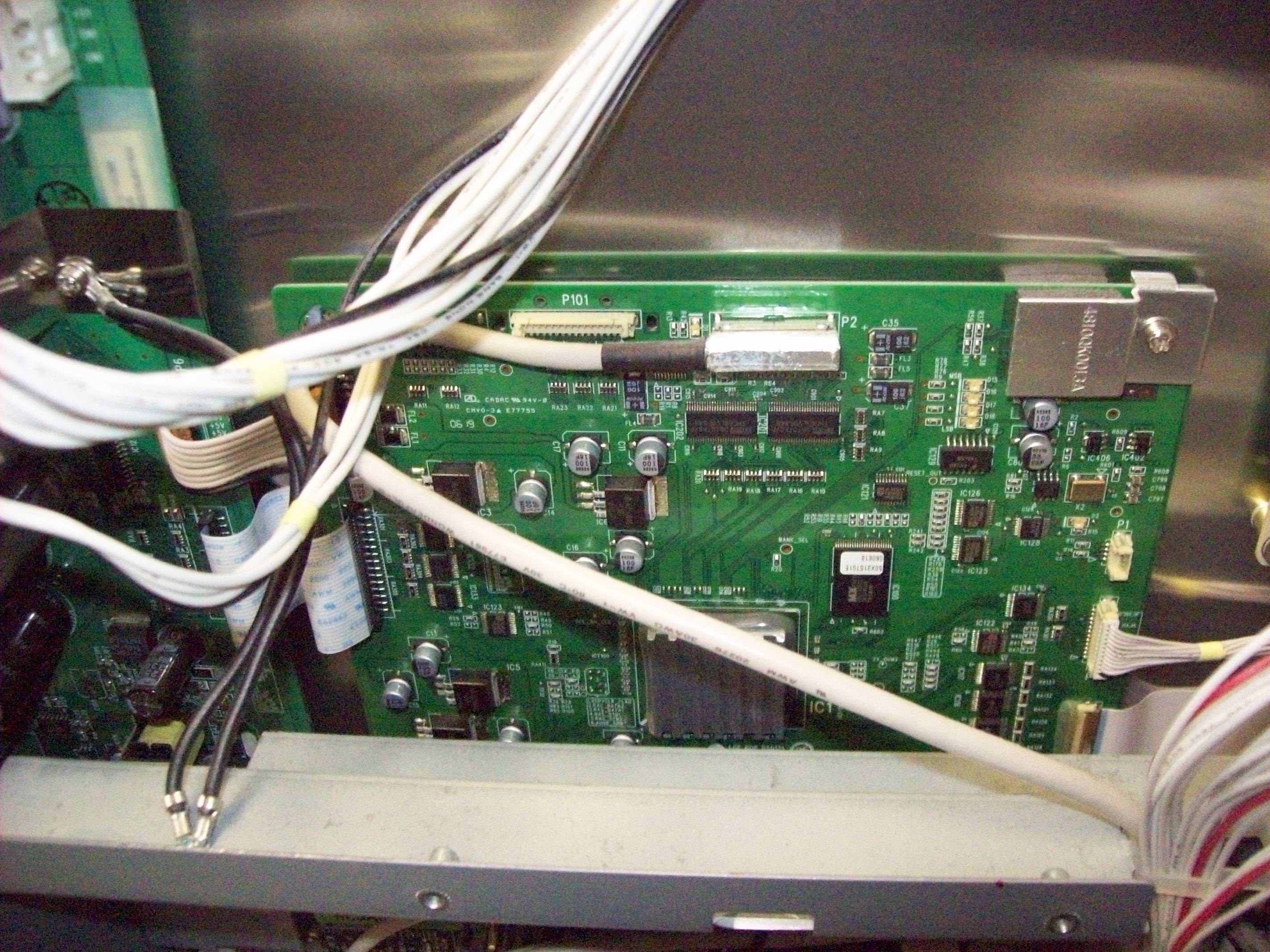

                                        yes I had done that and its the same .I also noticed that the control board lge pdp050121model50x3 led's d1 not lit d2 lit d15 lit d16 not d17 not d18 lit . if that's any help I know at one point they were all lit . also I checked the model no. with the back off label is pdp50x3 and on the outside case it is pdp50hp66 should have checked closer thanks
