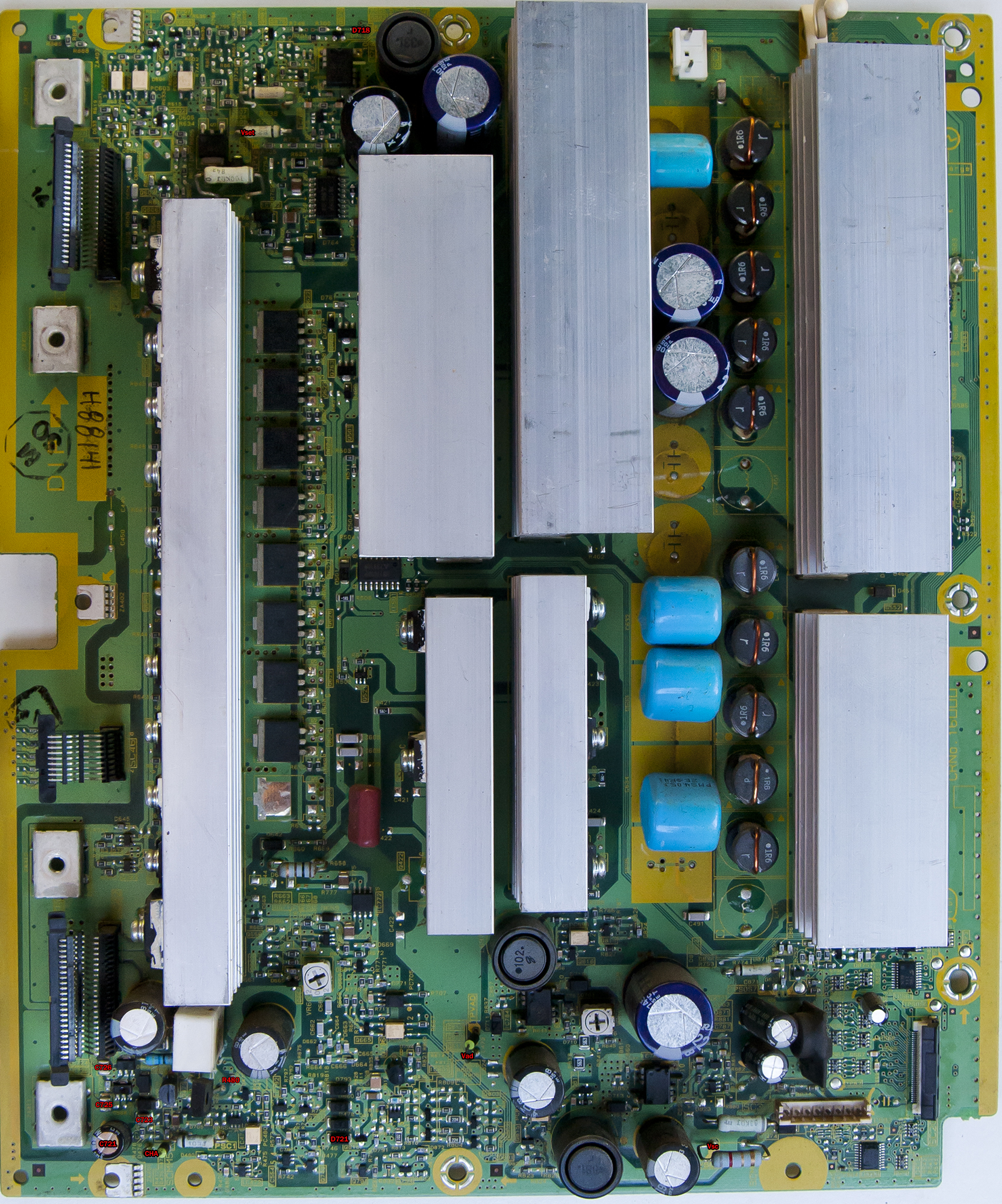

    Hello everyone, trying to fix this plasma for a friend. 7 blink error, pulled the manual from one of Toms posts on this model. It indicates that 7 blinks is su,sd or sc. I think I have it isolated to the su board. the top three pins of the connector are shorted to the middle four pins. On the sd they are not shorted. I just would like confirmation that Im not missing something before I order a replacement. Thanks

        Yes, what you're doing is jumpering the CHA signal so 7 blink error (buffer disconnect) won't occur. 7 blinks can still occur for other reasons though.
        The jumper wire goes from CHA to the VF GND, which is the "HV DANGER" screw. The two flex connectors are unplugged on the SD, as well as the ribbon between SU and SD. You can leave just the top buffer connected.

            The VF, produced by the SC board, needs to be fed thru the buffers to the CHA signal. CHA is on the flexible connectors that you unplug to isolate, so the jumper is essentially replacing the CHA signal which the buffers would normally complete, which not connecting anything else (the buffer board is attached by one "pin" only (the "VF"): it's like lifting a diode on one leg, it keeps it isolated.)
            Note, SC failure can still cause 7 blinks. Typically this can be caused by Vad or Vscn voltage being bad. With SU/SD isolated, you should have a second or so to check Vad and Vscn.
            Service manual:
            shows Vad = -140V, Vscn = Vad+148V = 8V. Test points are on SC board. Vad below -120V will trigger 7 blinks. Not sure about Vscn.

              Update: I tested at two points on the bottom of the sc board marked tpvad and tpvscn. The Vad is reading at -138.8v but Vscan only reading 4.8v.

                            Some other things to check before buffer swapped to rule in/out SC:
                            • Capacitor C725 on SC board, near C723 and IC724 and D1671: voltage across should measure around 5V.
                            • Capacitor C724 voltage across around 5V.
                            • Capacitor C723 voltage across around 15V.
                            • Capacitor C721 voltage across around 15V (Big electrolytic 100uF/50V.)
                            • Ends of diode D721: 16V one end, 15V other end, negative lead on negative of C721.
                            • Ends of R480: both ends should measure 5V, negative on chassis.
                            • Elsewhere, diode D820 pins should measure around 0V on all, negative on chassis.
                            • Diode D718 near VSET circuit: both ends 0V, negative on chassis.
                            • VSET test point not more than 395V, negative on chassis.

                              Ok tested out those I could find
                              C721 15v only appears for a second
                              C723 0v
                              C724 0v
                              C725 0v
                              D721 0v both ends
                              D718 0v both ends
                              I found the designation for 820 but am not sure where it is on the board
                              R480 0v both ends
                              Vset got a 405v momentary reading on the multimeter but then goes to 350v. didnt see the momentary high on the scope so I think its just the multimeter settling.
                              As for why I only have voltage on the cap, I think the board is shutting off before I can get the probes on the test points as I couldn't get a good reading off the electrolytic until i hooked it up on the scope, then it briefly came up to 15v.
                              Adding in a pic of the locations of the test points as I had some trouble locating them. Hopefully it will help out the next guy. Spent an hour cleaning the board of smoke residue so I could read all the designations. Cant imagine why anyone would want that crap in their lungs.

                                OK, was that with the buffer board removed? It looks like you have a bad SC board too...
                                My 42" PZ80 was full of cigarette smoke... it stank when I first got it powered up because all that crap came out the fans... jeez if that's inside the TV what's inside your lungs?
